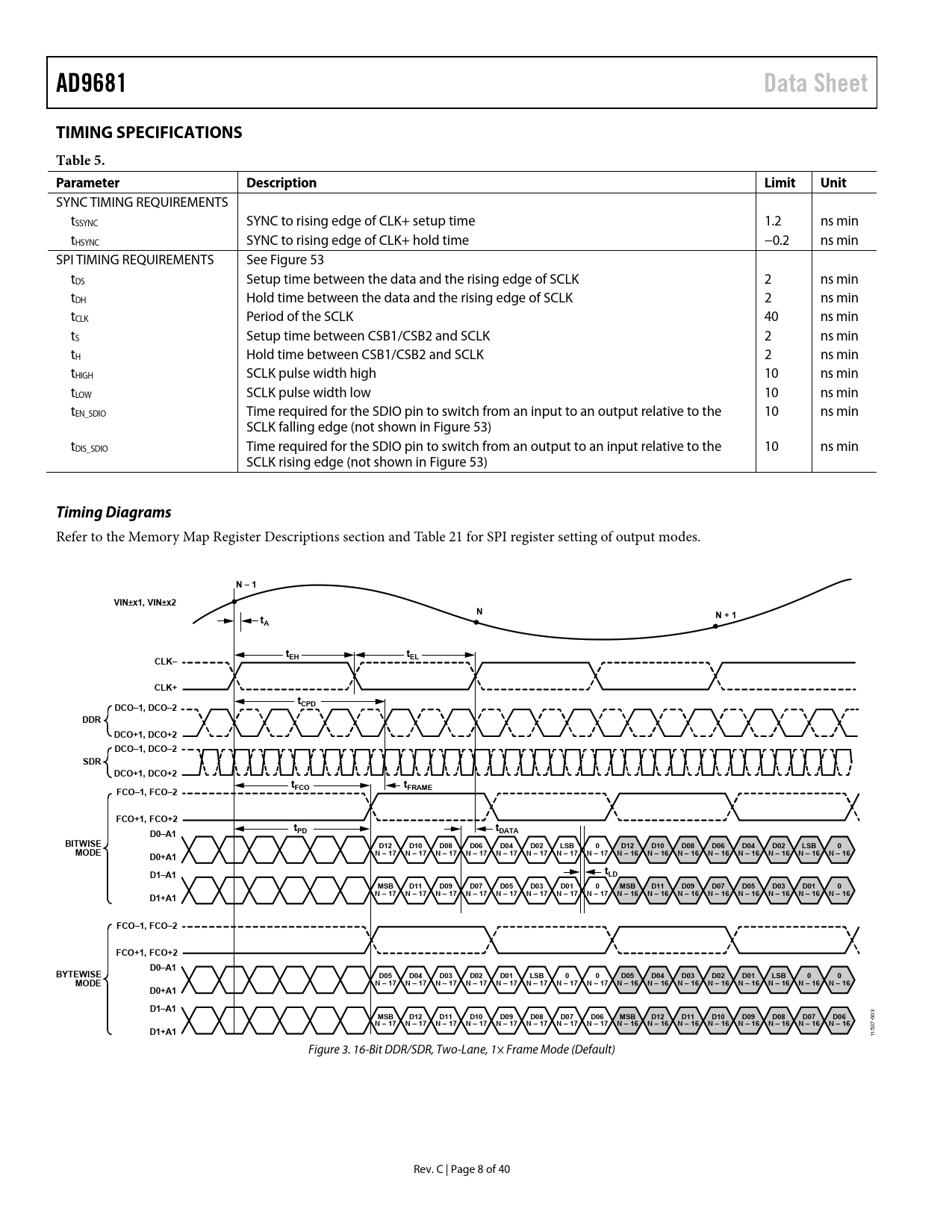

AD9681. Data Sheet. TIMING SPECIFICATIONS. Table 5. Parameter. Description. Limit. Unit. Timing Diagrams. N – 1. VIN±x1, VIN±x2. N + 1. CLK–
AD9681 Data Sheet TIMING SPECIFICATIONS Table 5 Parameter Description Limit Unit Timing Diagrams N – 1 VIN±x1, VIN±x2 N + 1 CLK–
link to page 30 link to page 30 link to page 30 link to page 36 link to page 38
AD9681 Data Sheet TIMING SPECIFICATIONS Table 5. Parameter Description Limit Unit
SYNC TIMING REQUIREMENTS tSSYNC SYNC to rising edge of CLK+ setup time 1.2 ns min tHSYNC SYNC to rising edge of CLK+ hold time −0.2 ns min SPI TIMING REQUIREMENTS See Figure 53 tDS Setup time between the data and the rising edge of SCLK 2 ns min tDH Hold time between the data and the rising edge of SCLK 2 ns min tCLK Period of the SCLK 40 ns min tS Setup time between CSB1/CSB2 and SCLK 2 ns min tH Hold time between CSB1/CSB2 and SCLK 2 ns min tHIGH SCLK pulse width high 10 ns min tLOW SCLK pulse width low 10 ns min tEN_SDIO Time required for the SDIO pin to switch from an input to an output relative to the 10 ns min SCLK falling edge (not shown in Figure 53) tDIS_SDIO Time required for the SDIO pin to switch from an output to an input relative to the 10 ns min SCLK rising edge (not shown in Figure 53)
Timing Diagrams
Refer to the Memory Map Register Descriptions section and Table 21 for SPI register setting of output modes.
N – 1 VIN±x1, VIN±x2 N t N + 1 A t t CLK– EH EL CLK+ t DCO–1, DCO–2 CPD DDR DCO+1, DCO+2 DCO–1, DCO–2 SDR DCO+1, DCO+2 tFCO tFRAME FCO–1, FCO–2 FCO+1, FCO+2 tPD t D0–A1 DATA BITWISE D12 D10 D08 D06 D04 D02 LSB 0 D12 D10 D08 D06 D04 D02 LSB 0 MODE D0+A1 N – 17 N – 17 N – 17 N – 17 N – 17 N – 17 N – 17 N – 17 N – 16 N – 16 N – 16 N – 16 N – 16 N – 16 N – 16 N – 16 D1–A1 tLD MSB D11 D09 D07 D05 D03 D01 0 MSB D11 D09 D07 D05 D03 D01 0 D1+A1 N – 17 N – 17 N – 17 N – 17 N – 17 N – 17 N – 17 N – 17 N – 16 N – 16 N – 16 N – 16 N – 16 N – 16 N – 16 N – 16 FCO–1, FCO–2 FCO+1, FCO+2 D0–A1 BYTEWISE D05 D04 D03 D02 D01 LSB 0 0 D05 D04 D03 D02 D01 LSB 0 0 MODE N – 17 N – 17 N – 17 N – 17 N – 17 N – 17 N – 17 N – 17 N – 16 N – 16 N – 16 N – 16 N – 16 N – 16 N – 16 N – 16 D0+A1 D1–A1 MSB D12 D11 D10 D09 D08 D07 D06 MSB D12 D11 D10 D09 D08 D07 D06
003
N – 17 N – 17 N – 17 N – 17 N – 17 N – 17 N – 17 N – 17 N – 16 N – 16 N – 16 N – 16 N – 16 N – 16 N – 16 N – 16 D1+A1
