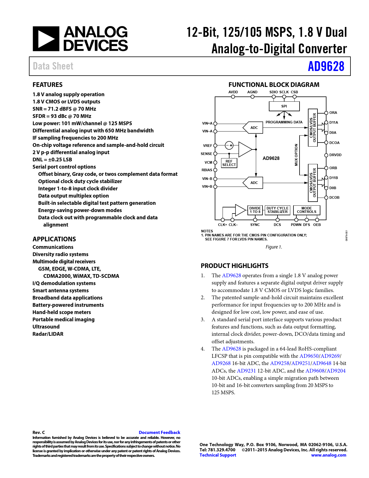

12-Bit, 125/105 MSPS, 1.8 V Dual. Analog-to-Digital Converter. Data Sheet. AD9628. FEATURES. FUNCTIONAL BLOCK DIAGRAM
Datasheet AD9628 Analog Devices, Revision: C
12-Bit, 125/105 MSPS, 1.8 V Dual Analog-to-Digital Converter Data Sheet AD9628 FEATURES FUNCTIONAL BLOCK DIAGRAM 1.8 V analog supply operation AVDD AGND SDIO SCLK CSB 1.8 V CMOS or LVDS outputs SNR = 71.2 dBFS @ 70 MHz SPI ORA SFDR = 93 dBc @ 70 MHz R Low power: 101 mW/channel @ 125 MSPS FFE VIN+A PROGRAMMING DATA U D11A LVDS Differential analog input with 650 MHz bandwidth ADC S/ VIN–A T B U D0A MO IF sampling frequencies to 200 MHz C TPOU On-chip voltage reference and sample-and-hold circuit DCOA VREF 2 V p-p differential analog input TION SENSE DRVDD DNL = ±0.25 LSB AD9628 X OP VCM REF U Serial port control options SELECT M RBIAS ORB R Offset binary, Gray code, or twos complement data format FFE U D11B Optional clock duty cycle stabilizer VIN–B ADC LVDS S/ T B Integer 1-to-8 input clock divider VIN+B U D0B MO C TP Data output multiplex option OU DCOB Built-in selectable digital test pattern generation Energy-saving power-down modes DIVIDE DUTY CYCLE MODE 1 TO 8 STABILIZER CONTROLS Data clock out with programmable clock and data alignment CLK+ CLK– SYNC DCS PDWN DFS OEB NOTES 1. PIN NAMES ARE FOR THE CMOS PIN CONFIGURATION ONLY;

APPLICATIONS SEE FIGURE 7 FOR LVDS PIN NAMES.

Figure 1.
Diversity radio systems Multimode digital receivers GSM, EDGE, W-CDMA, LTE, PRODUCT HIGHLIGHTS CDMA2000, WiMAX, TD-SCDMA
1. The AD9628 operates from a single 1.8 V analog power
I/Q demodulation systems
supply and features a separate digital output driver supply
Smart antenna systems
to accommodate 1.8 V CMOS or LVDS logic families.
Broadband data applications
2. The patented sample-and-hold circuit maintains excel ent
Battery-powered instruments
performance for input frequencies up to 200 MHz and is
Hand-held scope meters
designed for low cost, low power, and ease of use.
Portable medical imaging
3. A standard serial port interface supports various product
Ultrasound
features and functions, such as data output formatting,
Radar/LIDAR
internal clock divider, power-down, DCO/data timing and offset adjustments. 4. The AD9628 is packaged in a 64-lead RoHS-compliant LFCSP that is pin compatible with the AD9650/AD9269/ AD9268 16-bit ADC, the AD9258/AD9251/AD9648 14-bit ADCs, the AD9231 12-bit ADC, and the AD9608/AD9204 10-bit ADCs, enabling a simple migration path between 10-bit and 16-bit converters sampling from 20 MSPS to 125 MSPS.
