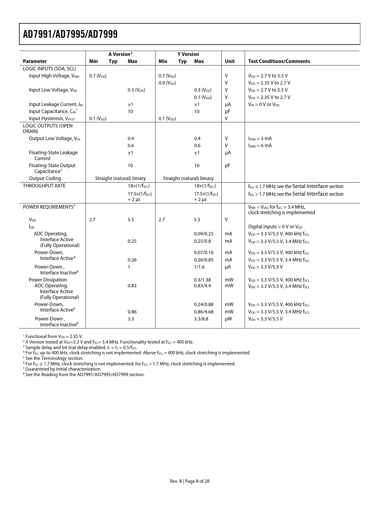

AD7991/AD7995/AD7999 A Version2 Y Version Parameter Min Typ Max Min Typ Max Unit Test Conditions/Comments
LOGIC INPUTS (SDA, SCL) Input High Voltage, VINH 0.7 (VDD) 0.7 (VDD) V VDD = 2.7 V to 5.5 V 0.9 (VDD) V VDD = 2.35 V to 2.7 V Input Low Voltage, VINL 0.3 (VDD) 0.3 (VDD) V VDD = 2.7 V to 5.5 V 0.1 (VDD) V VDD = 2.35 V to 2.7 V Input Leakage Current, IIN ±1 ±1 μA VIN = 0 V or VDD Input Capacitance, C 7 IN 10 10 pF Input Hysteresis, VHYST 0.1 (VDD) 0.1 (VDD) V LOGIC OUTPUTS (OPEN DRAIN) Output Low Voltage, VOL 0.4 0.4 V ISINK = 3 mA 0.6 0.6 V ISINK = 6 mA Floating-State Leakage ±1 ±1 μA Current Floating-State Output 10 10 pF Capacitance7 Output Coding Straight (natural) binary Straight (natural) binary THROUGHPUT RATE 18×(1/fSCL) 18×(1/fSCL) fSCL ≤ 1.7 MHz; see the Serial Interface section 17.5×(1/fSCL) 17.5×(1/fSCL) fSCL > 1.7 MHz; see the Serial Interface section + 2 μs + 2 μs POWER REQUIREMENTS3 VREF = VDD; for fSCL = 3.4 MHz, clock stretching is implemented VDD 2.7 5.5 2.7 5.5 V IDD Digital inputs = 0 V or VDD ADC Operating, 0.09/0.25 mA VDD = 3.3 V/5.5 V, 400 kHz fSCL Interface Active 0.25 0.25/0.8 mA VDD = 3.3 V/5.5 V, 3.4 MHz fSCL (Fully Operational) Power-Down, 0.07/0.16 mA VDD = 3.3 V/5.5 V, 400 kHz fSCL Interface Active8 0.26 0.26/0.85 mA VDD = 3.3 V/5.5 V, 3.4 MHz fSCL Power-Down , 1 1/1.6 μA VDD = 3.3 V/5.5 V Interface Inactive8 Power Dissipation 0.3/1.38 mW VDD = 3.3 V/5.5 V, 400 kHz fSCL ADC Operating, 0.83 0.83/4.4 mW VDD = 3.3 V/5.5 V, 3.4 MHz fSCL Interface Active (Fully Operational) Power-Down, 0.24/0.88 mW VDD = 3.3 V/5.5 V, 400 kHz fSCL Interface Active8 0.86 0.86/4.68 mW VDD = 3.3 V/5.5 V, 3.4 MHz fSCL Power-Down , 3.3 3.3/8.8 μW VDD = 3.3 V/5.5 V Interface Inactive8 1 Functional from VDD = 2.35 V. 2 A Version tested at VDD=3.3 V and fSCL= 3.4 MHz. Functionality tested at fSCL = 400 kHz. 3 Sample delay and bit trial delay enabled, t1 = t2 = 0.5/fSCL. 4 For fSCL up to 400 kHz, clock stretching is not implemented. Above fSCL = 400 kHz, clock stretching is implemented. 5 See the Terminology section. 6 For fSCL ≤ 1.7 MHz, clock stretching is not implemented; for fSCL > 1.7 MHz, clock stretching is implemented. 7 Guaranteed by initial characterization. 8 See the Reading from the AD7991/AD7995/AD7999 section. Rev. B | Page 8 of 28 Document Outline FEATURES APPLICATIONS FUNCTIONAL BLOCK DIAGRAM GENERAL DESCRIPTION PRODUCT HIGHLIGHTS TABLE OF CONTENTS REVISION HISTORY SPECIFICATIONS AD7991 AD7995 AD7999 I2C TIMING SPECIFICATIONS ABSOLUTE MAXIMUM RATINGS ESD CAUTION PIN CONFIGURATION AND FUNCTION DESCRIPTIONS TYPICAL PERFORMANCE CHARACTERISTICS TERMINOLOGY THEORY OF OPERATION CONVERTER OPERATION ADC Transfer Function TYPICAL CONNECTION DIAGRAM ANALOG INPUT INTERNAL REGISTER STRUCTURE CONFIGURATION REGISTER SAMPLE DELAY AND BIT TRIAL DELAY CONVERSION RESULT REGISTER SERIAL INTERFACE SERIAL BUS ADDRESS WRITING TO THE AD7991/AD7995/AD7999 READING FROM THE AD7991/AD7995/AD7999 PLACING THE AD7991/AD7995/AD7999 INTO HIGH SPEED MODE MODE OF OPERATION OUTLINE DIMENSIONS ORDERING GUIDE
