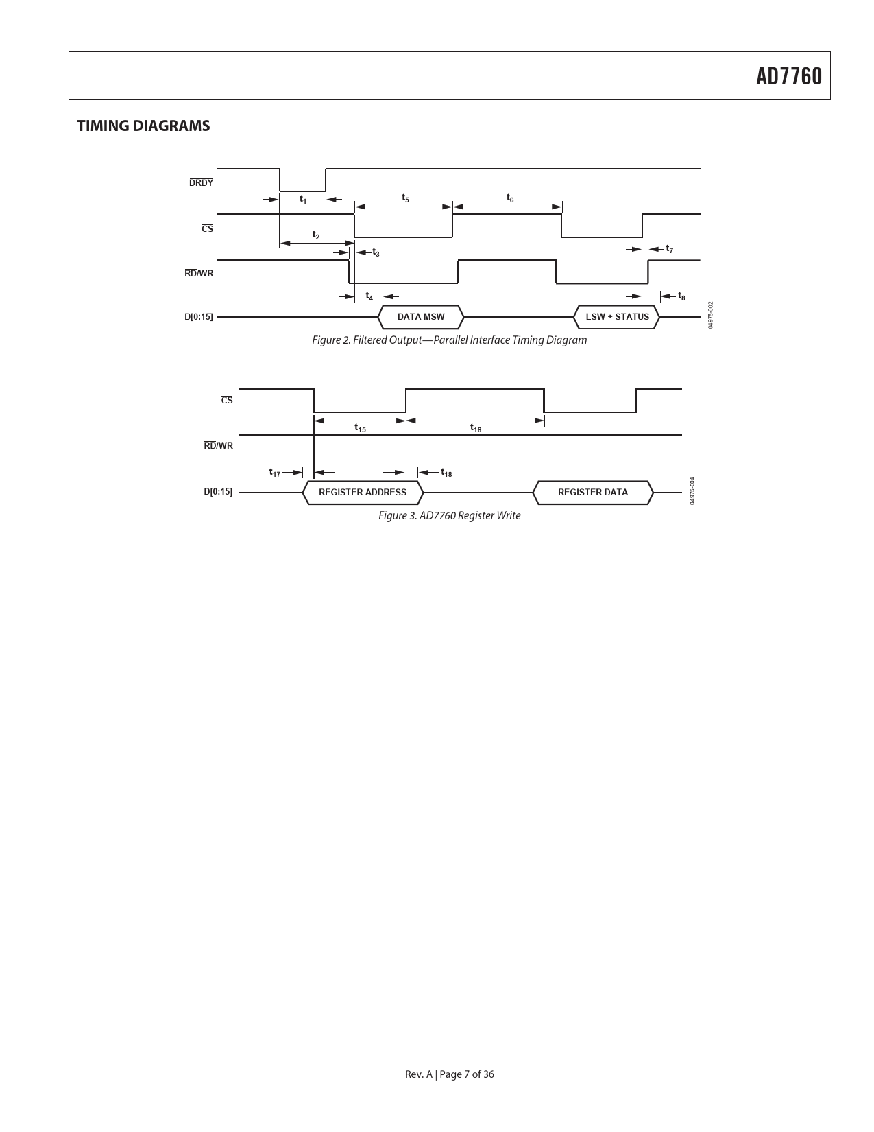

TIMING DIAGRAMS. DRDY. RD/WR. D[0:15]. DATA MSW. LSW + STATUS. t15. t16. t17. t18. REGISTER ADDRESS. REGISTER DATA
![TIMING DIAGRAMS DRDY RD/WR D[0:15] DATA MSW LSW + STATUS t15 t16 t17 t18 REGISTER ADDRESS REGISTER DATA](https://www.rlocman.ru/datasheet/img.php?di=125359&p=7)
AD7760
TIMING DIAGRAMS DRDY t t 1 5 t6 CS t2 t t 7 3 RD/WR t t 4 8
2 0 -0
5 7 9 4 0 Figure 2. Filtered Output—Parallel Interface Timing Diagram
CS t15 t16 RD/WR t17 t18
4 0 -0
D[0:15] REGISTER ADDRESS REGISTER DATA
5 7 9 4 0 Figure 3. AD7760 Register Write Rev. A | Page 7 of 36
