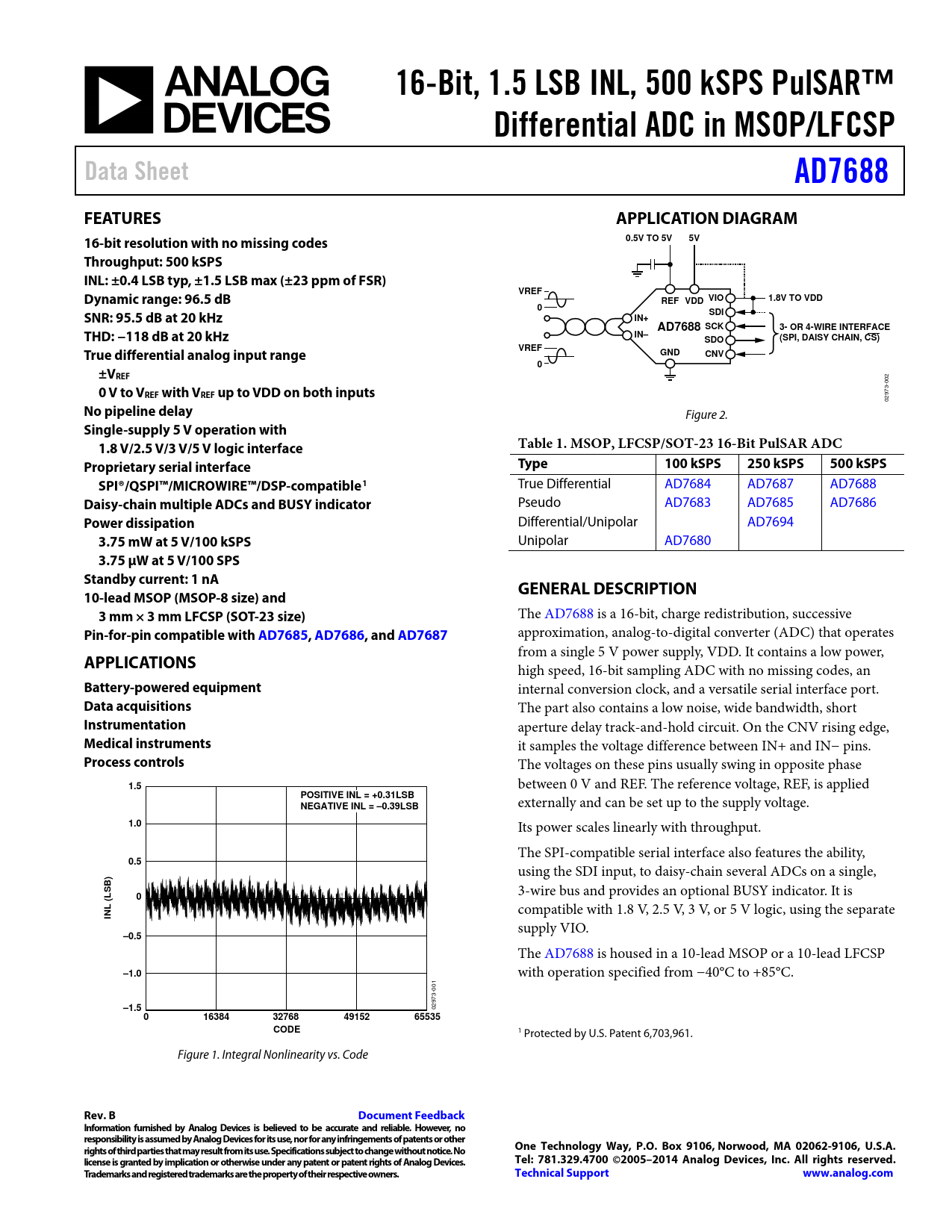

16-Bit, 1.5 LSB INL, 500 kSPS PulSAR™. Differential ADC in MSOP/LFCSP. Data Sheet. AD7688. FEATURES. APPLICATION DIAGRAM
Datasheet AD7688 Analog Devices, Revision: B
link to page 1
16-Bit, 1.5 LSB INL, 500 kSPS PulSAR™ Differential ADC in MSOP/LFCSP Data Sheet AD7688 FEATURES APPLICATION DIAGRAM 16-bit resolution with no missing codes 0.5V TO 5V 5V Throughput: 500 kSPS INL: ±0.4 LSB typ, ±1.5 LSB max (±23 ppm of FSR) Dynamic range: 96.5 dB VREF REF VDD VIO 1.8V TO VDD 0 SNR: 95.5 dB at 20 kHz SDI IN+ AD7688 SCK 3- OR 4-WIRE INTERFACE THD: −118 dB at 20 kHz IN– SDO (SPI, DAISY CHAIN, CS) True differential analog input range VREF GND CNV 0 ±VREF 0 V to VREF with VREF up to VDD on both inputs
02973-002
No pipeline delay
Figure 2.
Single-supply 5 V operation with 1.8 V/2.5 V/3 V/5 V logic interface Table 1. MSOP, LFCSP/SOT-23 16-Bit PulSAR ADC Proprietary serial interface Type 100 kSPS 250 kSPS 500 kSPS SPI®/QSPI™/MICROWIRE™/DSP-compatible1
True Differential AD7684 AD7687 AD7688
Daisy-chain multiple ADCs and BUSY indicator
Pseudo AD7683 AD7685 AD7686
Power dissipation
Differential/Unipolar AD7694
3.75 mW at 5 V/100 kSPS
Unipolar AD7680
3.75 µW at 5 V/100 SPS Standby current: 1 nA GENERAL DESCRIPTION 10-lead MSOP (MSOP-8 size) and 3 mm × 3 mm LFCSP (SOT-23 size)
The AD7688 is a 16-bit, charge redistribution, successive
Pin-for-pin compatible with AD7685, AD7686, and AD7687
approximation, analog-to-digital converter (ADC) that operates from a single 5 V power supply, VDD. It contains a low power,
APPLICATIONS
high speed, 16-bit sampling ADC with no missing codes, an
Battery-powered equipment
internal conversion clock, and a versatile serial interface port.
Data acquisitions
The part also contains a low noise, wide bandwidth, short
Instrumentation
aperture delay track-and-hold circuit. On the CNV rising edge,
Medical instruments
it samples the voltage difference between IN+ and IN− pins.
Process controls
The voltages on these pins usually swing in opposite phase
1.5
between 0 V and REF. The reference voltage, REF, is applied
POSITIVE INL = +0.31LSB NEGATIVE INL = –0.39LSB
externally and can be set up to the supply voltage.
1.0
Its power scales linearly with throughput. The SPI-compatible serial interface also features the ability,
0.5
using the SDI input, to daisy-chain several ADCs on a single, 3-wire bus and provides an optional BUSY indicator. It is
0
compatible with 1.8 V, 2.5 V, 3 V, or 5 V logic, using the separate
INL (LSB)
supply VIO.
–0.5
The AD7688 is housed in a 10-lead MSOP or a 10-lead LFCSP
–1.0
with operation specified from −40°C to +85°C.
–1.5
02973-001
0 16384 32768 49152 65535 CODE
1 Protected by U.S. Patent 6,703,961. Figure 1. Integral Nonlinearity vs. Code
