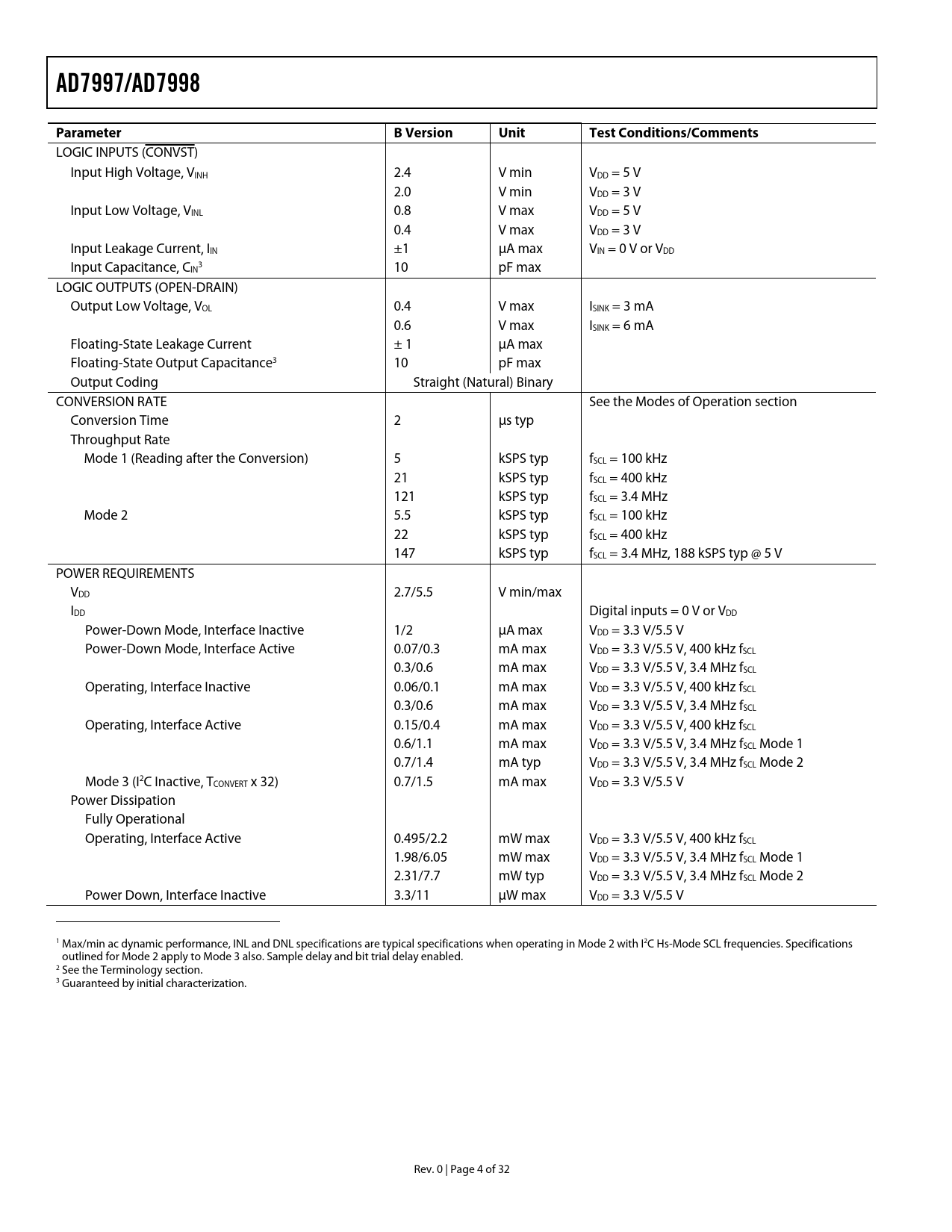

LOGIC INPUTS (CONVST) Input High Voltage, VINH 2.4 V min VDD = 5 V 2.0 V min VDD = 3 V Input Low Voltage, VINL 0.8 V max VDD = 5 V 0.4 V max VDD = 3 V Input Leakage Current, IIN ±1 µA max VIN = 0 V or VDD Input Capacitance, C 3 IN 10 pF max LOGIC OUTPUTS (OPEN-DRAIN) Output Low Voltage, VOL 0.4 V max ISINK = 3 mA 0.6 V max ISINK = 6 mA Floating-State Leakage Current ± 1 µA max Floating-State Output Capacitance3 10 pF max Output Coding Straight (Natural) Binary CONVERSION RATE See the Modes of Operation section Conversion Time 2 µs typ Throughput Rate Mode 1 (Reading after the Conversion) 5 kSPS typ fSCL = 100 kHz 21 kSPS typ fSCL = 400 kHz 121 kSPS typ fSCL = 3.4 MHz Mode 2 5.5 kSPS typ fSCL = 100 kHz 22 kSPS typ fSCL = 400 kHz 147 kSPS typ fSCL = 3.4 MHz, 188 kSPS typ @ 5 V POWER REQUIREMENTS VDD 2.7/5.5 V min/max IDD Digital inputs = 0 V or VDD Power-Down Mode, Interface Inactive 1/2 µA max VDD = 3.3 V/5.5 V Power-Down Mode, Interface Active 0.07/0.3 mA max VDD = 3.3 V/5.5 V, 400 kHz fSCL 0.3/0.6 mA max VDD = 3.3 V/5.5 V, 3.4 MHz fSCL Operating, Interface Inactive 0.06/0.1 mA max VDD = 3.3 V/5.5 V, 400 kHz fSCL 0.3/0.6 mA max VDD = 3.3 V/5.5 V, 3.4 MHz fSCL Operating, Interface Active 0.15/0.4 mA max VDD = 3.3 V/5.5 V, 400 kHz fSCL 0.6/1.1 mA max VDD = 3.3 V/5.5 V, 3.4 MHz fSCL Mode 1 0.7/1.4 mA typ VDD = 3.3 V/5.5 V, 3.4 MHz fSCL Mode 2 Mode 3 (I2C Inactive, TCONVERT x 32) 0.7/1.5 mA max VDD = 3.3 V/5.5 V Power Dissipation Fully Operational Operating, Interface Active 0.495/2.2 mW max VDD = 3.3 V/5.5 V, 400 kHz fSCL 1.98/6.05 mW max VDD = 3.3 V/5.5 V, 3.4 MHz fSCL Mode 1 2.31/7.7 mW typ VDD = 3.3 V/5.5 V, 3.4 MHz fSCL Mode 2 Power Down, Interface Inactive 3.3/11 µW max VDD = 3.3 V/5.5 V 1 Max/min ac dynamic performance, INL and DNL specifications are typical specifications when operating in Mode 2 with I2C Hs-Mode SCL frequencies. Specifications outlined for Mode 2 apply to Mode 3 also. Sample delay and bit trial delay enabled. 2 See the Terminology section. 3 Guaranteed by initial characterization. Rev. 0 | Page 4 of 32 Document Outline FEATURES GENERAL DESCRIPTION FUNCTIONAL BLOCK DIAGRAM PRODUCT HIGHLIGHTS AD7997 SPECIFICATIONS AD7998 SPECIFICATIONS I2C TIMING SPECIFICATIONS ABSOLUTE MAXIMUM RATINGS ESD CAUTION PIN CONFIGURATION AND PIN FUNCTION DESCRIPTIONS TERMINOLOGY TYPICAL PERFORMANCE CHARACTERISTICS CIRCUIT INFORMATION CONVERTER OPERATION TYPICAL CONNECTION DIAGRAM ANALOG INPUT INTERNAL REGISTER STRUCTURE ADDRESS POINTER REGISTER CONFIGURATION REGISTER CONVERSION RESULT REGISTER LIMIT REGISTERS DATAHIGH Register CH1/CH2/CH3/CH4 DATALOW Register CH1/CH2/CH3/CH4 Hysteresis Register (CH1/CH2/CH3/CH4) Using the Limit Registers to Store Min/Max Conversion Result ALERT STATUS REGISTER (CH1 TO CH4) CYCLE TIMER REGISTER SAMPLE DELAY AND BIT TRIAL DELAY SERIAL INTERFACE SERIAL BUS ADDRESS WRITING TO THE AD7997/AD7998 WRITING TO THE ADDRESS POINTER REGISTER FOR A SUBSEQUENT REA WRITING A SINGLE BYTE OF DATA TO THE ALERT STATUS REGISTER O WRITING TWO BYTES OF DATA TO A LIMIT, HYSTERESIS, OR CONFIGU READING DATA FROM THE AD7997/AD7998 ALERT/BUSY PIN SMBus ALERT BUSY PLACING THE AD7997-1/AD7998-1 INTOHIGH SPEED MODE THE ADDRESS SELECT (AS) PIN MODES OF OPERATION MODE 1—USING THE PIN MODE 2 – COMMAND MODE MODE 3—AUTOMATIC CYCLE INTERVAL MODE OUTLINE DIMENSIONS ORDERING GUIDE RELATED PARTS IN I2C-COMPATIBLE ADC PRODUCT FAMILY
