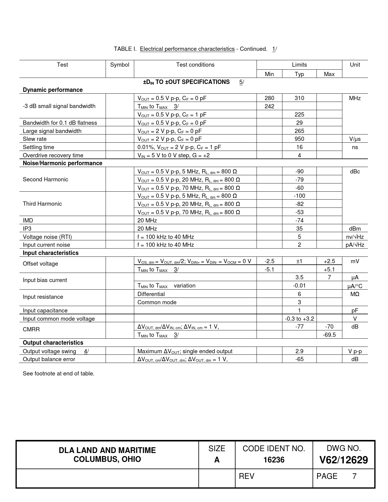

±DIN TO ±OUT SPECIFICATIONS. Dynamic performance. Noise/Harmonic performance. Input characteristics. Output characteristics
TABLE I. Electrical performance characteristics - Continued. 1/ Test Symbol Test conditions Limits Unit Min Typ Max
5/
Dynamic performance
VOUT = 0.5 V p-p, CF = 0 pF 280 310 MHz -3 dB small signal bandwidth TMIN to TMAX 3/ 242 VOUT = 0.5 V p-p, CF = 1 pF 225 Bandwidth for 0.1 dB flatness VOUT = 0.5 V p-p, CF = 0 pF 29 Large signal bandwidth VOUT = 2 V p-p, CF = 0 pF 265 Slew rate VOUT = 2 V p-p, CF = 0 pF 950 V/µs Settling time 0.01%, VOUT = 2 V p-p, CF = 1 pF 16 ns Overdrive recovery time VIN = 5 V to 0 V step, G = +2 4
VOUT = 0.5 V p-p, 5 MHz, RL, dm = 800 Ω -90 dBc Second Harmonic VOUT = 0.5 V p-p, 20 MHz, RL, dm = 800 Ω -79 VOUT = 0.5 V p-p, 70 MHz, RL, dm = 800 Ω -60 VOUT = 0.5 V p-p, 5 MHz, RL, dm = 800 Ω -100 Third Harmonic VOUT = 0.5 V p-p, 20 MHz, RL, dm = 800 Ω -82 VOUT = 0.5 V p-p, 70 MHz, RL, dm = 800 Ω -53 IMD 20 MHz -74 IP3 20 MHz 35 dBm Voltage noise (RTI) f = 100 kHz to 40 MHz 5 nv/√Hz Input current noise f = 100 kHz to 40 MHz 2 pA/√Hz
Offset voltage VOS, dm = VOUT, dm/2; VDIN+ = VDIN- = VOCM = 0 V -2.5 ±1 +2.5 mV TMIN to TMAX 3/ -5.1 +5.1 Input bias current 3.5 7 µA TMIN to TMAX variation -0.01 µA/°C Input resistance Differential 6 MΩ Common mode 3 Input capacitance 1 pF Input common mode voltage -0.3 to +3.2 V CMRR ΔVOUT, dm/ΔVIN, cm; ΔVIN, cm = 1 V, -77 -70 dB TMIN to TMAX 3/ -69.5
Output voltage swing 4/ Maximum ΔVOUT; single ended output 2.9 V p-p Output balance error ΔVOUT, cm/ΔVOUT, dm; ΔVOUT, dm = 1 V, -65 dB See footnote at end of table.
