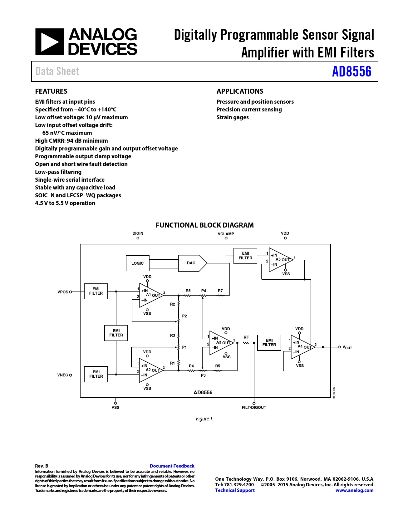

Digital y Programmable Sensor Signal. Amplifier with EMI Filters. Data Sheet. AD8556. FEATURES. APPLICATIONS
Digital y Programmable Sensor Signal Amplifier with EMI Filters Data Sheet AD8556 FEATURES APPLICATIONS EMI filters at input pins Pressure and position sensors Specified from −40°C to +140°C Precision current sensing Low offset voltage: 10 µV maximum Strain gages Low input offset voltage drift: 65 nV/°C maximum High CMRR: 94 dB minimum Digitally programmable gain and output offset voltage Programmable output clamp voltage Open and short wire fault detection Low-pass filtering Single-wire serial interface Stable with any capacitive load SOIC_N and LFCSP_WQ packages 4.5 V to 5.5 V operation FUNCTIONAL BLOCK DIAGRAM DIGIN VCLAMP VDD EMI 1 +IN FILTER 3 A5 2 OUT LOGIC DAC –IN VSS VDD EMI 1 +IN R5 P4 R7 VPOS 3 FILTER A1 2 OUT –IN R2 VSS P2 VDD VDD EMI FILTER R3 1 +IN RF 3 EMI A3 1 +IN 2 OUT FILTER 3 P1 –IN A4 2 OUT VOUT VDD –IN VSS 1 R1 +IN R4 R5 VSS 3 A2 EMI 2 OUT VNEG –IN P3 FILTER VSS AD8556
05448-053
VSS FILT/DIGOUT
Figure 1.
