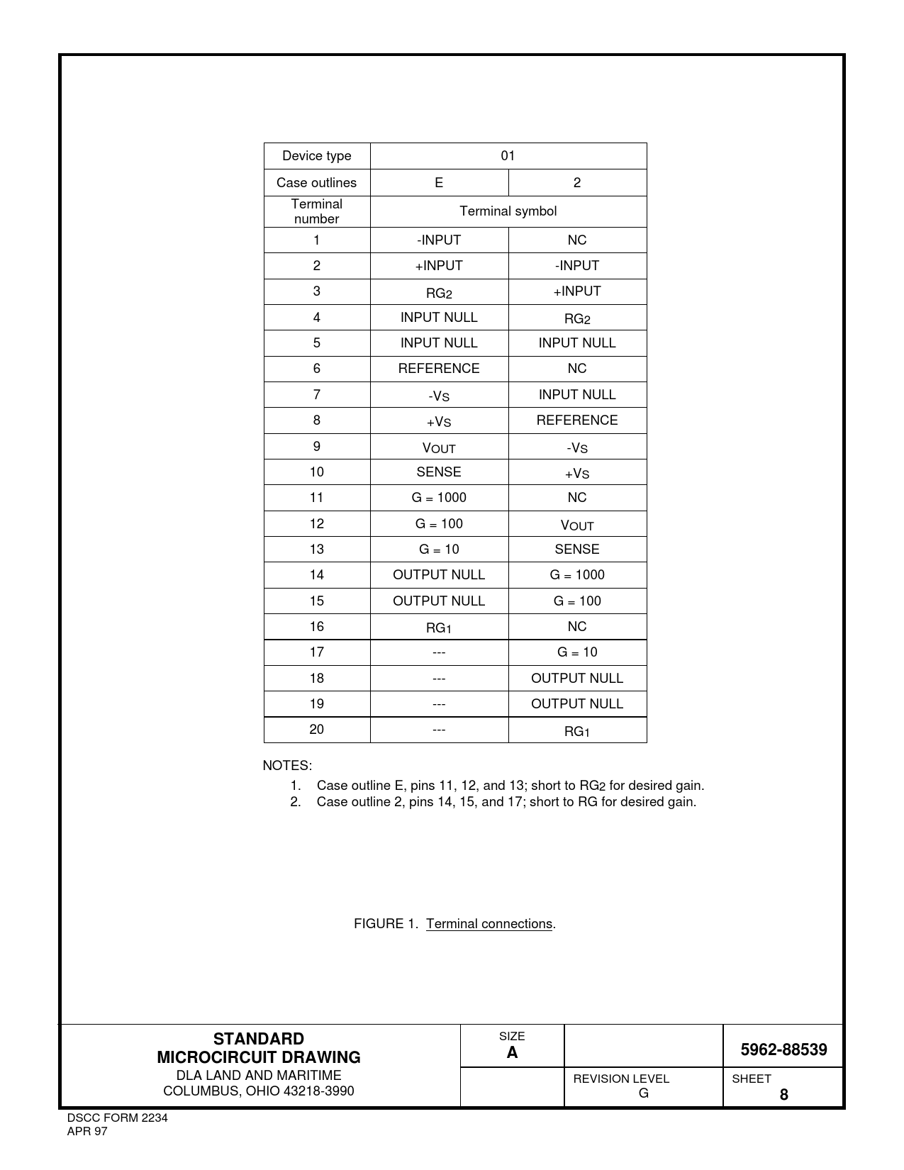

STANDARD. 5962-88539. MICROCIRCUIT DRAWING
STANDARD 5962-88539 MICROCIRCUIT DRAWING
Device type 01 Case outlines E 2 Terminal Terminal symbol number 1 -INPUT NC 2 +INPUT -INPUT 3 RG2 +INPUT 4 INPUT NULL RG2 5 INPUT NULL INPUT NULL 6 REFERENCE NC 7 -VS INPUT NULL 8 +VS REFERENCE 9 VOUT -VS 10 SENSE +VS 11 G = 1000 NC 12 G = 100 VOUT 13 G = 10 SENSE 14 OUTPUT NULL G = 1000 15 OUTPUT NULL G = 100 16 RG1 NC 17 --- G = 10 18 --- OUTPUT NULL 19 --- OUTPUT NULL 20 --- RG1 NOTES: 1. Case outline E, pins 11, 12, and 13; short to RG2 for desired gain. 2. Case outline 2, pins 14, 15, and 17; short to RG for desired gain. FIGURE 1. Terminal connections.
STANDARD
SIZE
5962-88539 MICROCIRCUIT DRAWING A
DLA LAND AND MARITIME REVISION LEVEL SHEET COLUMBUS, OHIO 43218-3990 G
8
DSCC FORM 2234 APR 97
