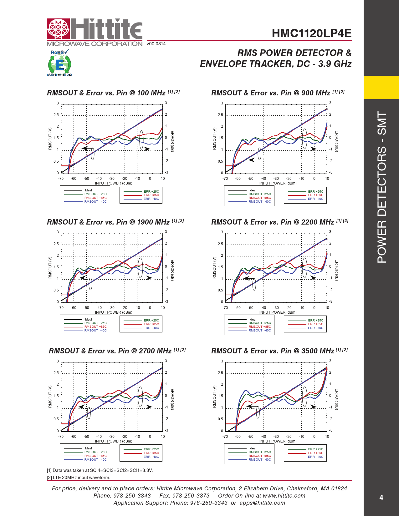

HMC1120LP4E. RMS POWER DETECTOR &. ENVELOPE TRACKER, DC - 3.9 GHz. RMSOUT & Error vs. Pin @ 100 MHz [1] [2]
![HMC1120LP4E RMS POWER DETECTOR & ENVELOPE TRACKER, DC - 3.9 GHz RMSOUT & Error vs Pin @ 100 MHz [1] [2]](https://www.rlocman.ru/datasheet/img.php?di=126397&p=6)
HMC1120LP4E
v00.0814
RMS POWER DETECTOR & ENVELOPE TRACKER, DC - 3.9 GHz RMSOUT & Error vs. Pin @ 100 MHz [1] [2] RMSOUT & Error vs. Pin @ 900 MHz [1] [2]
3 3 3 3 2.5 2 2.5 2 T 2 1 2 1 M ERROR (dB) ERROR (dB) 1.5 0 1.5 0 S - RMSOUT (V) 1 -1 RMSOUT (V) 1 -1 0.5 -2 0.5 -2 RS O 0 -3 0 -3 -70 -60 -50 -40 -30 -20 -10 0 10 -70 -60 -50 -40 -30 -20 -10 0 10 T INPUT POWER (dBm) INPUT POWER (dBm) C Ideal ERR +25C Ideal ERR +25C RMSOUT +25C RMSOUT +25C E ERR +85C ERR +85C RMSOUT +85C ERR -40C RMSOUT +85C ERR -40C RMSOUT -40C RMSOUT -40C T E D
RMSOUT & Error vs. Pin @ 1900 MHz [1] [2] RMSOUT & Error vs. Pin @ 2200 MHz [1] [2]
R 3 3 3 3 E 2.5 2 2.5 2 W 2 1 2 1 O ERROR (dB) ERROR (dB) P 1.5 0 1.5 0 RMSOUT (V) 1 -1 RMSOUT (V) 1 -1 0.5 -2 0.5 -2 0 -3 0 -3 -70 -60 -50 -40 -30 -20 -10 0 10 -70 -60 -50 -40 -30 -20 -10 0 10 INPUT POWER (dBm) INPUT POWER (dBm) Ideal ERR +25C Ideal ERR +25C RMSOUT +25C ERR +85C RMSOUT +25C ERR +85C RMSOUT +85C ERR -40C RMSOUT +85C ERR -40C RMSOUT -40C RMSOUT -40C
RMSOUT & Error vs. Pin @ 2700 MHz [1] [2] RMSOUT & Error vs. Pin @ 3500 MHz [1] [2]
3 3 3 3 2.5 2 2.5 2 2 1 2 1 ERROR (dB) ERROR (dB) 1.5 0 1.5 0 RMSOUT (V) 1 -1 RMSOUT (V) 1 -1 0.5 -2 0.5 -2 0 -3 0 -3 -70 -60 -50 -40 -30 -20 -10 0 10 -70 -60 -50 -40 -30 -20 -10 0 10 INPUT POWER (dBm) INPUT POWER (dBm) Ideal ERR +25C Ideal ERR +25C RMSOUT +25C ERR +85C RMSOUT +25C ERR +85C RMSOUT +85C ERR -40C RMSOUT +85C ERR -40C RMSOUT -40C RMSOUT -40C [1] Data was taken at SCI4=SCI3=SCI2=SCI1=3.3V. [2] LTE 20MHz input waveform. For price, delivery and to place orders: Hittite Microwave Corporation, 2 Elizabeth Drive, Chelmsford, MA 01824 Phone: 978-250-3343 Fax: 978-250-3373 Order On-line at www.hittite.com
