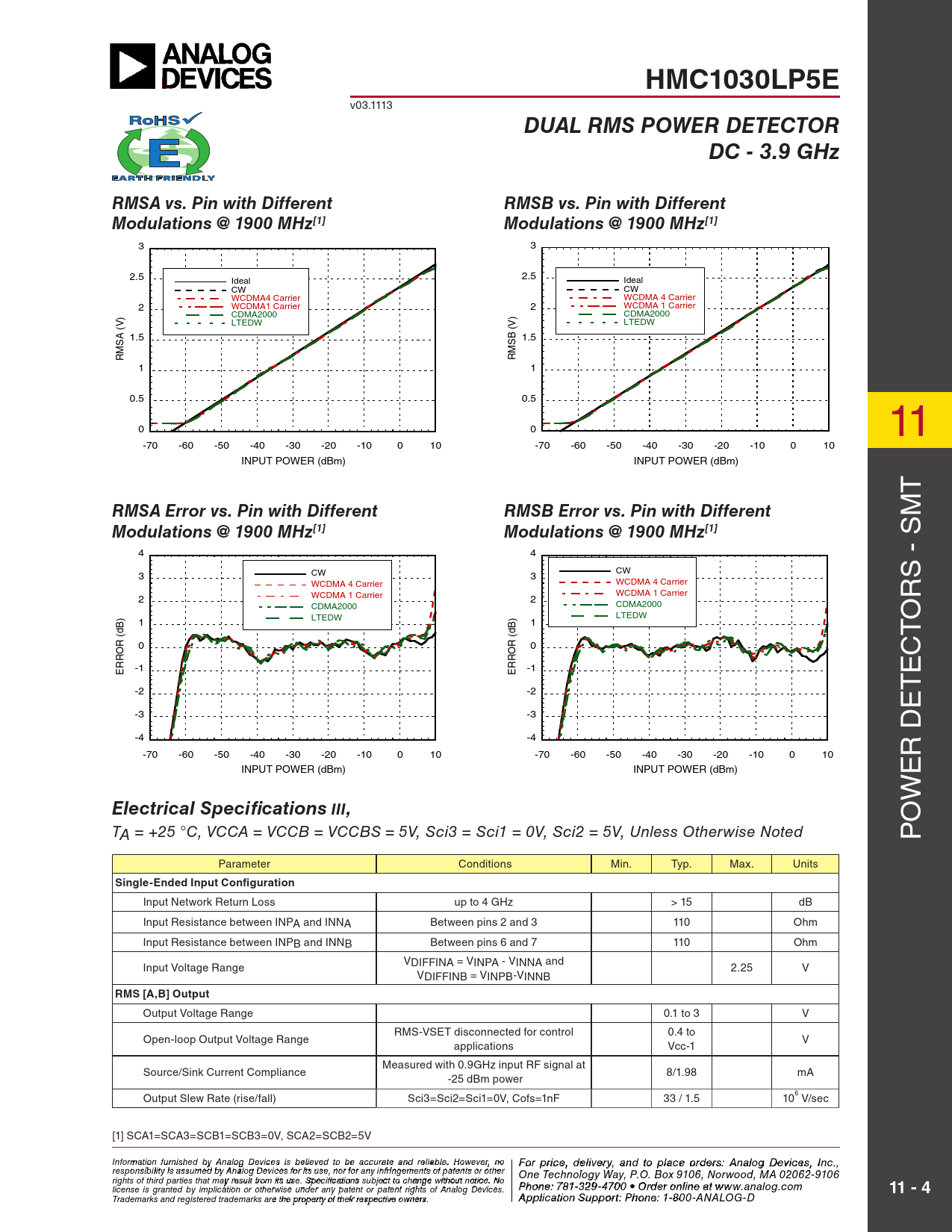

HMC1030LP5E. DUAL RMS POWER DETECTOR. DC - 3.9 GHz. RMSA vs. Pin with Different. RMSB vs. Pin with Different
HMC1030LP5E DUAL RMS POWER DETECTOR DC - 3.9 GHz RMSA vs Pin with Different RMSB vs Pin with Different
HMC1030LP5E
v03.1113
DUAL RMS POWER DETECTOR DC - 3.9 GHz RMSA vs. Pin with Different RMSB vs. Pin with Different Modulations @ 1900 MHz[1] Modulations @ 1900 MHz[1]
3 3 2.5 2.5 Ideal Ideal CW CW WCDMA4 Carrier WCDMA 4 Carrier 2 WCDMA1 Carrier 2 WCDMA 1 Carrier CDMA2000 CDMA2000 LTEDW LTEDW 1.5 1.5 RMSA (V) RMSB (V) 1 1 0.5 0.5 0 0 11 -70 -60 -50 -40 -30 -20 -10 0 10 -70 -60 -50 -40 -30 -20 -10 0 10 INPUT POWER (dBm) INPUT POWER (dBm) T
RMSA Error vs. Pin with Different RMSB Error vs. Pin with Different
M
S 4 4 - CW 3 CW 3 WCDMA 4 Carrier WCDMA 4 Carrier WCDMA 1 Carrier 2 WCDMA 1 Carrier 2 RS CDMA2000 CDMA2000 LTEDW 1 LTEDW 1 O T 0 0 C -1 ERROR (dB) -1 ERROR (dB) -2 -2 TE E -3 -3 -4 -4 D -70 -60 -50 -40 -30 -20 -10 0 10 -70 -60 -50 -40 -30 -20 -10 0 10 R INPUT POWER (dBm) INPUT POWER (dBm) WE
Electrical Specifications III,
O TA = +25 °C, VCCA = VCCB = VCCBS = 5V, Sci3 = Sci1 = 0V, Sci2 = 5V, Unless Otherwise Noted P Parameter Conditions Min. Typ. Max. Units
Single-Ended Input Configuration
Input Network Return Loss up to 4 GHz > 15 dB Input Resistance between INPA and INNA Between pins 2 and 3 110 Ohm Input Resistance between INPB and INNB Between pins 6 and 7 110 Ohm V Input Voltage Range DIFFINA = VINPA - VINNA and 2.25 V VDIFFINB = VINPB-VINNB
