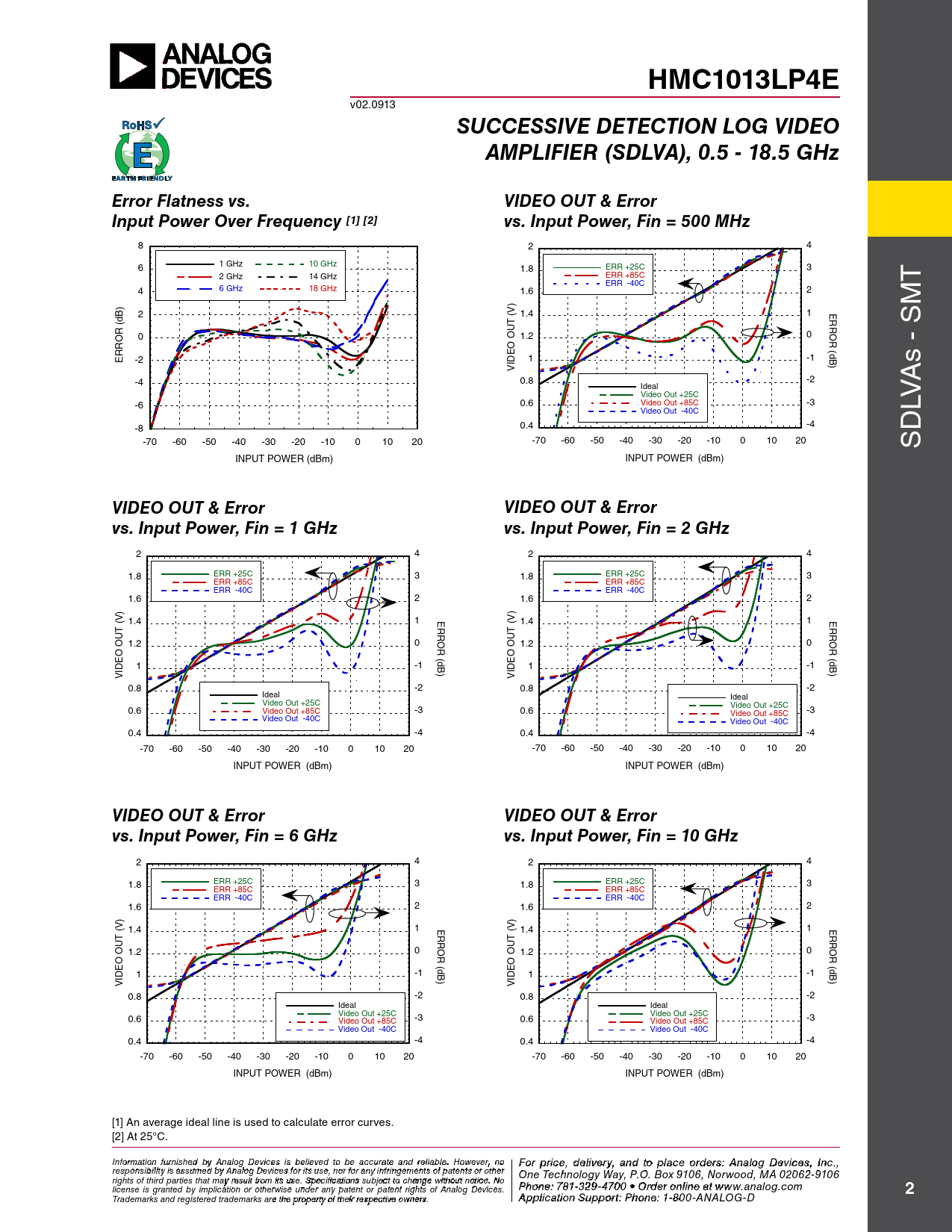

HMC1013LP4E. SUCCESSIVE DETECTION LOG VIDEO. AMPLIFIER (SDLVA), 0.5 - 18.5 GHz. Error Flatness vs. VIDEO OUT & Error
HMC1013LP4E SUCCESSIVE DETECTION LOG VIDEO AMPLIFIER (SDLVA), 0.5 - 18.5 GHz Error Flatness vs VIDEO OUT & Error
HMC1013LP4E
v02.0913
SUCCESSIVE DETECTION LOG VIDEO AMPLIFIER (SDLVA), 0.5 - 18.5 GHz Error Flatness vs. VIDEO OUT & Error Input Power Over Frequency [1] [2] vs. Input Power, Fin = 500 MHz
8 2 4 6 1 GHz 10 GHz 1.8 ERR +25C 3 2 GHz 14 GHz ERR +85C ERR -40C T 4 6 GHz 18 GHz 1.6 2 M 2 1.4 1 ERROR (dB) S 0 1.2 0 - ERROR (dB) -2 1 -1 VIDEO OUT (V) -4 0.8 -2 As Ideal Video Out +25C -6 0.6 Video Out +85C -3 Video Out -40C LV -8 0.4 -4 -70 -60 -50 -40 -30 -20 -10 0 10 20 -70 -60 -50 -40 -30 -20 -10 0 10 20 SD INPUT POWER (dBm) INPUT POWER (dBm)
VIDEO OUT & Error VIDEO OUT & Error vs. Input Power, Fin = 1 GHz vs. Input Power, Fin = 2 GHz
2 4 2 4 1.8 ERR +25C 3 1.8 ERR +25C 3 ERR +85C ERR +85C ERR -40C ERR -40C 1.6 2 1.6 2 1.4 1 ERROR (dB) 1.4 1 ERROR (dB) 1.2 0 1.2 0 1 -1 1 -1 VIDEO OUT (V) VIDEO OUT (V) 0.8 -2 0.8 -2 Ideal Ideal Video Out +25C Video Out +25C 0.6 Video Out +85C -3 0.6 -3 Video Out +85C Video Out -40C Video Out -40C 0.4 -4 0.4 -4 -70 -60 -50 -40 -30 -20 -10 0 10 20 -70 -60 -50 -40 -30 -20 -10 0 10 20 INPUT POWER (dBm) INPUT POWER (dBm)
VIDEO OUT & Error VIDEO OUT & Error vs. Input Power, Fin = 6 GHz vs. Input Power, Fin = 10 GHz
2 4 2 4 1.8 ERR +25C 3 1.8 ERR +25C 3 ERR +85C ERR +85C ERR -40C ERR -40C 1.6 2 1.6 2 1.4 1 ERROR (dB) 1.4 1 ERROR (dB) 1.2 0 1.2 0 1 -1 1 -1 VIDEO OUT (V) VIDEO OUT (V) 0.8 -2 0.8 -2 Ideal Ideal Video Out +25C Video Out +25C 0.6 -3 Video Out +85C 0.6 -3 Video Out +85C Video Out -40C Video Out -40C 0.4 -4 0.4 -4 -70 -60 -50 -40 -30 -20 -10 0 10 20 -70 -60 -50 -40 -30 -20 -10 0 10 20 INPUT POWER (dBm) INPUT POWER (dBm) [1] An average ideal line is used to calculate error curves. [2] At 25°C. Inf F or o m r p atio r n ifc ur e n , d ishe e d lbiv y e A r n y a alog n D d t evic o p es is la beclie o eved rd to ebre sa: H ccur iattti e tae M nd re ilicarbloew . H a o ve C wever, o n rp o For price, delivery, and to place orders: Analog Devices, Inc., responsibility is assumed by Analog Devices for its use, nor for any infringements of patents or other oration, 2 Elizabeth Drive, Chelmsford, MA 01824 One Technology Way, P.O. Box 9106, Norwood, MA 02062-9106 Phone: 978-250-3343 Fax: 978-250-3373 O rights of third parties that may result from its use. Specifications subject to change without notice. No P rd hone e r O : 7 n 81- -3li 2n 9 e a -47 t w 0 w 0 • O w rd .h e it r o t niltie n .c e ao t m license is granted by implication or otherwise under any patent or patent rights of Analog Devices. www.analog.com
