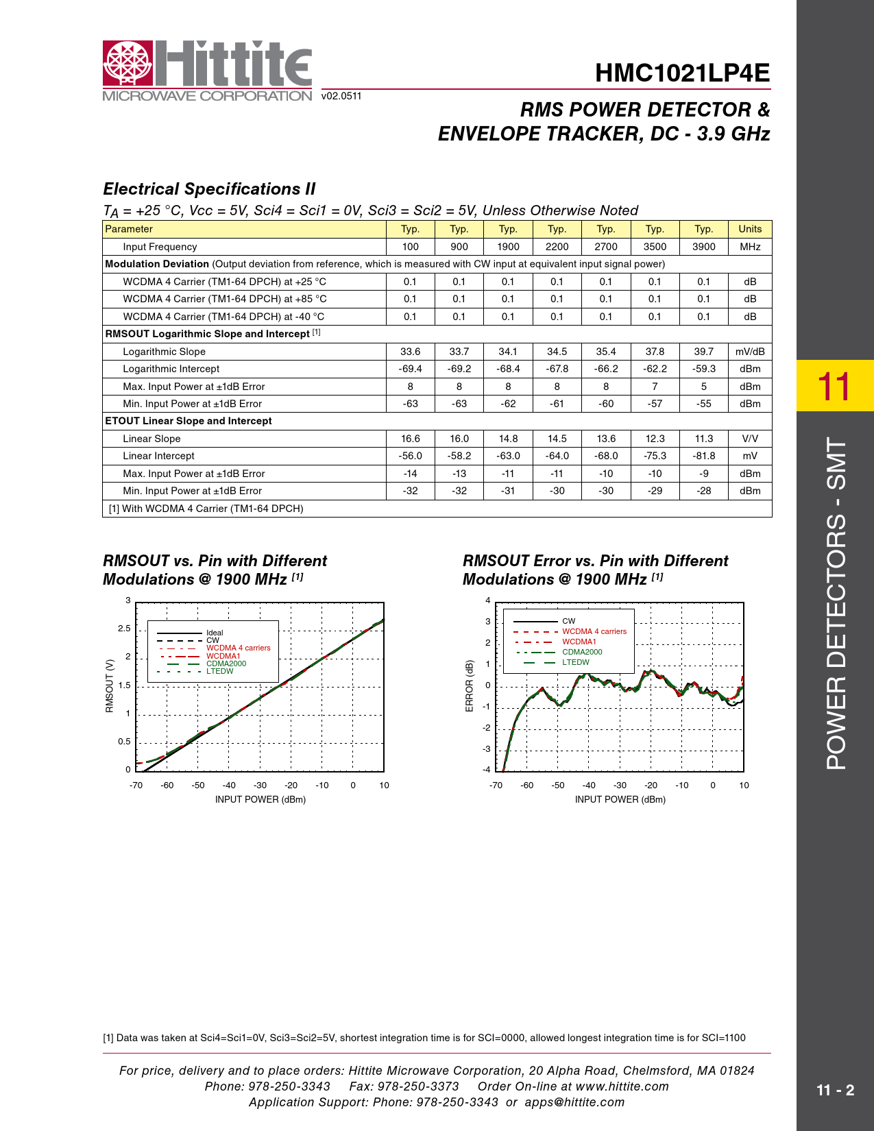

HMC1021LP4E. RMS POWER DETECTOR &. ENVELOPE TRACKER, DC - 3.9 GHz. Electrical Specifications II. Modulation Deviation
HMC1021LP4E RMS POWER DETECTOR & ENVELOPE TRACKER, DC - 3.9 GHz Electrical Specifications II Modulation Deviation
HMC1021LP4E
v02.0511
TA = +25 °C, Vcc = 5V, Sci4 = Sci1 = 0V, Sci3 = Sci2 = 5V, Unless Otherwise Noted Parameter typ. typ. typ. typ. typ. typ. typ. Units Input Frequency 100 900 1900 2200 2700 3500 3900 MHz
(Output deviation from reference, which is measured with CW input at equivalent input signal power)
WCDMA 4 Carrier (TM1-64 DPCH) at +25 °C 0.1 0.1 0.1 0.1 0.1 0.1 0.1 dB WCDMA 4 Carrier (TM1-64 DPCH) at +85 °C 0.1 0.1 0.1 0.1 0.1 0.1 0.1 dB WCDMA 4 Carrier (TM1-64 DPCH) at -40 °C 0.1 0.1 0.1 0.1 0.1 0.1 0.1 dB
RMSOUT Logarithmic Slope and Intercept
[1] Logarithmic slope 33.6 33.7 34.1 34.5 35.4 37.8 39.7 mV/dB Logarithmic Intercept -69.4 -69.2 -68.4 -67.8 -66.2 -62.2 -59.3 dBm Max. Input Power at ±1dB error 8 8 8 8 8 7 5 dBm Min. Input Power at ±1dB error -63 -63 -62 -61 -60 -57 -55 dBm 11
ETOUT Linear Slope and Intercept
Linear slope 16.6 16.0 14.8 14.5 13.6 12.3 11.3 V/V t Linear Intercept -56.0 -58.2 -63.0 -64.0 -68.0 -75.3 -81.8 mV Max. Input Power at ±1dB error -14 -13 -11 -11 -10 -10 -9 dBm M Min. Input Power at ±1dB error -32 -32 -31 -30 -30 -29 -28 dBm s [1] With WCDMA 4 Carrier (TM1-64 DPCH) - rs
RMSOUT vs. Pin with Different RMSOUT Error vs. Pin with Different
o
Modulations @ 1900 MHz [1] Modulations @ 1900 MHz [1]
t 3 4 c CW e 3 2.5 Ideal WCDMA 4 carriers t CW 2 WCDMA1 WCDMA 4 carriers CDMA2000 e 2 WCDMA1 CDMA2000 1 LTEDW LTEDW D 1.5 0 r RMSOUT (V) -1 1 ERROR (dB) e -2 w 0.5 -3 o 0 -4 P -70 -60 -50 -40 -30 -20 -10 0 10 -70 -60 -50 -40 -30 -20 -10 0 10 INPUT POWER (dBm) INPUT POWER (dBm) [1] Data was taken at sci4=sci1=0V, sci3=sci2=5V, shortest integration time is for scI=0000, allowed longest integration time is for scI=1100 For price, delivery and to place orders: Hittite Microwave Corporation, 20 Alpha Road, Chelmsford, MA 01824 Phone: 978-250-3343 Fax: 978-250-3373 Order On-line at www.hittite.com
