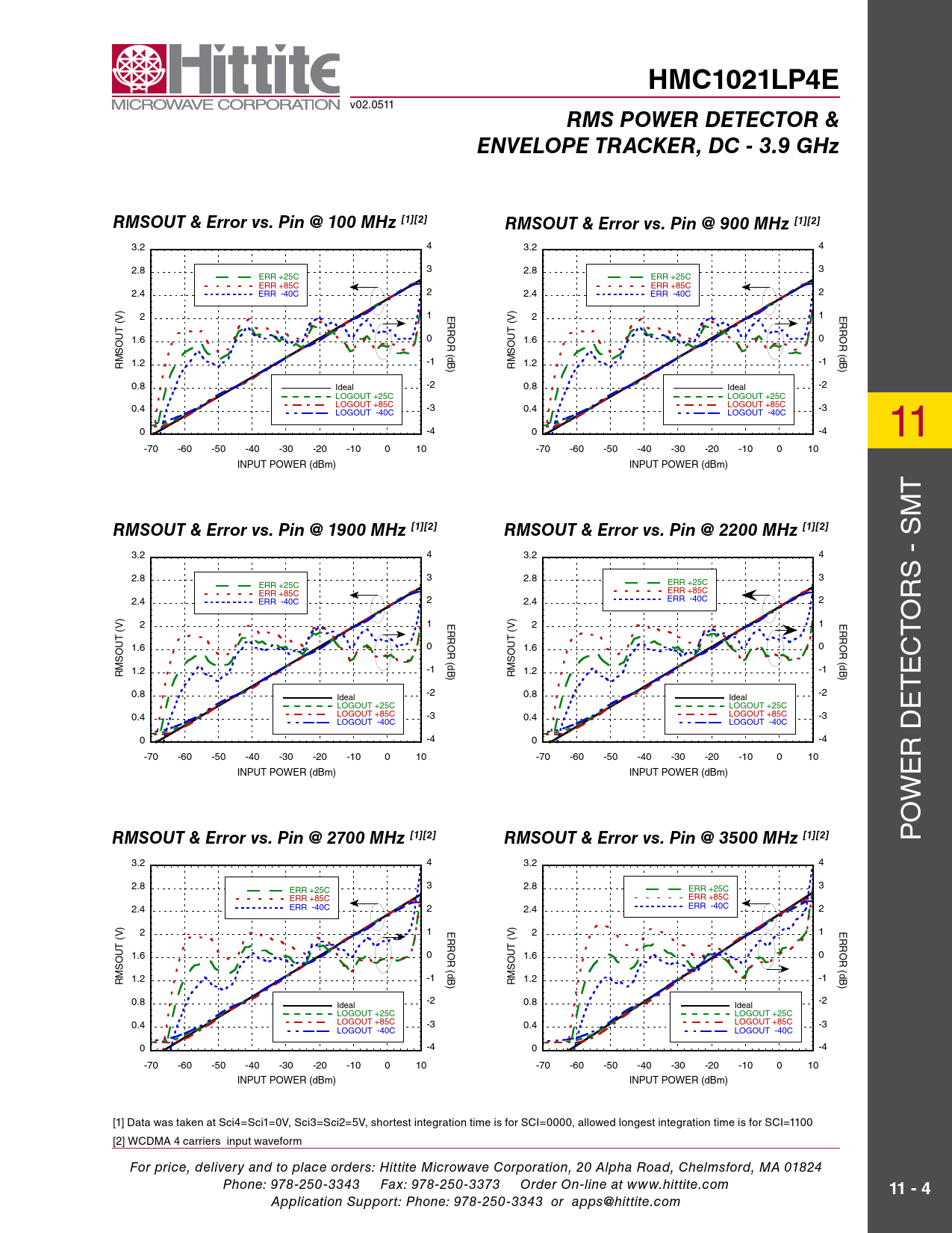

HMC1021LP4E. RMS POWER DETECTOR &. ENVELOPE TRACKER, DC - 3.9 GHz. RMSOUT & Error vs. Pin @ 100 MHz [1][2]

RMS POWER DETECTOR & ENVELOPE TRACKER, DC - 3.9 GHz RMSOUT & Error vs. Pin @ 100 MHz [1][2] RMSOUT & Error vs. Pin @ 900 MHz [1][2]
3.2 4 3.2 4 2.8 3 2.8 3 ERR +25C ERR +25C ERR +85C ERR +85C 2.4 ERR -40C 2 2.4 ERR -40C 2 2 1 ERROR ERROR (V) 2 1 (V) 1.6 0 1.6 0 (dB) (dB) 1.2 -1 RMSOUT 1.2 -1 RMSOUT 0.8 -2 Ideal 0.8 -2 Ideal LOGOUT +25C LOGOUT +25C 0.4 LOGOUT +85C -3 LOGOUT +85C -3 LOGOUT -40C 0.4 LOGOUT -40C 0 -4 0 -4 11 -70 -60 -50 -40 -30 -20 -10 0 10 -70 -60 -50 -40 -30 -20 -10 0 10 INPUT POWER (dBm) INPUT POWER (dBm) t M
RMSOUT & Error vs. Pin @ 1900 MHz [1][2] RMSOUT & Error vs. Pin @ 2200 MHz [1][2]
s 3.2 4 3.2 4 - 2.8 3 2.8 3 ERR +25C ERR +25C ERR +85C ERR +85C 2.4 ERR -40C 2 2.4 ERR -40C 2 rs ERROR ERROR o 2 1 (V) 2 1 (V) t 1.6 0 1.6 0 (dB) (dB) c 1.2 -1 RMSOUT 1.2 -1 RMSOUT e -2 -2 t 0.8 Ideal 0.8 Ideal LOGOUT +25C LOGOUT +25C e 0.4 LOGOUT +85C -3 0.4 LOGOUT +85C -3 LOGOUT -40C LOGOUT -40C 0 -4 0 -4 D -70 -60 -50 -40 -30 -20 -10 0 10 -70 -60 -50 -40 -30 -20 -10 0 10 r INPUT POWER (dBm) INPUT POWER (dBm) e w o
RMSOUT & Error vs. Pin @ 2700 MHz [1][2] RMSOUT & Error vs. Pin @ 3500 MHz [1][2]
P 3.2 4 3.2 4 2.8 3 3 ERR +25C 2.8 ERR +25C ERR +85C ERR +85C 2.4 ERR -40C 2 2.4 ERR -40C 2 2 1 ERROR ERROR (V) 2 1 (V) 1.6 0 1.6 0 (dB) (dB) 1.2 -1 RMSOUT 1.2 -1 RMSOUT 0.8 -2 Ideal 0.8 -2 Ideal LOGOUT +25C LOGOUT +25C 0.4 LOGOUT +85C -3 0.4 LOGOUT +85C -3 LOGOUT -40C LOGOUT -40C 0 -4 0 -4 -70 -60 -50 -40 -30 -20 -10 0 10 -70 -60 -50 -40 -30 -20 -10 0 10 INPUT POWER (dBm) INPUT POWER (dBm) [1] Data was taken at sci4=sci1=0V, sci3=sci2=5V, shortest integration time is for scI=0000, allowed longest integration time is for scI=1100 [2] wcDMA 4 carriers input waveform For price, delivery and to place orders: Hittite Microwave Corporation, 20 Alpha Road, Chelmsford, MA 01824 Phone: 978-250-3343 Fax: 978-250-3373 Order On-line at www.hittite.com
