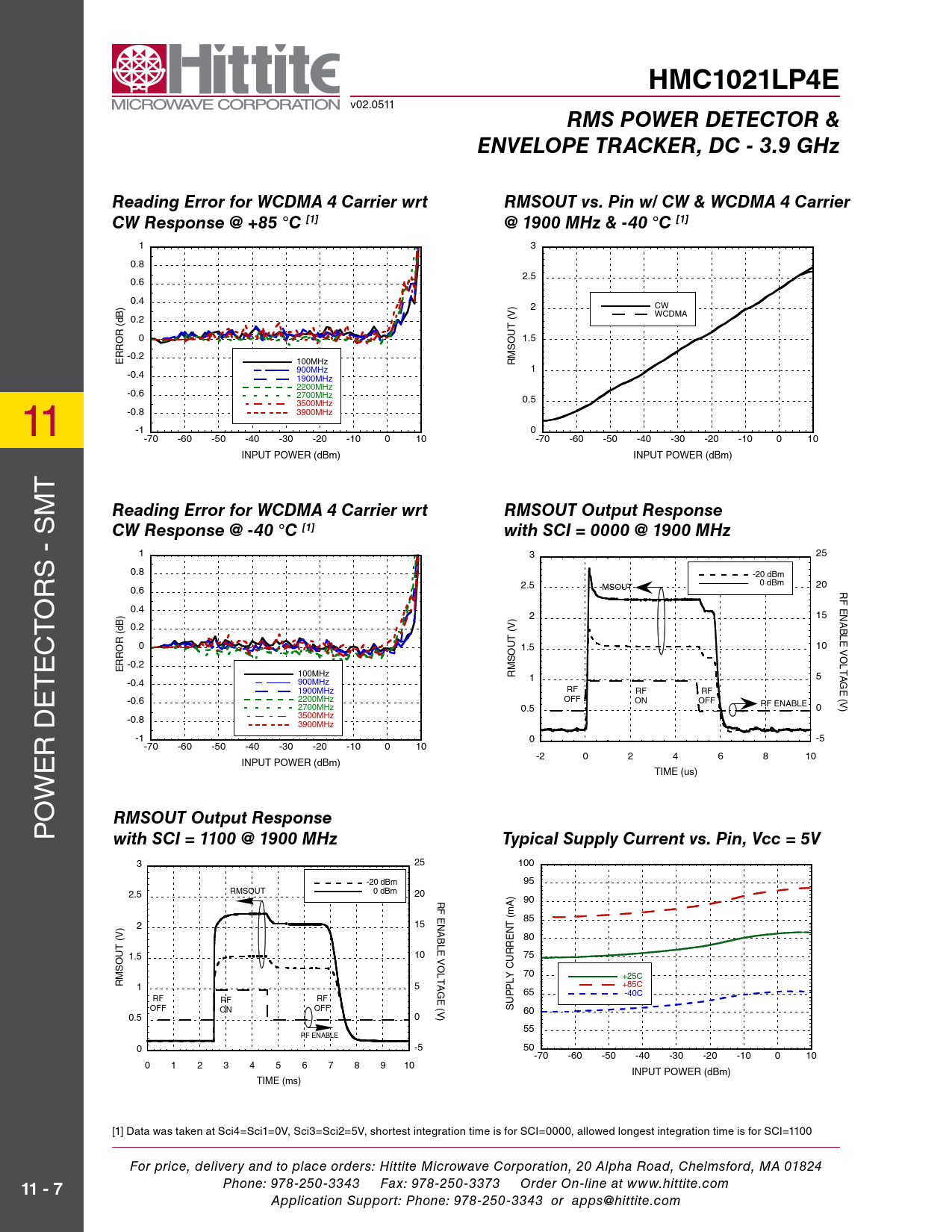

HMC1021LP4E. RMS POWER DETECTOR &. ENVELOPE TRACKER, DC - 3.9 GHz. Reading Error for WCDMA 4 Carrier wrt
HMC1021LP4E RMS POWER DETECTOR & ENVELOPE TRACKER, DC - 3.9 GHz Reading Error for WCDMA 4 Carrier wrt
HMC1021LP4E
v02.0511
RMS POWER DETECTOR & ENVELOPE TRACKER, DC - 3.9 GHz Reading Error for WCDMA 4 Carrier wrt RMSOUT vs. Pin w/ CW & WCDMA 4 Carrier CW Response @ +85 °C [1] @ 1900 MHz & -40 °C [1]
1 3 0.8 2.5 0.6 0.4 2 CW 0.2 WCDMA (V) (dB) 0 1.5 -0.2 ERROR 100MHz RMSOUT 1 -0.4 900MHz 1900MHz 2200MHz -0.6 2700MHz 11 3500MHz 0.5 -0.8 3900MHz -1 0 -70 -60 -50 -40 -30 -20 -10 0 10 -70 -60 -50 -40 -30 -20 -10 0 10 INPUT POWER (dBm) INPUT POWER (dBm) t M
Reading Error for WCDMA 4 Carrier wrt RMSOUT Output Response
s
CW Response @ -40 °C [1] with SCI = 0000 @ 1900 MHz
- 1 3 25 0.8 rs -20 dBm 0 dBm 20 0.6 2.5 MSOUT RF ENABLE VOLTAGE (V) o 0.4 t 2 15 0.2 c (dB) 0 1.5 10 e -0.2 t ERROR 100MHz RMSOUT (V) 5 -0.4 900MHz 1 e 1900MHz RF RF RF -0.6 2200MHz OFF ON OFF 2700MHz 0.5 RF ENABLE 0 D -0.8 3500MHz 3900MHz r -1 0 -5 -70 -60 -50 -40 -30 -20 -10 0 10 e -2 0 2 4 6 8 10 INPUT POWER (dBm) TIME (us) w o P
RMSOUT Output Response with SCI = 1100 @ 1900 MHz Typical Supply Current vs. Pin, Vcc = 5V
3 25 100 -20 dBm 95 2.5 RMSOUT 0 dBm 20 RF ENABLE VOLTAGE (V) 90 85 2 15 80 1.5 10 75 70 +25C RMSOUT (V) 1 5 +85C 65 -40C RF RF RF OFF ON OFF SUPPLY CURRENT (mA) 60 0.5 0 55 RF ENABLE 0 -5 50-70 -60 -50 -40 -30 -20 -10 0 10 0 1 2 3 4 5 6 7 8 9 10 INPUT POWER (dBm) TIME (ms) [1] Data was taken at sci4=sci1=0V, sci3=sci2=5V, shortest integration time is for scI=0000, allowed longest integration time is for scI=1100 For price, delivery and to place orders: Hittite Microwave Corporation, 20 Alpha Road, Chelmsford, MA 01824
