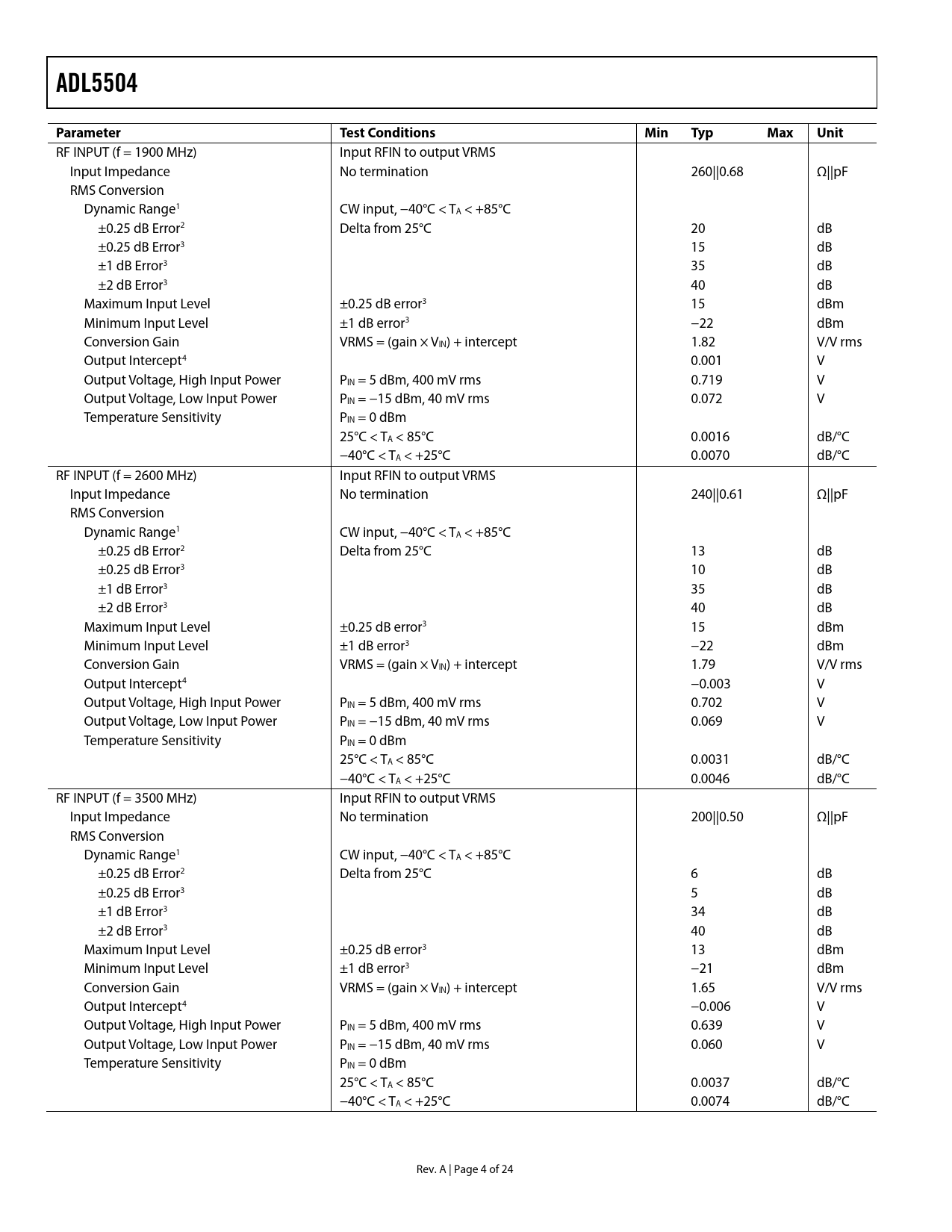

ADL5504 Parameter Test Conditions Min Typ Max Unit
RF INPUT (f = 1900 MHz) Input RFIN to output VRMS Input Impedance No termination 260||0.68 Ω||pF RMS Conversion Dynamic Range1 CW input, −40°C < TA < +85°C ±0.25 dB Error2 Delta from 25°C 20 dB ±0.25 dB Error3 15 dB ±1 dB Error3 35 dB ±2 dB Error3 40 dB Maximum Input Level ±0.25 dB error3 15 dBm Minimum Input Level ±1 dB error3 −22 dBm Conversion Gain VRMS = (gain × VIN) + intercept 1.82 V/V rms Output Intercept4 0.001 V Output Voltage, High Input Power PIN = 5 dBm, 400 mV rms 0.719 V Output Voltage, Low Input Power PIN = −15 dBm, 40 mV rms 0.072 V Temperature Sensitivity PIN = 0 dBm 25°C < TA < 85°C 0.0016 dB/°C −40°C < TA < +25°C 0.0070 dB/°C RF INPUT (f = 2600 MHz) Input RFIN to output VRMS Input Impedance No termination 240||0.61 Ω||pF RMS Conversion Dynamic Range1 CW input, −40°C < TA < +85°C ±0.25 dB Error2 Delta from 25°C 13 dB ±0.25 dB Error3 10 dB ±1 dB Error3 35 dB ±2 dB Error3 40 dB Maximum Input Level ±0.25 dB error3 15 dBm Minimum Input Level ±1 dB error3 −22 dBm Conversion Gain VRMS = (gain × VIN) + intercept 1.79 V/V rms Output Intercept4 −0.003 V Output Voltage, High Input Power PIN = 5 dBm, 400 mV rms 0.702 V Output Voltage, Low Input Power PIN = −15 dBm, 40 mV rms 0.069 V Temperature Sensitivity PIN = 0 dBm 25°C < TA < 85°C 0.0031 dB/°C −40°C < TA < +25°C 0.0046 dB/°C RF INPUT (f = 3500 MHz) Input RFIN to output VRMS Input Impedance No termination 200||0.50 Ω||pF RMS Conversion Dynamic Range1 CW input, −40°C < TA < +85°C ±0.25 dB Error2 Delta from 25°C 6 dB ±0.25 dB Error3 5 dB ±1 dB Error3 34 dB ±2 dB Error3 40 dB Maximum Input Level ±0.25 dB error3 13 dBm Minimum Input Level ±1 dB error3 −21 dBm Conversion Gain VRMS = (gain × VIN) + intercept 1.65 V/V rms Output Intercept4 −0.006 V Output Voltage, High Input Power PIN = 5 dBm, 400 mV rms 0.639 V Output Voltage, Low Input Power PIN = −15 dBm, 40 mV rms 0.060 V Temperature Sensitivity PIN = 0 dBm 25°C < TA < 85°C 0.0037 dB/°C −40°C < TA < +25°C 0.0074 dB/°C Rev. A | Page 4 of 24 Document Outline Features Applications Functional Block Diagram General Description Revision History Specifications Absolute Maximum Ratings ESD Caution Pin Configuration and Function Descriptions Typical Performance Characteristics Circuit Description RMS Circuit Description and Filtering Filtering Output Buffer Applications Information Basic Connections RF Input Interfacing Resistive Tap RF Input Multiple RF Inputs Linearity Output Swing Output Offset Output Drive Capability and Buffering Selecting the Square-Domain Filter and Output Low-Pass Filter Power Consumption, Enable, and Power-On/Power-Off Response Time Device Calibration and Error Calculation Calibration for Improved Accuracy Drift over a Reduced Temperature Range Device Handling Evaluation Board Land Pattern and Soldering Information Outline Dimensions Ordering Guide
