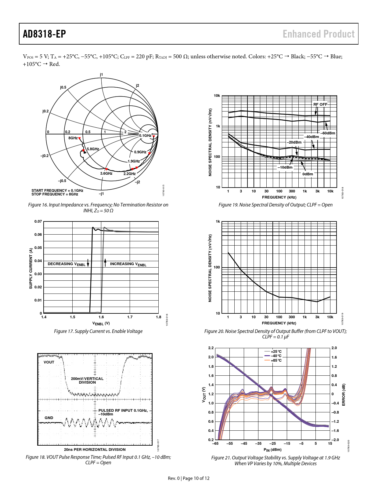

AD8318-EP. Enhanced Product. j0.5. 10k. RF OFF. j0.2. / Hz V n Y (. 0.2. 0.5. –60dBm. 0.1GHz. 8GHz. –40dBm. –20dBm. 5.8GHz. 0.9GHz. –j0.2. C E 100. 1.9GHz
AD8318-EP Enhanced Product j0.5 10k RF OFF j0.2 / Hz V n Y ( 0.2 0.5 –60dBm 0.1GHz 8GHz –40dBm –20dBm 5.8GHz 0.9GHz –j0.2 C E 100 1.9GHz
VPOS = 5 V; TA = +25°C, −55°C, +105°C; CLPF = 220 pF; RTADJ = 500 Ω; unless otherwise noted. Colors: +25°C  Black; −55°C  Blue; +105°C  Red.
j1 j2 j0.5 10k RF OFF ) j0.2 / Hz V n Y ( 1k IT 0 0.2 0.5 1 2 S –60dBm 0.1GHz N 8GHz E –40dBm D –20dBm AL 5.8GHz R 0.9GHz T –j0.2 C E 100 P 1.9GHz S E IS –10dBm 3.6GHz 2.2GHz NO 0dBm –j0.5 –j2

107 Figure 16. Input Impedance vs. Frequency; No Termination Resistor on Figure 19. Noise Spectral Density of Output; CLPF = Open INHI, ZO = 50 Ω
0.07 1k 0.06 ) z H V/ ) 0.05 n ( (A Y IT NT S 0.04 N DECREASING V E ENBL INCREASING VENBL D 100 L CURRE 0.03 A Y R L T P UP S 0.02 ISE SPEC O 0.01 N 0 10 1.4 1.5 1.6 1.7 1.8

10 107 Figure 17. Supply Current vs. Enable Voltage Figure 20. Noise Spectral Density of Output Buffer (from CLPF to VOUT); CLPF = 0.1 μF
2.2 2.0 +25°C 2.0 –40°C 1.6 +85°C VOUT 1.8 1.2 1.6 0.8 200mV/VERTICAL DIVISION 1.4 0.4 ) B) d (V T 1.2 0 R ( OUV 1.0 –0.4 RRO E PULSED RF INPUT 0.1GHz, 0.8 –0.8 –10dBm GND 0.6 –1.2 0.4 –1.6 0.2 –2.0

10 Figure 18. VOUT Pulse Response Time; Pulsed RF Input 0.1 GHz, –10 dBm; Figure 21. Output Voltage Stability vs. Supply Voltage at 1.9 GHz CLPF = Open When VP Varies by 10%, Multiple Devices Rev. 0 | Page 10 of 12 Document Outline Features Applications General Description Functional Block Diagram Revision History Specifications Absolute Maximum Ratings ESD Caution Pin Configuration and Function Descriptions Typical Performance Characteristics Outline Dimensions Ordering Guide
