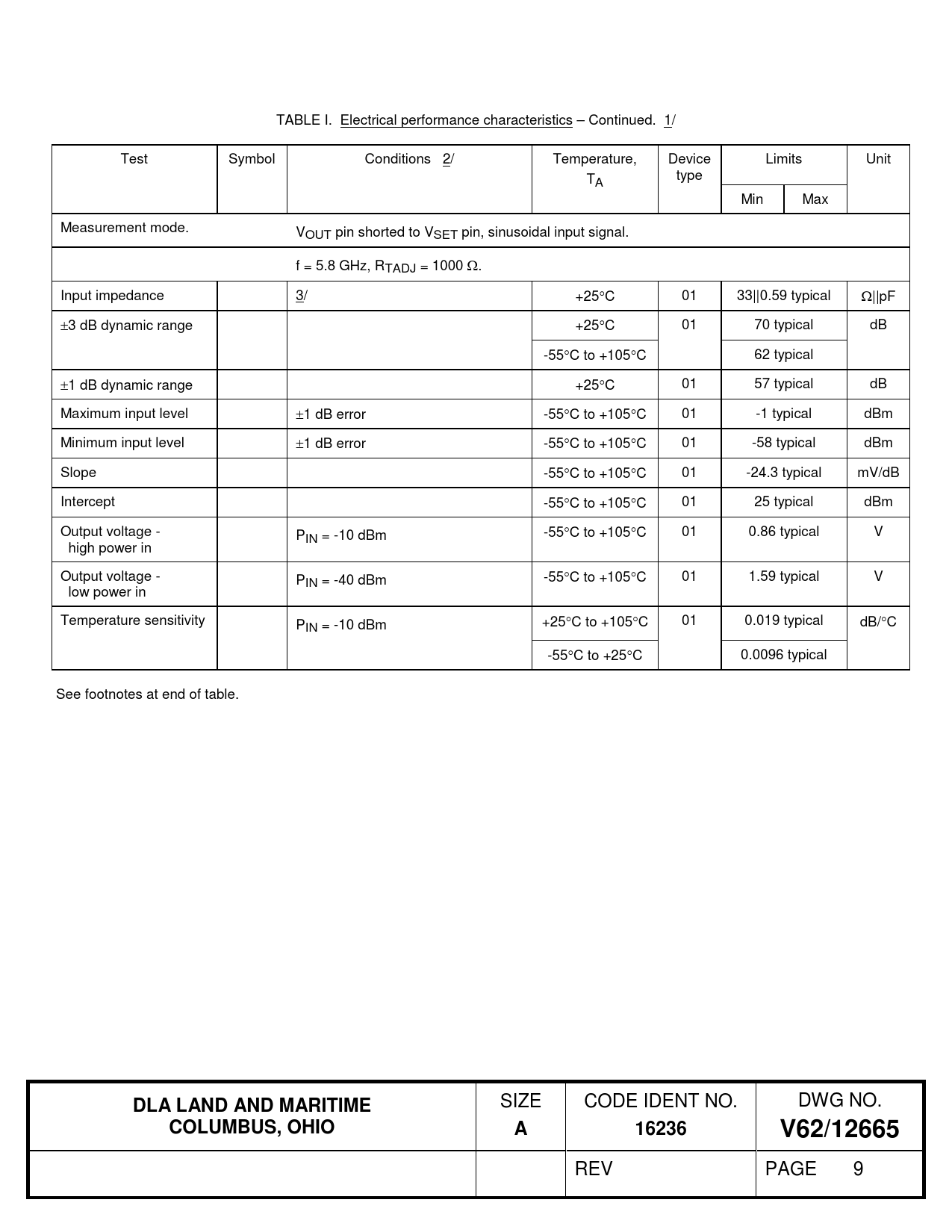

TABLE I. Electrical performance characteristics – Continued. 1/ Test Symbol Conditions 2/ Temperature, Device Limits Unit T type A Min Max Measurement mode. VOUT pin shorted to VSET pin, sinusoidal input signal. f = 5.8 GHz, RTADJ = 1000 Ω. Input impedance 3/ +25°C 01 33||0.59 typical Ω||pF ±3 dB dynamic range +25°C 01 70 typical dB -55°C to +105°C 62 typical ±1 dB dynamic range +25°C 01 57 typical dB Maximum input level ±1 dB error -55°C to +105°C 01 -1 typical dBm Minimum input level ±1 dB error -55°C to +105°C 01 -58 typical dBm Slope -55°C to +105°C 01 -24.3 typical mV/dB Intercept -55°C to +105°C 01 25 typical dBm Output voltage - PIN = -10 dBm -55°C to +105°C 01 0.86 typical V high power in Output voltage - PIN = -40 dBm -55°C to +105°C 01 1.59 typical V low power in Temperature sensitivity PIN = -10 dBm +25°C to +105°C 01 0.019 typical dB/°C -55°C to +25°C 0.0096 typical See footnotes at end of table.
