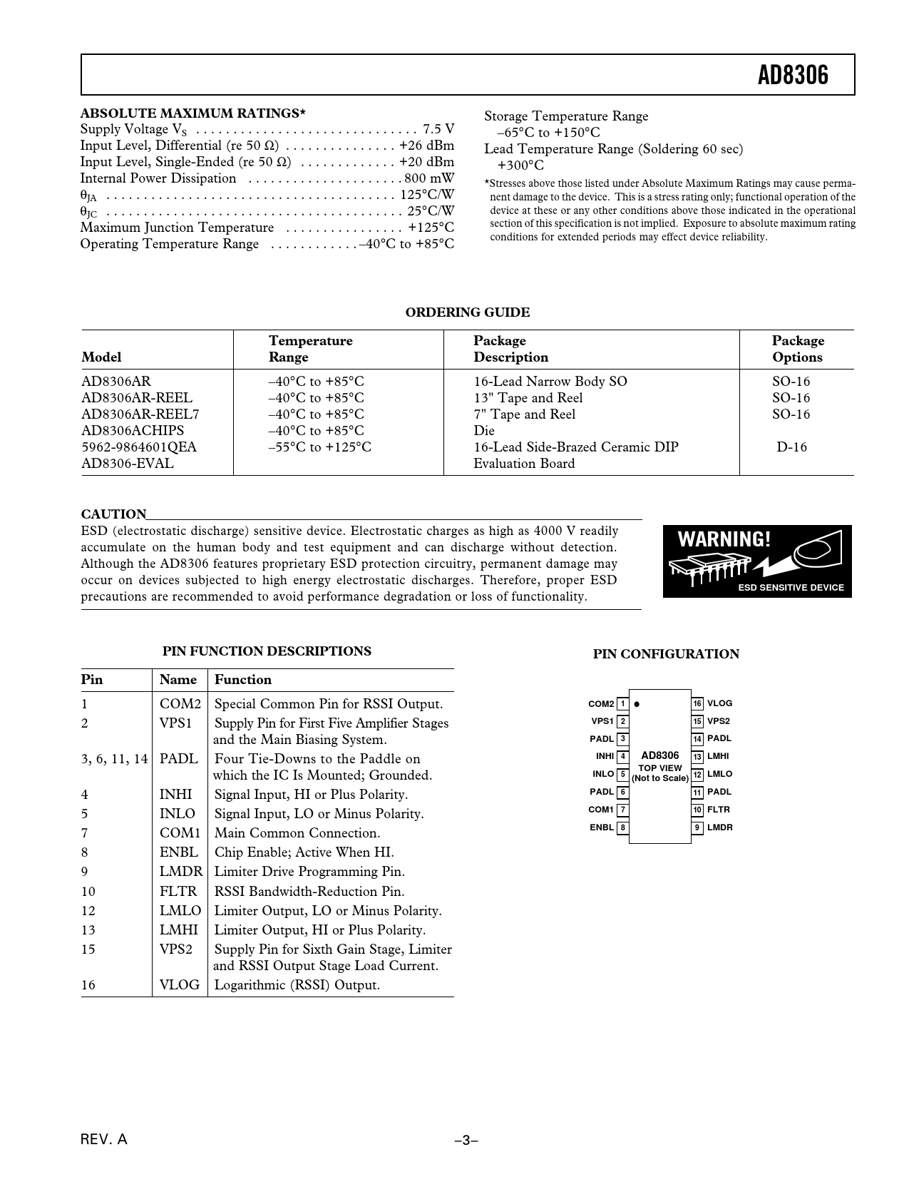

AD8306. ABSOLUTE MAXIMUM RATINGS*. ORDERING GUIDE. Temperature. Package. Model. Range. Description. Options. CAUTION. WARNING!
AD8306 ABSOLUTE MAXIMUM RATINGS* ORDERING GUIDE Temperature Package Model Range Description Options CAUTION WARNING!
Storage Temperature Range Supply Voltage VS . 7.5 V –65°C to +150°C Input Level, Differential (re 50 Ω) . +26 dBm Lead Temperature Range (Soldering 60 sec) Input Level, Single-Ended (re 50 Ω) . +20 dBm +300°C Internal Power Dissipation . 800 mW *Stresses above those listed under Absolute Maximum Ratings may cause perma- θJA . 125°C/W nent damage to the device. This is a stress rating only; functional operation of the θ device at these or any other conditions above those indicated in the operational JC . 25°C/W Maximum Junction Temperature . +125°C section of this specification is not implied. Exposure to absolute maximum rating conditions for extended periods may effect device reliability. Operating Temperature Range . –40°C to +85°C
ORDERING GUIDE Temperature Package Package Model Range Description Options
AD8306AR –40°C to +85°C 16-Lead Narrow Body SO SO-16 AD8306AR-REEL –40°C to +85°C 13" Tape and Reel SO-16 AD8306AR-REEL7 –40°C to +85°C 7" Tape and Reel SO-16 AD8306ACHIPS –40°C to +85°C Die 5962-9864601QEA –55°C to +125°C 16-Lead Side-Brazed Ceramic DIP D-16 AD8306-EVAL Evaluation Board
CAUTION
ESD (electrostatic discharge) sensitive device. Electrostatic charges as high as 4000 V readily
WARNING!
accumulate on the human body and test equipment and can discharge without detection. Although the AD8306 features proprietary ESD protection circuitry, permanent damage may occur on devices subjected to high energy electrostatic discharges. Therefore, proper ESD
ESD SENSITIVE DEVICE
precautions are recommended to avoid performance degradation or loss of functionality.
PIN FUNCTION DESCRIPTIONS PIN CONFIGURATION Pin Name Function
1 COM2 Special Common Pin for RSSI Output.
COM2 1 16 VLOG VPS1 2 15 VPS2
2 VPS1 Supply Pin for First Five Amplifier Stages
PADL 3 14 PADL
and the Main Biasing System.
INHI 4 AD8306 13 LMHI
3, 6, 11, 14 PADL Four Tie-Downs to the Paddle on
TOP VIEW INLO 5
which the IC Is Mounted; Grounded.
(Not to Scale) 12 LMLO PADL 6 11 PADL
4 INHI Signal Input, HI or Plus Polarity.
COM1 7 10 FLTR
5 INLO Signal Input, LO or Minus Polarity.
ENBL 8 9 LMDR
7 COM1 Main Common Connection. 8 ENBL Chip Enable; Active When HI. 9 LMDR Limiter Drive Programming Pin. 10 FLTR RSSI Bandwidth-Reduction Pin. 12 LMLO Limiter Output, LO or Minus Polarity. 13 LMHI Limiter Output, HI or Plus Polarity. 15 VPS2 Supply Pin for Sixth Gain Stage, Limiter and RSSI Output Stage Load Current. 16 VLOG Logarithmic (RSSI) Output. REV. A –3–
