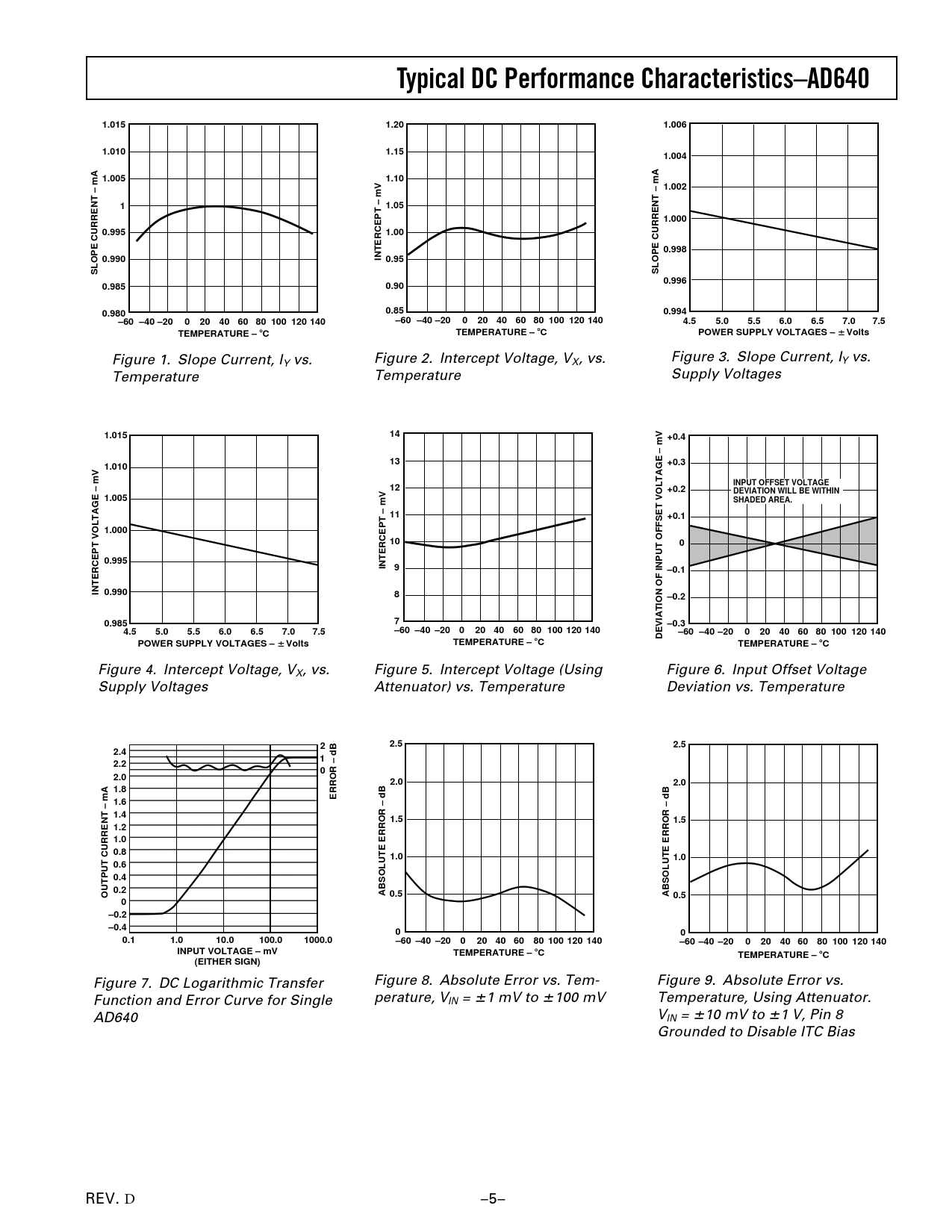

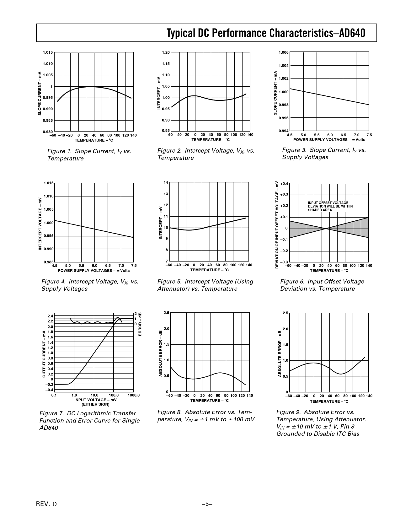

Typical DC Performance Characteristics–AD640. 1.015. 1.20. 1.006. 1.010. 1.15. 1.004. 1.005. 1.10. 1.002. 1.05. 1.000. 0.995. 1.00. 0.998. 0.990
Typical DC Performance Characteristics–AD640 1.015 1.20 1.006 1.010 1.15 1.004 1.005 1.10 1.002 1 1.05 1.000 0.995 1.00 0.998 0.990 INTERCEPT – mV 0.95 SLOPE CURRENT – mA SLOPE CURRENT – mA 0.996 0.985 0.90 0.980 0.85 0.994 –60 –40 –20 0 20 40 60 80 100 120 140 –60 –40 –20 0 20 40 60 80 100 120 140 4.5 5.0 5.5 6.0 6.5 7.0 7.5 TEMPERATURE –
8
C TEMPERATURE –
8
C POWER SUPPLY VOLTAGES –
6
Volts
Figure 1. Slope Current, I Figure 2. Intercept Voltage, V Figure 3. Slope Current, I Y vs. X, vs. Y vs. Temperature Temperature Supply Voltages
1.015 14 +0.4 13 1.010 +0.3 INPUT OFFSET VOLTAGE 12 +0.2 DEVIATION WILL BE WITHIN 1.005 SHADED AREA. 11 +0.1 1.000 10 0 0.995 INTERCEPT – mV 9 –0.1 INTERCEPT VOLTAGE – mV 0.990 8 –0.2 0.985 7 –0.3 4.5 5.0 5.5 6.0 6.5 7.0 7.5 –60 –40 –20 0 20 40 60 80 100 120 140 –60 –40 –20 0 20 40 60 80 100 120 140 DEVIATION OF INPUT OFFSET VOLTAGE – mV POWER SUPPLY VOLTAGES –
6
Volts TEMPERATURE –
8
C TEMPERATURE –
8
C
Figure 4. Intercept Voltage, VX, vs. Figure 5. Intercept Voltage (Using Figure 6. Input Offset Voltage Supply Voltages Attenuator) vs. Temperature Deviation vs. Temperature
2 2.5 2.5 2.4 1 2.2 0 2.0 2.0 2.0 1.8 ERROR – dB 1.6 1.4 1.5 1.5 1.2 1.0 0.8 1.0 1.0 0.6 0.4 0.2 OUTPUT CURRENT – mA ABSOLUTE ERROR – dB 0.5 ABSOLUTE ERROR – dB 0.5 0 –0.2 –0.4 0 0 0.1 1.0 10.0 100.0 1000.0 –60 –40 –20 0 20 40 60 80 100 120 140 –60 –40 –20 0 20 40 60 80 100 120 140 INPUT VOLTAGE – mV TEMPERATURE –
8
C TEMPERATURE –
8
C (EITHER SIGN)
Figure 7. DC Logarithmic Transfer Figure 8. Absolute Error vs. Tem- Figure 9. Absolute Error vs. Function and Error Curve for Single perature, VIN = ⴞ1 mV to ⴞ100 mV Temperature, Using Attenuator. AD640 VIN = ⴞ10 mV to ⴞ1 V, Pin 8 Grounded to Disable ITC Bias REV. D –5– Document Outline AD640-SPECIFICATIONS DC Specifications AC Specifications Thermal Characteristics ABSOLUTE MAXIMUM RATINGS TYPICAL DC PERFORMANCE CHARACTERISTICS TYPICAL AC PERFORMANCE CHARACTERISTICS OUTLINE DIMENSIONS ORDERING GUIDE
