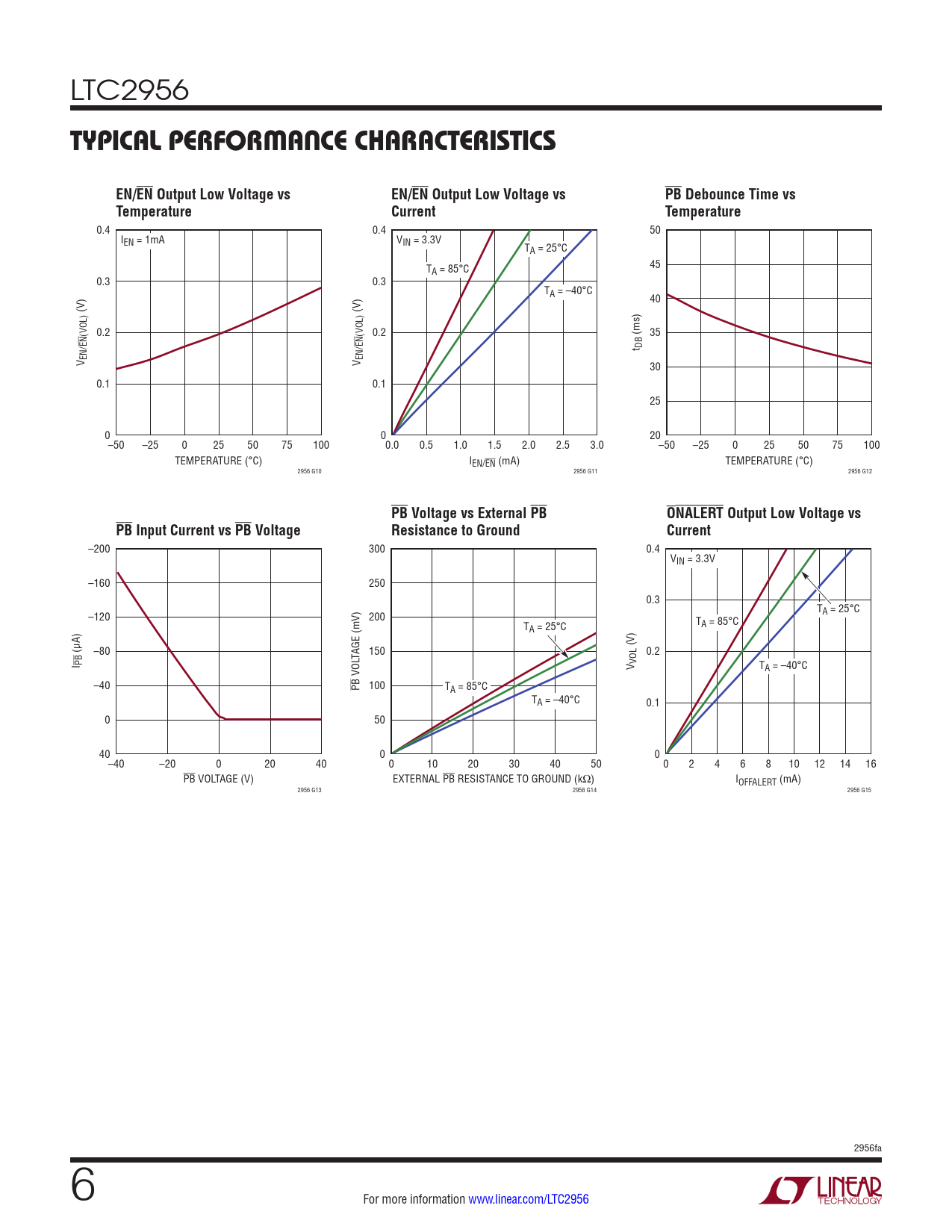

TYPICAL PERFORMANCE CHARACTERISTICS. EN/EN Output Low Voltage vs. PB Debounce Time vs. Temperature. Current
LTC2956
TYPICAL PERFORMANCE CHARACTERISTICS EN/EN Output Low Voltage vs EN/EN Output Low Voltage vs PB Debounce Time vs Temperature Current Temperature
0.4 0.4 50 IEN = 1mA VIN = 3.3V TA = 25°C T 45 A = 85°C 0.3 0.3 TA = –40°C 40 (V) (V) (VOL) 0.2 (VOL) 0.2 (ms) 35 EN EN t DB V EN/ V EN/ 30 0.1 0.1 25 0 0 20 –50 –25 0 25 50 75 100 0.0 0.5 1.0 1.5 2.0 2.5 3.0 –50 –25 0 25 50 75 100 TEMPERATURE (°C) IEN/EN (mA) TEMPERATURE (°C) 2956 G10 2956 G11 2956 G12
PB Voltage vs External PB ONALERT Output Low Voltage vs PB Input Current vs PB Voltage Resistance to Ground Current
–200 300 0.4 VIN = 3.3V –160 250 0.3 T –120 200 A = 25°C T T A = 25°C A = 85°C (V) (µA) –80 TAGE (mV) 150 0.2 I PB V VOL T VOL A = –40°C –40 PB 100 TA = 85°C TA = –40°C 0.1 0 50 40 0 0 –40 –20 0 20 40 0 10 20 30 40 50 0 2 4 6 8 10 12 14 16 PB VOLTAGE (V) EXTERNAL PB RESISTANCE TO GROUND (kΩ) IOFFALERT (mA) 2956 G13 2956 G14 2956 G15 2956fa 6 For more information www.linear.com/LTC2956
