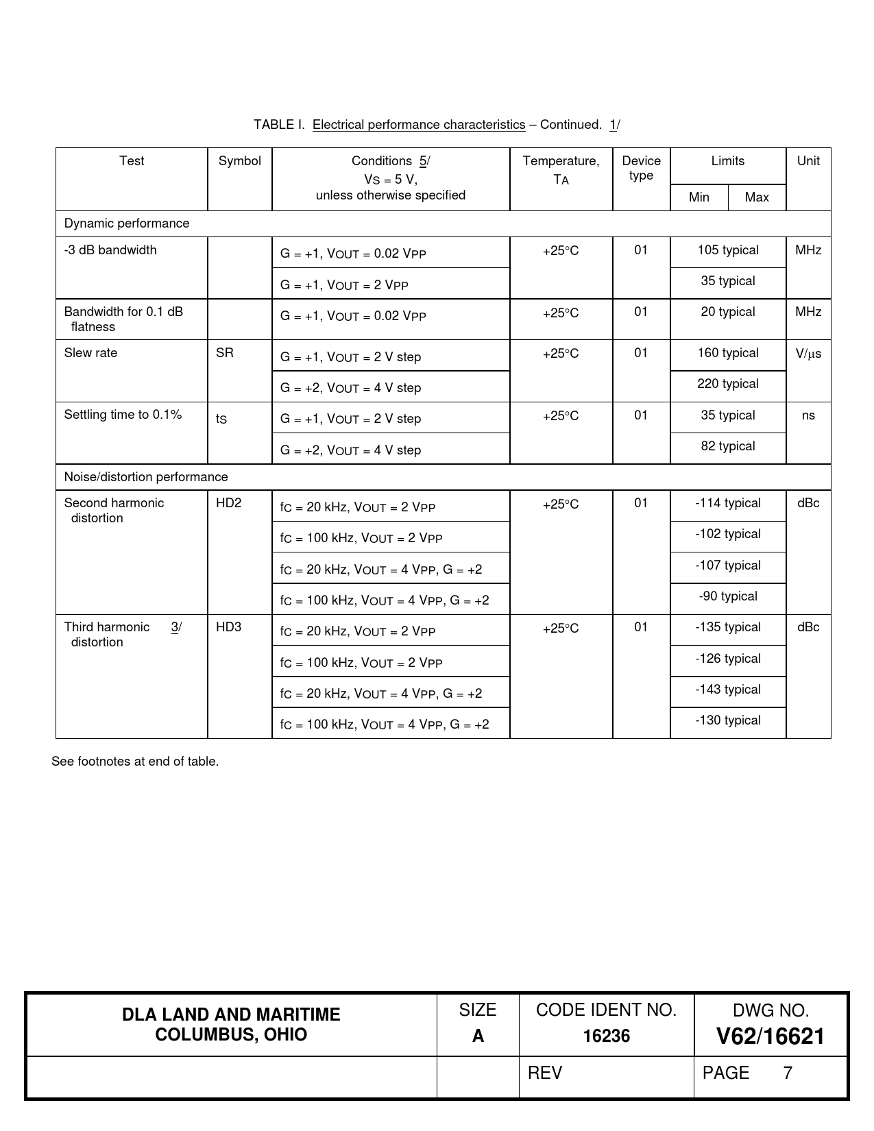

| Description | Dual, 0.2 µV/°C Offset Drift, 105 MHz Low Power, Low Noise, Rail-to-Rail Amplifier |
| Pages / Page | 17 / 7 — DLA LAND AND MARITIME. COLUMBUS, OHIO. 16236. V62/16621 |
| File Format / Size | PDF / 104 Kb |
TABLE I. Electrical performance characteristics – Continued. 1/ Test Symbol Conditions 5/ Temperature, Device Limits Unit VS = 5 V, TA type unless otherwise specified Min Max Dynamic performance -3 dB bandwidth G = +1, VOUT = 0.02 VPP +25C 01 105 typical MHz G = +1, VOUT = 2 VPP 35 typical Bandwidth for 0.1 dB G = +1, VOUT = 0.02 VPP +25C 01 20 typical MHz flatness Slew rate SR G = +1, VOUT = 2 V step +25C 01 160 typical V/s G = +2, VOUT = 4 V step 220 typical Settling time to 0.1% tS G = +1, VOUT = 2 V step +25C 01 35 typical ns G = +2, VOUT = 4 V step 82 typical Noise/distortion performance Second harmonic HD2 fC = 20 kHz, VOUT = 2 VPP +25C 01 -114 typical dBc distortion fC = 100 kHz, VOUT = 2 VPP -102 typical fC = 20 kHz, VOUT = 4 VPP, G = +2 -107 typical fC = 100 kHz, VOUT = 4 VPP, G = +2 -90 typical Third harmonic 3/ HD3 fC = 20 kHz, VOUT = 2 VPP +25C 01 -135 typical dBc distortion fC = 100 kHz, VOUT = 2 VPP -126 typical fC = 20 kHz, VOUT = 4 VPP, G = +2 -143 typical fC = 100 kHz, VOUT = 4 VPP, G = +2 -130 typical See footnotes at end of table.
