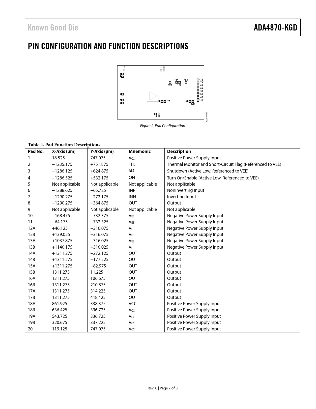

DescriptionHigh Speed, High Voltage, 1 A Output Drive Amplifier
Pages / Page8 / 7 — Known Good Die. ADA4870-KGD. PIN CONFIGURATION AND FUNCTION DESCRIPTIONS. …
File Format / SizePDF / 224 Kb
Known Good Die. ADA4870-KGD. PIN CONFIGURATION AND FUNCTION DESCRIPTIONS. 1 20. 3 4. 19A. 18A. 17B. 17A. 19B. 18B. 16B. 16A. 15B. 15A. 14B. 14A. 12A. 12B
Known Good Die ADA4870-KGD PIN CONFIGURATION AND FUNCTION DESCRIPTIONS 1 20 3 4 19A 18A 17B 17A 19B 18B 16B 16A 15B 15A 14B 14A 12A 12B
Known Good Die ADA4870-KGD PIN CONFIGURATION AND FUNCTION DESCRIPTIONS 2 1 20 3 4 19A 18A 17B 17A 19B 18B 16B 16A 15B 6 15A 14B 7 14A 12A 12B 13A 8 13B
-002
10 11
12203 Figure 2. Pad Configuration
Table 4. Pad Function Descriptions Pad No. X-Axis (μm) Y-Axis (μm) Mnemonic Description
1 18.525 747.075 VCC Positive Power Supply Input 2 −1235.175 +751.875 TFL Thermal Monitor and Short-Circuit Flag (Referenced to VEE) 3 −1286.125 +624.875 SD Shutdown (Active Low, Referenced to VEE) 4 −1286.525 +532.175 ON Turn On/Enable (Active Low, Referenced to VEE) 5 Not applicable Not applicable Not applicable Not applicable 6 −1288.625 −65.725 INP Noninverting Input 7 −1290.275 −272.175 INN Inverting Input 8 −1290.275 −364.875 OUT Output 9 Not applicable Not applicable Not applicable Not applicable 10 −168.475 −732.375 VEE Negative Power Supply Input 11 −64.175 −732.325 VEE Negative Power Supply Input 12A +46.125 −316.075 VEE Negative Power Supply Input 12B +139.025 −316.075 VEE Negative Power Supply Input 13A +1037.875 −316.025 VEE Negative Power Supply Input 13B +1140.175 −316.025 VEE Negative Power Supply Input 14A +1311.275 −272.125 OUT Output 14B +1311.275 −177.225 OUT Output 15A +1311.275 −82.975 OUT Output 15B 1311.275 11.225 OUT Output 16A 1311.275 106.675 OUT Output 16B 1311.275 210.875 OUT Output 17A 1311.275 314.225 OUT Output 17B 1311.275 418.425 OUT Output 18A 861.925 338.375 VCC Positive Power Supply Input 18B 636.425 336.725 VCC Positive Power Supply Input 19A 543.725 336.725 VCC Positive Power Supply Input 19B 320.675 337.225 VCC Positive Power Supply Input 20 119.125 747.075 VCC Positive Power Supply Input Rev. 0 | Page 7 of 8 Document Outline FEATURES APPLICATIONS FUNCTIONAL BLOCK DIAGRAM GENERAL DESCRIPTION TABLE OF CONTENTS REVISION HISTORY SPECIFICATIONS ±20 V SUPPLY ±5 V SUPPLY ABSOLUTE MAXIMUM RATINGS ESD CAUTION PIN CONFIGURATION AND FUNCTION DESCRIPTIONS OUTLINE DIMENSIONS DIE SPECIFICATIONS AND ASSEMBLY RECOMMENDATIONS ORDERING GUIDE
