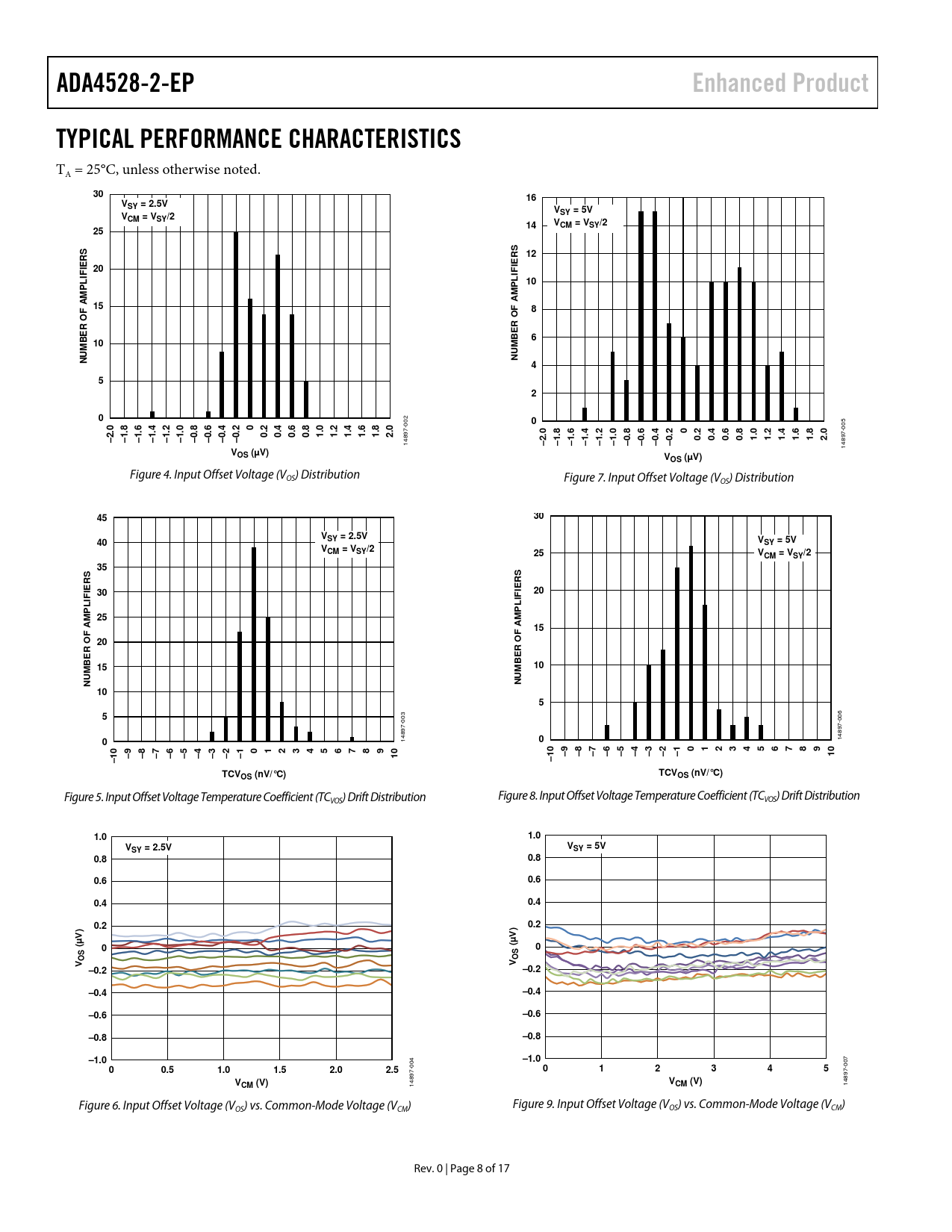

ADA4528-2-EP. Enhanced Product. TYPICAL PERFORMANCE CHARACTERISTICS. VSY = 2.5V. SY = 5V. CM = VSY/2. VCM = VSY/2. L 10. R O. NUM. –2. –1. –0
ADA4528-2-EP Enhanced Product TYPICAL PERFORMANCE CHARACTERISTICS
TA = 25°C, unless otherwise noted.
30 16 VSY = 2.5V V V SY = 5V CM = VSY/2 14 VCM = VSY/2 25 12 RS RS IE IE 20 IF IF L L 10 P P AM AM 15 F F 8 R O R O BE BE 6 10 NUM NUM 4 5 2 0
002
0 0 8 6 4 2 0 8 6 4 2 0 2 4 6 8 0 2 4 6 8 0
005
0 8 6 4 2 0 8 6 4 2 0 2 4 6 8 0 2 4 6 8 0 0. 0. 0. 0. 1. 1. 1. 1. 1. 2. –2. –1. –1. –1. –1. –1. –0. –0. –0. –0. 0. 0. 0. 0. 1. 1. 1. 1. 1. 2.
14897-
14897-
VOS (µV) VOS (µV)
Figure 4. Input Offset Voltage (VOS) Distribution Figure 7. Input Offset Voltage (V OS) Distribution
45 30 VSY = 2.5V 40 VSY = 5V VCM = VSY/2 25 VCM = VSY/2 35 S S R R 30 20 LIFIE LIFIE P P M 25 M A A 15 F F 20 R O R O BE BE 15 10 NUM NUM 10 5 5
003 006 14897-
0
14897-
0 0 1 2 3 4 5 6 7 8 9 0 1 2 3 4 5 6 7 8 9 –9 –8 –7 –6 –5 –4 –3 –2 –1 10 –9 –8 –7 –6 –5 –4 –3 –2 –1 10 –10 –10 TCV TCV OS (nV/°C) OS (nV/°C)
Figure 5. Input Offset Voltage Temperature Coefficient (TC Figure 8. Input Offset Voltage Temperature Coefficient (TC VOS) Drift Distribution VOS) Drift Distribution
1.0 1.0 V V SY = 2.5V SY = 5V 0.8 0.8 0.6 0.6 0.4 0.4 0.2 0.2 V) V) (µ 0 (µ 0 OS OS V V –0.2 –0.2 –0.4 –0.4 –0.6 –0.6 –0.8 –0.8 –1.0 –1.0
004 007
0 0.5 1.0 1.5 2.0 2.5 0 1 2 3 4 5 V V CM (V)
14897-
CM (V)
14897- Figure 6. Input Offset Voltage (V Figure 9. Input Offset Voltage (V OS) vs. Common-Mode Voltage (VCM) OS) vs. Common-Mode Voltage (VCM) Rev. 0 | Page 8 of 17 Document Outline FEATURES ENHANCED PRODUCT FEATURES APPLICATIONS PIN CONNECTION DIAGRAM GENERAL DESCRIPTION TABLE OF CONTENTS REVISION HISTORY SPECIFICATIONS ELECTRICAL CHARACTERISTICS—2.5 V OPERATION ELECTRICAL CHARACTERISTICS—5 V OPERATION ABSOLUTE MAXIMUM RATINGS THERMAL RESISTANCE ESD CAUTION PIN CONFIGURATION AND FUNCTION DESCRIPTIONS TYPICAL PERFORMANCE CHARACTERISTICS OUTLINE DIMENSIONS ORDERING GUIDE
