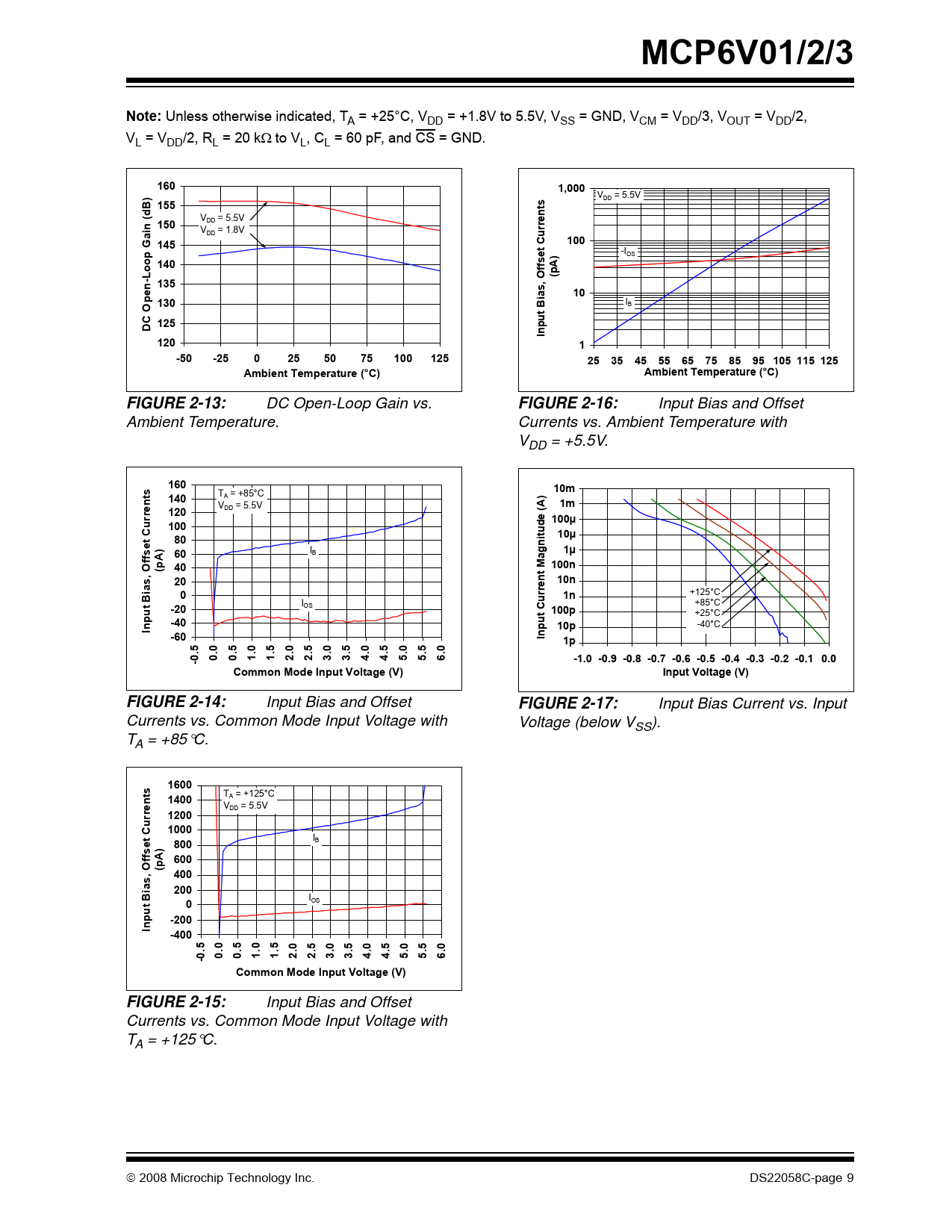

MCP6V01/2/3. Note:. 160. 1,000. B) 155. s nt. 150. rre. G 145. 100. 140. oop. fset. n 135. , Of. ias. 130. t B. C 125. pu In. 120. -50. -25. 125
MCP6V01/2/3 Note:
Unless otherwise indicated, TA = +25°C, VDD = +1.8V to 5.5V, VSS = GND, VCM = VDD/3, VOUT = VDD/2, VL = VDD/2, RL = 20 kΩ to VL, CL = 60 pF, and CS = GND.
160 1,000
VDD = 5.5V
B) 155 s nt (d
V
150
DD = 5.5V
in rre a
VDD = 1.8V
G 145 100 Cu
-IOS
140 oop fset A) -L (p n 135 , Of e 10 p ias 130
IB
O t B C 125 D pu In 120 1 -50 -25 0 25 50 75 100 125 25 35 45 55 65 75 85 95 105 115 125 Ambient Temperature (°C) Ambient Temperature (°C) FIGURE 2-13:
DC Open-Loop Gain vs.
FIGURE 2-16:
Input Bias and Offset Ambient Temperature. Currents vs. Ambient Temperature with VDD = +5.5V.
160 1.E-02 10m ts 140
TA = +85°C
n
V
1.E-03 1m 120
DD = 5.5V
(A) rre 1.E-04 100µ 100 t Cu 10µ 80 1.E-05 e ) 60
I
gnitude 1µ
B
1.E-06 ffs A (p 40 1.E 1 -07 00n , O s 20 1. nt Ma E-08 10n ia 0 rre
+125°C
1n B 1. u E-09
I +85°C
-20
OS
1. C t E 1 -10 00p
+25°C
-40 Input 1.E-11
-40°C
10p -60 Inpu1.E-12 1p .5 0 5 0 5 -0 0. 0.5 1.0 1.5 2.0 2.5 3.0 3. 4. 4. 5.0 5.5 6.0 -1.0 -0.9 -0.8 -0.7 -0.6 -0.5 -0.4 -0.3 -0.2 -0.1 0.0 Common Mode Input Voltage (V) Input Voltage (V) FIGURE 2-14:
FIGURE 2-17:
Input Bias Current vs. Input Currents vs. Common Mode Input Voltage with Voltage (below VSS). TA = +85°C.
1600 ts
T
n 1400
A = +125°C VDD = 5.5V
rre 1200 1000 t Cu
I
e 800
B
) ffs A 600 , O (p 400 s ia 200 B
I
0
OS
-200 Input -400 .5 0 5 0 5 0 5 0 5 0 5 0 5 0 -0 0. 0. 1. 1. 2. 2. 3. 3. 4. 4. 5. 5. 6. Common Mode Input Voltage (V) FIGURE 2-15:
Input Bias and Offset Currents vs. Common Mode Input Voltage with TA = +125°C. © 2008 Microchip Technology Inc. DS22058C-page 9 Document Outline 1.0 Electrical Characteristics 1.1 Absolute Maximum Ratings † 1.2 Specifications TABLE 1-1: DC Electrical Specifications TABLE 1-2: AC Electrical Specifications TABLE 1-3: Digital Electrical Specifications TABLE 1-4: Temperature Specifications 1.3 Timing Diagrams FIGURE 1-1: Amplifier Start Up. FIGURE 1-2: Offset Correction Settling Time. FIGURE 1-3: Output Overdrive Recovery. FIGURE 1-4: Chip Select (MCP6V03). 1.4 Test Circuits FIGURE 1-5: AC and DC Test Circuit for Most Non-Inverting Gain Conditions. FIGURE 1-6: AC and DC Test Circuit for Most Inverting Gain Conditions. FIGURE 1-7: Test Circuit for Dynamic Input Behavior. 2.0 Typical Performance Curves 2.1 DC Input Precision FIGURE 2-1: Input Offset Voltage. FIGURE 2-2: Input Offset Voltage Drift. FIGURE 2-3: Input Offset Voltage Quadratic Temp Co. FIGURE 2-4: Input Offset Voltage vs. Power Supply Voltage with VCM = VCMR_L. FIGURE 2-5: Input Offset Voltage vs. Power Supply Voltage with VCM = VCMR_H. FIGURE 2-6: Input Offset Voltage vs. Output Voltage. FIGURE 2-7: Input Offset Voltage vs. Common Mode Voltage with VDD = 1.8V. FIGURE 2-8: Input Offset Voltage vs. Common Mode Voltage with VDD = 5.5V. FIGURE 2-9: CMRR. FIGURE 2-10: PSRR. FIGURE 2-11: DC Open-Loop Gain. FIGURE 2-12: CMRR and PSRR vs. Ambient Temperature. FIGURE 2-13: DC Open-Loop Gain vs. Ambient Temperature. FIGURE 2-14: Input Bias and Offset Currents vs. Common Mode Input Voltage with TA = +85˚C. FIGURE 2-15: Input Bias and Offset Currents vs. Common Mode Input Voltage with TA = +125˚C. FIGURE 2-16: Input Bias and Offset Currents vs. Ambient Temperature with VDD = +5.5V. FIGURE 2-17: Input Bias Current vs. Input Voltage (below VSS). 2.2 Other DC Voltages and Currents FIGURE 2-18: Input Common Mode Voltage Headroom (Range) vs. Ambient Temperature. FIGURE 2-19: Output Voltage Headroom vs. Output Current. FIGURE 2-20: Output Voltage Headroom vs. Ambient Temperature. FIGURE 2-21: Output Short Circuit Current vs. Power Supply Voltage. FIGURE 2-22: Supply Current vs. Power Supply Voltage. FIGURE 2-23: Power On Reset Trip Voltage. FIGURE 2-24: Power On Reset Voltage vs. Ambient Temperature. 2.3 Frequency Response FIGURE 2-25: CMRR and PSRR vs. Frequency. FIGURE 2-26: Open-Loop Gain vs. Frequency with VDD = 1.8V. FIGURE 2-27: Open-Loop Gain vs. Frequency with VDD = 5.5V. FIGURE 2-28: Gain Bandwidth Product and Phase Margin vs. Ambient Temperature. FIGURE 2-29: Gain Bandwidth Product and Phase Margin vs. Common Mode Input Voltage. FIGURE 2-30: Gain Bandwidth Product and Phase Margin vs. Output Voltage. FIGURE 2-31: Closed-Loop Output Impedance vs. Frequency with VDD = 1.8V. FIGURE 2-32: Closed-Loop Output Impedance vs. Frequency with VDD = 5.5V. FIGURE 2-33: Channel-to-Channel Separation vs. Frequency. FIGURE 2-34: Maximum Output Voltage Swing vs. Frequency. 2.4 Input Noise and Distortion FIGURE 2-35: Input Noise Voltage Density vs. Frequency. FIGURE 2-36: Input Noise Voltage Density vs. Input Common Mode Voltage. FIGURE 2-37: Inter-Modulation Distortion vs. Frequency with VCM Disturbance (see Figure 1-7). FIGURE 2-38: Inter-Modulation Distortion vs. Frequency with VDD Disturbance (see Figure 1-7). FIGURE 2-39: Input Noise vs. Time with 1 Hz and 10 Hz Filters and VDD =1.8V. FIGURE 2-40: Input Noise vs. Time with 1 Hz and 10 Hz Filters and VDD =5.5V. 2.5 Time Response FIGURE 2-41: Input Offset Voltage vs. Time with Temperature Change. FIGURE 2-42: Input Offset Voltage vs. Time at Power Up. FIGURE 2-43: The MCP6V01/2/3 family shows no input phase reversal with overdrive. FIGURE 2-44: Non-inverting Small Signal Step Response. FIGURE 2-45: Non-inverting Large Signal Step Response. FIGURE 2-46: Inverting Small Signal Step Response. FIGURE 2-47: Inverting Large Signal Step Response. FIGURE 2-48: Slew Rate vs. Ambient Temperature. FIGURE 2-49: Output Overdrive Recovery vs. Time with G = -100 V/V. FIGURE 2-50: Output Overdrive Recovery Time vs. Inverting Gain. 2.6 Chip Select Response (MCP6V03 only) FIGURE 2-51: Chip Select Current vs. Power Supply Voltage. FIGURE 2-52: Power Supply Current vs. Chip Select Voltage with VDD = 1.8V. FIGURE 2-53: Power Supply Current vs. Chip Select Voltage with VDD = 5.5V. FIGURE 2-54: Chip Select Current vs. Chip Select Voltage. FIGURE 2-55: Chip Select Voltage, Output Voltage vs. Time with VDD = 1.8V. FIGURE 2-56: Chip Select Voltage, Output Voltage vs. Time with VDD = 5.5V. FIGURE 2-57: Chip Select Relative Logic Thresholds vs. Ambient Temperature. FIGURE 2-58: Chip Select Hysteresis. FIGURE 2-59: Chip Select Turn On Time vs. Ambient Temperature. FIGURE 2-60: Chip Select’s Pull-down Resistor (RPD) vs. Ambient Temperature. FIGURE 2-61: Quiescent Current in Shutdown vs. Power Supply Voltage. 3.0 Pin Descriptions TABLE 3-1: Pin Function Table 3.1 Analog Outputs 3.2 Analog Inputs 3.3 Power Supply Pins 3.4 Chip Select (CS) Digital Input 3.5 Exposed Thermal Pad (EP) 4.0 Applications 4.1 Overview of Auto-zeroing Operation FIGURE 4-1: Simplified Auto-zeroed Op Amp Functional Diagram. FIGURE 4-2: Normal Mode of Operation (f1); Equivalent Amplifier Diagram. FIGURE 4-3: Auto-zeroing Mode of Operation (f2); Equivalent Diagram. 4.2 Other Functional Blocks FIGURE 4-4: Simplified Analog Input ESD Structures. FIGURE 4-5: Protecting the Analog Inputs. 4.3 Application Tips FIGURE 4-6: Output Resistor, RISO, Stabilizes Capacitive Loads. FIGURE 4-7: Recommended RISO values for Capacitive Loads. FIGURE 4-8: Output Load Issue. FIGURE 4-9: One Solution To Output Load Issue. FIGURE 4-10: Additional Supply Filtering. FIGURE 4-11: PCB Layout and Schematic for Single Non-inverting and Inverting Amplifiers. FIGURE 4-12: PCB Layout and Schematic for Single Difference Amplifier. FIGURE 4-13: PCB Layout and Schematic for Dual Non-inverting Amplifier. FIGURE 4-14: PCB Layout for Individual Resistors. 4.4 Typical Applications FIGURE 4-15: Simple Design. FIGURE 4-16: High Performance Design. FIGURE 4-17: RTD Sensor. FIGURE 4-18: Thermocouple Sensor; Simplified Circuit. FIGURE 4-19: Thermocouple Sensor. FIGURE 4-20: Offset Correction. FIGURE 4-21: Precision Comparator. 5.0 Design Aids 5.1 SPICE Macro Model 5.2 FilterLab® Software 5.3 Mindi™ Circuit Designer & Simulator 5.4 Microchip Advanced Part Selector (MAPS) 5.5 Analog Demonstration and Evaluation Boards 5.6 Application Notes 6.0 Packaging Information 6.1 Package Marking Information
