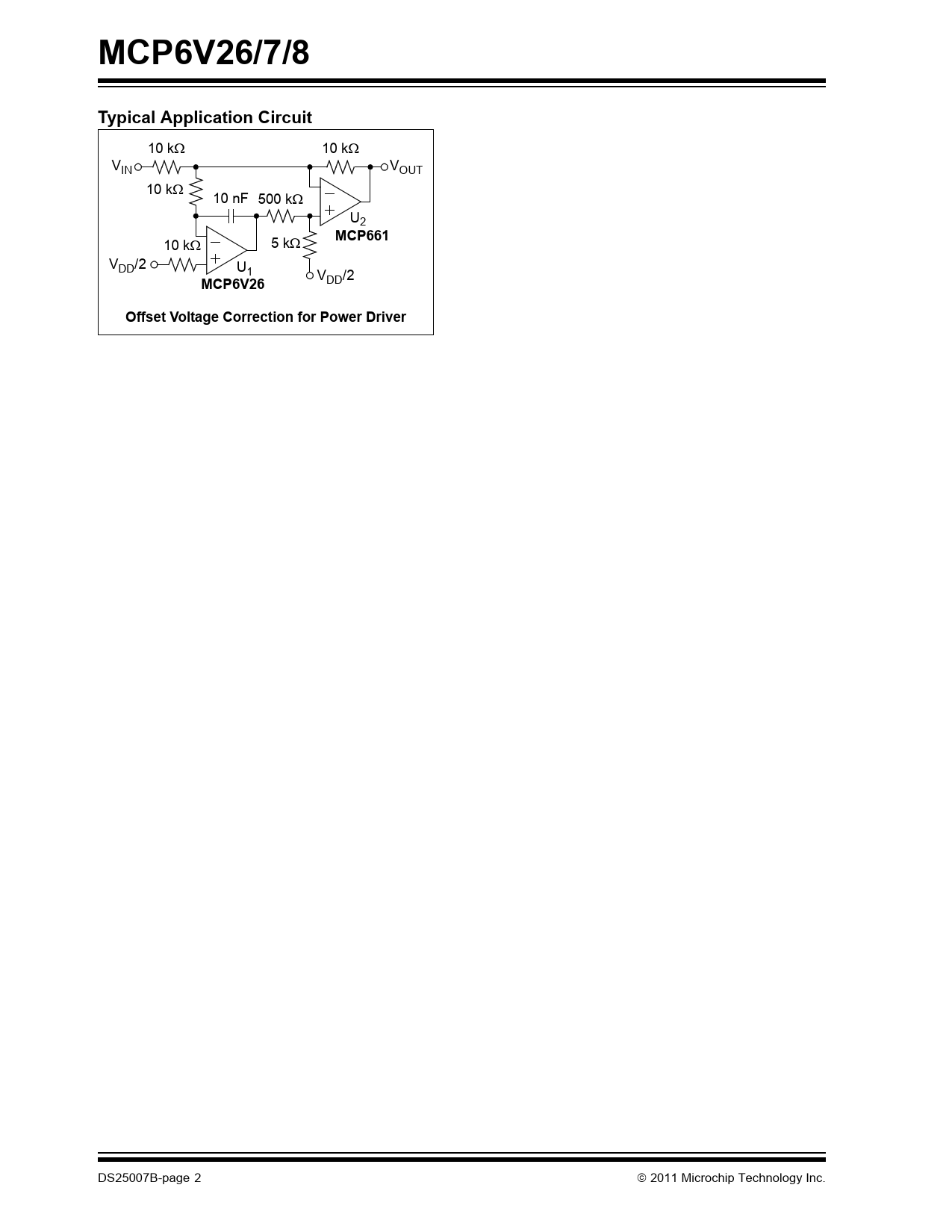

MCP6V26/7/8. Typical Application Circuit. MCP661. MCP6V26. Offset Voltage Correction for Power Driver
MCP6V26/7/8 Typical Application Circuit MCP661 MCP6V26 Offset Voltage Correction for Power Driver
10 kΩ 10 kΩ VIN VOUT 10 kΩ 10 nF 500 kΩ U2
MCP661
10 kΩ 5 kΩ VDD/2 U1 V
MCP6V26
DD/2
