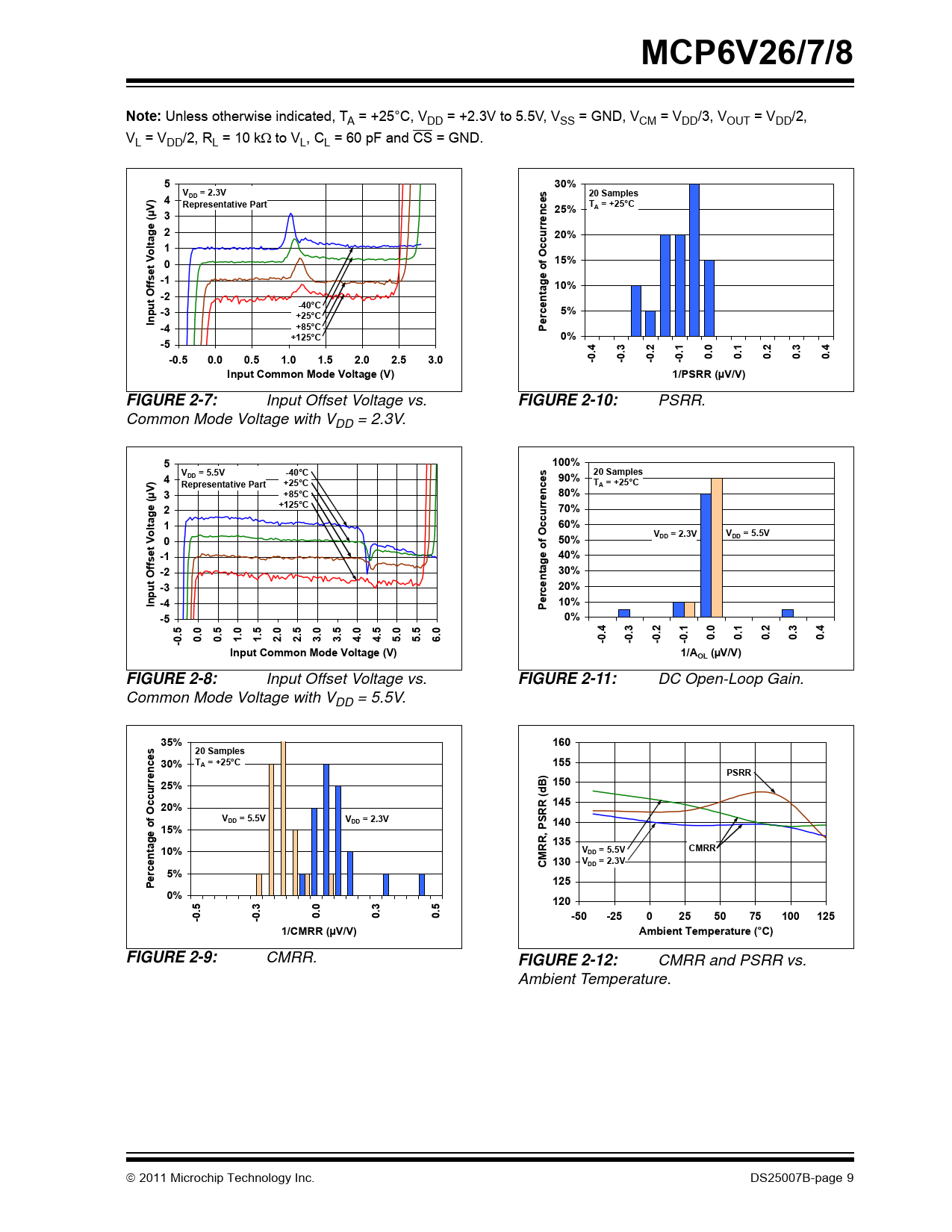

MCP6V26/7/8. Note:. 30%. ) 4. DD = 2.3V. 20 Samples. Representative Part. nc 25%. A = +25°C. (µ 3. e 2. rre 20%. ltag 1. Occu. t V 0. 15%. e of. ffse. 10%
MCP6V26/7/8 Note:
Unless otherwise indicated, TA = +25°C, VDD = +2.3V to 5.5V, VSS = GND, VCM = VDD/3, VOUT = VDD/2, VL = VDD/2, RL = 10 kΩ to VL, CL = 60 pF and CS = GND.
5 30% V ) 4 DD = 2.3V es 20 Samples V Representative Part T nc 25% A = +25°C (µ 3 e 2 rre 20% ltag 1 o Occu t V 0 15% -1 e of ffse 10% -2 tag t O n u -40°C p -3 +25°C 5% In erce -4 +85°C P +125°C 0% -5 1 4 -0.5 0.0 0.5 1.0 1.5 2.0 2.5 3.0 -0.4 -0.3 -0.2 -0. 0.0 0.1 0.2 0.3 0. Input Common Mode Voltage (V) 1/PSRR (µV/V) FIGURE 2-7:
Input Offset Voltage vs.
FIGURE 2-10:
PSRR. Common Mode Voltage with VDD = 2.3V.
5 100% V -40°C s 20 Samples 4 DD = 5.5V 90% T V) Representative Part +25°C ce A = +25°C 3 +85°C 80% (µ e 2 +125°C rren 70% cu ltag 1 c 60% O V 0 50% DD = 2.3V VDD = 5.5V of -1 e 40% ffset Vo g -2 a 30% t O -3 20% Inpu -4 ercent 10% P -5 0% 5 5 0 0 5 0 0 .4 .3 .2 .1 0 2 3 4 -0. 0.0 0. 1. 1.5 2.0 2.5 3. 3. 4. 4.5 5.0 5.5 6. -0 -0 -0 -0 0. 0.1 0. 0. 0. Input Common Mode Voltage (V) 1/AOL (µV/V) FIGURE 2-8:
FIGURE 2-11:
DC Open-Loop Gain. Common Mode Voltage with VDD = 5.5V.
35% 160 20 Samples ces 30% TA = +25°C 155 PSRR ren 25% B) 150 d ( ccur 20% 145 RR VDD = 5.5V V S of O DD = 2.3V 140 15% , P 135 tage 10% RR V CMRR n M DD = 5.5V 130 C VDD = 2.3V rce 5% e P 125 0% 120 .5 .3 0 3 5 -0 -0 0. 0. 0. -50 -25 0 25 50 75 100 125 1/CMRR (µV/V) Ambient Temperature (°C) FIGURE 2-9:
CMRR.
FIGURE 2-12:
CMRR and PSRR vs. Ambient Temperature. © 2011 Microchip Technology Inc. DS25007B-page 9 Document Outline 1.0 Electrical Characteristics 1.1 Absolute Maximum Ratings † 1.2 Specifications TABLE 1-1: DC Electrical Specifications TABLE 1-2: AC Electrical Specifications TABLE 1-3: Digital Electrical Specifications TABLE 1-4: Temperature Specifications 1.3 Timing Diagrams FIGURE 1-1: Amplifier Start Up. FIGURE 1-2: Offset Correction Settling Time. FIGURE 1-3: Output Overdrive Recovery. FIGURE 1-4: Chip Select (MCP6V28). 1.4 Test Circuits FIGURE 1-5: AC and DC Test Circuit for Most Non-Inverting Gain Conditions. FIGURE 1-6: AC and DC Test Circuit for Most Inverting Gain Conditions. FIGURE 1-7: Test Circuit for Dynamic Input Behavior. 2.0 Typical Performance Curves 2.1 DC Input Precision FIGURE 2-1: Input Offset Voltage. FIGURE 2-2: Input Offset Voltage Drift. FIGURE 2-3: Input Offset Voltage Quadratic Temperature Coefficient. FIGURE 2-4: Input Offset Voltage vs. Power Supply Voltage with VCM = VCML. FIGURE 2-5: Input Offset Voltage vs. Power Supply Voltage with VCM = VCMH. FIGURE 2-6: Input Offset Voltage vs. Output Voltage. FIGURE 2-7: Input Offset Voltage vs. Common Mode Voltage with VDD = 2.3V. FIGURE 2-8: Input Offset Voltage vs. Common Mode Voltage with VDD = 5.5V. FIGURE 2-9: CMRR. FIGURE 2-10: PSRR. FIGURE 2-11: DC Open-Loop Gain. FIGURE 2-12: CMRR and PSRR vs. Ambient Temperature. FIGURE 2-13: DC Open-Loop Gain vs. Ambient Temperature. FIGURE 2-14: Input Bias and Offset Currents vs. Common Mode Input Voltage with TA = +85°C. FIGURE 2-15: Input Bias and Offset Currents vs. Common Mode Input Voltage with TA = +125°C. FIGURE 2-16: Input Bias and Offset Currents vs. Ambient Temperature with VDD = +5.5V. FIGURE 2-17: Input Bias Current vs. Input Voltage (below VSS). 2.2 Other DC Voltages and Currents FIGURE 2-18: Input Common Mode Voltage Headroom (Range) vs. Ambient Temperature. FIGURE 2-19: Output Voltage Headroom vs. Output Current. FIGURE 2-20: Output Voltage Headroom vs. Ambient Temperature. FIGURE 2-21: Output Short Circuit Current vs. Power Supply Voltage. FIGURE 2-22: Supply Current vs. Power Supply Voltage. FIGURE 2-23: Power On Reset Trip Voltage. FIGURE 2-24: Power On Reset Voltage vs. Ambient Temperature. 2.3 Frequency Response FIGURE 2-25: CMRR and PSRR vs. Frequency. FIGURE 2-26: Open-Loop Gain vs. Frequency with VDD = 2.3V. FIGURE 2-27: Open-Loop Gain vs. Frequency with VDD = 5.5V. FIGURE 2-28: Gain Bandwidth Product and Phase Margin vs. Ambient Temperature. FIGURE 2-29: Gain Bandwidth Product and Phase Margin vs. Common Mode Input Voltage. FIGURE 2-30: Gain Bandwidth Product and Phase Margin vs. Output Voltage. FIGURE 2-31: Closed-Loop Output Impedance vs. Frequency with VDD = 2.3V. FIGURE 2-32: Closed-Loop Output Impedance vs. Frequency with VDD = 5.5V. FIGURE 2-33: Channel-to-Channel Separation vs. Frequency. FIGURE 2-34: Maximum Output Voltage Swing vs. Frequency. 2.4 Input Noise and Distortion FIGURE 2-35: Input Noise Voltage Density and Integrated Input Noise Voltage vs. Frequency. FIGURE 2-36: Input Noise Voltage Density vs. Input Common Mode Voltage. FIGURE 2-37: Intermodulation Distortion vs. Frequency with VCM Disturbance (see Figure 1-7). FIGURE 2-38: Intermodulation Distortion vs. Frequency with VDD Disturbance (see Figure 1-7). FIGURE 2-39: Input Noise vs. Time with 1 Hz and 10 Hz Filters and VDD =2.3V. FIGURE 2-40: Input Noise vs. Time with 1 Hz and 10 Hz Filters and VDD =5.5V. 2.5 Time Response FIGURE 2-41: Input Offset Voltage vs. Time with Temperature Change. FIGURE 2-42: Input Offset Voltage vs. Time at Power Up. FIGURE 2-43: The MCP6V26/7/8 Device Shows No Input Phase Reversal with Overdrive. FIGURE 2-44: Non-inverting Small Signal Step Response. FIGURE 2-45: Non-inverting Large Signal Step Response. FIGURE 2-46: Inverting Small Signal Step Response. FIGURE 2-47: Inverting Large Signal Step Response. FIGURE 2-48: Slew Rate vs. Ambient Temperature. FIGURE 2-49: Output Overdrive Recovery vs. Time with G = -100 V/V. FIGURE 2-50: Output Overdrive Recovery Time vs. Inverting Gain. 2.6 Chip Select Response (MCP6V28 only) FIGURE 2-51: Chip Select Current vs. Power Supply Voltage. FIGURE 2-52: Power Supply Current vs. Chip Select Voltage with VDD = 2.3V. FIGURE 2-53: Power Supply Current vs. Chip Select Voltage with VDD = 5.5V. FIGURE 2-54: Chip Select Current vs. Chip Select Voltage. FIGURE 2-55: Chip Select Voltage, Output Voltage vs. Time with VDD = 2.3V. FIGURE 2-56: Chip Select Voltage, Output Voltage vs. Time with VDD = 5.5V. FIGURE 2-57: Chip Select Relative Logic Thresholds vs. Ambient Temperature. FIGURE 2-58: Chip Select Hysteresis. FIGURE 2-59: Chip Select Turn On Time vs. Ambient Temperature. FIGURE 2-60: Chip Select’s Pull-down Resistor (RPD) vs. Ambient Temperature. FIGURE 2-61: Quiescent Current in Shutdown vs. Power Supply Voltage. 3.0 Pin Descriptions TABLE 3-1: Pin Function Table 3.1 Analog Outputs 3.2 Analog Inputs 3.3 Power Supply Pins 3.4 Chip Select (CS) Digital Input 3.5 Exposed Thermal Pad (EP) 4.0 Applications 4.1 Overview of Auto-Zeroing Operation FIGURE 4-1: Simplified Auto-Zeroed Op Amp Functional Diagram. FIGURE 4-2: Normal Mode of Operation (f1); Equivalent Amplifier Diagram. FIGURE 4-3: Auto-zeroing Mode of Operation (f2); Equivalent Diagram. 4.2 Other Functional Blocks FIGURE 4-4: Simplified Analog Input ESD Structures. FIGURE 4-5: Protecting the Analog Inputs Against High Voltages. FIGURE 4-6: Protecting the Analog Inputs Against High Currents. 4.3 Application Tips FIGURE 4-7: Output Resistor, RISO, Stabilizes Capacitive Loads. FIGURE 4-8: Recommended RISO values for Capacitive Loads. FIGURE 4-9: Output Load. FIGURE 4-10: Amplifier with Parasitic Capacitance. FIGURE 4-11: Additional Supply Filtering. 4.4 Typical Applications FIGURE 4-12: Simple Design. FIGURE 4-13: High Performance Design. FIGURE 4-14: RTD Sensor. FIGURE 4-15: Thermocouple Sensor; Simplified Circuit. FIGURE 4-16: Thermocouple Sensor. FIGURE 4-17: Offset Correction. FIGURE 4-18: Precision Comparator. 5.0 Design Aids 5.1 SPICE Macro Model 5.2 FilterLab® Software 5.3 Microchip Advanced Part Selector (MAPS) 5.4 Analog Demonstration and Evaluation Boards 5.5 Application Notes 6.0 Packaging Information 6.1 Package Marking Information Appendix A: Revision History Appendix B: Offset Related Test Screens Product Identification System Trademarks Worldwide Sales and Service
