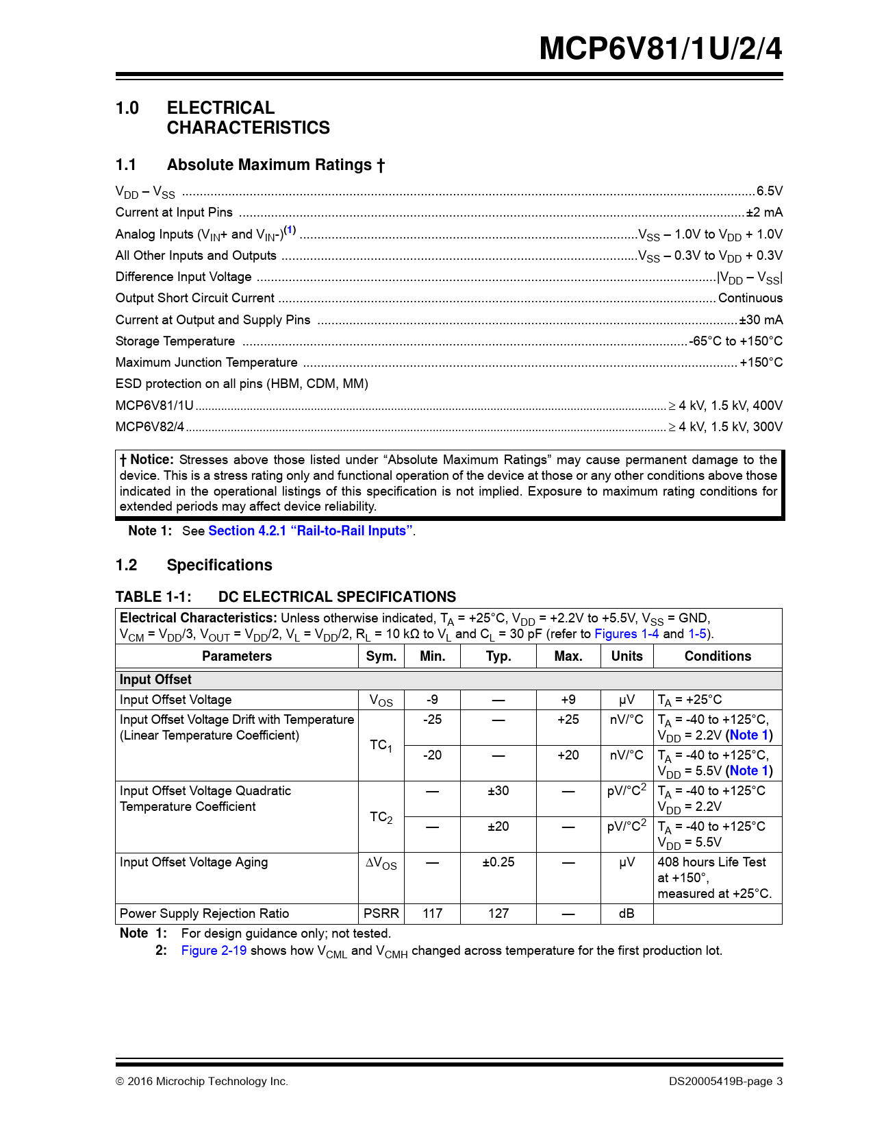

MCP6V81/1U/2/4 1.0 ELECTRICAL CHARACTERISTICS 1.1 Absolute Maximum Ratings †
VDD – VSS ...6.5V Current at Input Pins ..±2 mA Analog Inputs (VIN+ and VIN-)
(1)
...VSS – 1.0V to VDD + 1.0V All Other Inputs and Outputs ..VSS – 0.3V to VDD + 0.3V Difference Input Voltage ...|VDD – VSS| Output Short Circuit Current ... Continuous Current at Output and Supply Pins ..±30 mA Storage Temperature ...-65°C to +150°C Maximum Junction Temperature .. +150°C ESD protection on all pins (HBM, CDM, MM) MCP6V81/1U   4 kV, 1.5 kV, 400V MCP6V82/4  4 kV, 1.5 kV, 300V
† Notice:
Stresses above those listed under “Absolute Maximum Ratings” may cause permanent damage to the device. This is a stress rating only and functional operation of the device at those or any other conditions above those indicated in the operational listings of this specification is not implied. Exposure to maximum rating conditions for extended periods may affect device reliability.
Note 1:
See
Section 4.2.1 “Rail-to-Rail Inputs”
1.2 Specifications TABLE 1-1: DC ELECTRICAL SPECIFICATIONS Electrical Characteristics:
Unless otherwise indicated, TA = +25°C, VDD = +2.2V to +5.5V, VSS = GND, VCM = VDD/3, VOUT = VDD/2, VL = VDD/2, RL = 10 kΩ to VL and CL = 30 pF (refer to Figures 1-4 and 1-5).
Parameters Sym. Min. Typ. Max. Units Conditions Input Offset
Input Offset Voltage VOS -9 — +9 µV TA = +25°C Input Offset Voltage Drift with Temperature -25 — +25 nV/°C TA = -40 to +125°C, (Linear Temperature Coefficient) V TC DD = 2.2V
(Note 1)
1 -20 — +20 nV/°C TA = -40 to +125°C, VDD = 5.5V
(Note 1)
Input Offset Voltage Quadratic — ±30 — pV/°C2 TA = -40 to +125°C Temperature Coefficient V TC DD = 2.2V 2 — ±20 — pV/°C2 TA = -40 to +125°C VDD = 5.5V Input Offset Voltage Aging ∆VOS — ±0.25 — µV 408 hours Life Test at +150°, measured at +25°C. Power Supply Rejection Ratio PSRR 117 127 — dB
Note 1:
For design guidance only; not tested.
