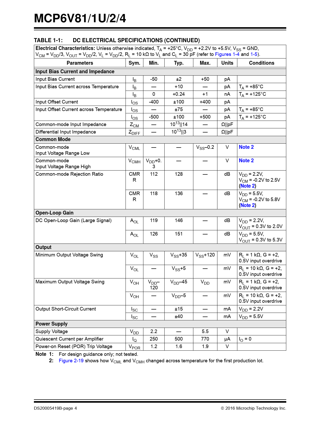

MCP6V81/1U/2/4. TABLE 1-1:. DC ELECTRICAL SPECIFICATIONS (CONTINUED). Electrical Characteristics:. Parameters. Sym. Min. Typ. Max. Units
MCP6V81/1U/2/4 TABLE 1-1: DC ELECTRICAL SPECIFICATIONS (CONTINUED) Electrical Characteristics: Parameters Sym Min Typ Max Units
link to page 3 link to page 3 link to page 3 link to page 3
Unless otherwise indicated, TA = +25°C, VDD = +2.2V to +5.5V, VSS = GND, VCM = VDD/3, VOUT = VDD/2, VL = VDD/2, RL = 10 kΩ to VL and CL = 30 pF (refer to Figures 1-4 and 1-5).
Parameters Sym. Min. Typ. Max. Units Conditions Input Bias Current and Impedance
Input Bias Current IB -50 ±2 +50 pA Input Bias Current across Temperature IB — +10 — pA TA = +85°C IB 0 +0.24 +1 nA TA = +125°C Input Offset Current IOS -400 ±100 +400 pA Input Offset Current across Temperature IOS — ±75 — pA TA = +85°C IOS -500 ±100 +500 pA TA = +125°C Common-mode Input Impedance ZCM — 1013||14 — Ω||pF Differential Input Impedance ZDIFF — 1013||3 — Ω||pF
Common Mode
Common-mode VCML — — VSS–0.2 V
Note 2
Input Voltage Range Low Common-mode VCMH VDD+0. — — V
Note 2
Input Voltage Range High 3 Common-mode Rejection Ratio CMR 112 128 — dB VDD = 2.2V, R VCM = -0.2V to 2.5V
(Note 2 )
CMR 118 136 — dB VDD = 5.5V, R VCM = -0.2V to 5.8V
(Note 2 ) Open-Loop Gain
DC Open-Loop Gain (Large Signal) AOL 119 146 — dB VDD = 2.2V, VOUT = 0.3V to 2.0V AOL 126 151 — dB VDD = 5.5V, VOUT = 0.3V to 5.3V
Output
Minimum Output Voltage Swing VOL VSS VSS+35 VSS+120 mV RL = 1 kΩ, G = +2, 0.5V input overdrive VOL — VSS+5 — mV RL = 10 kΩ, G = +2, 0.5V input overdrive Maximum Output Voltage Swing VOH VDD– VDD–45 VDD mV RL = 1 kΩ, G = +2, 120 0.5V input overdrive VOH — VDD–5 — mV RL = 10 kΩ, G = +2, 0.5V input overdrive Output Short-Circuit Current ISC — ±15 — mA VDD = 2.2V ISC — ±40 — mA VDD = 5.5V
Power Supply
Supply Voltage VDD 2.2 — 5.5 V Quiescent Current per Amplifier IQ 250 500 770 µA IO = 0 Power-on Reset (POR) Trip Voltage VPOR 1.2 1.6 1.9 V
