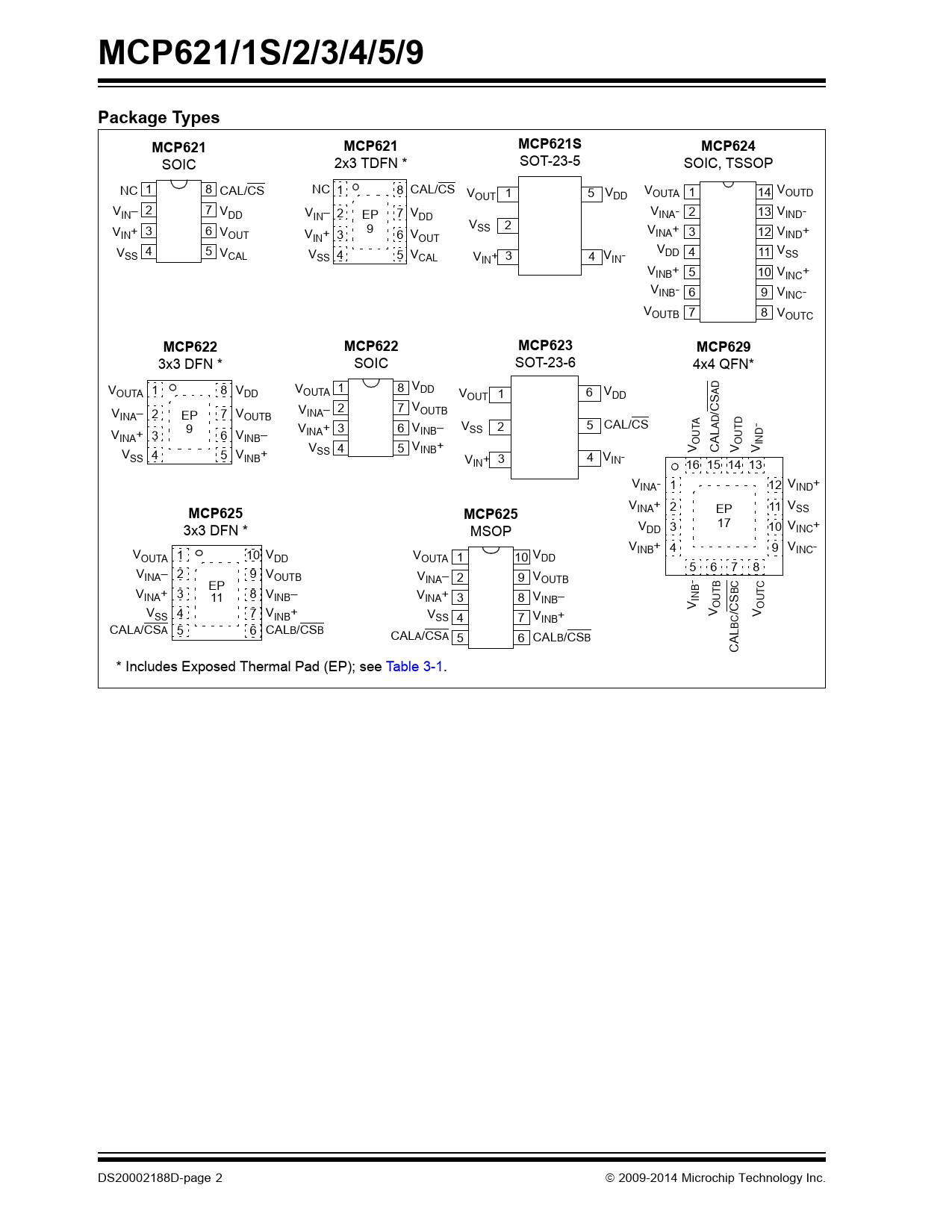

Pages / Page62 / 2 — MCP621/1S/2/3/4/5/9. Package Types. MCP621. MCP621S. MCP624. MCP622. …
MCP621/1S/2/3/4/5/9. Package Types. MCP621. MCP621S. MCP624. MCP622. MCP623. MCP629. MCP625
MCP621/1S/2/3/4/5/9 Package Types MCP621 MCP621S MCP624 MCP622 MCP623 MCP629 MCP625
MCP621
MCP621S
MCP622
MCP623
MCP624
MCP625
MCP629
link to page 20
MCP621/1S/2/3/4/5/9 Package Types MCP621 MCP621 MCP621S MCP624
SOIC 2x3 TDFN * SOT-23-5 SOIC, TSSOP NC 1 8 CAL/CS NC 1 8 CAL/CS V 1 5 V V DD OUTA 1 14 VOUTD OUT VIN– 2 7 VDD V 2 EP 7 V V IN– DD INA- 2 13 VIND- V 2 V 9 SS V IN+ 3 6 VOUT V 3 6 V INA+ 3 12 VIND+ IN+ OUT V V V SS 4 5 VCAL V DD 4 5 V 4 11 3 4 V SS SS CAL VIN+ IN- VINB+ 5 10 VINC+ VINB- 6 9 VINC- VOUTB 7 8 VOUTC
MCP622 MCP622 MCP623 MCP629
3x3 DFN * SOIC SOT-23-6 4x4 QFN* V 1 8 V V 1 8 V OUTA DD OUTA DD 1 6 V AD VOUT DD V V V 2 EP 7 V INA– 2 7 OUTB /CS INA– OUTB 9 V V 2 5 CAL/CS - INA+ 3 6 VINB– TA TD V SS LAD D INA+ 3 6 VINB– V OU OU IN SS 4 5 VINB+ V V CA V V SS 4 5 VINB+ V 3 4 V IN+ IN- 16 15 14 13 VINA- 1 12 VIND+ V 11 V
MCP625
INA+ 2
MCP625
EP SS 3x3 DFN * 17 MSOP VDD 3 10 VINC+ V 4 9 V V 1 10 V INB+ INC- OUTA DD VOUTA 1 10 VDD V 5 6 7 8 2 9 V INA– OUTB VINA– 2 9 VOUTB EP - V B TB BC TC INA+ 3 8 V 11 INB– VINA+ 3 8 VINB– IN S V OU OU V /C SS 4 7 VINB+ V V V SS 4 7 VINB+ CALA/CSA 5 6 CALB/CSB CAL LBC A/CSA 5 6 CALB/CSB CA * Includes Exposed Thermal Pad (EP); see Table 3-1. DS20002188D-page 2  2009-2014 Microchip Technology Inc. Document Outline 20 MHz, 200 µV Op Amps with mCal Features Typical Applications Design Aids Description Typical Application Circuit High Gain-Bandwidth Op Amp Portfolio Package Types 1.0 Electrical Characteristics 1.1 Absolute Maximum Ratings † 1.2 Specifications TABLE 1-1: DC Electrical Specifications TABLE 1-2: AC Electrical Specifications TABLE 1-3: Digital Electrical Specifications TABLE 1-4: Temperature Specifications 1.3 Timing Diagram FIGURE 1-1: Timing Diagram. 1.4 Test Circuits FIGURE 1-2: AC and DC Test Circuit for Most Specifications. 2.0 Typical Performance Curves 2.1 DC Signal Inputs FIGURE 2-1: Input Offset Voltage. FIGURE 2-2: Input Offset Voltage Drift. FIGURE 2-3: Input Offset Voltage Repeatability (repeated calibration). FIGURE 2-4: Input Offset Voltage vs. Power Supply Voltage. FIGURE 2-5: Input Offset Voltage vs. Output Voltage. FIGURE 2-6: Low Input Common Mode Voltage Headroom vs. Ambient Temperature. FIGURE 2-7: High Input Common Mode Voltage Headroom vs. Ambient Temperature. FIGURE 2-8: Input Offset Voltage vs. Common Mode Voltage with VDD = 2.5V. FIGURE 2-9: Input Offset Voltage vs. Common Mode Voltage with VDD = 5.5V. FIGURE 2-10: CMRR and PSRR vs. Ambient Temperature. FIGURE 2-11: DC Open-Loop Gain vs. Ambient Temperature. FIGURE 2-12: Input Bias and Offset Currents vs. Ambient Temperature with VDD = +5.5V. FIGURE 2-13: Input Bias and Offset Currents vs. Common Mode Input Voltage with TA = +85°C. FIGURE 2-14: Input Bias and Offset Currents vs. Common Mode Input Voltage with TA = +125°C. FIGURE 2-15: Input Bias Current vs. Input Voltage (below VSS). 2.2 Other DC Voltages and Currents FIGURE 2-16: Ratio of Output Voltage Headroom to Output Current. FIGURE 2-17: Output Voltage Headroom vs. Ambient Temperature. FIGURE 2-18: Output Short-Circuit Current vs. Power Supply Voltage. FIGURE 2-19: Supply Current vs. Power Supply Voltage. FIGURE 2-20: Supply Current vs. Common Mode Input Voltage. FIGURE 2-21: Power-On Reset Voltages vs. Ambient Temperature. FIGURE 2-22: Normalized Internal Calibration Voltage. FIGURE 2-23: VCAL Input Resistance vs. Temperature. 2.3 Frequency Response FIGURE 2-24: CMRR and PSRR vs. Frequency. FIGURE 2-25: Open-Loop Gain vs. Frequency. FIGURE 2-26: Gain Bandwidth Product and Phase Margin vs. Ambient Temperature. FIGURE 2-27: Gain Bandwidth Product and Phase Margin vs. Common Mode Input Voltage. FIGURE 2-28: Gain Bandwidth Product and Phase Margin vs. Output Voltage. FIGURE 2-29: Closed-Loop Output Impedance vs. Frequency. FIGURE 2-30: Gain Peaking vs. Normalized Capacitive Load. FIGURE 2-31: Channel-to-Channel Separation vs. Frequency. 2.4 Input Noise and Distortion FIGURE 2-32: Input Noise Voltage Density vs. Frequency. FIGURE 2-33: Input Noise Voltage Density vs. Input Common Mode Voltage with f = 100 Hz. FIGURE 2-34: Input Noise Voltage Density vs. Input Common Mode Voltage with f = 1 MHz. FIGURE 2-35: Input Noise plus Offset vs. Time with 0.1 Hz Filter. FIGURE 2-36: THD+N vs. Frequency. 2.5 Time Response FIGURE 2-37: Non-Inverting Small Signal Step Response. FIGURE 2-38: Non-Inverting Large Signal Step Response. FIGURE 2-39: Inverting Small Signal Step Response. FIGURE 2-40: Inverting Large Signal Step Response. FIGURE 2-41: The MCP621/1S/2/3/4/5/9 Family Shows No Input Phase Reversal with Overdrive. FIGURE 2-42: Slew Rate vs. Ambient Temperature. FIGURE 2-43: Maximum Output Voltage Swing vs. Frequency. 2.6 Calibration and Chip Select Response FIGURE 2-44: CAL/CS Current vs. Power Supply Voltage. FIGURE 2-45: CAL/CS Voltage, Output Voltage and Supply Current (for Side A) vs. Time with VDD = 2.5V. FIGURE 2-46: CAL/CS Voltage, Output Voltage and Supply Current (for Side A) vs. Time with VDD = 5.5V. FIGURE 2-47: CAL/CS Hysteresis vs. Ambient Temperature. FIGURE 2-48: CAL/CS Turn-On Time vs. Ambient Temperature. FIGURE 2-49: CAL/CS’s Pull-Down Resistor (RPD) vs. Ambient Temperature. FIGURE 2-50: Quiescent Current in Shutdown vs. Power Supply Voltage. FIGURE 2-51: Output Leakage Current vs. Output Voltage. 3.0 Pin Descriptions TABLE 3-1: Pin Function Table 3.1 Analog Outputs 3.2 Analog Inputs 3.3 Power Supply Pins 3.4 Calibration Common Mode Voltage Input 3.5 Calibrate/Chip Select Digital Input 3.6 Exposed Thermal Pad (EP) 4.0 Applications 4.1 Calibration and Chip Select FIGURE 4-1: Common-Mode Reference’s Input Circuitry. FIGURE 4-2: Setting VCM with External Resistors. 4.2 Input FIGURE 4-3: Simplified Analog Input ESD Structures. FIGURE 4-4: Protecting the Analog Inputs. FIGURE 4-5: Unity Gain Voltage Limitations for Linear Operation. 4.3 Rail-to-Rail Output FIGURE 4-6: Output Current. FIGURE 4-7: Diagram for Resistive Load Power Calculations. FIGURE 4-8: Diagram for Capacitive Load Power Calculations. 4.4 Improving Stability FIGURE 4-9: Output Resistor, RISO Stabilizes Large Capacitive Loads. FIGURE 4-10: Recommended RISO Values for Capacitive Loads. FIGURE 4-11: Amplifier with Parasitic Capacitance. FIGURE 4-12: Maximum Recommended RF vs. Gain. 4.5 Power Supply 4.6 High Speed PCB Layout 4.7 Typical Applications FIGURE 4-13: Power Driver. FIGURE 4-14: Transimpedance Amplifier for an Optical Detector. FIGURE 4-15: H-Bridge Driver. 5.0 Design Aids 5.1 SPICE Macro Model 5.2 FilterLab® Software 5.3 Microchip Advanced Part Selector (MAPS) 5.4 Analog Demonstration and Evaluation Boards 5.5 Application Notes 6.0 Packaging Information 6.1 Package Marking Information Appendix A: Revision History Product Identification System Trademarks Worldwide Sales and Service
