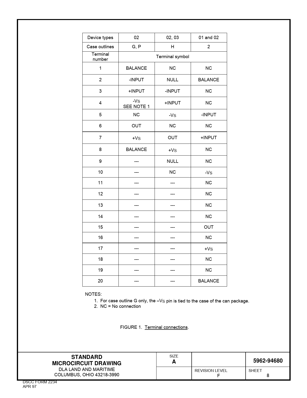

STANDARD. 5962-94680. MICROCIRCUIT DRAWING
Device types 02 02, 03 01 and 02 Case outlines G, P H 2 Terminal Terminal symbol number 1 BALANCE NC NC 2 -INPUT NULL BALANCE 3 +INPUT -INPUT NC 4 -VS +INPUT NC SEE NOTE 1 5 NC -VS -INPUT 6 OUT NC NC 7 +VS OUT +INPUT 8 BALANCE +VS NC 9 --- NULL NC 10 --- NC -VS 11 --- --- NC 12 --- --- NC 13 --- --- NC 14 --- --- NC 15 --- --- OUT 16 --- --- NC 17 --- --- +VS 18 --- --- NC 19 --- --- NC 20 --- --- BALANCE NOTES: 1. For case outline G only, the –VS pin is tied to the case of the can package. 2. NC = No connection FIGURE 1. Terminal connections.
STANDARD
SIZE
5962-94680 MICROCIRCUIT DRAWING A
DLA LAND AND MARITIME REVISION LEVEL SHEET COLUMBUS, OHIO 43218-3990 F 8 DSCC FORM 2234 APR 97
