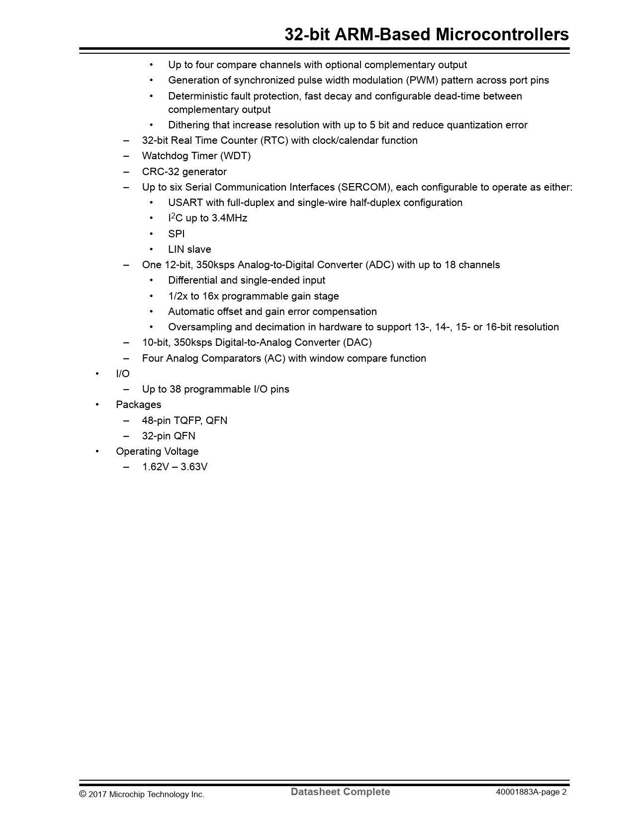

• Up to four compare channels with optional complementary output • Generation of synchronized pulse width modulation (PWM) pattern across port pins • Deterministic fault protection, fast decay and configurable dead-time between complementary output • Dithering that increase resolution with up to 5 bit and reduce quantization error – 32-bit Real Time Counter (RTC) with clock/calendar function – Watchdog Timer (WDT) – CRC-32 generator – Up to six Serial Communication Interfaces (SERCOM), each configurable to operate as either: • USART with full-duplex and single-wire half-duplex configuration • I2C up to 3.4MHz • SPI • LIN slave – One 12-bit, 350ksps Analog-to-Digital Converter (ADC) with up to 18 channels • Differential and single-ended input • 1/2x to 16x programmable gain stage • Automatic offset and gain error compensation • Oversampling and decimation in hardware to support 13-, 14-, 15- or 16-bit resolution – 10-bit, 350ksps Digital-to-Analog Converter (DAC) – Four Analog Comparators (AC) with window compare function • I/O – Up to 38 programmable I/O pins • Packages – 48-pin TQFP, QFN – 32-pin QFN • Operating Voltage – 1.62V – 3.63V © 2017 Microchip Technology Inc.
