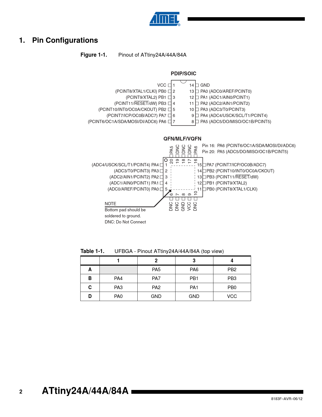

Pin Configurations. Figure 1-1. PDIP/SOIC. QFN/MLF/VQFN. Table 1-1. ATtiny24A/44A/84A
Pin Configurations Figure 1-1 PDIP/SOIC QFN/MLF/VQFN Table 1-1 ATtiny24A/44A/84A
1. Pin Configurations Figure 1-1.
Pinout of ATtiny24A/44A/84A
PDIP/SOIC
VCC 1 14 GND (PCINT8/XTAL1/CLKI) PB0 2 13 PA0 (ADC0/AREF/PCINT0) (PCINT9/XTAL2) PB1 3 12 PA1 (ADC1/AIN0/PCINT1) (PCINT11/RESET/dW) PB3 4 11 PA2 (ADC2/AIN1/PCINT2) (PCINT10/INT0/OC0A/CKOUT) PB2 5 10 PA3 (ADC3/T0/PCINT3) (PCINT7/ICP/OC0B/ADC7) PA7 6 9 PA4 (ADC4/USCK/SCL/T1/PCINT4) (PCINT6/OC1A/SDA/MOSI/DI/ADC6) PA6 7 8 PA5 (ADC5/DO/MISO/OC1B/PCINT5)
QFN/MLF/VQFN
5 6 Pin 16: PA6 (PCINT6/OC1A/SDA/MOSI/DI/ADC6) PA DNC DNC DNC PA Pin 20: PA5 (ADC5/DO/MISO/OC1B/PCINT5) 20 19 18 17 16 (ADC4/USCK/SCL/T1/PCINT4) PA4 1 15 PA7 (PCINT7/ICP/OC0B/ADC7) (ADC3/T0/PCINT3) PA3 2 14 PB2 (PCINT10/INT0/OC0A/CKOUT) (ADC2/AIN1/PCINT2) PA2 3 13 PB3 (PCINT11/RESET/dW) (ADC1/AIN0/PCINT1) PA1 4 12 PB1 (PCINT9/XTAL2) (ADC0/AREF/PCINT0) PA0 5 11 PB0 (PCINT8/XTAL1/CLKI) 6 7 8 9 10 NOTE Bottom pad should be DNC DNC GND VCC DNC soldered to ground. DNC: Do Not Connect
Table 1-1.
UFBGA - Pinout ATtiny24A/44A/84A (top view)
1 2 3 4 A
PA5 PA6 PB2
B
PA4 PA7 PB1 PB3
C
PA3 PA2 PA1 PB0
D
PA0 GND GND VCC
2 ATtiny24A/44A/84A
