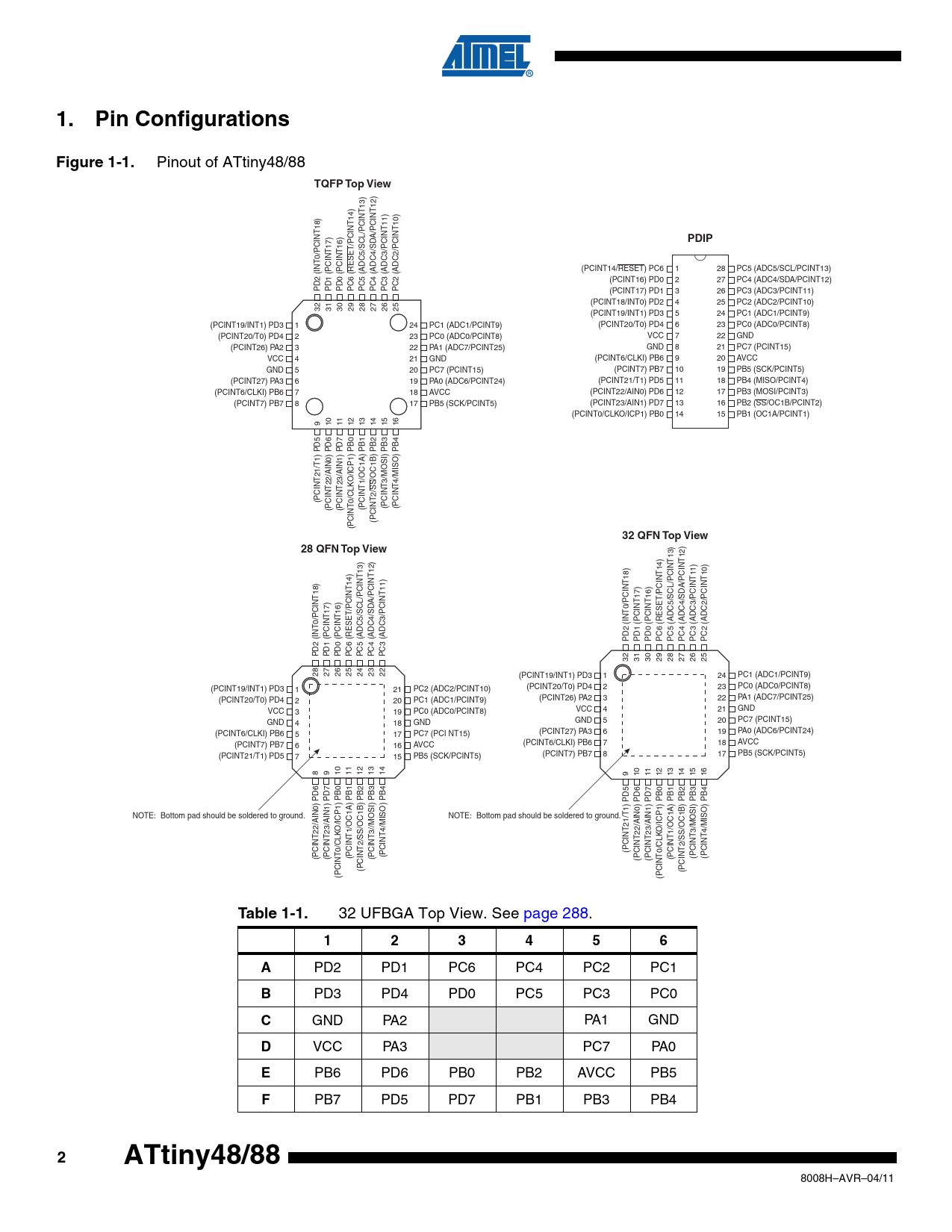

Pin Configurations. Figure 1-1. TQFP Top View. PDIP. 32 QFN Top View. 28 QFN Top View. Table 1-1. ATtiny48/88
Pin Configurations Figure 1-1 TQFP Top View PDIP 32 QFN Top View 28 QFN Top View Table 1-1 ATtiny48/88
link to page 288
1. Pin Configurations Figure 1-1.
Pinout of ATtiny48/88
TQFP Top View
A/PCINT12)
PDIP
(PCINT14/RESET) PC6 1 28 PC5 (ADC5/SCL/PCINT13) (PCINT16) PD0 2 27 PC4 (ADC4/SDA/PCINT12) PD2 (INT0/PCINT18) PD1 (PCINT17) PD0 (PCINT16) PC6 (RESET/PCINT14) PC5 (ADC5/SCL/PCINT13) PC4 (ADC4/SD PC3 (ADC3/PCINT11) PC2 (ADC2/PCINT10) (PCINT17) PD1 3 26 PC3 (ADC3/PCINT11) (PCINT18/INT0) PD2 4 25 PC2 (ADC2/PCINT10) 32 31 30 29 28 27 26 25 (PCINT19/INT1) PD3 5 24 PC1 (ADC1/PCINT9) (PCINT19/INT1) PD3 1 24 PC1 (ADC1/PCINT9) (PCINT20/T0) PD4 6 23 PC0 (ADC0/PCINT8) (PCINT20/T0) PD4 2 23 PC0 (ADC0/PCINT8) VCC 7 22 GND (PCINT26) PA2 3 22 PA1 (ADC7/PCINT25) GND 8 21 PC7 (PCINT15) VCC 4 21 GND (PCINT6/CLKI) PB6 9 20 AVCC GND 5 20 PC7 (PCINT15) (PCINT7) PB7 10 19 PB5 (SCK/PCINT5) (PCINT27) PA3 6 19 PA0 (ADC6/PCINT24) (PCINT21/T1) PD5 11 18 PB4 (MISO/PCINT4) (PCINT6/CLKI) PB6 7 18 AVCC (PCINT22/AIN0) PD6 12 17 PB3 (MOSI/PCINT3) (PCINT7) PB7 8 17 PB5 (SCK/PCINT5) (PCINT23/AIN1) PD7 13 16 PB2 (SS/OC1B/PCINT2) (PCINT0/CLKO/ICP1) PB0 14 15 PB1 (OC1A/PCINT1) 9 10 11 12 13 14 15 16 O/ICP1) PB0 (PCINT21/T1) PD5 (PCINT22/AIN0) PD6 (PCINT23/AIN1) PD7 (PCINT1/OC1A) PB1 (PCINT3/MOSI) PB3 (PCINT4/MISO) PB4 (PCINT2/SS/OC1B) PB2 (PCINT0/CLK
A/PCINT12) A/PCINT12) PD2 (INT0/PCINT18) PD1 (PCINT17) PD0 (PCINT16) PC6 (RESET/PCINT14) PC5 (ADC5/SCL/PCINT13) PC4 (ADC4/SD PC3 (ADC3/PCINT11) PC2 (ADC2/PCINT10) PD2 (INT0/PCINT18) PD1 (PCINT17) PD0 (PCINT16) PC6 (RESET/PCINT14) PC5 (ADC5/SCL/PCINT13) PC4 (ADC4/SD PC3 (ADC3/PCINT11) 32 31 30 29 28 27 26 25 28 27 26 25 24 23 22 (PCINT19/INT1) PD3 1 24 PC1 (ADC1/PCINT9) (PCINT20/T0) PD4 2 23 PC0 (ADC0/PCINT8) (PCINT19/INT1) PD3 1 21 PC2 (ADC2/PCINT10) (PCINT26) PA2 3 22 PA1 (ADC7/PCINT25) (PCINT20/T0) PD4 2 20 PC1 (ADC1/PCINT9) VCC 4 21 GND VCC 3 19 PC0 (ADC0/PCINT8) GND 5 20 PC7 (PCINT15) GND 4 18 GND (PCINT27) PA3 6 19 PA0 (ADC6/PCINT24) (PCINT6/CLKI) PB6 5 17 PC7 (PCI NT15) (PCINT6/CLKI) PB6 7 18 AVCC (PCINT7) PB7 6 16 AVCC (PCINT7) PB7 8 17 PB5 (SCK/PCINT5) (PCINT21/T1) PD5 7 15 PB5 (SCK/PCINT5) 8 9 10 11 12 13 14 9 10 11 12 13 14 15 16 NOTE: Bottom pad should be soldered to ground. NOTE: Bottom pad should be soldered to ground. O/ICP1) PB0 O/ICP1) PB0 (PCINT21/T1) PD5 (PCINT22/AIN0) PD6 (PCINT23/AIN1) PD7 (PCINT1/OC1A) PB1 (PCINT3//MOSI) PB3 (PCINT4/MISO) PB4 (PCINT22/AIN0) PD6 (PCINT23/AIN1) PD7 (PCINT1/OC1A) PB1 (PCINT3/MOSI) PB3 (PCINT4/MISO) PB4 (PCINT2/SS/OC1B) PB2 (PCINT2/SS/OC1B) PB2 (PCINT0/CLK (PCINT0/CLK
Table 1-1.
32 UFBGA Top View. See page 288.
1 2 3 4 5 6 A
PD2 PD1 PC6 PC4 PC2 PC1
B
PD3 PD4 PD0 PC5 PC3 PC0
C
GND PA2 PA1 GND
D
VCC PA3 PC7 PA0
E
PB6 PD6 PB0 PB2 AVCC PB5
F
PB7 PD5 PD7 PB1 PB3 PB4
