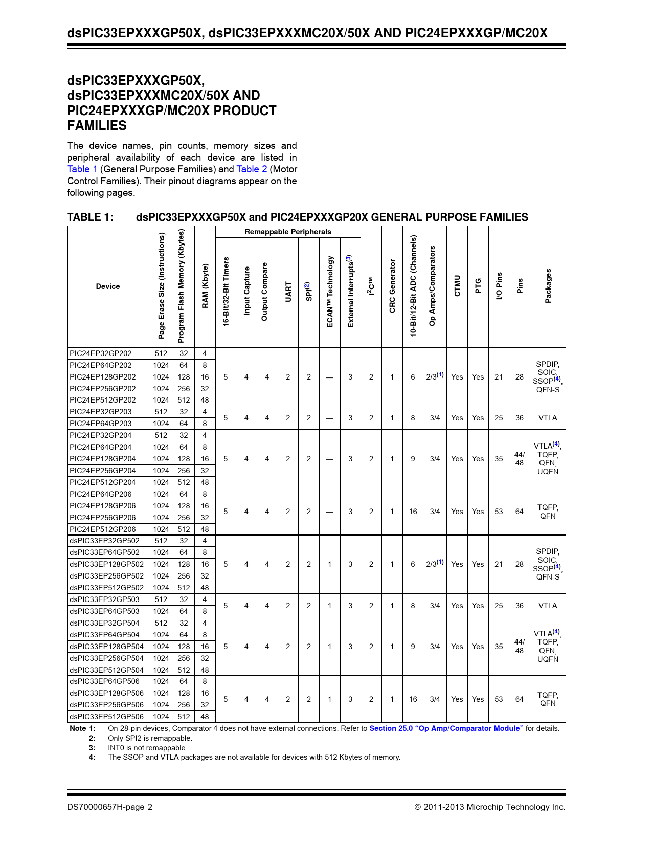

dsPIC33EPXXXGP50X, dsPIC33EPXXXMC20X/50X AND PIC24EPXXXGP/MC20X dsPIC33EPXXXGP50X, dsPIC33EPXXXMC20X/50X AND PIC24EPXXXGP/MC20X PRODUCT FAMILIES
The device names, pin counts, memory sizes and peripheral availability of each device are listed in Table 1 (General Purpose Families) and Table 2 (Motor Control Families). Their pinout diagrams appear on the following pages.
TABLE 1: dsPIC33EPXXXGP50X and PIC24EPXXXGP20X GENERAL PURPOSE FAMILIES ) ) s Remappable Peripherals s ) te ls e tion by n rs c K ) n ( y (3 r a to tru y ) rs g h ra s e re ts to te lo C a In o pa mor y im ra up s ure p es ( b n e U T pt m ) h rr n m G in Device e o ag z M ns Me (K a (2 c te C™ P h e 2 -Bit C n I ADC ( /C PT Pi ck Si s M CT t t Co l I I/O a e a A UART SPI ps u P s R /32 -Bit pu m n tp rna CRC Ge 2 I /1 A Era m Fl -Bit Ou te it p ra 16 ECAN™ T O ge g Ex -B 0 Pa 1 Pro
PIC24EP32GP202 512 32 4 PIC24EP64GP202 1024 64 8 SPDIP, SOIC, PIC24EP128GP202 1024 128 16 5 4 4 2 2 — 3 2 1 6 2/3
(1 )
Yes Yes 21 28 SSOP
(4 )
, PIC24EP256GP202 1024 256 32 QFN-S PIC24EP512GP202 1024 512 48 PIC24EP32GP203 512 32 4 5 4 4 2 2 — 3 2 1 8 3/4 Yes Yes 25 36 VTLA PIC24EP64GP203 1024 64 8 PIC24EP32GP204 512 32 4 PIC24EP64GP204 1024 64 8 VTLA
(4)
, 44/ TQFP, PIC24EP128GP204 1024 128 16 5 4 4 2 2 — 3 2 1 9 3/4 Yes Yes 35 48 QFN, PIC24EP256GP204 1024 256 32 UQFN PIC24EP512GP204 1024 512 48 PIC24EP64GP206 1024 64 8 PIC24EP128GP206 1024 128 16 TQFP, 5 4 4 2 2 — 3 2 1 16 3/4 Yes Yes 53 64 PIC24EP256GP206 1024 256 32 QFN PIC24EP512GP206 1024 512 48 dsPIC33EP32GP502 512 32 4 dsPIC33EP64GP502 1024 64 8 SPDIP, SOIC, dsPIC33EP128GP502 1024 128 16 5 4 4 2 2 1 3 2 1 6 2/3
(1 )
Yes Yes 21 28 SSOP
(4 )
, dsPIC33EP256GP502 1024 256 32 QFN-S dsPIC33EP512GP502 1024 512 48 dsPIC33EP32GP503 512 32 4 5 4 4 2 2 1 3 2 1 8 3/4 Yes Yes 25 36 VTLA dsPIC33EP64GP503 1024 64 8 dsPIC33EP32GP504 512 32 4 dsPIC33EP64GP504 1024 64 8 VTLA
(4)
, 44/ TQFP, dsPIC33EP128GP504 1024 128 16 5 4 4 2 2 1 3 2 1 9 3/4 Yes Yes 35 48 QFN, dsPIC33EP256GP504 1024 256 32 UQFN dsPIC33EP512GP504 1024 512 48 dsPIC33EP64GP506 1024 64 8 dsPIC33EP128GP506 1024 128 16 TQFP, 5 4 4 2 2 1 3 2 1 16 3/4 Yes Yes 53 64 QFN dsPIC33EP256GP506 1024 256 32 dsPIC33EP512GP506 1024 512 48
