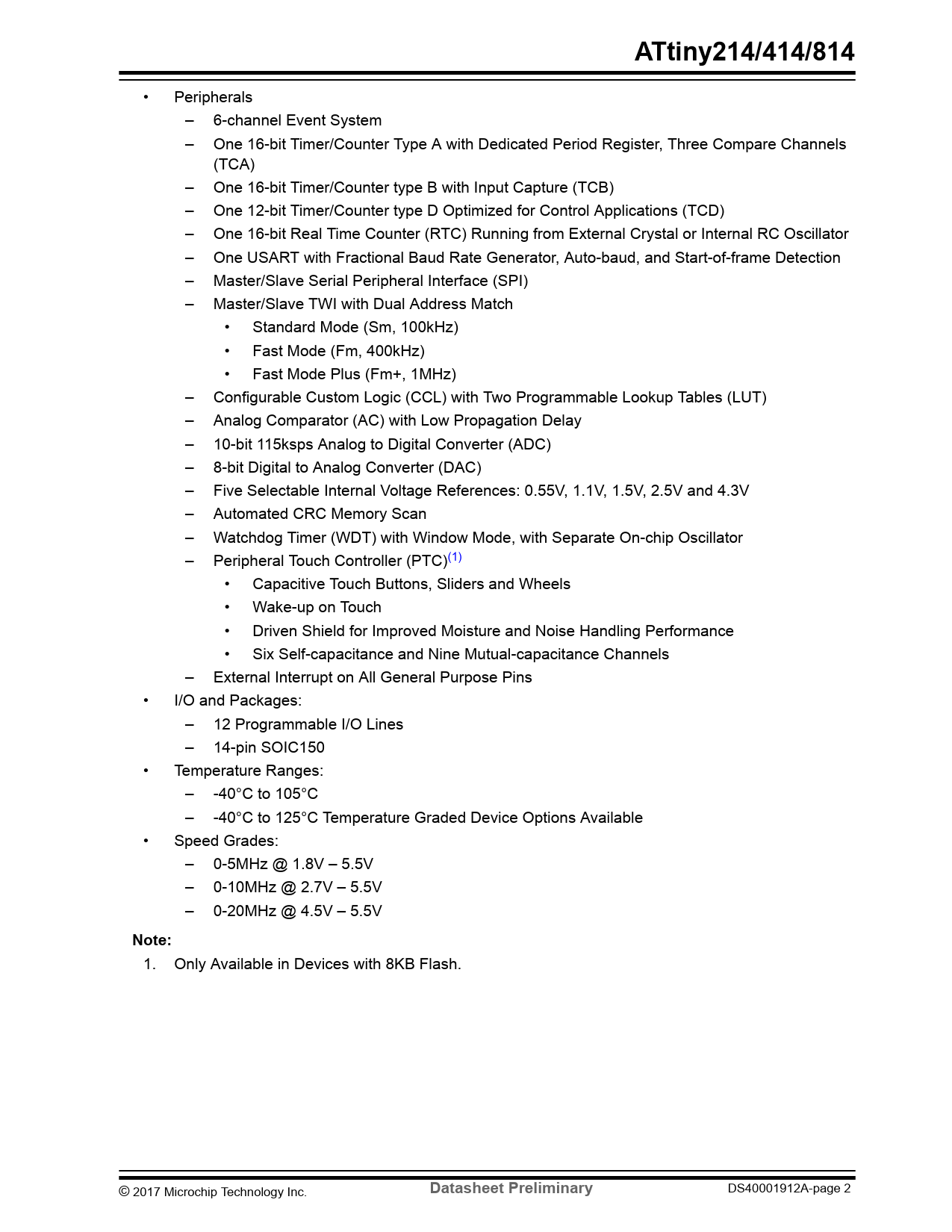

ATtiny214/414/814
• Peripherals – 6-channel Event System – One 16-bit Timer/Counter Type A with Dedicated Period Register, Three Compare Channels (TCA) – One 16-bit Timer/Counter type B with Input Capture (TCB) – One 12-bit Timer/Counter type D Optimized for Control Applications (TCD) – One 16-bit Real Time Counter (RTC) Running from External Crystal or Internal RC Oscillator – One USART with Fractional Baud Rate Generator, Auto-baud, and Start-of-frame Detection – Master/Slave Serial Peripheral Interface (SPI) – Master/Slave TWI with Dual Address Match • Standard Mode (Sm, 100kHz) • Fast Mode (Fm, 400kHz) • Fast Mode Plus (Fm+, 1MHz) – Configurable Custom Logic (CCL) with Two Programmable Lookup Tables (LUT) – Analog Comparator (AC) with Low Propagation Delay – 10-bit 115ksps Analog to Digital Converter (ADC) – 8-bit Digital to Analog Converter (DAC) – Five Selectable Internal Voltage References: 0.55V, 1.1V, 1.5V, 2.5V and 4.3V – Automated CRC Memory Scan – Watchdog Timer (WDT) with Window Mode, with Separate On-chip Oscillator – Peripheral Touch Controller (PTC)(1) • Capacitive Touch Buttons, Sliders and Wheels • Wake-up on Touch • Driven Shield for Improved Moisture and Noise Handling Performance • Six Self-capacitance and Nine Mutual-capacitance Channels – External Interrupt on All General Purpose Pins • I/O and Packages: – 12 Programmable I/O Lines – 14-pin SOIC150 • Temperature Ranges: – -40°C to 105°C – -40°C to 125°C Temperature Graded Device Options Available • Speed Grades: – 0-5MHz @ 1.8V – 5.5V – 0-10MHz @ 2.7V – 5.5V – 0-20MHz @ 4.5V – 5.5V
Note: 
1. Only Available in Devices with 8KB Flash. © 2017 Microchip Technology Inc.
Datasheet Preliminary
