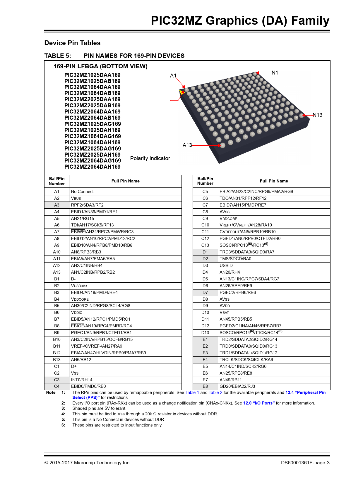

PIC32MZ Graphics (DA) Family. Device Pin Tables. TABLE 5:. PIN NAMES FOR 169-PIN DEVICES. 169-PIN LFBGA (BOTTOM VIEW)
PIC32MZ Graphics (DA) Family Device Pin Tables TABLE 5: PIN NAMES FOR 169-PIN DEVICES 169-PIN LFBGA (BOTTOM VIEW)
PIC32MZ1025DAA169
PIC32MZ1025DAA176
PIC32MZ1025DAA288
PIC32MZ1025DAB169
PIC32MZ1025DAB176
PIC32MZ1025DAB288
PIC32MZ1025DAG169
PIC32MZ1025DAG176
PIC32MZ1025DAH169
PIC32MZ1025DAH176
PIC32MZ1064DAA169
PIC32MZ1064DAA176
PIC32MZ1064DAA288
PIC32MZ1064DAB169
PIC32MZ1064DAB176
PIC32MZ1064DAB288
PIC32MZ1064DAG169
PIC32MZ1064DAG176
PIC32MZ1064DAH169
PIC32MZ1064DAH176
PIC32MZ2025DAA169
PIC32MZ2025DAA176
PIC32MZ2025DAA288
PIC32MZ2025DAB169
PIC32MZ2025DAB176
PIC32MZ2025DAB288
PIC32MZ2025DAG169
PIC32MZ2025DAG176
PIC32MZ2025DAH169
PIC32MZ2025DAH176
PIC32MZ2064DAA169
PIC32MZ2064DAA176
PIC32MZ2064DAA288
PIC32MZ2064DAB169
PIC32MZ2064DAB176
PIC32MZ2064DAB288
PIC32MZ2064DAG169
PIC32MZ2064DAG176
PIC32MZ2064DAH169
PIC32MZ2064DAH176
link to page 2 link to page 2 link to page 253 link to page 253 link to page 251
A1 N1
PIC32MZ1025DAA169 PIC32MZ1025DAB169 PIC32MZ1064DAA169 PIC32MZ1064DAB169 PIC32MZ2025DAA169 PIC32MZ2025DAB169 PIC32MZ2064DAA169
N13
PIC32MZ2064DAB169 PIC32MZ1025DAG169 PIC32MZ1025DAH169 PIC32MZ1064DAG169 PIC32MZ1064DAH169
A13
PIC32MZ2025DAG169 PIC32MZ2025DAH169 PIC32MZ2064DAG169
Polarity Indicator
PIC32MZ2064DAH169 Ball/Pin Ball/Pin Full Pin Name Full Pin Name Number Number
A1 No Connect C5 EBIA2/AN23/C2INC/RPG9/PMA2/RG9 A2 VBUS C6 TDO/AN31/RPF12/RF12 A3 RPF2/SDA3/RF2 C7 EBID7/AN15/PMD7/RE7 A4 EBID1/AN39/PMD1/RE1 C8 AVSS A5 AN21/RG15 C9 VDDCORE A6 TDI/AN17/SCK5/RF13 C10 VREF+/CVREF+/AN28/RA10 A7 EBIWE/AN34/RPC3/PMWR/RC3 C11 CVREFOUT/AN5/RPB10/RB10 A8 EBID12/AN10/RPC2/PMD12/RC2 C12 PGED1/AN0/RPB0/CTED2/RB0 A9 EBID10/AN4/RPB8/PMD10/RB8 C13 SOSCI/RPC13
(6)
/RC13
(6)
A10 AN8/RPB3/RB3 D1 TRD3/SDDATA3/SQID3/RA7 A11 EBIA5/AN7/PMA5/RA5 D2 TMS/SDCD/RA0 A12 AN2/C1INB/RB4 D3 USBID A13 AN1/C2INB/RPB2/RB2 D4 AN20/RH4 B1 D- D5 AN13/C1INC/RPG7/SDA4/RG7 B2 VUSB3V3 D6 AN26/RPE9/RE9 B3 EBID4/AN18/PMD4/RE4 D7 PGEC2/RPB6/RB6 B4 VDDCORE D8 AVSS B5 AN30/C2IND/RPG8/SCL4/RG8 D9 AVDD B6 VDDIO D10 VBAT B7 EBID5/AN12/RPC1/PMD5/RC1 D11 AN45/RPB5/RB5 B8 EBIOE/AN19/RPC4/PMRD/RC4 D12 PGED2/C1INA/AN46/RPB7/RB7 B9 PGEC1/AN9/RPB1/CTED1/RB1 D13 SOSCO/RPC14
(6)
/T1CK/RC14
(6)
B10 AN3/C2INA/RPB15/OCFB/RB15 E1 TRD2/SDDATA2/SQID2/RG14 B11 VREF-/CVREF-/AN27/RA9 E2 TRD0/SDDATA0/SQID0/RG13 B12 EBIA7/AN47/HLVDIN/RPB9/PMA7/RB9 E3 TRD1/SDDATA1/SQID1/RG12 B13 AN6/RB12 E4 TRCLK/SDCK/SQICLK/RA6 C1 D+ E5 AN14/C1IND/SCK2/RG6 C2 VSS E6 AN25/RPE8/RE8 C3 INT0/RH14 E7 AN49/RB11 C4 EBID0/PMD0/RE0 E8 GD20/EBIA22/RJ3
