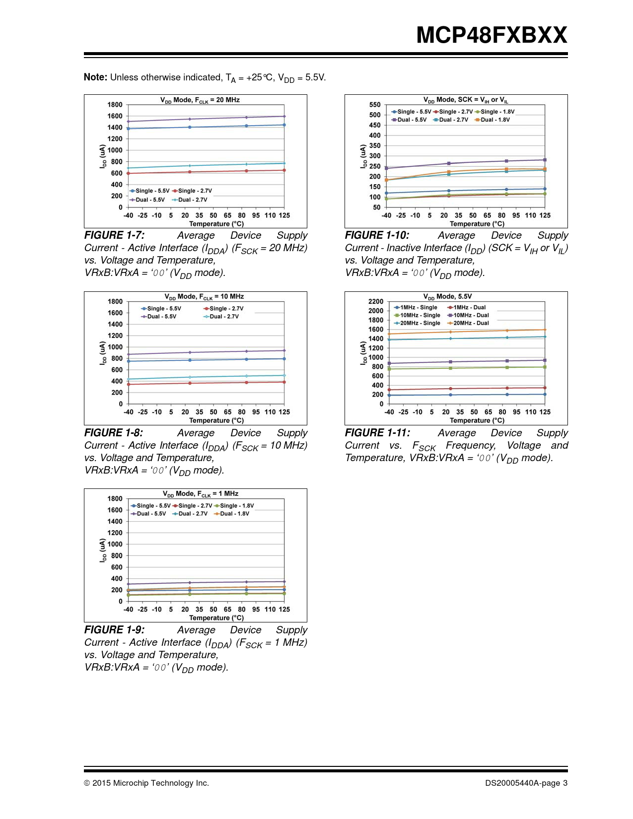

Unless otherwise indicated, TA = +25°C, VDD = 5.5V.
FIGURE 1-7:
Average Device Supply
FIGURE 1-10:
Average Device Supply Current - Active Interface (IDDA) (FSCK = 20 MHz) Current - Inactive Interface (IDD) (SCK = VIH or VIL) vs. Voltage and Temperature, vs. Voltage and Temperature, VRxB:VRxA = ‘00’ (VDD mode). VRxB:VRxA = ‘00’ (VDD mode).
FIGURE 1-8:
FIGURE 1-11:
Average Device Supply Current - Active Interface (IDDA) (FSCK = 10 MHz) Current vs. FSCK Frequency, Voltage and vs. Voltage and Temperature, Temperature, VRxB:VRxA = ‘00’ (VDD mode). VRxB:VRxA = ‘00’ (VDD mode).
FIGURE 1-9:
Average Device Supply Current - Active Interface (IDDA) (FSCK = 1 MHz) vs. Voltage and Temperature, VRxB:VRxA = ‘00’ (VDD mode).  2015 Microchip Technology Inc. DS20005440A-page 3 Document Outline 1.0 Typical Performance Curves 12-bit FIGURE 1-40: Total Unadjusted Error (VOUT) vs. DAC Code, and Temperature (Single Channel - MCP48FXB21) (12-bit: VDD = 5.5V, VRxB:VRxA = ‘00’ (VDD), Gx = ‘0’ (1x)). FIGURE 1-41: Total Unadjusted Error (VOUT) vs. DAC Code, and Temperature (Single Channel - MCP48FXB21) (12-bit: VDD = 2.7V, VRxB:VRxA = ‘00’ (VDD), Gx = ‘0’ (1x)). FIGURE 1-42: Total Unadjusted Error (VOUT) vs. DAC Code, and Temperature (Single Channel - MCP48FXB21) (12-bit: VDD = 1.8V, VRxB:VRxA = ‘00’ (VDD), Gx = ‘0’ (1x)), (see Appendix B.1 for additional information). FIGURE 1-43: Total Unadjusted Error (VOUT) vs. DAC Code, and Temperature (Dual Channel - MCP48FXB22) (12-bit: VDD = 5.5V, VRxB:VRxA = ‘00’ (VDD), Gx = ‘0’ (1x)). FIGURE 1-44: Total Unadjusted Error (VOUT) vs. DAC Code, and Temperature (Dual Channel - MCP48FXB22) (12-bit: VDD = 2.7V, VRxB:VRxA = ‘00’ (VDD), Gx = ‘0’ (1x)). FIGURE 1-45: Total Unadjusted Error (VOUT) vs. DAC Code, and Temperature (Dual Channel - MCP48FXB22) (12-bit: VDD = 1.8V, VRxB:VRxA = ‘00’ (VDD), Gx = ‘0’ (1x)), (see Appendix B.1 for additional information). FIGURE 1-46: INL Error vs. DAC Code, and Temperature (Code 100 - 4000) (Single Channel - MCP48FXB21) (12-bit: VDD = 5.5V, VRxB:VRxA = ‘00’ (VDD), Gx = ‘0’ (1x)). FIGURE 1-47: INL Error vs. DAC Code, and Temperature (Code 100 - 4000) (Single Channel - MCP48FXB21) (12-bit: VDD = 2.7V, VRxB:VRxA = ‘00’ (VDD), Gx = ‘0’ (1x)). FIGURE 1-48: INL Error vs. DAC Code, and Temperature (Code 100 - 4000) (Single Channel - MCP48FXB21) (12-bit: VDD = 1.8V, VRxB:VRxA = ‘00’ (VDD), Gx = ‘0’ (1x)), (see Appendix B.1 for additional information). FIGURE 1-49: INL Error vs. DAC Code, and Temperature (Code 100 - 4000) (Dual Channel - MCP48FXB22) (12-bit: VDD = 5.5V, VRxB:VRxA = ‘00’ (VDD), Gx = ‘0’ (1x)). FIGURE 1-50: INL Error vs. DAC Code, and Temperature (Code 100 - 4000) (Dual Channel - MCP48FXB22) (12-bit: VDD = 2.7V, VRxB:VRxA = ‘00’ (VDD), Gx = ‘0’ (1x)). FIGURE 1-51: INL Error vs. DAC Code, and Temperature (Code 100 - 4000) (Dual Channel - MCP48FXB22) (12-bit: VDD = 1.8V, VRxB:VRxA = ‘00’ (VDD), Gx = ‘0’ (1x)), (see Appendix B.1 for additional information). FIGURE 1-52: DNL Error vs. DAC Code, and Temperature (Code 100 - 4000) (Single Channel - MCP48FXB21) (12-bit: VDD = 5.5V, VRxB:VRxA = ‘00’ (VDD), Gx = ‘0’ (1x)). FIGURE 1-53: DNL Error vs. DAC Code, and Temperature (Code 100 - 4000) (Single Channel - MCP48FXB21) (12-bit: VDD = 2.7V, VRxB:VRxA = ‘00’ (VDD), Gx = ‘0’ (1x)). FIGURE 1-54: DNL Error vs. DAC Code, and Temperature (Code 100 - 4000) (Single Channel - MCP48FXB21) (12-bit: VDD = 1.8V, VRxB:VRxA = ‘00’ (VDD), Gx = ‘0’ (1x)), (see Appendix B.1 for additional information). FIGURE 1-55: DNL Error vs. DAC Code, and Temperature (Code 100 - 4000) (Dual Channel - MCP48FXB22) (12-bit: VDD = 5.5V, VRxB:VRxA = ‘00’ (VDD), Gx = ‘0’ (1x)). FIGURE 1-56: DNL Error vs. DAC Code, and Temperature (Code 100 - 4000) (Dual Channel - MCP48FXB22) (12-bit: VDD = 2.7V, VRxB:VRxA = ‘00’ (VDD), Gx = ‘0’ (1x)). FIGURE 1-57: DNL Error vs. DAC Code, and Temperature (Code 100 - 4000) (Dual Channel - MCP48FXB22) (12-bit: VDD = 1.8V, VRxB:VRxA = ‘00’ (VDD), Gx = ‘0’ (1x)), (see Appendix B.1 for additional information). FIGURE 1-58: Total Unadjusted Error (VOUT) vs. DAC Code, and Temperature (Single Channel - MCP48FXB21) (12-bit: VDD = 5.5V, VRxB:VRxA = ‘01’ (Bandgap), Gx = ‘1’ (2x)). FIGURE 1-59: Total Unadjusted Error (VOUT) vs. DAC Code, and Temperature (Single Channel - MCP48FXB21) (12-bit: VDD = 5.5V, VRxB:VRxA = ‘01’ (Bandgap), Gx = ‘0’ (1x)). FIGURE 1-60: Total Unadjusted Error (VOUT) vs. DAC Code, and Temperature (Single Channel - MCP48FXB21) (12-bit: VDD = 2.7V, VRxB:VRxA = ‘01’ (Bandgap), Gx = ‘0’ (1x)). FIGURE 1-61: Total Unadjusted Error (VOUT) vs. DAC Code, and Temperature (Dual Channel - MCP48FXB22) (12-bit: VDD = 5.5V, VRxB:VRxA = ‘01’ (Bandgap), Gx = ‘1’ (2x)). FIGURE 1-62: Total Unadjusted Error (VOUT) vs. DAC Code, and Temperature (Dual Channel - MCP48FXB22) (12-bit: VDD = 5.5V, VRxB:VRxA = ‘01’ (Bandgap), Gx = ‘0’ (1x)). FIGURE 1-63: Total Unadjusted Error (VOUT) vs. DAC Code, and Temperature (Dual Channel - MCP48FXB22) (12-bit: VDD = 2.7V, VRxB:VRxA = ‘01’ (Bandgap), Gx = ‘0’ (1x)). FIGURE 1-64: INL Error vs. DAC Code, and Temperature (Code 100 - 4000) (Single Channel - MCP48FXB21) (12-bit: VDD = 5.5V, VRxB:VRxA = ‘01’ (Bandgap), Gx = ‘1’ (2x)). FIGURE 1-65: INL Error vs. DAC Code, and Temperature (Code 100 - 4000) (Single Channel - MCP48FXB21) (12-bit: VDD = 5.5V, VRxB:VRxA = ‘01’ (Bandgap), Gx = ‘0’ (1x)). FIGURE 1-66: INL Error vs. DAC Code, and Temperature (Code 100 - 4000) (Single Channel - MCP48FXB21) (12-bit: VDD = 2.7V, VRxB:VRxA = ‘01’ (Bandgap), Gx = ‘0’ (1x)). FIGURE 1-67: INL Error vs. DAC Code, and Temperature (Code 100 - 4000) (Dual Channel - MCP48FXB22) (12-bit: VDD = 5.5V, VRxB:VRxA = ‘01’ (Bandgap), Gx = ‘1’ (2x)). FIGURE 1-68: INL Error vs. DAC Code, and Temperature (Code 100 - 4000) (Dual Channel - MCP48FXB22) (12-bit: VDD = 5.5V, VRxB:VRxA = ‘01’ (Bandgap), Gx = ‘0’ (1x)). FIGURE 1-69: INL Error vs. DAC Code, and Temperature (Code 100 - 4000) (Dual Channel - MCP48FXB22) (12-bit: VDD = 2.7V, VRxB:VRxA = ‘01’ (Bandgap), Gx = ‘0’ (1x)). FIGURE 1-70: DNL Error vs. DAC Code, and Temperature (Code 100 - 4000) (Single Channel - MCP48FXB21) (12-bit: VDD = 5.5V, VRxB:VRxA = ‘01’ (Bandgap), Gx = ‘1’ (2x)). FIGURE 1-71: DNL Error vs. DAC Code, and Temperature (Code 100 - 4000) (Single Channel - MCP48FXB21) (12-bit: VDD = 5.5V, VRxB:VRxA = ‘01’ (Bandgap), Gx = ‘0’ (1x)). FIGURE 1-72: DNL Error vs. DAC Code, and Temperature (Code 100 - 4000) (Single Channel - MCP48FXB21) (12-bit: VDD = 2.7V, VRxB:VRxA = ‘01’ (Bandgap), Gx = ‘0’ (1x)). FIGURE 1-73: DNL Error vs. DAC Code, and Temperature (Code 100 - 4000) (Dual Channel - MCP48FXB22) (12-bit: VDD = 5.5V, VRxB:VRxA = ‘01’ (Bandgap), Gx = ‘1’ (2x)). FIGURE 1-74: DNL Error vs. DAC Code, and Temperature (Code 100 - 4000) (Dual Channel - MCP48FXB22) (12-bit: VDD = 5.5V, VRxB:VRxA = ‘01’ (Bandgap), Gx = ‘0’ (1x)). FIGURE 1-75: DNL Error vs. DAC Code, and Temperature (Code 100 - 4000) (Dual Channel - MCP48FXB22) (12-bit: VDD = 2.7V, VRxB:VRxA = ‘01’ (Bandgap), Gx = ‘0’ (1x)). FIGURE 1-76: Total Unadjusted Error (VOUT) vs. DAC Code, and Temperature (Single Channel - MCP48FXB21) (12-bit: VDD = 5.5V, VREF = VDD, VRxB:VRxA = ‘10’ (VREF Unbuffered), Gx = ‘0’ (1x)). FIGURE 1-77: Total Unadjusted Error (VOUT) vs. DAC Code, and Temperature (Single Channel - MCP48FXB21) (12-bit: VDD = 2.7V, VREF = VDD, VRxB:VRxA = ‘10’ (VREF Unbuffered), Gx = ‘0’ (1x)). FIGURE 1-78: Total Unadjusted Error (VOUT) vs. DAC Code, and Temperature (Single Channel - MCP48FXB21) (12-bit: VDD = 1.8V, VREF = VDD, VRxB:VRxA = ‘10’ (VREF Unbuffered), Gx = ‘0’ (1x)), (see Appendix B.2 for additional information). FIGURE 1-79: Total Unadjusted Error (VOUT) vs. DAC Code, and Temperature (Dual Channel - MCP48FXB22) (12-bit: VDD = 5.5V, VREF = VDD, VRxB:VRxA = ‘10’ (VREF Unbuffered), Gx = ‘0’ (1x)). FIGURE 1-80: Total Unadjusted Error (VOUT) vs. DAC Code, and Temperature (Dual Channel - MCP48FXB22) (12-bit: VDD = 2.7V, VREF = VDD, VRxB:VRxA = ‘10’ (VREF Unbuffered), Gx = ‘0’ (1x)). FIGURE 1-81: Total Unadjusted Error (VOUT) vs. DAC Code, and Temperature (Dual Channel - MCP48FXB22) (12-bit: VDD = 1.8V, VREF = VDD, VRxB:VRxA = ‘10’ (VREF Unbuffered), Gx = ‘0’ (1x)), (see Appendix B.2 for additional information). FIGURE 1-82: INL Error vs. DAC Code, and Temperature (Code 100 - 4000) (Single Channel - MCP48FXB21) (12-bit: VDD = 5.5V, VREF = VDD, VRxB:VRxA = ‘10’ (VREF Unbuffered), Gx = ‘0’ (1x)). FIGURE 1-83: INL Error vs. DAC Code, and Temperature (Code 100 - 4000) (Single Channel - MCP48FXB21) (12-bit: VDD = 2.7V, VREF = VDD, VRxB:VRxA = ‘10’ (VREF Unbuffered), Gx = ‘0’ (1x)). FIGURE 1-84: INL Error vs. DAC Code, and Temperature (Code 100 - 4000) (Single Channel - MCP48FXB21) (12-bit: VDD = 1.8V, VREF = VDD, VRxB:VRxA = ‘10’ (VREF Unbuffered), Gx = ‘0’ (1x)), (see Appendix B.2 for additional information). FIGURE 1-85: INL Error vs. DAC Code, and Temperature (Code 100 - 4000) (Dual Channel - MCP48FXB22) (12-bit: VDD = 5.5V, VREF = VDD, VRxB:VRxA = ‘10’ (VREF Unbuffered), Gx = ‘0’ (1x)). FIGURE 1-86: INL Error vs. DAC Code, and Temperature (Code 100 - 4000) (Dual Channel - MCP48FXB22) (12-bit: VDD = 2.7V, VREF = VDD, VRxB:VRxA = ‘10’ (VREF Unbuffered), Gx = ‘0’ (1x)). FIGURE 1-87: INL Error vs. DAC Code, and Temperature (Code 100 - 4000) (Dual Channel - MCP48FXB22) (12-bit: VDD = 1.8V, VREF = VDD, VRxB:VRxA = ‘10’ (VREF Unbuffered), Gx = ‘0’ (1x)), (see Appendix B.2 for additional information). FIGURE 1-88: DNL Error vs. DAC Code, and Temperature (Code 100 - 4000) (Single Channel - MCP48FXB21) (12-bit: VDD = 5.5V, VREF = VDD, VRxB:VRxA = ‘10’ (VREF Unbuffered), Gx = ‘0’ (1x)). FIGURE 1-89: DNL Error vs. DAC Code, and Temperature (Code 100 - 4000) (Single Channel - MCP48FXB21) (12-bit: VDD = 2.7V, VREF = VDD, VRxB:VRxA = ‘10’ (VREF Unbuffered), Gx = ‘0’ (1x)). FIGURE 1-90: DNL Error vs. DAC Code, and Temperature (Code 100 - 4000) (Single Channel - MCP48FXB21) (12-bit: VDD = 1.8V, VREF = VDD, VRxB:VRxA = ‘10’ (VREF Unbuffered), Gx = ‘0’ (1x)), (see Appendix B.2 for additional information). FIGURE 1-91: DNL Error vs. DAC Code, and Temperature (Code 100 - 4000) (Dual Channel - MCP48FXB22) (12-bit: VDD = 5.5V, VREF = VDD, VRxB:VRxA = ‘10’ (VREF Unbuffered), Gx = ‘0’ (1x)). FIGURE 1-92: DNL Error vs. DAC Code, and Temperature (Code 100 - 4000) (Dual Channel - MCP48FXB22) (12-bit: VDD = 2.7V, VREF = VDD, VRxB:VRxA = ‘10’ (VREF Unbuffered), Gx = ‘0’ (1x)). FIGURE 1-93: DNL Error vs. DAC Code, and Temperature (Code 100 - 4000) (Dual Channel - MCP48FXB22) (12-bit: VDD = 1.8V, VREF = VDD, VRxB:VRxA = ‘10’ (VREF Unbuffered), Gx = ‘0’ (1x)), (see Appendix B.2 for additional information). FIGURE 1-94: Total Unadjusted Error (VOUT) vs. DAC Code, and Temperature (Single Channel - MCP48FXB21) (12-bit: VDD = 5.5V, VREF = 1V, VRxB:VRxA = ‘10’ (VREF Unbuffered), Gx = ‘0’ (1x)). FIGURE 1-95: Total Unadjusted Error (VOUT) vs. DAC Code, and Temperature (Single Channel - MCP48FXB21) (12-bit: VDD = 2.7V, VREF = 1V, VRxB:VRxA = ‘10’ (VREF Unbuffered), Gx = ‘0’ (1x)). FIGURE 1-96: Total Unadjusted Error (VOUT) vs. DAC Code, and Temperature (Single Channel - MCP48FXB21) (12-bit: VDD = 1.8V, VREF = 1V, VRxB:VRxA = ‘10’ (VREF Unbuffered), Gx = ‘0’ (1x)). FIGURE 1-97: Total Unadjusted Error (VOUT) vs. DAC Code, and Temperature (Dual Channel - MCP48FXB22) (12-bit: VDD = 5.5V, VREF = 1V, VRxB:VRxA = ‘10’ (VREF Unbuffered), Gx = ‘0’ (1x)). FIGURE 1-98: Total Unadjusted Error (VOUT) vs. DAC Code, and Temperature (Dual Channel - MCP48FXB22) (12-bit: VDD = 2.7V, VREF = 1V, VRxB:VRxA = ‘10’ (VREF Unbuffered), Gx = ‘0’ (1x)). FIGURE 1-99: Total Unadjusted Error (VOUT) vs. DAC Code, and Temperature (Dual Channel - MCP48FXB22) (12-bit: VDD = 1.8V, VREF = 1V, VRxB:VRxA = ‘10’ (VREF Unbuffered), Gx = ‘0’ (1x)). FIGURE 1-100: INL Error vs. DAC Code, and Temperature (Code 100 - 4000) (Single Channel - MCP48FXB21) (12-bit: VDD = 5.5V, VREF = 1V, VRxB:VRxA = ‘10’ (VREF Unbuffered), Gx = ‘0’ (1x)). FIGURE 1-101: INL Error vs. DAC Code, and Temperature (Code 100 - 4000) (Single Channel - MCP48FXB21) (12-bit: VDD = 2.7V, VREF = 1V, VRxB:VRxA = ‘10’ (VREF Unbuffered), Gx = ‘0’ (1x)). FIGURE 1-102: INL Error vs. DAC Code, and Temperature (Code 100 - 4000) (Single Channel - MCP48FXB21) (12-bit: VDD = 1.8V, VREF = 1V, VRxB:VRxA = ‘10’ (VREF Unbuffered), Gx = ‘0’ (1x)). FIGURE 1-103: INL Error vs. DAC Code, and Temperature (Code 100 - 4000) (Dual Channel - MCP48FXB22) (12-bit: VDD = 5.5V, VREF = 1V, VRxB:VRxA = ‘10’ (VREF Unbuffered), Gx = ‘0’ (1x)). FIGURE 1-104: INL Error vs. DAC Code, and Temperature (Code 100 - 4000) (Dual Channel - MCP48FXB22) (12-bit: VDD = 2.7V, VREF = 1V, VRxB:VRxA = ‘10’ (VREF Unbuffered), Gx = ‘0’ (1x)). FIGURE 1-105: INL Error vs. DAC Code, and Temperature (Code 100 - 4000) (Dual Channel - MCP48FXB22) (12-bit: VDD = 1.8V, VREF = 1V, VRxB:VRxA = ‘10’ (VREF Unbuffered), Gx = ‘0’ (1x)). FIGURE 1-106: DNL Error vs. DAC Code, and Temperature (Code 100 - 4000) (Single Channel - MCP48FXB21) (12-bit: VDD = 5.5V, VREF = 1V, VRxB:VRxA = ‘10’ (VREF Unbuffered), Gx = ‘0’ (1x)). FIGURE 1-107: DNL Error vs. DAC Code, and Temperature (Code 100 - 4000) (Single Channel - MCP48FXB21) (12-bit: VDD = 2.7V, VREF = 1V, VRxB:VRxA = ‘10’ (VREF Unbuffered), Gx = ‘0’ (1x)). FIGURE 1-108: DNL Error vs. DAC Code, and Temperature (Code 100 - 4000) (Single Channel - MCP48FXB21) (12-bit: VDD = 1.8V, VREF = 1V, VRxB:VRxA = ‘10’ (VREF Unbuffered), Gx = ‘0’ (1x)). FIGURE 1-109: DNL Error vs. DAC Code, and Temperature (Code 100 - 4000) (Dual Channel - MCP48FXB22) (12-bit: VDD = 5.5V, VREF = 1V, VRxB:VRxA = ‘10’ (VREF Unbuffered), Gx = ‘0’ (1x)). FIGURE 1-110: DNL Error vs. DAC Code, and Temperature (Code 100 - 4000) (Dual Channel - MCP48FXB22) (12-bit: VDD = 2.7V, VREF = 1V, VRxB:VRxA = ‘10’ (VREF Unbuffered), Gx = ‘0’ (1x)). FIGURE 1-111: DNL Error vs. DAC Code, and Temperature (Code 100 - 4000) (Dual Channel - MCP48FXB22) (12-bit: VDD = 1.8V, VREF = 1V, VRxB:VRxA = ‘10’ (VREF Unbuffered), Gx = ‘0’ (1x)). FIGURE 1-112: Total Unadjusted Error (VOUT) vs. DAC Code, and Temperature (Single Channel - MCP48FXB21) (12-bit: VDD = 5.5V, VREF = 1V, VRxB:VRxA = ‘10’ (VREF Unbuffered), Gx = ‘1’ (2x)). FIGURE 1-113: Total Unadjusted Error (VOUT) vs. DAC Code, and Temperature (Single Channel - MCP48FXB21) (12-bit: VDD = 2.7V, VREF = 1V, VRxB:VRxA = ‘10’ (VREF Unbuffered), Gx = ‘1’ (2x)). FIGURE 1-114: Total Unadjusted Error (VOUT) vs. DAC Code, and Temperature (Single Channel - MCP48FXB21) (12-bit: VDD = 1.8V, VREF = 1V, VRxB:VRxA = ‘10’ (VREF Unbuffered), Gx = ‘1’ (2x)), (see Appendix B.3 for additional information). FIGURE 1-115: Total Unadjusted Error (VOUT) vs. DAC Code, and Temperature (Dual Channel - MCP48FXB22) (12-bit: VDD = 5.5V, VREF = 1V, VRxB:VRxA = ‘10’ (VREF Unbuffered), Gx = ‘1’ (2x)). FIGURE 1-116: Total Unadjusted Error (VOUT) vs. DAC Code, and Temperature (Dual Channel - MCP48FXB22) (12-bit: VDD = 2.7V, VREF = 1V, VRxB:VRxA = ‘10’ (VREF Unbuffered), Gx = ‘1’ (2x)). FIGURE 1-117: Total Unadjusted Error (VOUT) vs. DAC Code, and Temperature (Dual Channel - MCP48FXB22) (12-bit: VDD = 1.8V, VREF = 1V, VRxB:VRxA = ‘10’ (VREF Unbuffered), Gx = ‘1’ (2x)), (see Appendix B.3 for additional information). FIGURE 1-118: INL Error vs. DAC Code, and Temperature (Code 100 - 4000) (Single Channel - MCP48FXB21) (12-bit: VDD = 5.5V, VREF = 1V, VRxB:VRxA = ‘10’ (VREF Unbuffered), Gx = ‘1’ (2x)). FIGURE 1-119: INL Error vs. DAC Code, and Temperature (Code 100 - 4000) (Single Channel - MCP48FXB21) (12-bit: VDD = 2.7V, VREF = 1V, VRxB:VRxA = ‘10’ (VREF Unbuffered), Gx = ‘1’ (2x)). FIGURE 1-120: INL Error vs. DAC Code, and Temperature (Code 100 - 4000) (Single Channel - MCP48FXB21) (12-bit: VDD = 1.8V, VREF = 1V, VRxB:VRxA = ‘10’ (VREF Unbuffered), Gx = ‘1’ (2x)), (see Appendix B.3 for additional information). FIGURE 1-121: INL Error vs. DAC Code, and Temperature (Code 100 - 4000) (Dual Channel - MCP48FXB22) (12-bit: VDD = 5.5V, VREF = 1V, VRxB:VRxA = ‘10’ (VREF Unbuffered), Gx = ‘1’ (2x)). FIGURE 1-122: INL Error vs. DAC Code, and Temperature (Code 100 - 4000) (Dual Channel - MCP48FXB22) (12-bit: VDD = 2.7V, VREF = 1V, VRxB:VRxA = ‘10’ (VREF Unbuffered), Gx = ‘1’ (2x)). FIGURE 1-123: INL Error vs. DAC Code, and Temperature (Code 100 - 4000) (Dual Channel - MCP48FXB22) (12-bit: VDD = 1.8V, VREF = 1V, VRxB:VRxA = ‘10’ (VREF Unbuffered), Gx = ‘1’ (2x)), (see Appendix B.3 for additional information). FIGURE 1-124: DNL Error vs. DAC Code, and Temperature (Code 100 - 4000) (Single Channel - MCP48FXB21) (12-bit: VDD = 5.5V, VREF = 1V, VRxB:VRxA = ‘10’ (VREF Unbuffered), Gx = ‘1’ (2x)). FIGURE 1-125: DNL Error vs. DAC Code, and Temperature (Code 100 - 4000) (Single Channel - MCP48FXB21) (12-bit: VDD = 2.7V, VREF = 1V, VRxB:VRxA = ‘10’ (VREF Unbuffered), Gx = ‘1’ (2x)). FIGURE 1-126: DNL Error vs. DAC Code, and Temperature (Code 100 - 4000) (Single Channel - MCP48FXB21) (12-bit: VDD = 1.8V, VREF = 1V, VRxB:VRxA = ‘10’ (VREF Unbuffered), Gx = ‘1’ (2x)), (see Appendix B.3 for additional information). FIGURE 1-127: DNL Error vs. DAC Code, and Temperature (Code 100 - 4000) (Dual Channel - MCP48FXB22) (12-bit: VDD = 5.5V, VREF = 1V, VRxB:VRxA = ‘10’ (VREF Unbuffered), Gx = ‘1’ (2x)). FIGURE 1-128: DNL Error vs. DAC Code, and Temperature (Code 100 - 4000) (Dual Channel - MCP48FXB22) (12-bit: VDD = 2.7V, VREF = 1V, VRxB:VRxA = ‘10’ (VREF Unbuffered), Gx = ‘1’ (2x)). FIGURE 1-129: DNL Error vs. DAC Code, and Temperature (Code 100 - 4000) (Dual Channel - MCP48FXB22) (12-bit: VDD = 1.8V, VREF = 1V, VRxB:VRxA = ‘10’ (VREF Unbuffered), Gx = ‘1’ (2x)), (see Appendix B.3 for additional information). FIGURE 1-130: Total Unadjusted Error (VOUT) vs. DAC Code, and Temperature (Single Channel - MCP48FXB21) (12-bit: VDD = 5.5V, VREF = 2.048V, VRxB:VRxA = ‘10’ (VREF Unbuffered), Gx = ‘1’ (2x)). FIGURE 1-131: Total Unadjusted Error (VOUT) vs. DAC Code, and Temperature (Single Channel - MCP48FXB21) (12-bit: VDD = 5.5V, VREF = 2.048V, VRxB:VRxA = ‘10’ (VREF Unbuffered), Gx = ‘0’ (1x)). FIGURE 1-132: Total Unadjusted Error (VOUT) vs. DAC Code, and Temperature (Single Channel - MCP48FXB21) (12-bit: VDD = 2.7V, VREF = 2.048V, VRxB:VRxA = ‘10’ (VREF Unbuffered), Gx = ‘0’ (1x)). FIGURE 1-133: Total Unadjusted Error (VOUT) vs. DAC Code, and Temperature (Dual Channel - MCP48FXB22) (12-bit: VDD = 5.5V, VREF = 2.048V, VRxB:VRxA = ‘10’ (VREF Unbuffered), Gx = ‘1’ (2x)). FIGURE 1-134: Total Unadjusted Error (VOUT) vs. DAC Code, and Temperature (Dual Channel - MCP48FXB22) (12-bit: VDD = 5.5V, VREF = 2.048V, VRxB:VRxA = ‘10’ (VREF Unbuffered), Gx = ‘0’ (1x)). FIGURE 1-135: Total Unadjusted Error (VOUT) vs. DAC Code, and Temperature (Dual Channel - MCP48FXB22) (12-bit: VDD = 2.7V, VREF = 2.048V, VRxB:VRxA = ‘10’ (VREF Unbuffered), Gx = ‘0’ (1x)). FIGURE 1-136: INL Error vs. DAC Code, and Temperature (Code 100 - 4000) (Single Channel - MCP48FXB21) (12-bit: VDD = 5.5V, VREF = 2.048V, VRxB:VRxA = ‘10’ (VREF Unbuffered), Gx = ‘1’ (2x)). FIGURE 1-137: INL Error vs. DAC Code, and Temperature (Code 100 - 4000) (Single Channel - MCP48FXB21) (12-bit: VDD = 5.5V, VREF = 2.048V, VRxB:VRxA = ‘10’ (VREF Unbuffered), Gx = ‘0’ (1x)). FIGURE 1-138: INL Error vs. DAC Code, and Temperature (Code 100 - 4000) (Single Channel - MCP48FXB21) (12-bit: VDD = 2.7V, VREF = 2.048V, VRxB:VRxA = ‘10’ (VREF Unbuffered), Gx = ‘0’ (1x)). FIGURE 1-139: INL Error vs. DAC Code, and Temperature (Code 100 - 4000) (Dual Channel - MCP48FXB22) (12-bit: VDD = 5.5V, VREF = 2.048V, VRxB:VRxA = ‘10’ (VREF Unbuffered), Gx = ‘1’ (2x)). FIGURE 1-140: INL Error vs. DAC Code, and Temperature (Code 100 - 4000) (Dual Channel - MCP48FXB22) (12-bit: VDD = 5.5V, VREF = 2.048V, VRxB:VRxA = ‘10’ (VREF Unbuffered), Gx = ‘0’ (1x)). FIGURE 1-141: INL Error vs. DAC Code, and Temperature (Code 100 - 4000) (Dual Channel - MCP48FXB22) (12-bit: VDD = 2.7V, VREF = 2.048V, VRxB:VRxA = ‘10’ (VREF Unbuffered), Gx = ‘0’ (1x)). FIGURE 1-142: DNL Error vs. DAC Code, and Temperature (Code 100 - 4000) (Single Channel - MCP48FXB21) (12-bit: VDD = 5.5V, VREF = 2.048V, VRxB:VRxA = ‘10’ (VREF Unbuffered), Gx = ‘1’ (2x)). FIGURE 1-143: DNL Error vs. DAC Code, and Temperature (Code 100 - 4000) (Single Channel - MCP48FXB21) (12-bit: VDD = 5.5V, VREF = 2.048V, VRxB:VRxA = ‘10’ (VREF Unbuffered), Gx = ‘0’ (1x)). FIGURE 1-144: DNL Error vs. DAC Code, and Temperature (Code 100 - 4000) (Single Channel - MCP48FXB21) (12-bit: VDD = 2.7V, VREF = 2.048V, VRxB:VRxA = ‘10’ (VREF Unbuffered), Gx = ‘0’ (1x)). FIGURE 1-145: DNL Error vs. DAC Code, and Temperature (Code 100 - 4000) (Dual Channel - MCP48FXB22) (12-bit: VDD = 5.5V, VREF = 2.048V, VRxB:VRxA = ‘10’ (VREF Unbuffered), Gx = ‘1’ (2x)). FIGURE 1-146: DNL Error vs. DAC Code, and Temperature (Code 100 - 4000) (Dual Channel - MCP48FXB22) (12-bit: VDD = 5.5V, VREF = 2.048V, VRxB:VRxA = ‘10’ (VREF Unbuffered), Gx = ‘0’ (1x)). FIGURE 1-147: DNL Error vs. DAC Code, and Temperature (Code 100 - 4000) (Dual Channel - MCP48FXB22) (12-bit: VDD = 2.7V, VREF = 2.048V, VRxB:VRxA = ‘10’ (VREF Unbuffered), Gx = ‘0’ (1x)). FIGURE 1-148: Total Unadjusted Error (VOUT) vs. DAC Code, and Temperature (Single Channel - MCP48FXB21) (12-bit: VDD = 5.5V, VREF = VDD, VRxB:VRxA = ‘11’ (VREF Buffered), Gx = ‘0’ (1x)). FIGURE 1-149: Total Unadjusted Error (VOUT) vs. DAC Code, and Temperature (Single Channel - MCP48FXB21) (12-bit: VDD = 2.7V, VREF = VDD, VRxB:VRxA = ‘11’ (VREF Buffered), Gx = ‘0’ (1x)). FIGURE 1-150: Total Unadjusted Error (VOUT) vs. DAC Code, and Temperature (Single Channel - MCP48FXB21) (12-bit: VDD = 1.8V, VREF = VDD, VRxB:VRxA = ‘11’ (VREF Buffered), Gx = ‘0’ (1x)), (see Appendix B.4 for additional information). FIGURE 1-151: Total Unadjusted Error (VOUT) vs. DAC Code, and Temperature (Dual Channel - MCP48FXB22) (12-bit: VDD = 5.5V, VREF = VDD, VRxB:VRxA = ‘11’ (VREF Buffered), Gx = ‘0’ (1x)). FIGURE 1-152: Total Unadjusted Error (VOUT) vs. DAC Code, and Temperature (Dual Channel - MCP48FXB22) (12-bit: VDD = 2.7V, VREF = VDD, VRxB:VRxA = ‘11’ (VREF Buffered), Gx = ‘0’ (1x)). FIGURE 1-153: Total Unadjusted Error (VOUT) vs. DAC Code, and Temperature (Dual Channel - MCP48FXB22) (12-bit: VDD = 1.8V, VREF = VDD, VRxB:VRxA = ‘11’ (VREF Buffered), Gx = ‘0’ (1x)), (see Appendix B.4 for additional information). FIGURE 1-154: INL Error vs. DAC Code, and Temperature (Code 100 - 4000) (Single Channel - MCP48FXB21) (12-bit: VDD = 5.5V, VREF = VDD, VRxB:VRxA = ‘11’ (VREF Buffered), Gx = ‘0’ (1x)). FIGURE 1-155: INL Error vs. DAC Code, and Temperature (Code 100 - 4000) (Single Channel - MCP48FXB21) (12-bit: VDD = 2.7V, VREF = VDD, VRxB:VRxA = ‘11’ (VREF Buffered), Gx = ‘0’ (1x)). FIGURE 1-156: INL Error vs. DAC Code, and Temperature (Code 100 - 4000) (Single Channel - MCP48FXB21) (12-bit: VDD = 1.8V, VREF = VDD, VRxB:VRxA = ‘11’ (VREF Buffered), Gx = ‘0’ (1x)), (see Appendix B.4 for additional information). FIGURE 1-157: INL Error vs. DAC Code, and Temperature (Code 100 - 4000) (Dual Channel - MCP48FXB22) (12-bit: VDD = 5.5V, VREF = VDD, VRxB:VRxA = ‘11’ (VREF Buffered), Gx = ‘0’ (1x)). FIGURE 1-158: INL Error vs. DAC Code, and Temperature (Code 100 - 4000) (Dual Channel - MCP48FXB22) (12-bit: VDD = 2.7V, VREF = VDD, VRxB:VRxA = ‘11’ (VREF Buffered), Gx = ‘0’ (1x)). FIGURE 1-159: INL Error vs. DAC Code, and Temperature (Code 100 - 4000) (Dual Channel - MCP48FXB22) (12-bit: VDD = 1.8V, VREF = VDD, VRxB:VRxA = ‘11’ (VREF Buffered), Gx = ‘0’ (1x)), (see Appendix B.4 for additional information). FIGURE 1-160: DNL Error vs. DAC Code, and Temperature (Code 100 - 4000) (Single Channel - MCP48FXB21) (12-bit: VDD = 5.5V, VREF = VDD, VRxB:VRxA = ‘11’ (VREF Buffered), Gx = ‘0’ (1x)). FIGURE 1-161: DNL Error vs. DAC Code, and Temperature (Code 100 - 4000) (Single Channel - MCP48FXB21) (12-bit: VDD = 2.7V, VREF = VDD, VRxB:VRxA = ‘11’ (VREF Buffered), Gx = ‘0’ (1x)). FIGURE 1-162: DNL Error vs. DAC Code, and Temperature (Code 100 - 4000) (Single Channel - MCP48FXB21) (12-bit: VDD = 1.8V, VREF = VDD, VRxB:VRxA = ‘11’ (VREF Buffered), Gx = ‘0’ (1x)), (see Appendix B.4 for additional information). FIGURE 1-163: DNL Error vs. DAC Code, and Temperature (Code 100 - 4000) (Dual Channel - MCP48FXB22) (12-bit: VDD = 5.5V, VREF = VDD, VRxB:VRxA = ‘11’ (VREF Buffered), Gx = ‘0’ (1x)). FIGURE 1-164: DNL Error vs. DAC Code, and Temperature (Code 100 - 4000) (Dual Channel - MCP48FXB22) (12-bit: VDD = 2.7V, VREF = VDD, VRxB:VRxA = ‘11’ (VREF Buffered), Gx = ‘0’ (1x)). FIGURE 1-165: DNL Error vs. DAC Code, and Temperature (Code 100 - 4000) (Dual Channel - MCP48FXB22) (12-bit: VDD = 1.8V, VREF = VDD, VRxB:VRxA = ‘11’ (VREF Buffered), Gx = ‘0’ (1x)), (see Appendix B.4 for additional information). FIGURE 1-166: Total Unadjusted Error (VOUT) vs. DAC Code, and Temperature (Single Channel - MCP48FXB21) (12-bit: VDD = 5.5V, VREF = 1V, VRxB:VRxA = ‘11’ (VREF Buffered), Gx = ‘0’ (1x)). FIGURE 1-167: Total Unadjusted Error (VOUT) vs. DAC Code, and Temperature (Single Channel - MCP48FXB21) (12-bit: VDD = 2.7V, VREF = 1V, VRxB:VRxA = ‘11’ (VREF Buffered), Gx = ‘0’ (1x)). FIGURE 1-168: Total Unadjusted Error (VOUT) vs. DAC Code, and Temperature (Single Channel - MCP48FXB21) (12-bit: VDD = 1.8V, VREF = 1V, VRxB:VRxA = ‘11’ (VREF Buffered), Gx = ‘0’ (1x)). FIGURE 1-169: Total Unadjusted Error (VOUT) vs. DAC Code, and Temperature (Dual Channel - MCP48FXB22) (12-bit: VDD = 5.5V, VREF = 1V, VRxB:VRxA = ‘11’ (VREF Buffered), Gx = ‘0’ (1x)). FIGURE 1-170: Total Unadjusted Error (VOUT) vs. DAC Code, and Temperature (Dual Channel - MCP48FXB22) (12-bit: VDD = 2.7V, VREF = 1V, VRxB:VRxA = ‘11’ (VREF Buffered), Gx = ‘0’ (1x)). FIGURE 1-171: Total Unadjusted Error (VOUT) vs. DAC Code, and Temperature (Dual Channel - MCP48FXB22) (12-bit: VDD = 1.8V, VREF = 1V, VRxB:VRxA = ‘11’ (VREF Buffered), Gx = ‘0’ (1x)). FIGURE 1-172: INL Error vs. DAC Code, and Temperature (Code 100 - 4000) (Single Channel - MCP48FXB21) (12-bit: VDD = 5.5V, VREF = 1V, VRxB:VRxA = ‘11’ (VREF Buffered), Gx = ‘0’ (1x)). FIGURE 1-173: INL Error vs. DAC Code, and Temperature (Code 100 - 4000) (Single Channel - MCP48FXB21) (12-bit: VDD = 2.7V, VREF = 1V, VRxB:VRxA = ‘11’ (VREF Buffered), Gx = ‘0’ (1x)). FIGURE 1-174: INL Error vs. DAC Code, and Temperature (Code 100 - 4000) (Single Channel - MCP48FXB21) (12-bit: VDD = 1.8V, VREF = 1V, VRxB:VRxA = ‘11’ (VREF Buffered), Gx = ‘0’ (1x)). FIGURE 1-175: INL Error vs. DAC Code, and Temperature (Code 100 - 4000) (Dual Channel - MCP48FXB22) (12-bit: VDD = 5.5V, VREF = 1V, VRxB:VRxA = ‘11’ (VREF Buffered), Gx = ‘0’ (1x)). FIGURE 1-176: INL Error vs. DAC Code, and Temperature (Code 100 - 4000) (Dual Channel - MCP48FXB22) (12-bit: VDD = 2.7V, VREF = 1V, VRxB:VRxA = ‘11’ (VREF Buffered), Gx = ‘0’ (1x)). FIGURE 1-177: INL Error vs. DAC Code, and Temperature (Code 100 - 4000) (Dual Channel - MCP48FXB22) (12-bit: VDD = 1.8V, VREF = 1V, VRxB:VRxA = ‘11’ (VREF Buffered), Gx = ‘0’ (1x)). FIGURE 1-178: DNL Error vs. DAC Code, and Temperature (Code 100 - 4000) (Single Channel - MCP48FXB21) (12-bit: VDD = 5.5V, VREF = 1V, VRxB:VRxA = ‘11’ (VREF Buffered), Gx = ‘0’ (1x)). FIGURE 1-179: DNL Error vs. DAC Code, and Temperature (Code 100 - 4000) (Single Channel - MCP48FXB21) (12-bit: VDD = 2.7V, VREF = 1V, VRxB:VRxA = ‘11’ (VREF Buffered), Gx = ‘0’ (1x)). FIGURE 1-180: DNL Error vs. DAC Code, and Temperature (Code 100 - 4000) (Single Channel - MCP48FXB21) (12-bit: VDD = 1.8V, VREF = 1V, VRxB:VRxA = ‘11’ (VREF Buffered), Gx = ‘0’ (1x)). FIGURE 1-181: DNL Error vs. DAC Code, and Temperature (Code 100 - 4000) (Dual Channel - MCP48FXB22) (12-bit: VDD = 5.5V, VREF = 1V, VRxB:VRxA = ‘11’ (VREF Buffered), Gx = ‘0’ (1x)). FIGURE 1-182: DNL Error vs. DAC Code, and Temperature (Code 100 - 4000) (Dual Channel - MCP48FXB22) (12-bit: VDD = 2.7V, VREF = 1V, VRxB:VRxA = ‘11’ (VREF Buffered), Gx = ‘0’ (1x)). FIGURE 1-183: DNL Error vs. DAC Code, and Temperature (Code 100 - 4000) (Dual Channel - MCP48FXB22) (12-bit: VDD = 1.8V, VREF = 1V, VRxB:VRxA = ‘11’ (VREF Buffered), Gx = ‘0’ (1x)). FIGURE 1-184: Total Unadjusted Error (VOUT) vs. DAC Code, and Temperature (Single Channel - MCP48FXB21) (12-bit: VDD = 5.5V, VREF = 1V, VRxB:VRxA = ‘11’ (VREF Buffered), Gx = ‘1’ (2x)). FIGURE 1-185: Total Unadjusted Error (VOUT) vs. DAC Code, and Temperature (Single Channel - MCP48FXB21) (12-bit: VDD = 2.7V, VREF = 1V, VRxB:VRxA = ‘11’ (VREF Buffered), Gx = ‘1’ (2x)). FIGURE 1-186: Total Unadjusted Error (VOUT) vs. DAC Code, and Temperature (Single Channel - MCP48FXB21) (12-bit: VDD = 1.8V, VREF = 1V, VRxB:VRxA = ‘11’ (VREF Buffered), Gx = ‘1’ (2x)), (see Appendix B.5 for additional information). FIGURE 1-187: Total Unadjusted Error (VOUT) vs. DAC Code, and Temperature (Dual Channel - MCP48FXB22) (12-bit: VDD = 5.5V, VREF = 1V, VRxB:VRxA = ‘11’ (VREF Buffered), Gx = ‘1’ (2x)). FIGURE 1-188: Total Unadjusted Error (VOUT) vs. DAC Code, and Temperature (Dual Channel - MCP48FXB22) (12-bit: VDD = 2.7V, VREF = 1V, VRxB:VRxA = ‘11’ (VREF Buffered), Gx = ‘1’ (2x)). FIGURE 1-189: Total Unadjusted Error (VOUT) vs. DAC Code, and Temperature (Dual Channel - MCP48FXB22) (12-bit: VDD = 1.8V, VREF = 1V, VRxB:VRxA = ‘11’ (VREF Buffered), Gx = ‘1’ (2x)), (see Appendix B.5 for additional information). FIGURE 1-190: INL Error vs. DAC Code, and Temperature (Code 100 - 4000) (Single Channel - MCP48FXB21) (12-bit: VDD = 5.5V, VREF = 1V, VRxB:VRxA = ‘11’ (VREF Buffered), Gx = ‘1’ (2x)). FIGURE 1-191: INL Error vs. DAC Code, and Temperature (Code 100 - 4000) (Single Channel - MCP48FXB21) (12-bit: VDD = 2.7V, VREF = 1V, VRxB:VRxA = ‘11’ (VREF Buffered), Gx = ‘1’ (2x)). FIGURE 1-192: INL Error vs. DAC Code, and Temperature (Code 100 - 4000) (Single Channel - MCP48FXB21) (12-bit: VDD = 1.8V, VREF = 1V, VRxB:VRxA = ‘11’ (VREF Buffered), Gx = ‘1’ (2x)), (see Appendix B.5 for additional information). FIGURE 1-193: INL Error vs. DAC Code, and Temperature (Code 100 - 4000) (Dual Channel - MCP48FXB22) (12-bit: VDD = 5.5V, VREF = 1V, VRxB:VRxA = ‘11’ (VREF Buffered), Gx = ‘1’ (2x)). FIGURE 1-194: INL Error vs. DAC Code, and Temperature (Code 100 - 4000) (Dual Channel - MCP48FXB22) (12-bit: VDD = 2.7V, VREF = 1V, VRxB:VRxA = ‘11’ (VREF Buffered), Gx = ‘1’ (2x)). FIGURE 1-195: INL Error vs. DAC Code, and Temperature (Code 100 - 4000) (Dual Channel - MCP48FXB22) (12-bit: VDD = 1.8V, VREF = 1V, VRxB:VRxA = ‘11’ (VREF Buffered), Gx = ‘1’ (2x)), (see Appendix B.5 for additional information). FIGURE 1-196: DNL Error vs. DAC Code, and Temperature (Code 100 - 4000) (Single Channel - MCP48FXB21) (12-bit: VDD = 5.5V, VREF = 1V, VRxB:VRxA = ‘11’ (VREF Buffered), Gx = ‘1’ (2x)). FIGURE 1-197: DNL Error vs. DAC Code, and Temperature (Code 100 - 4000) (Single Channel - MCP48FXB21) (12-bit: VDD = 2.7V, VREF = 1V, VRxB:VRxA = ‘11’ (VREF Buffered), Gx = ‘1’ (2x)). FIGURE 1-198: DNL Error vs. DAC Code, and Temperature (Code 100 - 4000) (Single Channel - MCP48FXB21) (12-bit: VDD = 1.8V, VREF = 1V, VRxB:VRxA = ‘11’ (VREF Buffered), Gx = ‘1’ (2x)), (see Appendix B.5 for additional information). FIGURE 1-199: DNL Error vs. DAC Code, and Temperature (Code 100 - 4000) (Dual Channel - MCP48FXB22) (12-bit: VDD = 5.5V, VREF = 1V, VRxB:VRxA = ‘11’ (VREF Buffered), Gx = ‘1’ (2x)). FIGURE 1-200: DNL Error vs. DAC Code, and Temperature (Code 100 - 4000) (Dual Channel - MCP48FXB22) (12-bit: VDD = 2.7V, VREF = 1V, VRxB:VRxA = ‘11’ (VREF Buffered), Gx = ‘1’ (2x)). FIGURE 1-201: DNL Error vs. DAC Code, and Temperature (Code 100 - 4000) (Dual Channel - MCP48FXB22) (12-bit: VDD = 1.8V, VREF = 1V, VRxB:VRxA = ‘11’ (VREF Buffered), Gx = ‘1’ (2x)), (see Appendix B.5 for additional information). FIGURE 1-202: Total Unadjusted Error (VOUT) vs. DAC Code, and Temperature (Single Channel - MCP48FXB21) (12-bit: VDD = 5.5V, VREF = 2.048V, VRxB:VRxA = ‘11’ (VREF Buffered), Gx = ‘1’ (2x)). FIGURE 1-203: Total Unadjusted Error (VOUT) vs. DAC Code, and Temperature (Single Channel - MCP48FXB21) (12-bit: VDD = 5.5V, VREF = 2.048V, VRxB:VRxA = ‘11’ (VREF Buffered), Gx = ‘0’ (1x)). FIGURE 1-204: Total Unadjusted Error (VOUT) vs. DAC Code, and Temperature (Single Channel - MCP48FXB21) (12-bit: VDD = 2.7V, VREF = 2.048V, VRxB:VRxA = ‘11’ (VREF Buffered), Gx = ‘0’ (1x)). FIGURE 1-205: Total Unadjusted Error (VOUT) vs. DAC Code, and Temperature (Dual Channel - MCP48FXB22) (12-bit: VDD = 5.5V, VREF = 2.048V, VRxB:VRxA = ‘11’ (VREF Buffered), Gx = ‘1’ (2x)). FIGURE 1-206: Total Unadjusted Error (VOUT) vs. DAC Code, and Temperature (Dual Channel - MCP48FXB22) (12-bit: VDD = 5.5V, VREF = 2.048V, VRxB:VRxA = ‘11’ (VREF Buffered), Gx = ‘0’ (1x)). FIGURE 1-207: Total Unadjusted Error (VOUT) vs. DAC Code, and Temperature (Dual Channel - MCP48FXB22) (12-bit: VDD = 2.7V, VREF = 2.048V, VRxB:VRxA = ‘11’ (VREF Buffered), Gx = ‘0’ (1x)). FIGURE 1-208: INL Error vs. DAC Code, and Temperature (Code 100 - 4000) (Single Channel - MCP48FXB21) (12-bit: VDD = 5.5V, VREF = 2.048V, VRxB:VRxA = ‘11’ (VREF Buffered), Gx = ‘1’ (2x)). FIGURE 1-209: INL Error vs. DAC Code, and Temperature (Code 100 - 4000) (Single Channel - MCP48FXB21) (12-bit: VDD = 5.5V, VREF = 2.048V, VRxB:VRxA = ‘11’ (VREF Buffered), Gx = ‘0’ (1x)). FIGURE 1-210: INL Error vs. DAC Code, and Temperature (Code 100 - 4000) (Single Channel - MCP48FXB21) (12-bit: VDD = 2.7V, VREF = 2.048V, VRxB:VRxA = ‘11’ (VREF Buffered), Gx = ‘0’ (1x)). FIGURE 1-211: INL Error vs. DAC Code, and Temperature (Code 100 - 4000) (Dual Channel - MCP48FXB22) (12-bit: VDD = 5.5V, VREF = 2.048V, VRxB:VRxA = ‘11’ (VREF Buffered), Gx = ‘1’ (2x)). FIGURE 1-212: INL Error vs. DAC Code, and Temperature (Code 100 - 4000) (Dual Channel - MCP48FXB22) (12-bit: VDD = 5.5V, VREF = 2.048V, VRxB:VRxA = ‘11’ (VREF Buffered), Gx = ‘0’ (1x)). FIGURE 1-213: INL Error vs. DAC Code, and Temperature (Code 100 - 4000) (Dual Channel - MCP48FXB22) (12-bit: VDD = 2.7V, VREF = 2.048V, VRxB:VRxA = ‘11’ (VREF Buffered), Gx = ‘0’ (1x)). FIGURE 1-214: DNL Error vs. DAC Code, and Temperature (Code 100 - 4000) (Single Channel - MCP48FXB21) (12-bit: VDD = 5.5V, VREF = 2.048V, VRxB:VRxA = ‘11’ (VREF Buffered), Gx = ‘1’ (2x)). FIGURE 1-215: DNL Error vs. DAC Code, and Temperature (Code 100 - 4000) (Single Channel - MCP48FXB21) (12-bit: VDD = 5.5V, VREF = 2.048V, VRxB:VRxA = ‘11’ (VREF Buffered), Gx = ‘0’ (1x)). FIGURE 1-216: DNL Error vs. DAC Code, and Temperature (Code 100 - 4000) (Single Channel - MCP48FXB21) (12-bit: VDD = 2.7V, VREF = 2.048V, VRxB:VRxA = ‘11’ (VREF Buffered), Gx = ‘0’ (1x)). FIGURE 1-217: DNL Error vs. DAC Code, and Temperature (Code 100 - 4000) (Dual Channel - MCP48FXB22) (12-bit: VDD = 5.5V, VREF = 2.048V, VRxB:VRxA = ‘11’ (VREF Buffered), Gx = ‘1’ (2x)). FIGURE 1-218: DNL Error vs. DAC Code, and Temperature (Code 100 - 4000) (Dual Channel - MCP48FXB22) (12-bit: VDD = 5.5V, VREF = 2.048V, VRxB:VRxA = ‘11’ (VREF Buffered), Gx = ‘0’ (1x)). FIGURE 1-219: DNL Error vs. DAC Code, and Temperature (Code 100 - 4000) (Dual Channel - MCP48FXB22) (12-bit: VDD = 2.7V, VREF = 2.048V, VRxB:VRxA = ‘11’ (VREF Buffered), Gx = ‘0’ (1x)). 10-bit FIGURE 1-220: Total Unadjusted Error (VOUT) vs. DAC Code, and Temperature (Single Channel - MCP48FXB11) (10-bit: VDD = 5.5V, VRxB:VRxA = ‘00’ (VDD), Gx = ‘0’ (1x)). FIGURE 1-221: Total Unadjusted Error (VOUT) vs. DAC Code, and Temperature (Single Channel - MCP48FXB11) (10-bit: VDD = 2.7V, VRxB:VRxA = ‘00’ (VDD), Gx = ‘0’ (1x)). FIGURE 1-222: Total Unadjusted Error (VOUT) vs. DAC Code, and Temperature (Single Channel - MCP48FXB11) (10-bit: VDD = 1.8V, VRxB:VRxA = ‘00’ (VDD), Gx = ‘0’ (1x)), (see Appendix B.1 for additional information). FIGURE 1-223: Total Unadjusted Error (VOUT) vs. DAC Code, and Temperature (Dual Channel - MCP48FXB12) (10-bit: VDD = 5.5V, VRxB:VRxA = ‘00’ (VDD), Gx = ‘0’ (1x)). FIGURE 1-224: Total Unadjusted Error (VOUT) vs. DAC Code, and Temperature (Dual Channel - MCP48FXB12) (10-bit: VDD = 2.7V, VRxB:VRxA = ‘00’ (VDD), Gx = ‘0’ (1x)). FIGURE 1-225: Total Unadjusted Error (VOUT) vs. DAC Code, and Temperature (Dual Channel - MCP48FXB12) (10-bit: VDD = 1.8V, VRxB:VRxA = ‘00’ (VDD), Gx = ‘0’ (1x)), (see Appendix B.1 for additional information). FIGURE 1-226: INL Error vs. DAC Code, and Temperature (Code 25 - 1000) (Single Channel - MCP48FXB11) (10-bit: VDD = 5.5V, VRxB:VRxA = ‘00’ (VDD), Gx = ‘0’ (1x)). FIGURE 1-227: INL Error vs. DAC Code, and Temperature (Code 25 - 1000) (Single Channel - MCP48FXB11) (10-bit: VDD = 2.7V, VRxB:VRxA = ‘00’ (VDD), Gx = ‘0’ (1x)). FIGURE 1-228: INL Error vs. DAC Code, and Temperature (Code 25 - 1000) (Single Channel - MCP48FXB11) (10-bit: VDD = 1.8V, VRxB:VRxA = ‘00’ (VDD), Gx = ‘0’ (1x)), (see Appendix B.1 for additional information). FIGURE 1-229: INL Error vs. DAC Code, and Temperature (Code 25 - 1000) (Dual Channel - MCP48FXB12) (10-bit: VDD = 5.5V, VRxB:VRxA = ‘00’ (VDD), Gx = ‘0’ (1x)). FIGURE 1-230: INL Error vs. DAC Code, and Temperature (Code 25 - 1000) (Dual Channel - MCP48FXB12) (10-bit: VDD = 2.7V, VRxB:VRxA = ‘00’ (VDD), Gx = ‘0’ (1x)). FIGURE 1-231: INL Error vs. DAC Code, and Temperature (Code 25 - 1000) (Dual Channel - MCP48FXB12) (10-bit: VDD = 1.8V, VRxB:VRxA = ‘00’ (VDD), Gx = ‘0’ (1x)), (see Appendix B.1 for additional information). FIGURE 1-232: DNL Error vs. DAC Code, and Temperature (Code 25 - 1000) (Single Channel - MCP48FXB11) (10-bit: VDD = 5.5V, VRxB:VRxA = ‘00’ (VDD), Gx = ‘0’ (1x)). FIGURE 1-233: DNL Error vs. DAC Code, and Temperature (Code 25 - 1000) (Single Channel - MCP48FXB11) (10-bit: VDD = 2.7V, VRxB:VRxA = ‘00’ (VDD), Gx = ‘0’ (1x)). FIGURE 1-234: DNL Error vs. DAC Code, and Temperature (Code 25 - 1000) (Single Channel - MCP48FXB11) (10-bit: VDD = 1.8V, VRxB:VRxA = ‘00’ (VDD), Gx = ‘0’ (1x)), (see Appendix B.1 for additional information). FIGURE 1-235: DNL Error vs. DAC Code, and Temperature (Code 25 - 1000) (Dual Channel - MCP48FXB12) (10-bit: VDD = 5.5V, VRxB:VRxA = ‘00’ (VDD), Gx = ‘0’ (1x)). FIGURE 1-236: DNL Error vs. DAC Code, and Temperature (Code 25 - 1000) (Dual Channel - MCP48FXB12) (10-bit: VDD = 2.7V, VRxB:VRxA = ‘00’ (VDD), Gx = ‘0’ (1x)). FIGURE 1-237: DNL Error vs. DAC Code, and Temperature (Code 25 - 1000) (Dual Channel - MCP48FXB12) (10-bit: VDD = 1.8V, VRxB:VRxA = ‘00’ (VDD), Gx = ‘0’ (1x)), (see Appendix B.1 for additional information). FIGURE 1-238: Total Unadjusted Error (VOUT) vs. DAC Code, and Temperature (Single Channel - MCP48FXB11) (10-bit: VDD = 5.5V, VRxB:VRxA = ‘01’ (Bandgap), Gx = ‘1’ (2x)). FIGURE 1-239: Total Unadjusted Error (VOUT) vs. DAC Code, and Temperature (Single Channel - MCP48FXB11) (10-bit: VDD = 5.5V, VRxB:VRxA = ‘01’ (Bandgap), Gx = ‘0’ (1x)). FIGURE 1-240: Total Unadjusted Error (VOUT) vs. DAC Code, and Temperature (Single Channel - MCP48FXB11) (10-bit: VDD = 2.7V, VRxB:VRxA = ‘01’ (Bandgap), Gx = ‘0’ (1x)). FIGURE 1-241: Total Unadjusted Error (VOUT) vs. DAC Code, and Temperature (Dual Channel - MCP48FXB12) (10-bit: VDD = 5.5V, VRxB:VRxA = ‘01’ (Bandgap), Gx = ‘1’ (2x)). FIGURE 1-242: Total Unadjusted Error (VOUT) vs. DAC Code, and Temperature (Dual Channel - MCP48FXB12) (10-bit: VDD = 5.5V, VRxB:VRxA = ‘01’ (Bandgap), Gx = ‘0’ (1x)). FIGURE 1-243: Total Unadjusted Error (VOUT) vs. DAC Code, and Temperature (Dual Channel - MCP48FXB12) (10-bit: VDD = 2.7V, VRxB:VRxA = ‘01’ (Bandgap), Gx = ‘0’ (1x)). FIGURE 1-244: INL Error vs. DAC Code, and Temperature (Code 25 - 1000) (Single Channel - MCP48FXB11) (10-bit: VDD = 5.5V, VRxB:VRxA = ‘01’ (Bandgap), Gx = ‘1’ (2x)). FIGURE 1-245: INL Error vs. DAC Code, and Temperature (Code 25 - 1000) (Single Channel - MCP48FXB11) (10-bit: VDD = 5.5V, VRxB:VRxA = ‘01’ (Bandgap), Gx = ‘0’ (1x)). FIGURE 1-246: INL Error vs. DAC Code, and Temperature (Code 25 - 1000) (Single Channel - MCP48FXB11) (10-bit: VDD = 2.7V, VRxB:VRxA = ‘01’ (Bandgap), Gx = ‘0’ (1x)). FIGURE 1-247: INL Error vs. DAC Code, and Temperature (Code 25 - 1000) (Dual Channel - MCP48FXB12) (10-bit: VDD = 5.5V, VRxB:VRxA = ‘01’ (Bandgap), Gx = ‘1’ (2x)). FIGURE 1-248: INL Error vs. DAC Code, and Temperature (Code 25 - 1000) (Dual Channel - MCP48FXB12) (10-bit: VDD = 5.5V, VRxB:VRxA = ‘01’ (Bandgap), Gx = ‘0’ (1x)). FIGURE 1-249: INL Error vs. DAC Code, and Temperature (Code 25 - 1000) (Dual Channel - MCP48FXB12) (10-bit: VDD = 2.7V, VRxB:VRxA = ‘01’ (Bandgap), Gx = ‘0’ (1x)). FIGURE 1-250: DNL Error vs. DAC Code, and Temperature (Code 25 - 1000) (Single Channel - MCP48FXB11) (10-bit: VDD = 5.5V, VRxB:VRxA = ‘01’ (Bandgap), Gx = ‘1’ (2x)). FIGURE 1-251: DNL Error vs. DAC Code, and Temperature (Code 25 - 1000) (Single Channel - MCP48FXB11) (10-bit: VDD = 5.5V, VRxB:VRxA = ‘01’ (Bandgap), Gx = ‘0’ (1x)). FIGURE 1-252: DNL Error vs. DAC Code, and Temperature (Code 25 - 1000) (Single Channel - MCP48FXB11) (10-bit: VDD = 2.7V, VRxB:VRxA = ‘01’ (Bandgap), Gx = ‘0’ (1x)). FIGURE 1-253: DNL Error vs. DAC Code, and Temperature (Code 25 - 1000) (Dual Channel - MCP48FXB12) (10-bit: VDD = 5.5V, VRxB:VRxA = ‘01’ (Bandgap), Gx = ‘1’ (2x)). FIGURE 1-254: DNL Error vs. DAC Code, and Temperature (Code 25 - 1000) (Dual Channel - MCP48FXB12) (10-bit: VDD = 5.5V, VRxB:VRxA = ‘01’ (Bandgap), Gx = ‘0’ (1x)). FIGURE 1-255: DNL Error vs. DAC Code, and Temperature (Code 25 - 1000) (Dual Channel - MCP48FXB12) (10-bit: VDD = 2.7V, VRxB:VRxA = ‘01’ (Bandgap), Gx = ‘0’ (1x)). FIGURE 1-256: Total Unadjusted Error (VOUT) vs. DAC Code, and Temperature (Single Channel - MCP48FXB11) (10-bit: VDD = 5.5V, VREF = VDD, VRxB:VRxA = ‘10’ (VREF Unbuffered), Gx = ‘0’ (1x)). FIGURE 1-257: Total Unadjusted Error (VOUT) vs. DAC Code, and Temperature (Single Channel - MCP48FXB11) (10-bit: VDD = 2.7V, VREF = VDD, VRxB:VRxA = ‘10’ (VREF Unbuffered), Gx = ‘0’ (1x)). FIGURE 1-258: Total Unadjusted Error (VOUT) vs. DAC Code, and Temperature (Single Channel - MCP48FXB11) (10-bit: VDD = 1.8V, VREF = VDD, VRxB:VRxA = ‘10’ (VREF Unbuffered), Gx = ‘0’ (1x)), (see Appendix B.2 for additional information). FIGURE 1-259: Total Unadjusted Error (VOUT) vs. DAC Code, and Temperature (Dual Channel - MCP48FXB12) (10-bit: VDD = 5.5V, VREF = VDD, VRxB:VRxA = ‘10’ (VREF Unbuffered), Gx = ‘0’ (1x)). FIGURE 1-260: Total Unadjusted Error (VOUT) vs. DAC Code, and Temperature (Dual Channel - MCP48FXB12) (10-bit: VDD = 2.7V, VREF = VDD, VRxB:VRxA = ‘10’ (VREF Unbuffered), Gx = ‘0’ (1x)). FIGURE 1-261: Total Unadjusted Error (VOUT) vs. DAC Code, and Temperature (Dual Channel - MCP48FXB12) (10-bit: VDD = 1.8V, VREF = VDD, VRxB:VRxA = ‘10’ (VREF Unbuffered), Gx = ‘0’ (1x)), (see Appendix B.2 for additional information). FIGURE 1-262: INL Error vs. DAC Code, and Temperature (Code 25 - 1000) (Single Channel - MCP48FXB11) (10-bit: VDD = 5.5V, VREF = VDD, VRxB:VRxA = ‘10’ (VREF Unbuffered), Gx = ‘0’ (1x)). FIGURE 1-263: INL Error vs. DAC Code, and Temperature (Code 25 - 1000) (Single Channel - MCP48FXB11) (10-bit: VDD = 2.7V, VREF = VDD, VRxB:VRxA = ‘10’ (VREF Unbuffered), Gx = ‘0’ (1x)). FIGURE 1-264: INL Error vs. DAC Code, and Temperature (Code 25 - 1000) (Single Channel - MCP48FXB11) (10-bit: VDD = 1.8V, VREF = VDD, VRxB:VRxA = ‘10’ (VREF Unbuffered), Gx = ‘0’ (1x)), (see Appendix B.2 for additional information). FIGURE 1-265: INL Error vs. DAC Code, and Temperature (Code 25 - 1000) (Dual Channel - MCP48FXB12) (10-bit: VDD = 5.5V, VREF = VDD, VRxB:VRxA = ‘10’ (VREF Unbuffered), Gx = ‘0’ (1x)). FIGURE 1-266: INL Error vs. DAC Code, and Temperature (Code 25 - 1000) (Dual Channel - MCP48FXB12) (10-bit: VDD = 2.7V, VREF = VDD, VRxB:VRxA = ‘10’ (VREF Unbuffered), Gx = ‘0’ (1x)). FIGURE 1-267: INL Error vs. DAC Code, and Temperature (Code 25 - 1000) (Dual Channel - MCP48FXB12) (10-bit: VDD = 1.8V, VREF = VDD, VRxB:VRxA = ‘10’ (VREF Unbuffered), Gx = ‘0’ (1x)), (see Appendix B.2 for additional information). FIGURE 1-268: DNL Error vs. DAC Code, and Temperature (Code 25 - 1000) (Single Channel - MCP48FXB11) (10-bit: VDD = 5.5V, VREF = VDD, VRxB:VRxA = ‘10’ (VREF Unbuffered), Gx = ‘0’ (1x)). FIGURE 1-269: DNL Error vs. DAC Code, and Temperature (Code 25 - 1000) (Single Channel - MCP48FXB11) (10-bit: VDD = 2.7V, VREF = VDD, VRxB:VRxA = ‘10’ (VREF Unbuffered), Gx = ‘0’ (1x)). FIGURE 1-270: DNL Error vs. DAC Code, and Temperature (Code 25 - 1000) (Single Channel - MCP48FXB11) (10-bit: VDD = 1.8V, VREF = VDD, VRxB:VRxA = ‘10’ (VREF Unbuffered), Gx = ‘0’ (1x)), (see Appendix B.2 for additional information). FIGURE 1-271: DNL Error vs. DAC Code, and Temperature (Code 25 - 1000) (Dual Channel - MCP48FXB12) (10-bit: VDD = 5.5V, VREF = VDD, VRxB:VRxA = ‘10’ (VREF Unbuffered), Gx = ‘0’ (1x)). FIGURE 1-272: DNL Error vs. DAC Code, and Temperature (Code 25 - 1000) (Dual Channel - MCP48FXB12) (10-bit: VDD = 2.7V, VREF = VDD, VRxB:VRxA = ‘10’ (VREF Unbuffered), Gx = ‘0’ (1x)). FIGURE 1-273: DNL Error vs. DAC Code, and Temperature (Code 25 - 1000) (Dual Channel - MCP48FXB12) (10-bit: VDD = 1.8V, VREF = VDD, VRxB:VRxA = ‘10’ (VREF Unbuffered), Gx = ‘0’ (1x)), (see Appendix B.2 for additional information). FIGURE 1-274: Total Unadjusted Error (VOUT) vs. DAC Code, and Temperature (Single Channel - MCP48FXB11) (10-bit: VDD = 5.5V, VREF = 1V, VRxB:VRxA = ‘10’ (VREF Unbuffered), Gx = ‘0’ (1x)). FIGURE 1-275: Total Unadjusted Error (VOUT) vs. DAC Code, and Temperature (Single Channel - MCP48FXB11) (10-bit: VDD = 2.7V, VREF = 1V, VRxB:VRxA = ‘10’ (VREF Unbuffered), Gx = ‘0’ (1x)). FIGURE 1-276: Total Unadjusted Error (VOUT) vs. DAC Code, and Temperature (Single Channel - MCP48FXB11) (10-bit: VDD = 1.8V, VREF = 1V, VRxB:VRxA = ‘10’ (VREF Unbuffered), Gx = ‘0’ (1x)). FIGURE 1-277: Total Unadjusted Error (VOUT) vs. DAC Code, and Temperature (Dual Channel - MCP48FXB12) (10-bit: VDD = 5.5V, VREF = 1V, VRxB:VRxA = ‘10’ (VREF Unbuffered), Gx = ‘0’ (1x)). FIGURE 1-278: Total Unadjusted Error (VOUT) vs. DAC Code, and Temperature (Dual Channel - MCP48FXB12) (10-bit: VDD = 2.7V, VREF = 1V, VRxB:VRxA = ‘10’ (VREF Unbuffered), Gx = ‘0’ (1x)). FIGURE 1-279: Total Unadjusted Error (VOUT) vs. DAC Code, and Temperature (Dual Channel - MCP48FXB12) (10-bit: VDD = 1.8V, VREF = 1V, VRxB:VRxA = ‘10’ (VREF Unbuffered), Gx = ‘0’ (1x)). FIGURE 1-280: INL Error vs. DAC Code, and Temperature (Code 25 - 1000) (Single Channel - MCP48FXB11) (10-bit: VDD = 5.5V, VREF = 1V, VRxB:VRxA = ‘10’ (VREF Unbuffered), Gx = ‘0’ (1x)). FIGURE 1-281: INL Error vs. DAC Code, and Temperature (Code 25 - 1000) (Single Channel - MCP48FXB11) (10-bit: VDD = 2.7V, VREF = 1V, VRxB:VRxA = ‘10’ (VREF Unbuffered), Gx = ‘0’ (1x)). FIGURE 1-282: INL Error vs. DAC Code, and Temperature (Code 25 - 1000) (Single Channel - MCP48FXB11) (10-bit: VDD = 1.8V, VREF = 1V, VRxB:VRxA = ‘10’ (VREF Unbuffered), Gx = ‘0’ (1x)). FIGURE 1-283: INL Error vs. DAC Code, and Temperature (Code 25 - 1000) (Dual Channel - MCP48FXB12) (10-bit: VDD = 5.5V, VREF = 1V, VRxB:VRxA = ‘10’ (VREF Unbuffered), Gx = ‘0’ (1x)). FIGURE 1-284: INL Error vs. DAC Code, and Temperature (Code 25 - 1000) (Dual Channel - MCP48FXB12) (10-bit: VDD = 2.7V, VREF = 1V, VRxB:VRxA = ‘10’ (VREF Unbuffered), Gx = ‘0’ (1x)). FIGURE 1-285: INL Error vs. DAC Code, and Temperature (Code 25 - 1000) (Dual Channel - MCP48FXB12) (10-bit: VDD = 1.8V, VREF = 1V, VRxB:VRxA = ‘10’ (VREF Unbuffered), Gx = ‘0’ (1x)). FIGURE 1-286: DNL Error vs. DAC Code, and Temperature (Code 25 - 1000) (Single Channel - MCP48FXB11) (10-bit: VDD = 5.5V, VREF = 1V, VRxB:VRxA = ‘10’ (VREF Unbuffered), Gx = ‘0’ (1x)). FIGURE 1-287: DNL Error vs. DAC Code, and Temperature (Code 25 - 1000) (Single Channel - MCP48FXB11) (10-bit: VDD = 2.7V, VREF = 1V, VRxB:VRxA = ‘10’ (VREF Unbuffered), Gx = ‘0’ (1x)). FIGURE 1-288: DNL Error vs. DAC Code, and Temperature (Code 25 - 1000) (Single Channel - MCP48FXB11) (10-bit: VDD = 1.8V, VREF = 1V, VRxB:VRxA = ‘10’ (VREF Unbuffered), Gx = ‘0’ (1x)). FIGURE 1-289: DNL Error vs. DAC Code, and Temperature (Code 25 - 1000) (Dual Channel - MCP48FXB12) (10-bit: VDD = 5.5V, VREF = 1V, VRxB:VRxA = ‘10’ (VREF Unbuffered), Gx = ‘0’ (1x)). FIGURE 1-290: DNL Error vs. DAC Code, and Temperature (Code 25 - 1000) (Dual Channel - MCP48FXB12) (10-bit: VDD = 2.7V, VREF = 1V, VRxB:VRxA = ‘10’ (VREF Unbuffered), Gx = ‘0’ (1x)). FIGURE 1-291: DNL Error vs. DAC Code, and Temperature (Code 25 - 1000) (Dual Channel - MCP48FXB12) (10-bit: VDD = 1.8V, VREF = 1V, VRxB:VRxA = ‘10’ (VREF Unbuffered), Gx = ‘0’ (1x)). FIGURE 1-292: Total Unadjusted Error (VOUT) vs. DAC Code, and Temperature (Single Channel - MCP48FXB11) (10-bit: VDD = 5.5V, VREF = 1V, VRxB:VRxA = ‘10’ (VREF Unbuffered), Gx = ‘1’ (2x)). FIGURE 1-293: Total Unadjusted Error (VOUT) vs. DAC Code, and Temperature (Single Channel - MCP48FXB11) (10-bit: VDD = 2.7V, VREF = 1V, VRxB:VRxA = ‘10’ (VREF Unbuffered), Gx = ‘1’ (2x)). FIGURE 1-294: Total Unadjusted Error (VOUT) vs. DAC Code, and Temperature (Single Channel - MCP48FXB11) (10-bit: VDD = 1.8V, VREF = 1V, VRxB:VRxA = ‘10’ (VREF Unbuffered), Gx = ‘1’ (2x)), (see Appendix B.3 for additional information). FIGURE 1-295: Total Unadjusted Error (VOUT) vs. DAC Code, and Temperature (Dual Channel - MCP48FXB12) (10-bit: VDD = 5.5V, VREF = 1V, VRxB:VRxA = ‘10’ (VREF Unbuffered), Gx = ‘1’ (2x)). FIGURE 1-296: Total Unadjusted Error (VOUT) vs. DAC Code, and Temperature (Dual Channel - MCP48FXB12) (10-bit: VDD = 2.7V, VREF = 1V, VRxB:VRxA = ‘10’ (VREF Unbuffered), Gx = ‘1’ (2x)). FIGURE 1-297: Total Unadjusted Error (VOUT) vs. DAC Code, and Temperature (Dual Channel - MCP48FXB12) (10-bit: VDD = 1.8V, VREF = 1V, VRxB:VRxA = ‘10’ (VREF Unbuffered), Gx = ‘1’ (2x)), (see Appendix B.3 for additional information). FIGURE 1-298: INL Error vs. DAC Code, and Temperature (Code 25 - 1000) (Single Channel - MCP48FXB11) (10-bit: VDD = 5.5V, VREF = 1V, VRxB:VRxA = ‘10’ (VREF Unbuffered), Gx = ‘1’ (2x)). FIGURE 1-299: INL Error vs. DAC Code, and Temperature (Code 25 - 1000) (Single Channel - MCP48FXB11) (10-bit: VDD = 2.7V, VREF = 1V, VRxB:VRxA = ‘10’ (VREF Unbuffered), Gx = ‘1’ (2x)). FIGURE 1-300: INL Error vs. DAC Code, and Temperature (Code 25 - 1000) (Single Channel - MCP48FXB11) (10-bit: VDD = 1.8V, VREF = 1V, VRxB:VRxA = ‘10’ (VREF Unbuffered), Gx = ‘1’ (2x)), (see Appendix B.3 for additional information). FIGURE 1-301: INL Error vs. DAC Code, and Temperature (Code 25 - 1000) (Dual Channel - MCP48FXB12) (10-bit: VDD = 5.5V, VREF = 1V, VRxB:VRxA = ‘10’ (VREF Unbuffered), Gx = ‘1’ (2x)). FIGURE 1-302: INL Error vs. DAC Code, and Temperature (Code 25 - 1000) (Dual Channel - MCP48FXB12) (10-bit: VDD = 2.7V, VREF = 1V, VRxB:VRxA = ‘10’ (VREF Unbuffered), Gx = ‘1’ (2x)). FIGURE 1-303: INL Error vs. DAC Code, and Temperature (Code 25 - 1000) (Dual Channel - MCP48FXB12) (10-bit: VDD = 1.8V, VREF = 1V, VRxB:VRxA = ‘10’ (VREF Unbuffered), Gx = ‘1’ (2x)), (see Appendix B.3 for additional information). FIGURE 1-304: DNL Error vs. DAC Code, and Temperature (Code 25 - 1000) (Single Channel - MCP48FXB11) (10-bit: VDD = 5.5V, VREF = 1V, VRxB:VRxA = ‘10’ (VREF Unbuffered), Gx = ‘1’ (2x)). FIGURE 1-305: DNL Error vs. DAC Code, and Temperature (Code 25 - 1000) (Single Channel - MCP48FXB11) (10-bit: VDD = 2.7V, VREF = 1V, VRxB:VRxA = ‘10’ (VREF Unbuffered), Gx = ‘1’ (2x)). FIGURE 1-306: DNL Error vs. DAC Code, and Temperature (Code 25 - 1000) (Single Channel - MCP48FXB11) (10-bit: VDD = 1.8V, VREF = 1V, VRxB:VRxA = ‘10’ (VREF Unbuffered), Gx = ‘1’ (2x)), (see Appendix B.3 for additional information). FIGURE 1-307: DNL Error vs. DAC Code, and Temperature (Code 25 - 1000) (Dual Channel - MCP48FXB12) (10-bit: VDD = 5.5V, VREF = 1V, VRxB:VRxA = ‘10’ (VREF Unbuffered), Gx = ‘1’ (2x)). FIGURE 1-308: DNL Error vs. DAC Code, and Temperature (Code 25 - 1000) (Dual Channel - MCP48FXB12) (10-bit: VDD = 2.7V, VREF = 1V, VRxB:VRxA = ‘10’ (VREF Unbuffered), Gx = ‘1’ (2x)). FIGURE 1-309: DNL Error vs. DAC Code, and Temperature (Code 25 - 1000) (Dual Channel - MCP48FXB12) (10-bit: VDD = 1.8V, VREF = 1V, VRxB:VRxA = ‘10’ (VREF Unbuffered), Gx = ‘1’ (2x)), (see Appendix B.3 for additional information). FIGURE 1-310: Total Unadjusted Error (VOUT) vs. DAC Code, and Temperature (Single Channel - MCP48FXB11) (10-bit: VDD = 5.5V, VREF = 2.048V, VRxB:VRxA = ‘10’ (VREF Unbuffered), Gx = ‘1’ (2x)). FIGURE 1-311: Total Unadjusted Error (VOUT) vs. DAC Code, and Temperature (Single Channel - MCP48FXB11) (10-bit: VDD = 5.5V, VREF = 2.048V, VRxB:VRxA = ‘10’ (VREF Unbuffered), Gx = ‘0’ (1x)). FIGURE 1-312: Total Unadjusted Error (VOUT) vs. DAC Code, and Temperature (Single Channel - MCP48FXB11) (10-bit: VDD = 2.7V, VREF = 2.048V, VRxB:VRxA = ‘10’ (VREF Unbuffered), Gx = ‘0’ (1x)). FIGURE 1-313: Total Unadjusted Error (VOUT) vs. DAC Code, and Temperature (Dual Channel - MCP48FXB12) (10-bit: VDD = 5.5V, VREF = 2.048V, VRxB:VRxA = ‘10’ (VREF Unbuffered), Gx = ‘1’ (2x)). FIGURE 1-314: Total Unadjusted Error (VOUT) vs. DAC Code, and Temperature (Dual Channel - MCP48FXB12) (10-bit: VDD = 5.5V, VREF = 2.048V, VRxB:VRxA = ‘10’ (VREF Unbuffered), Gx = ‘0’ (1x)). FIGURE 1-315: Total Unadjusted Error (VOUT) vs. DAC Code, and Temperature (Dual Channel - MCP48FXB12) (10-bit: VDD = 2.7V, VREF = 2.048V, VRxB:VRxA = ‘10’ (VREF Unbuffered), Gx = ‘0’ (1x)). FIGURE 1-316: INL Error vs. DAC Code, and Temperature (Code 25 - 1000) (Single Channel - MCP48FXB11) (10-bit: VDD = 5.5V, VREF = 2.048V, VRxB:VRxA = ‘10’ (VREF Unbuffered), Gx = ‘1’ (2x)). FIGURE 1-317: INL Error vs. DAC Code, and Temperature (Code 25 - 1000) (Single Channel - MCP48FXB11) (10-bit: VDD = 5.5V, VREF = 2.048V, VRxB:VRxA = ‘10’ (VREF Unbuffered), Gx = ‘0’ (1x)). FIGURE 1-318: INL Error vs. DAC Code, and Temperature (Code 25 - 1000) (Single Channel - MCP48FXB11) (10-bit: VDD = 2.7V, VREF = 2.048V, VRxB:VRxA = ‘10’ (VREF Unbuffered), Gx = ‘0’ (1x)). FIGURE 1-319: INL Error vs. DAC Code, and Temperature (Code 25 - 1000) (Dual Channel - MCP48FXB12) (10-bit: VDD = 5.5V, VREF = 2.048V, VRxB:VRxA = ‘10’ (VREF Unbuffered), Gx = ‘1’ (2x)). FIGURE 1-320: INL Error vs. DAC Code, and Temperature (Code 25 - 1000) (Dual Channel - MCP48FXB12) (10-bit: VDD = 5.5V, VREF = 2.048V, VRxB:VRxA = ‘10’ (VREF Unbuffered), Gx = ‘0’ (1x)). FIGURE 1-321: INL Error vs. DAC Code, and Temperature (Code 25 - 1000) (Dual Channel - MCP48FXB12) (10-bit: VDD = 2.7V, VREF = 2.048V, VRxB:VRxA = ‘10’ (VREF Unbuffered), Gx = ‘0’ (1x)). FIGURE 1-322: DNL Error vs. DAC Code, and Temperature (Code 25 - 1000) (Single Channel - MCP48FXB11) (10-bit: VDD = 5.5V, VREF = 2.048V, VRxB:VRxA = ‘10’ (VREF Unbuffered), Gx = ‘1’ (2x)). FIGURE 1-323: DNL Error vs. DAC Code, and Temperature (Code 25 - 1000) (Single Channel - MCP48FXB11) (10-bit: VDD = 5.5V, VREF = 2.048V, VRxB:VRxA = ‘10’ (VREF Unbuffered), Gx = ‘0’ (1x)). FIGURE 1-324: DNL Error vs. DAC Code, and Temperature (Code 25 - 1000) (Single Channel - MCP48FXB11) (10-bit: VDD = 2.7V, VREF = 2.048V, VRxB:VRxA = ‘10’ (VREF Unbuffered), Gx = ‘0’ (1x)). FIGURE 1-325: DNL Error vs. DAC Code, and Temperature (Code 25 - 1000) (Dual Channel - MCP48FXB12) (10-bit: VDD = 5.5V, VREF = 2.048V, VRxB:VRxA = ‘10’ (VREF Unbuffered), Gx = ‘1’ (2x)). FIGURE 1-326: DNL Error vs. DAC Code, and Temperature (Code 25 - 1000) (Dual Channel - MCP48FXB12) (10-bit: VDD = 5.5V, VREF = 2.048V, VRxB:VRxA = ‘10’ (VREF Unbuffered), Gx = ‘0’ (1x)). FIGURE 1-327: DNL Error vs. DAC Code, and Temperature (Code 25 - 1000) (Dual Channel - MCP48FXB12) (10-bit: VDD = 2.7V, VREF = 2.048V, VRxB:VRxA = ‘10’ (VREF Unbuffered), Gx = ‘0’ (1x)). FIGURE 1-328: Total Unadjusted Error (VOUT) vs. DAC Code, and Temperature (Single Channel - MCP48FXB11) (10-bit: VDD = 5.5V, VREF = VDD, VRxB:VRxA = ‘11’ (VREF Buffered), Gx = ‘0’ (1x)). FIGURE 1-329: Total Unadjusted Error (VOUT) vs. DAC Code, and Temperature (Single Channel - MCP48FXB11) (10-bit: VDD = 2.7V, VREF = VDD, VRxB:VRxA = ‘11’ (VREF Buffered), Gx = ‘0’ (1x)). FIGURE 1-330: Total Unadjusted Error (VOUT) vs. DAC Code, and Temperature (Single Channel - MCP48FXB11) (10-bit: VDD = 1.8V, VREF = VDD, VRxB:VRxA = ‘11’ (VREF Buffered), Gx = ‘0’ (1x)), (see Appendix B.4 for additional information). FIGURE 1-331: Total Unadjusted Error (VOUT) vs. DAC Code, and Temperature (Dual Channel - MCP48FXB12) (10-bit: VDD = 5.5V, VREF = VDD, VRxB:VRxA = ‘11’ (VREF Buffered), Gx = ‘0’ (1x)). FIGURE 1-332: Total Unadjusted Error (VOUT) vs. DAC Code, and Temperature (Dual Channel - MCP48FXB12) (10-bit: VDD = 2.7V, VREF = VDD, VRxB:VRxA = ‘11’ (VREF Buffered), Gx = ‘0’ (1x)). FIGURE 1-333: Total Unadjusted Error (VOUT) vs. DAC Code, and Temperature (Dual Channel - MCP48FXB12) (10-bit: VDD = 1.8V, VREF = VDD, VRxB:VRxA = ‘11’ (VREF Buffered), Gx = ‘0’ (1x)), (see Appendix B.4 for additional information). FIGURE 1-334: INL Error vs. DAC Code, and Temperature (Code 25 - 1000) (Single Channel - MCP48FXB11) (10-bit: VDD = 5.5V, VREF = VDD, VRxB:VRxA = ‘11’ (VREF Buffered), Gx = ‘0’ (1x)). FIGURE 1-335: INL Error vs. DAC Code, and Temperature (Code 25 - 1000) (Single Channel - MCP48FXB11) (10-bit: VDD = 2.7V, VREF = VDD, VRxB:VRxA = ‘11’ (VREF Buffered), Gx = ‘0’ (1x)). FIGURE 1-336: INL Error vs. DAC Code, and Temperature (Code 25 - 1000) (Single Channel - MCP48FXB11) (10-bit: VDD = 1.8V, VREF = VDD, VRxB:VRxA = ‘11’ (VREF Buffered), Gx = ‘0’ (1x)), (see Appendix B.4 for additional information). FIGURE 1-337: INL Error vs. DAC Code, and Temperature (Code 25 - 1000) (Dual Channel - MCP48FXB12) (10-bit: VDD = 5.5V, VREF = VDD, VRxB:VRxA = ‘11’ (VREF Buffered), Gx = ‘0’ (1x)). FIGURE 1-338: INL Error vs. DAC Code, and Temperature (Code 25 - 1000) (Dual Channel - MCP48FXB12) (10-bit: VDD = 2.7V, VREF = VDD, VRxB:VRxA = ‘11’ (VREF Buffered), Gx = ‘0’ (1x)). FIGURE 1-339: INL Error vs. DAC Code, and Temperature (Code 25 - 1000) (Dual Channel - MCP48FXB12) (10-bit: VDD = 1.8V, VREF = VDD, VRxB:VRxA = ‘11’ (VREF Buffered), Gx = ‘0’ (1x)), (see Appendix B.4 for additional information). FIGURE 1-340: DNL Error vs. DAC Code, and Temperature (Code 25 - 1000) (Single Channel - MCP48FXB11) (10-bit: VDD = 5.5V, VREF = VDD, VRxB:VRxA = ‘11’ (VREF Buffered), Gx = ‘0’ (1x)). FIGURE 1-341: DNL Error vs. DAC Code, and Temperature (Code 25 - 1000) (Single Channel - MCP48FXB11) (10-bit: VDD = 2.7V, VREF = VDD, VRxB:VRxA = ‘11’ (VREF Buffered), Gx = ‘0’ (1x)). FIGURE 1-342: DNL Error vs. DAC Code, and Temperature (Code 25 - 1000) (Single Channel - MCP48FXB11) (10-bit: VDD = 1.8V, VREF = VDD, VRxB:VRxA = ‘11’ (VREF Buffered), Gx = ‘0’ (1x)), (see Appendix B.4 for additional information). FIGURE 1-343: DNL Error vs. DAC Code, and Temperature (Code 25 - 1000) (Dual Channel - MCP48FXB12) (10-bit: VDD = 5.5V, VREF = VDD, VRxB:VRxA = ‘11’ (VREF Buffered), Gx = ‘0’ (1x)). FIGURE 1-344: DNL Error vs. DAC Code, and Temperature (Code 25 - 1000) (Dual Channel - MCP48FXB12) (10-bit: VDD = 2.7V, VREF = VDD, VRxB:VRxA = ‘11’ (VREF Buffered), Gx = ‘0’ (1x)). FIGURE 1-345: DNL Error vs. DAC Code, and Temperature (Code 25 - 1000) (Dual Channel - MCP48FXB12) (10-bit: VDD = 1.8V, VREF = VDD, VRxB:VRxA = ‘11’ (VREF Buffered), Gx = ‘0’ (1x)), (see Appendix B.4 for additional information). FIGURE 1-346: Total Unadjusted Error (VOUT) vs. DAC Code, and Temperature (Single Channel - MCP48FXB11) (10-bit: VDD = 5.5V, VREF = 1V, VRxB:VRxA = ‘11’ (VREF Buffered), Gx = ‘0’ (1x)). FIGURE 1-347: Total Unadjusted Error (VOUT) vs. DAC Code, and Temperature (Single Channel - MCP48FXB11) (10-bit: VDD = 2.7V, VREF = 1V, VRxB:VRxA = ‘11’ (VREF Buffered), Gx = ‘0’ (1x)). FIGURE 1-348: Total Unadjusted Error (VOUT) vs. DAC Code, and Temperature (Single Channel - MCP48FXB11) (10-bit: VDD = 1.8V, VREF = 1V, VRxB:VRxA = ‘11’ (VREF Buffered), Gx = ‘0’ (1x)). FIGURE 1-349: Total Unadjusted Error (VOUT) vs. DAC Code, and Temperature (Dual Channel - MCP48FXB12) (10-bit: VDD = 5.5V, VREF = 1V, VRxB:VRxA = ‘11’ (VREF Buffered), Gx = ‘0’ (1x)). FIGURE 1-350: Total Unadjusted Error (VOUT) vs. DAC Code, and Temperature (Dual Channel - MCP48FXB12) (10-bit: VDD = 2.7V, VREF = 1V, VRxB:VRxA = ‘11’ (VREF Buffered), Gx = ‘0’ (1x)). FIGURE 1-351: Total Unadjusted Error (VOUT) vs. DAC Code, and Temperature (Dual Channel - MCP48FXB12) (10-bit: VDD = 1.8V, VREF = 1V, VRxB:VRxA = ‘11’ (VREF Buffered), Gx = ‘0’ (1x)). FIGURE 1-352: INL Error vs. DAC Code, and Temperature (Code 25 - 1000) (Single Channel - MCP48FXB11) (10-bit: VDD = 5.5V, VREF = 1V, VRxB:VRxA = ‘11’ (VREF Buffered), Gx = ‘0’ (1x)). FIGURE 1-353: INL Error vs. DAC Code, and Temperature (Code 25 - 1000) (Single Channel - MCP48FXB11) (10-bit: VDD = 2.7V, VREF = 1V, VRxB:VRxA = ‘11’ (VREF Buffered), Gx = ‘0’ (1x)). FIGURE 1-354: INL Error vs. DAC Code, and Temperature (Code 25 - 1000) (Single Channel - MCP48FXB11) (10-bit: VDD = 1.8V, VREF = 1V, VRxB:VRxA = ‘11’ (VREF Buffered), Gx = ‘0’ (1x)). FIGURE 1-355: INL Error vs. DAC Code, and Temperature (Code 25 - 1000) (Dual Channel - MCP48FXB12) (10-bit: VDD = 5.5V, VREF = 1V, VRxB:VRxA = ‘11’ (VREF Buffered), Gx = ‘0’ (1x)). FIGURE 1-356: INL Error vs. DAC Code, and Temperature (Code 25 - 1000) (Dual Channel - MCP48FXB12) (10-bit: VDD = 2.7V, VREF = 1V, VRxB:VRxA = ‘11’ (VREF Buffered), Gx = ‘0’ (1x)). FIGURE 1-357: INL Error vs. DAC Code, and Temperature (Code 25 - 1000) (Dual Channel - MCP48FXB12) (10-bit: VDD = 1.8V, VREF = 1V, VRxB:VRxA = ‘11’ (VREF Buffered), Gx = ‘0’ (1x)). FIGURE 1-358: DNL Error vs. DAC Code, and Temperature (Code 25 - 1000) (Single Channel - MCP48FXB11) (10-bit: VDD = 5.5V, VREF = 1V, VRxB:VRxA = ‘11’ (VREF Buffered), Gx = ‘0’ (1x)). FIGURE 1-359: DNL Error vs. DAC Code, and Temperature (Code 25 - 1000) (Single Channel - MCP48FXB11) (10-bit: VDD = 2.7V, VREF = 1V, VRxB:VRxA = ‘11’ (VREF Buffered), Gx = ‘0’ (1x)). FIGURE 1-360: DNL Error vs. DAC Code, and Temperature (Code 25 - 1000) (Single Channel - MCP48FXB11) (10-bit: VDD = 1.8V, VREF = 1V, VRxB:VRxA = ‘11’ (VREF Buffered), Gx = ‘0’ (1x)). FIGURE 1-361: DNL Error vs. DAC Code, and Temperature (Code 25 - 1000) (Dual Channel - MCP48FXB12) (10-bit: VDD = 5.5V, VREF = 1V, VRxB:VRxA = ‘11’ (VREF Buffered), Gx = ‘0’ (1x)). FIGURE 1-362: DNL Error vs. DAC Code, and Temperature (Code 25 - 1000) (Dual Channel - MCP48FXB12) (10-bit: VDD = 2.7V, VREF = 1V, VRxB:VRxA = ‘11’ (VREF Buffered), Gx = ‘0’ (1x)). FIGURE 1-363: DNL Error vs. DAC Code, and Temperature (Code 25 - 1000) (Dual Channel - MCP48FXB12) (10-bit: VDD = 1.8V, VREF = 1V, VRxB:VRxA = ‘11’ (VREF Buffered), Gx = ‘0’ (1x)). FIGURE 1-364: Total Unadjusted Error (VOUT) vs. DAC Code, and Temperature (Single Channel - MCP48FXB11) (10-bit: VDD = 5.5V, VREF = 1V, VRxB:VRxA = ‘11’ (VREF Buffered), Gx = ‘1’ (2x)). FIGURE 1-365: Total Unadjusted Error (VOUT) vs. DAC Code, and Temperature (Single Channel - MCP48FXB11) (10-bit: VDD = 2.7V, VREF = 1V, VRxB:VRxA = ‘11’ (VREF Buffered), Gx = ‘1’ (2x)). FIGURE 1-366: Total Unadjusted Error (VOUT) vs. DAC Code, and Temperature (Single Channel - MCP48FXB11) (10-bit: VDD = 1.8V, VREF = 1V, VRxB:VRxA = ‘11’ (VREF Buffered), Gx = ‘1’ (2x)), (see Appendix B.5 for additional information). FIGURE 1-367: Total Unadjusted Error (VOUT) vs. DAC Code, and Temperature (Dual Channel - MCP48FXB12) (10-bit: VDD = 5.5V, VREF = 1V, VRxB:VRxA = ‘11’ (VREF Buffered), Gx = ‘1’ (2x)). FIGURE 1-368: Total Unadjusted Error (VOUT) vs. DAC Code, and Temperature (Dual Channel - MCP48FXB12) (10-bit: VDD = 2.7V, VREF = 1V, VRxB:VRxA = ‘11’ (VREF Buffered), Gx = ‘1’ (2x)). FIGURE 1-369: Total Unadjusted Error (VOUT) vs. DAC Code, and Temperature (Dual Channel - MCP48FXB12) (10-bit: VDD = 1.8V, VREF = 1V, VRxB:VRxA = ‘11’ (VREF Buffered), Gx = ‘1’ (2x)), (see Appendix B.5 for additional information). FIGURE 1-370: INL Error vs. DAC Code, and Temperature (Code 25 - 1000) (Single Channel - MCP48FXB11) (10-bit: VDD = 5.5V, VREF = 1V, VRxB:VRxA = ‘11’ (VREF Buffered), Gx = ‘1’ (2x)). FIGURE 1-371: INL Error vs. DAC Code, and Temperature (Code 25 - 1000) (Single Channel - MCP48FXB11) (10-bit: VDD = 2.7V, VREF = 1V, VRxB:VRxA = ‘11’ (VREF Buffered), Gx = ‘1’ (2x)). FIGURE 1-372: INL Error vs. DAC Code, and Temperature (Code 25 - 1000) (Single Channel - MCP48FXB11) (10-bit: VDD = 1.8V, VREF = 1V, VRxB:VRxA = ‘11’ (VREF Buffered), Gx = ‘1’ (2x)), (see Appendix B.5 for additional information). FIGURE 1-373: INL Error vs. DAC Code, and Temperature (Code 25 - 1000) (Dual Channel - MCP48FXB12) (10-bit: VDD = 5.5V, VREF = 1V, VRxB:VRxA = ‘11’ (VREF Buffered), Gx = ‘1’ (2x)). FIGURE 1-374: INL Error vs. DAC Code, and Temperature (Code 25 - 1000) (Dual Channel - MCP48FXB12) (10-bit: VDD = 2.7V, VREF = 1V, VRxB:VRxA = ‘11’ (VREF Buffered), Gx = ‘1’ (2x)). FIGURE 1-375: INL Error vs. DAC Code, and Temperature (Code 25 - 1000) (Dual Channel - MCP48FXB12) (10-bit: VDD = 1.8V, VREF = 1V, VRxB:VRxA = ‘11’ (VREF Buffered), Gx = ‘1’ (2x)), (see Appendix B.5 for additional information). FIGURE 1-376: DNL Error vs. DAC Code, and Temperature (Code 25 - 1000) (Single Channel - MCP48FXB11) (10-bit: VDD = 5.5V, VREF = 1V, VRxB:VRxA = ‘11’ (VREF Buffered), Gx = ‘1’ (2x)). FIGURE 1-377: DNL Error vs. DAC Code, and Temperature (Code 25 - 1000) (Single Channel - MCP48FXB11) (10-bit: VDD = 2.7V, VREF = 1V, VRxB:VRxA = ‘11’ (VREF Buffered), Gx = ‘1’ (2x)). FIGURE 1-378: DNL Error vs. DAC Code, and Temperature (Code 25 - 1000) (Single Channel - MCP48FXB11) (10-bit: VDD = 1.8V, VREF = 1V, VRxB:VRxA = ‘11’ (VREF Buffered), Gx = ‘1’ (2x)), (see Appendix B.5 for additional information). FIGURE 1-379: DNL Error vs. DAC Code, and Temperature (Code 25 - 1000) (Dual Channel - MCP48FXB12) (10-bit: VDD = 5.5V, VREF = 1V, VRxB:VRxA = ‘11’ (VREF Buffered), Gx = ‘1’ (2x)). FIGURE 1-380: DNL Error vs. DAC Code, and Temperature (Code 25 - 1000) (Dual Channel - MCP48FXB12) (10-bit: VDD = 2.7V, VREF = 1V, VRxB:VRxA = ‘11’ (VREF Buffered), Gx = ‘1’ (2x)). FIGURE 1-381: DNL Error vs. DAC Code, and Temperature (Code 25 - 1000) (Dual Channel - MCP48FXB12) (10-bit: VDD = 1.8V, VREF = 1V, VRxB:VRxA = ‘11’ (VREF Buffered), Gx = ‘1’ (2x)), (see Appendix B.5 for additional information). FIGURE 1-382: Total Unadjusted Error (VOUT) vs. DAC Code, and Temperature (Single Channel - MCP48FXB11) (10-bit: VDD = 5.5V, VREF = 2.048V, VRxB:VRxA = ‘11’ (VREF Buffered), Gx = ‘1’ (2x)). FIGURE 1-383: Total Unadjusted Error (VOUT) vs. DAC Code, and Temperature (Single Channel - MCP48FXB11) (10-bit: VDD = 5.5V, VREF = 2.048V, VRxB:VRxA = ‘11’ (VREF Buffered), Gx = ‘0’ (1x)). FIGURE 1-384: Total Unadjusted Error (VOUT) vs. DAC Code, and Temperature (Single Channel - MCP48FXB11) (10-bit: VDD = 2.7V, VREF = 2.048V, VRxB:VRxA = ‘11’ (VREF Buffered), Gx = ‘0’ (1x)). FIGURE 1-385: Total Unadjusted Error (VOUT) vs. DAC Code, and Temperature (Dual Channel - MCP48FXB12) (10-bit: VDD = 5.5V, VREF = 2.048V, VRxB:VRxA = ‘11’ (VREF Buffered), Gx = ‘1’ (2x)). FIGURE 1-386: Total Unadjusted Error (VOUT) vs. DAC Code, and Temperature (Dual Channel - MCP48FXB12) (10-bit: VDD = 5.5V, VREF = 2.048V, VRxB:VRxA = ‘11’ (VREF Buffered), Gx = ‘0’ (1x)). FIGURE 1-387: Total Unadjusted Error (VOUT) vs. DAC Code, and Temperature (Dual Channel - MCP48FXB12) (10-bit: VDD = 2.7V, VREF = 2.048V, VRxB:VRxA = ‘11’ (VREF Buffered), Gx = ‘0’ (1x)). FIGURE 1-388: INL Error vs. DAC Code, and Temperature (Code 25 - 1000) (Single Channel - MCP48FXB11) (10-bit: VDD = 5.5V, VREF = 2.048V, VRxB:VRxA = ‘11’ (VREF Buffered), Gx = ‘1’ (2x)). FIGURE 1-389: INL Error vs. DAC Code, and Temperature (Code 25 - 1000) (Single Channel - MCP48FXB11) (10-bit: VDD = 5.5V, VREF = 2.048V, VRxB:VRxA = ‘11’ (VREF Buffered), Gx = ‘0’ (1x)). FIGURE 1-390: INL Error vs. DAC Code, and Temperature (Code 25 - 1000) (Single Channel - MCP48FXB11) (10-bit: VDD = 2.7V, VREF = 2.048V, VRxB:VRxA = ‘11’ (VREF Buffered), Gx = ‘0’ (1x)). FIGURE 1-391: INL Error vs. DAC Code, and Temperature (Code 25 - 1000) (Dual Channel - MCP48FXB12) (10-bit: VDD = 5.5V, VREF = 2.048V, VRxB:VRxA = ‘11’ (VREF Buffered), Gx = ‘1’ (2x)). FIGURE 1-392: INL Error vs. DAC Code, and Temperature (Code 25 - 1000) (Dual Channel - MCP48FXB12) (10-bit: VDD = 5.5V, VREF = 2.048V, VRxB:VRxA = ‘11’ (VREF Buffered), Gx = ‘0’ (1x)). FIGURE 1-393: INL Error vs. DAC Code, and Temperature (Code 25 - 1000) (Dual Channel - MCP48FXB12) (10-bit: VDD = 2.7V, VREF = 2.048V, VRxB:VRxA = ‘11’ (VREF Buffered), Gx = ‘0’ (1x)). FIGURE 1-394: DNL Error vs. DAC Code, and Temperature (Code 25 - 1000) (Single Channel - MCP48FXB11) (10-bit: VDD = 5.5V, VREF = 2.048V, VRxB:VRxA = ‘11’ (VREF Buffered), Gx = ‘1’ (2x)). FIGURE 1-395: DNL Error vs. DAC Code, and Temperature (Code 25 - 1000) (Single Channel - MCP48FXB11) (10-bit: VDD = 5.5V, VREF = 2.048V, VRxB:VRxA = ‘11’ (VREF Buffered), Gx = ‘0’ (1x)). FIGURE 1-396: DNL Error vs. DAC Code, and Temperature (Code 25 - 1000) (Single Channel - MCP48FXB11) (10-bit: VDD = 2.7V, VREF = 2.048V, VRxB:VRxA = ‘11’ (VREF Buffered), Gx = ‘0’ (1x)). FIGURE 1-397: DNL Error vs. DAC Code, and Temperature (Code 25 - 1000) (Dual Channel - MCP48FXB12) (10-bit: VDD = 5.5V, VREF = 2.048V, VRxB:VRxA = ‘11’ (VREF Buffered), Gx = ‘1’ (2x)). FIGURE 1-398: DNL Error vs. DAC Code, and Temperature (Code 25 - 1000) (Dual Channel - MCP48FXB12) (10-bit: VDD = 5.5V, VREF = 2.048V, VRxB:VRxA = ‘11’ (VREF Buffered), Gx = ‘0’ (1x)). FIGURE 1-399: DNL Error vs. DAC Code, and Temperature (Code 25 - 1000) (Dual Channel - MCP48FXB12) (10-bit: VDD = 2.7V, VREF = 2.048V, VRxB:VRxA = ‘11’ (VREF Buffered), Gx = ‘0’ (1x)). 8-bit FIGURE 1-400: Total Unadjusted Error (VOUT) vs. DAC Code, and Temperature (Single Channel - MCP48FXB01) (8-bit: VDD = 5.5V, VRxB:VRxA = ‘00’ (VDD), Gx = ‘0’ (1x)). FIGURE 1-401: Total Unadjusted Error (VOUT) vs. DAC Code, and Temperature (Single Channel - MCP48FXB01) (8-bit: VDD = 2.7V, VRxB:VRxA = ‘00’ (VDD), Gx = ‘0’ (1x)). FIGURE 1-402: Total Unadjusted Error (VOUT) vs. DAC Code, and Temperature (Single Channel - MCP48FXB01) (8-bit: VDD = 1.8V, VRxB:VRxA = ‘00’ (VDD), Gx = ‘0’ (1x)), (see Appendix B.1 for additional information). FIGURE 1-403: Total Unadjusted Error (VOUT) vs. DAC Code, and Temperature (Dual Channel - MCP48FXB02) (8-bit: VDD = 5.5V, VRxB:VRxA = ‘00’ (VDD), Gx = ‘0’ (1x)). FIGURE 1-404: Total Unadjusted Error (VOUT) vs. DAC Code, and Temperature (Dual Channel - MCP48FXB02) (8-bit: VDD = 2.7V, VRxB:VRxA = ‘00’ (VDD), Gx = ‘0’ (1x)). FIGURE 1-405: Total Unadjusted Error (VOUT) vs. DAC Code, and Temperature (Dual Channel - MCP48FXB02) (8-bit: VDD = 1.8V, VRxB:VRxA = ‘00’ (VDD), Gx = ‘0’ (1x)), (see Appendix B.1 for additional information). FIGURE 1-406: INL Error vs. DAC Code, and Temperature (Code 6 - 250) (Single Channel - MCP48FXB01) (8-bit: VDD = 5.5V, VRxB:VRxA = ‘00’ (VDD), Gx = ‘0’ (1x)). FIGURE 1-407: INL Error vs. DAC Code, and Temperature (Code 6 - 250) (Single Channel - MCP48FXB01) (8-bit: VDD = 2.7V, VRxB:VRxA = ‘00’ (VDD), Gx = ‘0’ (1x)). FIGURE 1-408: INL Error vs. DAC Code, and Temperature (Code 6 - 250) (Single Channel - MCP48FXB01) (8-bit: VDD = 1.8V, VRxB:VRxA = ‘00’ (VDD), Gx = ‘0’ (1x)), (see Appendix B.1 for additional information). FIGURE 1-409: INL Error vs. DAC Code, and Temperature (Code 6 - 250) (Dual Channel - MCP48FXB02) (8-bit: VDD = 5.5V, VRxB:VRxA = ‘00’ (VDD), Gx = ‘0’ (1x)). FIGURE 1-410: INL Error vs. DAC Code, and Temperature (Code 6 - 250) (Dual Channel - MCP48FXB02) (8-bit: VDD = 2.7V, VRxB:VRxA = ‘00’ (VDD), Gx = ‘0’ (1x)). FIGURE 1-411: INL Error vs. DAC Code, and Temperature (Code 6 - 250) (Dual Channel - MCP48FXB02) (8-bit: VDD = 1.8V, VRxB:VRxA = ‘00’ (VDD), Gx = ‘0’ (1x)), (see Appendix B.1 for additional information). FIGURE 1-412: DNL Error vs. DAC Code, and Temperature (Code 6 - 250) (Single Channel - MCP48FXB01) (8-bit: VDD = 5.5V, VRxB:VRxA = ‘00’ (VDD), Gx = ‘0’ (1x)). FIGURE 1-413: DNL Error vs. DAC Code, and Temperature (Code 6 - 250) (Single Channel - MCP48FXB01) (8-bit: VDD = 2.7V, VRxB:VRxA = ‘00’ (VDD), Gx = ‘0’ (1x)). FIGURE 1-414: DNL Error vs. DAC Code, and Temperature (Code 6 - 250) (Single Channel - MCP48FXB01) (8-bit: VDD = 1.8V, VRxB:VRxA = ‘00’ (VDD), Gx = ‘0’ (1x)), (see Appendix B.1 for additional information). FIGURE 1-415: DNL Error vs. DAC Code, and Temperature (Code 6 - 250) (Dual Channel - MCP48FXB02) (8-bit: VDD = 5.5V, VRxB:VRxA = ‘00’ (VDD), Gx = ‘0’ (1x)). FIGURE 1-416: DNL Error vs. DAC Code, and Temperature (Code 6 - 250) (Dual Channel - MCP48FXB02) (8-bit: VDD = 2.7V, VRxB:VRxA = ‘00’ (VDD), Gx = ‘0’ (1x)). FIGURE 1-417: DNL Error vs. DAC Code, and Temperature (Code 6 - 250) (Dual Channel - MCP48FXB02) (8-bit: VDD = 1.8V, VRxB:VRxA = ‘00’ (VDD), Gx = ‘0’ (1x)), (see Appendix B.1 for additional information). FIGURE 1-418: Total Unadjusted Error (VOUT) vs. DAC Code, and Temperature (Single Channel - MCP48FXB01) (8-bit: VDD = 5.5V, VRxB:VRxA = ‘01’ (Bandgap), Gx = ‘1’ (2x)). FIGURE 1-419: Total Unadjusted Error (VOUT) vs. DAC Code, and Temperature (Single Channel - MCP48FXB01) (8-bit: VDD = 5.5V, VRxB:VRxA = ‘01’ (Bandgap), Gx = ‘0’ (1x)). FIGURE 1-420: Total Unadjusted Error (VOUT) vs. DAC Code, and Temperature (Single Channel - MCP48FXB01) (8-bit: VDD = 2.7V, VRxB:VRxA = ‘01’ (Bandgap), Gx = ‘0’ (1x)). FIGURE 1-421: Total Unadjusted Error (VOUT) vs. DAC Code, and Temperature (Dual Channel - MCP48FXB02) (8-bit: VDD = 5.5V, VRxB:VRxA = ‘01’ (Bandgap), Gx = ‘1’ (2x)). FIGURE 1-422: Total Unadjusted Error (VOUT) vs. DAC Code, and Temperature (Dual Channel - MCP48FXB02) (8-bit: VDD = 5.5V, VRxB:VRxA = ‘01’ (Bandgap), Gx = ‘0’ (1x)). FIGURE 1-423: Total Unadjusted Error (VOUT) vs. DAC Code, and Temperature (Dual Channel - MCP48FXB02) (8-bit: VDD = 2.7V, VRxB:VRxA = ‘01’ (Bandgap), Gx = ‘0’ (1x)). FIGURE 1-424: INL Error vs. DAC Code, and Temperature (Code 6 - 250) (Single Channel - MCP48FXB01) (8-bit: VDD = 5.5V, VRxB:VRxA = ‘01’ (Bandgap), Gx = ‘1’ (2x)). FIGURE 1-425: INL Error vs. DAC Code, and Temperature (Code 6 - 250) (Single Channel - MCP48FXB01) (8-bit: VDD = 5.5V, VRxB:VRxA = ‘01’ (Bandgap), Gx = ‘0’ (1x)). FIGURE 1-426: INL Error vs. DAC Code, and Temperature (Code 6 - 250) (Single Channel - MCP48FXB01) (8-bit: VDD = 2.7V, VRxB:VRxA = ‘01’ (Bandgap), Gx = ‘0’ (1x)). FIGURE 1-427: INL Error vs. DAC Code, and Temperature (Code 6 - 250) (Dual Channel - MCP48FXB02) (8-bit: VDD = 5.5V, VRxB:VRxA = ‘01’ (Bandgap), Gx = ‘1’ (2x)). FIGURE 1-428: INL Error vs. DAC Code, and Temperature (Code 6 - 250) (Dual Channel - MCP48FXB02) (8-bit: VDD = 5.5V, VRxB:VRxA = ‘01’ (Bandgap), Gx = ‘0’ (1x)). FIGURE 1-429: INL Error vs. DAC Code, and Temperature (Code 6 - 250) (Dual Channel - MCP48FXB02) (8-bit: VDD = 2.7V, VRxB:VRxA = ‘01’ (Bandgap), Gx = ‘0’ (1x)). FIGURE 1-430: DNL Error vs. DAC Code, and Temperature (Code 6 - 250) (Single Channel - MCP48FXB01) (8-bit: VDD = 5.5V, VRxB:VRxA = ‘01’ (Bandgap), Gx = ‘1’ (2x)). FIGURE 1-431: DNL Error vs. DAC Code, and Temperature (Code 6 - 250) (Single Channel - MCP48FXB01) (8-bit: VDD = 5.5V, VRxB:VRxA = ‘01’ (Bandgap), Gx = ‘0’ (1x)). FIGURE 1-432: DNL Error vs. DAC Code, and Temperature (Code 6 - 250) (Single Channel - MCP48FXB01) (8-bit: VDD = 2.7V, VRxB:VRxA = ‘01’ (Bandgap), Gx = ‘0’ (1x)). FIGURE 1-433: DNL Error vs. DAC Code, and Temperature (Code 6 - 250) (Dual Channel - MCP48FXB02) (8-bit: VDD = 5.5V, VRxB:VRxA = ‘01’ (Bandgap), Gx = ‘1’ (2x)). FIGURE 1-434: DNL Error vs. DAC Code, and Temperature (Code 6 - 250) (Dual Channel - MCP48FXB02) (8-bit: VDD = 5.5V, VRxB:VRxA = ‘01’ (Bandgap), Gx = ‘0’ (1x)). FIGURE 1-435: DNL Error vs. DAC Code, and Temperature (Code 6 - 250) (Dual Channel - MCP48FXB02) (8-bit: VDD = 2.7V, VRxB:VRxA = ‘01’ (Bandgap), Gx = ‘0’ (1x)). FIGURE 1-436: Total Unadjusted Error (VOUT) vs. DAC Code, and Temperature (Single Channel - MCP48FXB01) (8-bit: VDD = 5.5V, VREF = VDD, VRxB:VRxA = ‘10’ (VREF Unbuffered), Gx = ‘0’ (1x)). FIGURE 1-437: Total Unadjusted Error (VOUT) vs. DAC Code, and Temperature (Single Channel - MCP48FXB01) (8-bit: VDD = 2.7V, VREF = VDD, VRxB:VRxA = ‘10’ (VREF Unbuffered), Gx = ‘0’ (1x)). FIGURE 1-438: Total Unadjusted Error (VOUT) vs. DAC Code, and Temperature (Single Channel - MCP48FXB01) (8-bit: VDD = 1.8V, VREF = VDD, VRxB:VRxA = ‘10’ (VREF Unbuffered), Gx = ‘0’ (1x)), (see Appendix B.2 for additional information). FIGURE 1-439: Total Unadjusted Error (VOUT) vs. DAC Code, and Temperature (Dual Channel - MCP48FXB02) (8-bit: VDD = 5.5V, VREF = VDD, VRxB:VRxA = ‘10’ (VREF Unbuffered), Gx = ‘0’ (1x)). FIGURE 1-440: Total Unadjusted Error (VOUT) vs. DAC Code, and Temperature (Dual Channel - MCP48FXB02) (8-bit: VDD = 2.7V, VREF = VDD, VRxB:VRxA = ‘10’ (VREF Unbuffered), Gx = ‘0’ (1x)). FIGURE 1-441: Total Unadjusted Error (VOUT) vs. DAC Code, and Temperature (Dual Channel - MCP48FXB02) (8-bit: VDD = 1.8V, VREF = VDD, VRxB:VRxA = ‘10’ (VREF Unbuffered), Gx = ‘0’ (1x)), (see Appendix B.2 for additional information). FIGURE 1-442: INL Error vs. DAC Code, and Temperature (Code 6 - 250) (Single Channel - MCP48FXB01) (8-bit: VDD = 5.5V, VREF = VDD, VRxB:VRxA = ‘10’ (VREF Unbuffered), Gx = ‘0’ (1x)). FIGURE 1-443: INL Error vs. DAC Code, and Temperature (Code 6 - 250) (Single Channel - MCP48FXB01) (8-bit: VDD = 2.7V, VREF = VDD, VRxB:VRxA = ‘10’ (VREF Unbuffered), Gx = ‘0’ (1x)). FIGURE 1-444: INL Error vs. DAC Code, and Temperature (Code 6 - 250) (Single Channel - MCP48FXB01) (8-bit: VDD = 1.8V, VREF = VDD, VRxB:VRxA = ‘10’ (VREF Unbuffered), Gx = ‘0’ (1x)), (see Appendix B.2 for additional information). FIGURE 1-445: INL Error vs. DAC Code, and Temperature (Code 6 - 250) (Dual Channel - MCP48FXB02) (8-bit: VDD = 5.5V, VREF = VDD, VRxB:VRxA = ‘10’ (VREF Unbuffered), Gx = ‘0’ (1x)). FIGURE 1-446: INL Error vs. DAC Code, and Temperature (Code 6 - 250) (Dual Channel - MCP48FXB02) (8-bit: VDD = 2.7V, VREF = VDD, VRxB:VRxA = ‘10’ (VREF Unbuffered), Gx = ‘0’ (1x)). FIGURE 1-447: INL Error vs. DAC Code, and Temperature (Code 6 - 250) (Dual Channel - MCP48FXB02) (8-bit: VDD = 1.8V, VREF = VDD, VRxB:VRxA = ‘10’ (VREF Unbuffered), Gx = ‘0’ (1x)), (see Appendix B.2 for additional information). FIGURE 1-448: DNL Error vs. DAC Code, and Temperature (Code 6 - 250) (Single Channel - MCP48FXB01) (8-bit: VDD = 5.5V, VREF = VDD, VRxB:VRxA = ‘10’ (VREF Unbuffered), Gx = ‘0’ (1x)). FIGURE 1-449: DNL Error vs. DAC Code, and Temperature (Code 6 - 250) (Single Channel - MCP48FXB01) (8-bit: VDD = 2.7V, VREF = VDD, VRxB:VRxA = ‘10’ (VREF Unbuffered), Gx = ‘0’ (1x)). FIGURE 1-450: DNL Error vs. DAC Code, and Temperature (Code 6 - 250) (Single Channel - MCP48FXB01) (8-bit: VDD = 1.8V, VREF = VDD, VRxB:VRxA = ‘10’ (VREF Unbuffered), Gx = ‘0’ (1x)), (see Appendix B.2 for additional information). FIGURE 1-451: DNL Error vs. DAC Code, and Temperature (Code 6 - 250) (Dual Channel - MCP48FXB02) (8-bit: VDD = 5.5V, VREF = VDD, VRxB:VRxA = ‘10’ (VREF Unbuffered), Gx = ‘0’ (1x)). FIGURE 1-452: DNL Error vs. DAC Code, and Temperature (Code 6 - 250) (Dual Channel - MCP48FXB02) (8-bit: VDD = 2.7V, VREF = VDD, VRxB:VRxA = ‘10’ (VREF Unbuffered), Gx = ‘0’ (1x)). FIGURE 1-453: DNL Error vs. DAC Code, and Temperature (Code 6 - 250) (Dual Channel - MCP48FXB02) (8-bit: VDD = 1.8V, VREF = VDD, VRxB:VRxA = ‘10’ (VREF Unbuffered), Gx = ‘0’ (1x)), (see Appendix B.2 for additional information). FIGURE 1-454: Total Unadjusted Error (VOUT) vs. DAC Code, and Temperature (Single Channel - MCP48FXB01) (8-bit: VDD = 5.5V, VREF = 1V, VRxB:VRxA = ‘10’ (VREF Unbuffered), Gx = ‘0’ (1x)). FIGURE 1-455: Total Unadjusted Error (VOUT) vs. DAC Code, and Temperature (Single Channel - MCP48FXB01) (8-bit: VDD = 2.7V, VREF = 1V, VRxB:VRxA = ‘10’ (VREF Unbuffered), Gx = ‘0’ (1x)). FIGURE 1-456: Total Unadjusted Error (VOUT) vs. DAC Code, and Temperature (Single Channel - MCP48FXB01) (8-bit: VDD = 1.8V, VREF = 1V, VRxB:VRxA = ‘10’ (VREF Unbuffered), Gx = ‘0’ (1x)). FIGURE 1-457: Total Unadjusted Error (VOUT) vs. DAC Code, and Temperature (Dual Channel - MCP48FXB02) (8-bit: VDD = 5.5V, VREF = 1V, VRxB:VRxA = ‘10’ (VREF Unbuffered), Gx = ‘0’ (1x)). FIGURE 1-458: Total Unadjusted Error (VOUT) vs. DAC Code, and Temperature (Dual Channel - MCP48FXB02) (8-bit: VDD = 2.7V, VREF = 1V, VRxB:VRxA = ‘10’ (VREF Unbuffered), Gx = ‘0’ (1x)). FIGURE 1-459: Total Unadjusted Error (VOUT) vs. DAC Code, and Temperature (Dual Channel - MCP48FXB02) (8-bit: VDD = 1.8V, VREF = 1V, VRxB:VRxA = ‘10’ (VREF Unbuffered), Gx = ‘0’ (1x)). FIGURE 1-460: INL Error vs. DAC Code, and Temperature (Code 6 - 250) (Single Channel - MCP48FXB01) (8-bit: VDD = 5.5V, VREF = 1V, VRxB:VRxA = ‘10’ (VREF Unbuffered), Gx = ‘0’ (1x)). FIGURE 1-461: INL Error vs. DAC Code, and Temperature (Code 6 - 250) (Single Channel - MCP48FXB01) (8-bit: VDD = 2.7V, VREF = 1V, VRxB:VRxA = ‘10’ (VREF Unbuffered), Gx = ‘0’ (1x)). FIGURE 1-462: INL Error vs. DAC Code, and Temperature (Code 6 - 250) (Single Channel - MCP48FXB01) (8-bit: VDD = 1.8V, VREF = 1V, VRxB:VRxA = ‘10’ (VREF Unbuffered), Gx = ‘0’ (1x)). FIGURE 1-463: INL Error vs. DAC Code, and Temperature (Code 6 - 250) (Dual Channel - MCP48FXB02) (8-bit: VDD = 5.5V, VREF = 1V, VRxB:VRxA = ‘10’ (VREF Unbuffered), Gx = ‘0’ (1x)). FIGURE 1-464: INL Error vs. DAC Code, and Temperature (Code 6 - 250) (Dual Channel - MCP48FXB02) (8-bit: VDD = 2.7V, VREF = 1V, VRxB:VRxA = ‘10’ (VREF Unbuffered), Gx = ‘0’ (1x)). FIGURE 1-465: INL Error vs. DAC Code, and Temperature (Code 6 - 250) (Dual Channel - MCP48FXB02) (8-bit: VDD = 1.8V, VREF = 1V, VRxB:VRxA = ‘10’ (VREF Unbuffered), Gx = ‘0’ (1x)). FIGURE 1-466: DNL Error vs. DAC Code, and Temperature (Code 6 - 250) (Single Channel - MCP48FXB01) (8-bit: VDD = 5.5V, VREF = 1V, VRxB:VRxA = ‘10’ (VREF Unbuffered), Gx = ‘0’ (1x)). FIGURE 1-467: DNL Error vs. DAC Code, and Temperature (Code 6 - 250) (Single Channel - MCP48FXB01) (8-bit: VDD = 2.7V, VREF = 1V, VRxB:VRxA = ‘10’ (VREF Unbuffered), Gx = ‘0’ (1x)). FIGURE 1-468: DNL Error vs. DAC Code, and Temperature (Code 6 - 250) (Single Channel - MCP48FXB01) (8-bit: VDD = 1.8V, VREF = 1V, VRxB:VRxA = ‘10’ (VREF Unbuffered), Gx = ‘0’ (1x)). FIGURE 1-469: DNL Error vs. DAC Code, and Temperature (Code 6 - 250) (Dual Channel - MCP48FXB02) (8-bit: VDD = 5.5V, VREF = 1V, VRxB:VRxA = ‘10’ (VREF Unbuffered), Gx = ‘0’ (1x)). FIGURE 1-470: DNL Error vs. DAC Code, and Temperature (Code 6 - 250) (Dual Channel - MCP48FXB02) (8-bit: VDD = 2.7V, VREF = 1V, VRxB:VRxA = ‘10’ (VREF Unbuffered), Gx = ‘0’ (1x)). FIGURE 1-471: DNL Error vs. DAC Code, and Temperature (Code 6 - 250) (Dual Channel - MCP48FXB02) (8-bit: VDD = 1.8V, VREF = 1V, VRxB:VRxA = ‘10’ (VREF Unbuffered), Gx = ‘0’ (1x)). FIGURE 1-472: Total Unadjusted Error (VOUT) vs. DAC Code, and Temperature (Single Channel - MCP48FXB01) (8-bit: VDD = 5.5V, VREF = 1V, VRxB:VRxA = ‘10’ (VREF Unbuffered), Gx = ‘1’ (2x)). FIGURE 1-473: Total Unadjusted Error (VOUT) vs. DAC Code, and Temperature (Single Channel - MCP48FXB01) (8-bit: VDD = 2.7V, VREF = 1V, VRxB:VRxA = ‘10’ (VREF Unbuffered), Gx = ‘1’ (2x)). FIGURE 1-474: Total Unadjusted Error (VOUT) vs. DAC Code, and Temperature (Single Channel - MCP48FXB01) (8-bit: VDD = 1.8V, VREF = 1V, VRxB:VRxA = ‘10’ (VREF Unbuffered), Gx = ‘1’ (2x)), (see Appendix B.3 for additional information). FIGURE 1-475: Total Unadjusted Error (VOUT) vs. DAC Code, and Temperature (Dual Channel - MCP48FXB02) (8-bit: VDD = 5.5V, VREF = 1V, VRxB:VRxA = ‘10’ (VREF Unbuffered), Gx = ‘1’ (2x)). FIGURE 1-476: Total Unadjusted Error (VOUT) vs. DAC Code, and Temperature (Dual Channel - MCP48FXB02) (8-bit: VDD = 2.7V, VREF = 1V, VRxB:VRxA = ‘10’ (VREF Unbuffered), Gx = ‘1’ (2x)). FIGURE 1-477: Total Unadjusted Error (VOUT) vs. DAC Code, and Temperature (Dual Channel - MCP48FXB02) (8-bit: VDD = 1.8V, VREF = 1V, VRxB:VRxA = ‘10’ (VREF Unbuffered), Gx = ‘1’ (2x)), (see Appendix B.3 for additional information). FIGURE 1-478: INL Error vs. DAC Code, and Temperature (Code 6 - 250) (Single Channel - MCP48FXB01) (8-bit: VDD = 5.5V, VREF = 1V, VRxB:VRxA = ‘10’ (VREF Unbuffered), Gx = ‘1’ (2x)). FIGURE 1-479: INL Error vs. DAC Code, and Temperature (Code 6 - 250) (Single Channel - MCP48FXB01) (8-bit: VDD = 2.7V, VREF = 1V, VRxB:VRxA = ‘10’ (VREF Unbuffered), Gx = ‘1’ (2x)). FIGURE 1-480: INL Error vs. DAC Code, and Temperature (Code 6 - 250) (Single Channel - MCP48FXB01) (8-bit: VDD = 1.8V, VREF = 1V, VRxB:VRxA = ‘10’ (VREF Unbuffered), Gx = ‘1’ (2x)), (see Appendix B.3 for additional information). FIGURE 1-481: INL Error vs. DAC Code, and Temperature (Code 6 - 250) (Dual Channel - MCP48FXB02) (8-bit: VDD = 5.5V, VREF = 1V, VRxB:VRxA = ‘10’ (VREF Unbuffered), Gx = ‘1’ (2x)). FIGURE 1-482: INL Error vs. DAC Code, and Temperature (Code 6 - 250) (Dual Channel - MCP48FXB02) (8-bit: VDD = 2.7V, VREF = 1V, VRxB:VRxA = ‘10’ (VREF Unbuffered), Gx = ‘1’ (2x)). FIGURE 1-483: INL Error vs. DAC Code, and Temperature (Code 6 - 250) (Dual Channel - MCP48FXB02) (8-bit: VDD = 1.8V, VREF = 1V, VRxB:VRxA = ‘10’ (VREF Unbuffered), Gx = ‘1’ (2x)), (see Appendix B.3 for additional information). FIGURE 1-484: DNL Error vs. DAC Code, and Temperature (Code 6 - 250) (Single Channel - MCP48FXB01) (8-bit: VDD = 5.5V, VREF = 1V, VRxB:VRxA = ‘10’ (VREF Unbuffered), Gx = ‘1’ (2x)). FIGURE 1-485: DNL Error vs. DAC Code, and Temperature (Code 6 - 250) (Single Channel - MCP48FXB01) (8-bit: VDD = 2.7V, VREF = 1V, VRxB:VRxA = ‘10’ (VREF Unbuffered), Gx = ‘1’ (2x)). FIGURE 1-486: DNL Error vs. DAC Code, and Temperature (Code 6 - 250) (Single Channel - MCP48FXB01) (8-bit: VDD = 1.8V, VREF = 1V, VRxB:VRxA = ‘10’ (VREF Unbuffered), Gx = ‘1’ (2x)), (see Appendix B.3 for additional information). FIGURE 1-487: DNL Error vs. DAC Code, and Temperature (Code 6 - 250) (Dual Channel - MCP48FXB02) (8-bit: VDD = 5.5V, VREF = 1V, VRxB:VRxA = ‘10’ (VREF Unbuffered), Gx = ‘1’ (2x)). FIGURE 1-488: DNL Error vs. DAC Code, and Temperature (Code 6 - 250) (Dual Channel - MCP48FXB02) (8-bit: VDD = 2.7V, VREF = 1V, VRxB:VRxA = ‘10’ (VREF Unbuffered), Gx = ‘1’ (2x)). FIGURE 1-489: DNL Error vs. DAC Code, and Temperature (Code 6 - 250) (Dual Channel - MCP48FXB02) (8-bit: VDD = 1.8V, VREF = 1V, VRxB:VRxA = ‘10’ (VREF Unbuffered), Gx = ‘1’ (2x)), (see Appendix B.3 for additional information). FIGURE 1-490: Total Unadjusted Error (VOUT) vs. DAC Code, and Temperature (Single Channel - MCP48FXB01) (8-bit: VDD = 5.5V, VREF = 2.048V, VRxB:VRxA = ‘10’ (VREF Unbuffered), Gx = ‘1’ (2x)). FIGURE 1-491: Total Unadjusted Error (VOUT) vs. DAC Code, and Temperature (Single Channel - MCP48FXB01) (8-bit: VDD = 5.5V, VREF = 2.048V, VRxB:VRxA = ‘10’ (VREF Unbuffered), Gx = ‘0’ (1x)). FIGURE 1-492: Total Unadjusted Error (VOUT) vs. DAC Code, and Temperature (Single Channel - MCP48FXB01) (8-bit: VDD = 2.7V, VREF = 2.048V, VRxB:VRxA = ‘10’ (VREF Unbuffered), Gx = ‘0’ (1x)). FIGURE 1-493: Total Unadjusted Error (VOUT) vs. DAC Code, and Temperature (Dual Channel - MCP48FXB02) (8-bit: VDD = 5.5V, VREF = 2.048V, VRxB:VRxA = ‘10’ (VREF Unbuffered), Gx = ‘1’ (2x)). FIGURE 1-494: Total Unadjusted Error (VOUT) vs. DAC Code, and Temperature (Dual Channel - MCP48FXB02) (8-bit: VDD = 5.5V, VREF = 2.048V, VRxB:VRxA = ‘10’ (VREF Unbuffered), Gx = ‘0’ (1x)). FIGURE 1-495: Total Unadjusted Error (VOUT) vs. DAC Code, and Temperature (Dual Channel - MCP48FXB02) (8-bit: VDD = 2.7V, VREF = 2.048V, VRxB:VRxA = ‘10’ (VREF Unbuffered), Gx = ‘0’ (1x)). FIGURE 1-496: INL Error vs. DAC Code, and Temperature (Code 6 - 250) (Single Channel - MCP48FXB01) (8-bit: VDD = 5.5V, VREF = 2.048V, VRxB:VRxA = ‘10’ (VREF Unbuffered), Gx = ‘1’ (2x)). FIGURE 1-497: INL Error vs. DAC Code, and Temperature (Code 6 - 250) (Single Channel - MCP48FXB01) (8-bit: VDD = 5.5V, VREF = 2.048V, VRxB:VRxA = ‘10’ (VREF Unbuffered), Gx = ‘0’ (1x)). FIGURE 1-498: INL Error vs. DAC Code, and Temperature (Code 6 - 250) (Single Channel - MCP48FXB01) (8-bit: VDD = 2.7V, VREF = 2.048V, VRxB:VRxA = ‘10’ (VREF Unbuffered), Gx = ‘0’ (1x)). FIGURE 1-499: INL Error vs. DAC Code, and Temperature (Code 6 - 250) (Dual Channel - MCP48FXB02) (8-bit: VDD = 5.5V, VREF = 2.048V, VRxB:VRxA = ‘10’ (VREF Unbuffered), Gx = ‘1’ (2x)). FIGURE 1-500: INL Error vs. DAC Code, and Temperature (Code 6 - 250) (Dual Channel - MCP48FXB02) (8-bit: VDD = 5.5V, VREF = 2.048V, VRxB:VRxA = ‘10’ (VREF Unbuffered), Gx = ‘0’ (1x)). FIGURE 1-501: INL Error vs. DAC Code, and Temperature (Code 6 - 250) (Dual Channel - MCP48FXB02) (8-bit: VDD = 2.7V, VREF = 2.048V, VRxB:VRxA = ‘10’ (VREF Unbuffered), Gx = ‘0’ (1x)). FIGURE 1-502: DNL Error vs. DAC Code, and Temperature (Code 6 - 250) (Single Channel - MCP48FXB01) (8-bit: VDD = 5.5V, VREF = 2.048V, VRxB:VRxA = ‘10’ (VREF Unbuffered), Gx = ‘1’ (2x)). FIGURE 1-503: DNL Error vs. DAC Code, and Temperature (Code 6 - 250) (Single Channel - MCP48FXB01) (8-bit: VDD = 5.5V, VREF = 2.048V, VRxB:VRxA = ‘10’ (VREF Unbuffered), Gx = ‘0’ (1x)). FIGURE 1-504: DNL Error vs. DAC Code, and Temperature (Code 6 - 250) (Single Channel - MCP48FXB01) (8-bit: VDD = 2.7V, VREF = 2.048V, VRxB:VRxA = ‘10’ (VREF Unbuffered), Gx = ‘0’ (1x)). FIGURE 1-505: DNL Error vs. DAC Code, and Temperature (Code 6 - 250) (Dual Channel - MCP48FXB02) (8-bit: VDD = 5.5V, VREF = 2.048V, VRxB:VRxA = ‘10’ (VREF Unbuffered), Gx = ‘1’ (2x)). FIGURE 1-506: DNL Error vs. DAC Code, and Temperature (Code 6 - 250) (Dual Channel - MCP48FXB02) (8-bit: VDD = 5.5V, VREF = 2.048V, VRxB:VRxA = ‘10’ (VREF Unbuffered), Gx = ‘0’ (1x)). FIGURE 1-507: DNL Error vs. DAC Code, and Temperature (Code 6 - 250) (Dual Channel - MCP48FXB02) (8-bit: VDD = 2.7V, VREF = 2.048V, VRxB:VRxA = ‘10’ (VREF Unbuffered), Gx = ‘0’ (1x)). FIGURE 1-508: Total Unadjusted Error (VOUT) vs. DAC Code, and Temperature (Single Channel - MCP48FXB01) (8-bit: VDD = 5.5V, VREF = VDD, VRxB:VRxA = ‘11’ (VREF Buffered), Gx = ‘0’ (1x)). FIGURE 1-509: Total Unadjusted Error (VOUT) vs. DAC Code, and Temperature (Single Channel - MCP48FXB01) (8-bit: VDD = 2.7V, VREF = VDD, VRxB:VRxA = ‘11’ (VREF Buffered), Gx = ‘0’ (1x)). FIGURE 1-510: Total Unadjusted Error (VOUT) vs. DAC Code, and Temperature (Single Channel - MCP48FXB01) (8-bit: VDD = 1.8V, VREF = VDD, VRxB:VRxA = ‘11’ (VREF Buffered), Gx = ‘0’ (1x)), (see Appendix B.4 for additional information). FIGURE 1-511: Total Unadjusted Error (VOUT) vs. DAC Code, and Temperature (Dual Channel - MCP48FXB02) (8-bit: VDD = 5.5V, VREF = VDD, VRxB:VRxA = ‘11’ (VREF Buffered), Gx = ‘0’ (1x)). FIGURE 1-512: Total Unadjusted Error (VOUT) vs. DAC Code, and Temperature (Dual Channel - MCP48FXB02) (8-bit: VDD = 2.7V, VREF = VDD, VRxB:VRxA = ‘11’ (VREF Buffered), Gx = ‘0’ (1x)). FIGURE 1-513: Total Unadjusted Error (VOUT) vs. DAC Code, and Temperature (Dual Channel - MCP48FXB02) (8-bit: VDD = 1.8V, VREF = VDD, VRxB:VRxA = ‘11’ (VREF Buffered), Gx = ‘0’ (1x)), (see Appendix B.4 for additional information). FIGURE 1-514: INL Error vs. DAC Code, and Temperature (Code 6 - 250) (Single Channel - MCP48FXB01) (8-bit: VDD = 5.5V, VREF = VDD, VRxB:VRxA = ‘11’ (VREF Buffered), Gx = ‘0’ (1x)). FIGURE 1-515: INL Error vs. DAC Code, and Temperature (Code 6 - 250) (Single Channel - MCP48FXB01) (8-bit: VDD = 2.7V, VREF = VDD, VRxB:VRxA = ‘11’ (VREF Buffered), Gx = ‘0’ (1x)). FIGURE 1-516: INL Error vs. DAC Code, and Temperature (Code 6 - 250) (Single Channel - MCP48FXB01) (8-bit: VDD = 1.8V, VREF = VDD, VRxB:VRxA = ‘11’ (VREF Buffered), Gx = ‘0’ (1x)), (see Appendix B.4 for additional information). FIGURE 1-517: INL Error vs. DAC Code, and Temperature (Code 6 - 250) (Dual Channel - MCP48FXB02) (8-bit: VDD = 5.5V, VREF = VDD, VRxB:VRxA = ‘11’ (VREF Buffered), Gx = ‘0’ (1x)). FIGURE 1-518: INL Error vs. DAC Code, and Temperature (Code 6 - 250) (Dual Channel - MCP48FXB02) (8-bit: VDD = 2.7V, VREF = VDD, VRxB:VRxA = ‘11’ (VREF Buffered), Gx = ‘0’ (1x)). FIGURE 1-519: INL Error vs. DAC Code, and Temperature (Code 6 - 250) (Dual Channel - MCP48FXB02) (8-bit: VDD = 1.8V, VREF = VDD, VRxB:VRxA = ‘11’ (VREF Buffered), Gx = ‘0’ (1x)), (see Appendix B.4 for additional information). FIGURE 1-520: DNL Error vs. DAC Code, and Temperature (Code 6 - 250) (Single Channel - MCP48FXB01) (8-bit: VDD = 5.5V, VREF = VDD, VRxB:VRxA = ‘11’ (VREF Buffered), Gx = ‘0’ (1x)). FIGURE 1-521: DNL Error vs. DAC Code, and Temperature (Code 6 - 250) (Single Channel - MCP48FXB01) (8-bit: VDD = 2.7V, VREF = VDD, VRxB:VRxA = ‘11’ (VREF Buffered), Gx = ‘0’ (1x)). FIGURE 1-522: DNL Error vs. DAC Code, and Temperature (Code 6 - 250) (Single Channel - MCP48FXB01) (8-bit: VDD = 1.8V, VREF = VDD, VRxB:VRxA = ‘11’ (VREF Buffered), Gx = ‘0’ (1x)), (see Appendix B.4 for additional information). FIGURE 1-523: DNL Error vs. DAC Code, and Temperature (Code 6 - 250) (Dual Channel - MCP48FXB02) (8-bit: VDD = 5.5V, VREF = VDD, VRxB:VRxA = ‘11’ (VREF Buffered), Gx = ‘0’ (1x)). FIGURE 1-524: DNL Error vs. DAC Code, and Temperature (Code 6 - 250) (Dual Channel - MCP48FXB02) (8-bit: VDD = 2.7V, VREF = VDD, VRxB:VRxA = ‘11’ (VREF Buffered), Gx = ‘0’ (1x)). FIGURE 1-525: DNL Error vs. DAC Code, and Temperature (Code 6 - 250) (Dual Channel - MCP48FXB02) (8-bit: VDD = 1.8V, VREF = VDD, VRxB:VRxA = ‘11’ (VREF Buffered), Gx = ‘0’ (1x)), (see Appendix B.4 for additional information). FIGURE 1-526: Total Unadjusted Error (VOUT) vs. DAC Code, and Temperature (Single Channel - MCP48FXB01) (8-bit: VDD = 5.5V, VREF = 1V, VRxB:VRxA = ‘11’ (VREF Buffered), Gx = ‘0’ (1x)). FIGURE 1-527: Total Unadjusted Error (VOUT) vs. DAC Code, and Temperature (Single Channel - MCP48FXB01) (8-bit: VDD = 2.7V, VREF = 1V, VRxB:VRxA = ‘11’ (VREF Buffered), Gx = ‘0’ (1x)). FIGURE 1-528: Total Unadjusted Error (VOUT) vs. DAC Code, and Temperature (Single Channel - MCP48FXB01) (8-bit: VDD = 1.8V, VREF = 1V, VRxB:VRxA = ‘11’ (VREF Buffered), Gx = ‘0’ (1x)). FIGURE 1-529: Total Unadjusted Error (VOUT) vs. DAC Code, and Temperature (Dual Channel - MCP48FXB02) (8-bit: VDD = 5.5V, VREF = 1V, VRxB:VRxA = ‘11’ (VREF Buffered), Gx = ‘0’ (1x)). FIGURE 1-530: Total Unadjusted Error (VOUT) vs. DAC Code, and Temperature (Dual Channel - MCP48FXB02) (8-bit: VDD = 2.7V, VREF = 1V, VRxB:VRxA = ‘11’ (VREF Buffered), Gx = ‘0’ (1x)). FIGURE 1-531: Total Unadjusted Error (VOUT) vs. DAC Code, and Temperature (Dual Channel - MCP48FXB02) (8-bit: VDD = 1.8V, VREF = 1V, VRxB:VRxA = ‘11’ (VREF Buffered), Gx = ‘0’ (1x)). FIGURE 1-532: INL Error vs. DAC Code, and Temperature (Code 6 - 250) (Single Channel - MCP48FXB01) (8-bit: VDD = 5.5V, VREF = 1V, VRxB:VRxA = ‘11’ (VREF Buffered), Gx = ‘0’ (1x)). FIGURE 1-533: INL Error vs. DAC Code, and Temperature (Code 6 - 250) (Single Channel - MCP48FXB01) (8-bit: VDD = 2.7V, VREF = 1V, VRxB:VRxA = ‘11’ (VREF Buffered), Gx = ‘0’ (1x)). FIGURE 1-534: INL Error vs. DAC Code, and Temperature (Code 6 - 250) (Single Channel - MCP48FXB01) (8-bit: VDD = 1.8V, VREF = 1V, VRxB:VRxA = ‘11’ (VREF Buffered), Gx = ‘0’ (1x)). FIGURE 1-535: INL Error vs. DAC Code, and Temperature (Code 6 - 250) (Dual Channel - MCP48FXB02) (8-bit: VDD = 5.5V, VREF = 1V, VRxB:VRxA = ‘11’ (VREF Buffered), Gx = ‘0’ (1x)). FIGURE 1-536: INL Error vs. DAC Code, and Temperature (Code 6 - 250) (Dual Channel - MCP48FXB02) (8-bit: VDD = 2.7V, VREF = 1V, VRxB:VRxA = ‘11’ (VREF Buffered), Gx = ‘0’ (1x)). FIGURE 1-537: INL Error vs. DAC Code, and Temperature (Code 6 - 250) (Dual Channel - MCP48FXB02) (8-bit: VDD = 1.8V, VREF = 1V, VRxB:VRxA = ‘11’ (VREF Buffered), Gx = ‘0’ (1x)). FIGURE 1-538: DNL Error vs. DAC Code, and Temperature (Code 6 - 250) (Single Channel - MCP48FXB01) (8-bit: VDD = 5.5V, VREF = 1V, VRxB:VRxA = ‘11’ (VREF Buffered), Gx = ‘0’ (1x)). FIGURE 1-539: DNL Error vs. DAC Code, and Temperature (Code 6 - 250) (Single Channel - MCP48FXB01) (8-bit: VDD = 2.7V, VREF = 1V, VRxB:VRxA = ‘11’ (VREF Buffered), Gx = ‘0’ (1x)). FIGURE 1-540: DNL Error vs. DAC Code, and Temperature (Code 6 - 250) (Single Channel - MCP48FXB01) (8-bit: VDD = 1.8V, VREF = 1V, VRxB:VRxA = ‘11’ (VREF Buffered), Gx = ‘0’ (1x)). FIGURE 1-541: DNL Error vs. DAC Code, and Temperature (Code 6 - 250) (Dual Channel - MCP48FXB02) (8-bit: VDD = 5.5V, VREF = 1V, VRxB:VRxA = ‘11’ (VREF Buffered), Gx = ‘0’ (1x)). FIGURE 1-542: DNL Error vs. DAC Code, and Temperature (Code 6 - 250) (Dual Channel - MCP48FXB02) (8-bit: VDD = 2.7V, VREF = 1V, VRxB:VRxA = ‘11’ (VREF Buffered), Gx = ‘0’ (1x)). FIGURE 1-543: DNL Error vs. DAC Code, and Temperature (Code 6 - 250) (Dual Channel - MCP48FXB02) (8-bit: VDD = 1.8V, VREF = 1V, VRxB:VRxA = ‘11’ (VREF Buffered), Gx = ‘0’ (1x)). FIGURE 1-544: Total Unadjusted Error (VOUT) vs. DAC Code, and Temperature (Single Channel - MCP48FXB01) (8-bit: VDD = 5.5V, VREF = 1V, VRxB:VRxA = ‘11’ (VREF Buffered), Gx = ‘1’ (2x)). FIGURE 1-545: Total Unadjusted Error (VOUT) vs. DAC Code, and Temperature (Single Channel - MCP48FXB01) (8-bit: VDD = 2.7V, VREF = 1V, VRxB:VRxA = ‘11’ (VREF Buffered), Gx = ‘1’ (2x)). FIGURE 1-546: Total Unadjusted Error (VOUT) vs. DAC Code, and Temperature (Single Channel - MCP48FXB01) (8-bit: VDD = 1.8V, VREF = 1V, VRxB:VRxA = ‘11’ (VREF Buffered), Gx = ‘1’ (2x)), (see Appendix B.5 for additional information). FIGURE 1-547: Total Unadjusted Error (VOUT) vs. DAC Code, and Temperature (Dual Channel - MCP48FXB02) (8-bit: VDD = 5.5V, VREF = 1V, VRxB:VRxA = ‘11’ (VREF Buffered), Gx = ‘1’ (2x)). FIGURE 1-548: Total Unadjusted Error (VOUT) vs. DAC Code, and Temperature (Dual Channel - MCP48FXB02) (8-bit: VDD = 2.7V, VREF = 1V, VRxB:VRxA = ‘11’ (VREF Buffered), Gx = ‘1’ (2x)). FIGURE 1-549: Total Unadjusted Error (VOUT) vs. DAC Code, and Temperature (Dual Channel - MCP48FXB02) (8-bit: VDD = 1.8V, VREF = 1V, VRxB:VRxA = ‘11’ (VREF Buffered), Gx = ‘1’ (2x)), (see Appendix B.5 for additional information). FIGURE 1-550: INL Error vs. DAC Code, and Temperature (Code 6 - 250) (Single Channel - MCP48FXB01) (8-bit: VDD = 5.5V, VREF = 1V, VRxB:VRxA = ‘11’ (VREF Buffered), Gx = ‘1’ (2x)). FIGURE 1-551: INL Error vs. DAC Code, and Temperature (Code 6 - 250) (Single Channel - MCP48FXB01) (8-bit: VDD = 2.7V, VREF = 1V, VRxB:VRxA = ‘11’ (VREF Buffered), Gx = ‘1’ (2x)). FIGURE 1-552: INL Error vs. DAC Code, and Temperature (Code 6 - 250) (Single Channel - MCP48FXB01) (8-bit: VDD = 1.8V, VREF = 1V, VRxB:VRxA = ‘11’ (VREF Buffered), Gx = ‘1’ (2x)), (see Appendix B.5 for additional information). FIGURE 1-553: INL Error vs. DAC Code, and Temperature (Code 6 - 250) (Dual Channel - MCP48FXB02) (8-bit: VDD = 5.5V, VREF = 1V, VRxB:VRxA = ‘11’ (VREF Buffered), Gx = ‘1’ (2x)). FIGURE 1-554: INL Error vs. DAC Code, and Temperature (Code 6 - 250) (Dual Channel - MCP48FXB02) (8-bit: VDD = 2.7V, VREF = 1V, VRxB:VRxA = ‘11’ (VREF Buffered), Gx = ‘1’ (2x)). FIGURE 1-555: INL Error vs. DAC Code, and Temperature (Code 6 - 250) (Dual Channel - MCP48FXB02) (8-bit: VDD = 1.8V, VREF = 1V, VRxB:VRxA = ‘11’ (VREF Buffered), Gx = ‘1’ (2x)), (see Appendix B.5 for additional information). FIGURE 1-556: DNL Error vs. DAC Code, and Temperature (Code 6 - 250) (Single Channel - MCP48FXB01) (8-bit: VDD = 5.5V, VREF = 1V, VRxB:VRxA = ‘11’ (VREF Buffered), Gx = ‘1’ (2x)). FIGURE 1-557: DNL Error vs. DAC Code, and Temperature (Code 6 - 250) (Single Channel - MCP48FXB01) (8-bit: VDD = 2.7V, VREF = 1V, VRxB:VRxA = ‘11’ (VREF Buffered), Gx = ‘1’ (2x)). FIGURE 1-558: DNL Error vs. DAC Code, and Temperature (Code 6 - 250) (Single Channel - MCP48FXB01) (8-bit: VDD = 1.8V, VREF = 1V, VRxB:VRxA = ‘11’ (VREF Buffered), Gx = ‘1’ (2x)), (see Appendix B.5 for additional information). FIGURE 1-559: DNL Error vs. DAC Code, and Temperature (Code 6 - 250) (Dual Channel - MCP48FXB02) (8-bit: VDD = 5.5V, VREF = 1V, VRxB:VRxA = ‘11’ (VREF Buffered), Gx = ‘1’ (2x)). FIGURE 1-560: DNL Error vs. DAC Code, and Temperature (Code 6 - 250) (Dual Channel - MCP48FXB02) (8-bit: VDD = 2.7V, VREF = 1V, VRxB:VRxA = ‘11’ (VREF Buffered), Gx = ‘1’ (2x)). FIGURE 1-561: DNL Error vs. DAC Code, and Temperature (Code 6 - 250) (Dual Channel - MCP48FXB02) (8-bit: VDD = 1.8V, VREF = 1V, VRxB:VRxA = ‘11’ (VREF Buffered), Gx = ‘1’ (2x)), (see Appendix B.5 for additional information). FIGURE 1-562: Total Unadjusted Error (VOUT) vs. DAC Code, and Temperature (Single Channel - MCP48FXB01) (8-bit: VDD = 5.5V, VREF = 2.048V, VRxB:VRxA = ‘11’ (VREF Buffered), Gx = ‘1’ (2x)). FIGURE 1-563: Total Unadjusted Error (VOUT) vs. DAC Code, and Temperature (Single Channel - MCP48FXB01) (8-bit: VDD = 5.5V, VREF = 2.048V, VRxB:VRxA = ‘11’ (VREF Buffered), Gx = ‘0’ (1x)). FIGURE 1-564: Total Unadjusted Error (VOUT) vs. DAC Code, and Temperature (Single Channel - MCP48FXB01) (8-bit: VDD = 2.7V, VREF = 2.048V, VRxB:VRxA = ‘11’ (VREF Buffered), Gx = ‘0’ (1x)). FIGURE 1-565: Total Unadjusted Error (VOUT) vs. DAC Code, and Temperature (Dual Channel - MCP48FXB02) (8-bit: VDD = 5.5V, VREF = 2.048V, VRxB:VRxA = ‘11’ (VREF Buffered), Gx = ‘1’ (2x)). FIGURE 1-566: Total Unadjusted Error (VOUT) vs. DAC Code, and Temperature (Dual Channel - MCP48FXB02) (8-bit: VDD = 5.5V, VREF = 2.048V, VRxB:VRxA = ‘11’ (VREF Buffered), Gx = ‘0’ (1x)). FIGURE 1-567: Total Unadjusted Error (VOUT) vs. DAC Code, and Temperature (Dual Channel - MCP48FXB02) (8-bit: VDD = 2.7V, VREF = 2.048V, VRxB:VRxA = ‘11’ (VREF Buffered), Gx = ‘0’ (1x)). FIGURE 1-568: INL Error vs. DAC Code, and Temperature (Code 6 - 250) (Single Channel - MCP48FXB01) (8-bit: VDD = 5.5V, VREF = 2.048V, VRxB:VRxA = ‘11’ (VREF Buffered), Gx = ‘1’ (2x)). FIGURE 1-569: INL Error vs. DAC Code, and Temperature (Code 6 - 250) (Single Channel - MCP48FXB01) (8-bit: VDD = 5.5V, VREF = 2.048V, VRxB:VRxA = ‘11’ (VREF Buffered), Gx = ‘0’ (1x)). FIGURE 1-570: INL Error vs. DAC Code, and Temperature (Code 6 - 250) (Single Channel - MCP48FXB01) (8-bit: VDD = 2.7V, VREF = 2.048V, VRxB:VRxA = ‘11’ (VREF Buffered), Gx = ‘0’ (1x)). FIGURE 1-571: INL Error vs. DAC Code, and Temperature (Code 6 - 250) (Dual Channel - MCP48FXB02) (8-bit: VDD = 5.5V, VREF = 2.048V, VRxB:VRxA = ‘11’ (VREF Buffered), Gx = ‘1’ (2x)). FIGURE 1-572: INL Error vs. DAC Code, and Temperature (Code 6 - 250) (Dual Channel - MCP48FXB02) (8-bit: VDD = 5.5V, VREF = 2.048V, VRxB:VRxA = ‘11’ (VREF Buffered), Gx = ‘0’ (1x)). FIGURE 1-573: INL Error vs. DAC Code, and Temperature (Code 6 - 250) (Dual Channel - MCP48FXB02) (8-bit: VDD = 2.7V, VREF = 2.048V, VRxB:VRxA = ‘11’ (VREF Buffered), Gx = ‘0’ (1x)). FIGURE 1-574: DNL Error vs. DAC Code, and Temperature (Code 6 - 250) (Single Channel - MCP48FXB01) (8-bit: VDD = 5.5V, VREF = 2.048V, VRxB:VRxA = ‘11’ (VREF Buffered), Gx = ‘1’ (2x)). FIGURE 1-575: DNL Error vs. DAC Code, and Temperature (Code 6 - 250) (Single Channel - MCP48FXB01) (8-bit: VDD = 5.5V, VREF = 2.048V, VRxB:VRxA = ‘11’ (VREF Buffered), Gx = ‘0’ (1x)). FIGURE 1-576: DNL Error vs. DAC Code, and Temperature (Code 6 - 250) (Single Channel - MCP48FXB01) (8-bit: VDD = 2.7V, VREF = 2.048V, VRxB:VRxA = ‘11’ (VREF Buffered), Gx = ‘0’ (1x)). FIGURE 1-577: DNL Error vs. DAC Code, and Temperature (Code 6 - 250) (Dual Channel - MCP48FXB02) (8-bit: VDD = 5.5V, VREF = 2.048V, VRxB:VRxA = ‘11’ (VREF Buffered), Gx = ‘1’ (2x)). FIGURE 1-578: DNL Error vs. DAC Code, and Temperature (Code 6 - 250) (Dual Channel - MCP48FXB02) (8-bit: VDD = 5.5V, VREF = 2.048V, VRxB:VRxA = ‘11’ (VREF Buffered), Gx = ‘0’ (1x)). FIGURE 1-579: DNL Error vs. DAC Code, and Temperature (Code 6 - 250) (Dual Channel - MCP48FXB02) (8-bit: VDD = 2.7V, VREF = 2.048V, VRxB:VRxA = ‘11’ (VREF Buffered), Gx = ‘0’ (1x)). Appendix A: Revision History Appendix B: Characterization Graph Performance Insights B.1 VDD Mode at VDD = 1.8V B.2 VREF Unbuffered Mode with VREF = VDD and a Gain of 1x at VDD = 1.8V B.3 VREF Unbuffered Mode with VREF = 1V and a Gain of 2x at VDD = 1.8V B.4 VREF Buffered Mode with VREF = VDD and a Gain of 1x at VDD = 1.8V B.5 VREF Buffered Mode with VREF = 1V and a Gain of 2x at VDD = 1.8V Trademarks Worldwide Sales and Service
