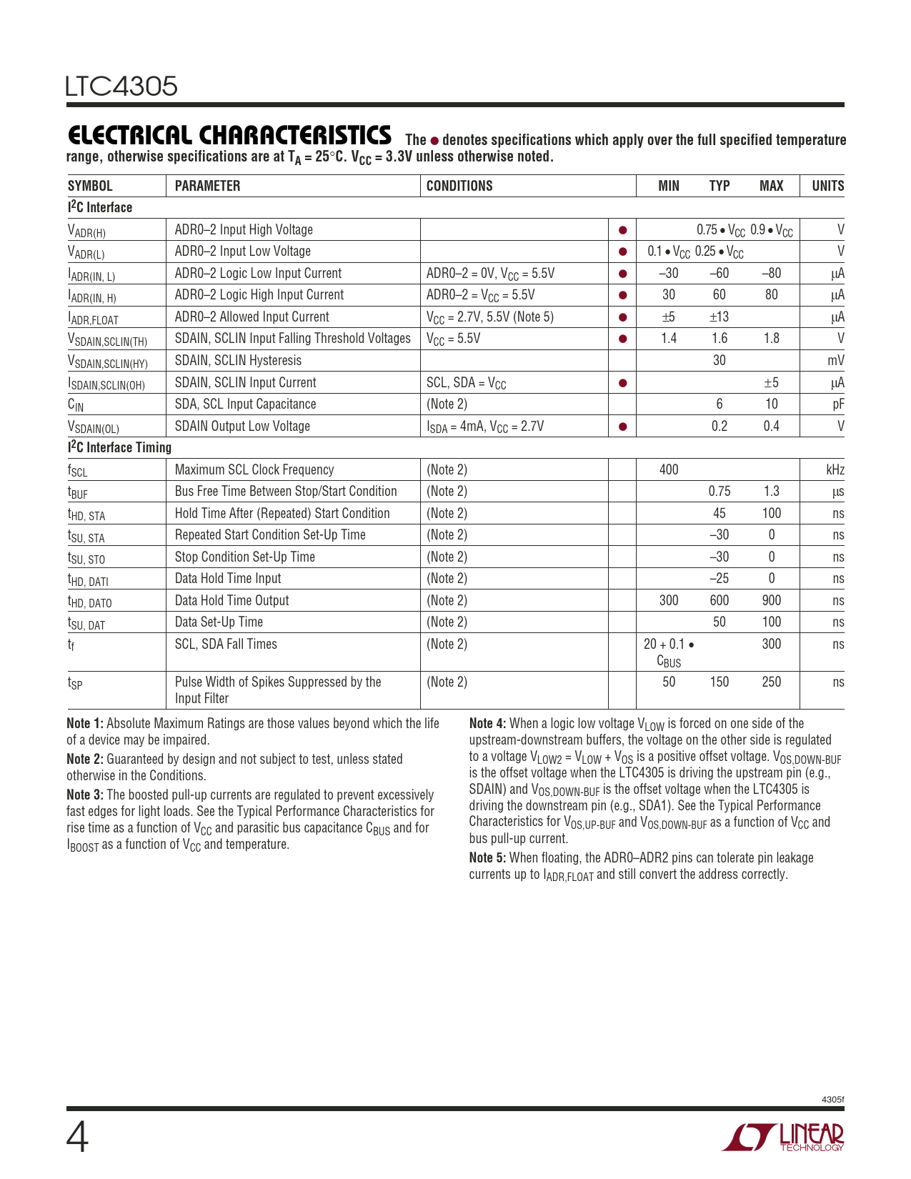

ELECTRICAL CHARACTERISTICS The. denotes specifications which apply over the full specified temperature
ELECTRICAL CHARACTERISTICS The denotes specifications which apply over the full specified temperature
LTC4305
denotes specifications which apply over the full specified temperature range, otherwise specifications are at TA = 25
C. VCC = 3.3V unless otherwise noted. SYMBOL PARAMETER CONDITIONS MIN TYP MAX UNITS I2C Interface
VADR(H) ADR0–2 Input High Voltage ● 0.75 • VCC 0.9 • VCC V VADR(L) ADR0–2 Input Low Voltage ● 0.1 • VCC 0.25 • VCC V IADR(IN, L) ADR0–2 Logic Low Input Current ADR0–2 = 0V, VCC = 5.5V ● –30 –60 –80 µA IADR(IN, H) ADR0–2 Logic High Input Current ADR0–2 = VCC = 5.5V ● 30 60 80 µA IADR,FLOAT ADR0–2 Allowed Input Current VCC = 2.7V, 5.5V (Note 5) ● ±5 ±13 µA VSDAIN,SCLIN(TH) SDAIN, SCLIN Input Falling Threshold Voltages VCC = 5.5V ● 1.4 1.6 1.8 V VSDAIN,SCLIN(HY) SDAIN, SCLIN Hysteresis 30 mV ISDAIN,SCLIN(OH) SDAIN, SCLIN Input Current SCL, SDA = VCC ● ±5 µA CIN SDA, SCL Input Capacitance (Note 2) 6 10 pF VSDAIN(OL) SDAIN Output Low Voltage ISDA = 4mA, VCC = 2.7V ● 0.2 0.4 V
I2C Interface Timing
fSCL Maximum SCL Clock Frequency (Note 2) 400 kHz tBUF Bus Free Time Between Stop/Start Condition (Note 2) 0.75 1.3 µs tHD, STA Hold Time After (Repeated) Start Condition (Note 2) 45 100 ns tSU, STA Repeated Start Condition Set-Up Time (Note 2) –30 0 ns tSU, STO Stop Condition Set-Up Time (Note 2) –30 0 ns tHD, DATI Data Hold Time Input (Note 2) –25 0 ns tHD, DATO Data Hold Time Output (Note 2) 300 600 900 ns tSU, DAT Data Set-Up Time (Note 2) 50 100 ns tf SCL, SDA Fall Times (Note 2) 20 + 0.1 • 300 ns CBUS tSP Pulse Width of Spikes Suppressed by the (Note 2) 50 150 250 ns Input Filter
Note 1:
Absolute Maximum Ratings are those values beyond which the life
Note 4:
When a logic low voltage VLOW is forced on one side of the of a device may be impaired. upstream-downstream buffers, the voltage on the other side is regulated
Note 2:
Guaranteed by design and not subject to test, unless stated to a voltage VLOW2 = VLOW + VOS is a positive offset voltage. VOS,DOWN-BUF otherwise in the Conditions. is the offset voltage when the LTC4305 is driving the upstream pin (e.g.,
Note 3:
The boosted pull-up currents are regulated to prevent excessively SDAIN) and VOS,DOWN-BUF is the offset voltage when the LTC4305 is fast edges for light loads. See the Typical Performance Characteristics for driving the downstream pin (e.g., SDA1). See the Typical Performance rise time as a function of V Characteristics for VOS,UP-BUF and VOS,DOWN-BUF as a function of VCC and CC and parasitic bus capacitance CBUS and for I bus pull-up current. BOOST as a function of VCC and temperature.
Note 5:
When floating, the ADR0–ADR2 pins can tolerate pin leakage currents up to IADR,FLOAT and still convert the address correctly. 4305f 4
