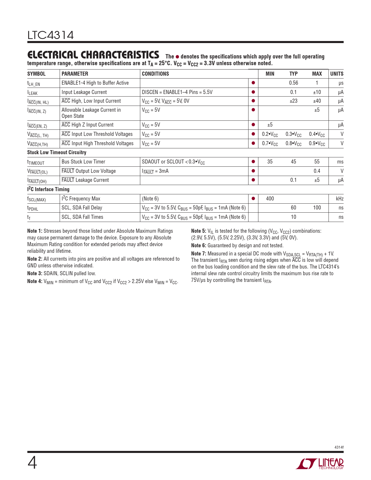

ELECTRICAL CHARACTERISTICS. The. denotes the specifi cations which apply over the full operating
ELECTRICAL CHARACTERISTICS The denotes the specifi cations which apply over the full operating
LTC4314
l
denotes the specifi cations which apply over the full operating temperature range, otherwise specifi cations are at TA = 25°C. VCC = VCC2 = 3.3V unless otherwise noted. SYMBOL PARAMETER CONDITIONS MIN TYP MAX UNITS
tLH_EN ENABLE1-4 High to Buffer Active l 0.56 1 μs ILEAK Input Leakage Current DISCEN = ENABLE1–4 Pins = 5.5V l 0.1 ±10 μA IACC(IN, HL) ACC High, Low Input Current VCC = 5V, VACC = 5V, 0V l ±23 ±40 μA IACC(IN, Z) Allowable Leakage Current in VCC = 5V l ±5 μA Open State IACC(EN, Z) ACC High Z Input Current VCC = 5V l ±5 μA VACC(L, TH) ACC Input Low Threshold Voltages VCC = 5V l 0.2•VCC 0.3•VCC 0.4•VCC V VACC(H,TH) ACC Input High Threshold Voltages VCC = 5V l 0.7•VCC 0.8•VCC 0.9•VCC V
Stuck Low Timeout Circuitry
tTIMEOUT Bus Stuck Low Timer SDAOUT or SCLOUT < 0.3•VCC l 35 45 55 ms VFAULT(OL) FAULT Output Low Voltage IFAULT = 3mA l 0.4 V IFAULT(OH) FAULT Leakage Current l 0.1 ±5 μA
I2C Interface Timing
fSCL(MAX) I2C Frequency Max (Note 6) l 400 kHz tPDHL SCL, SDA Fall Delay VCC = 3V to 5.5V, CBUS = 50pF, IBUS = 1mA (Note 6) 60 100 ns tf SCL, SDA Fall Times VCC = 3V to 5.5V, CBUS = 50pF, IBUS = 1mA (Note 6) 10 ns
Note 1:
Note 5:
VIL is tested for the following (VCC, VCC2) combinations: may cause permanent damage to the device. Exposure to any Absolute (2.9V, 5.5V), (5.5V, 2.25V), (3.3V, 3.3V) and (5V, 0V). Maximum Rating condition for extended periods may affect device
Note 6:
Guaranteed by design and not tested. reliability and lifetime.
Note 7:
Measured in a special DC mode with VSDA,SCL = VRTA(TH) + 1V.
Note 2:
All currents into pins are positive and all voltages are referenced to The transient IRTA seen during rising edges when ACC is low will depend GND unless otherwise indicated. on the bus loading condition and the slew rate of the bus. The LTC4314’s
Note 3:
SDAIN, SCLIN pulled low. internal slew rate control circuitry limits the maximum bus rise rate to
Note 4:
V 75V/μs by controlling the transient I MIN = minimum of VCC and VCC2 if VCC2 > 2.25V else VMIN = VCC. RTA. 4314f 4
