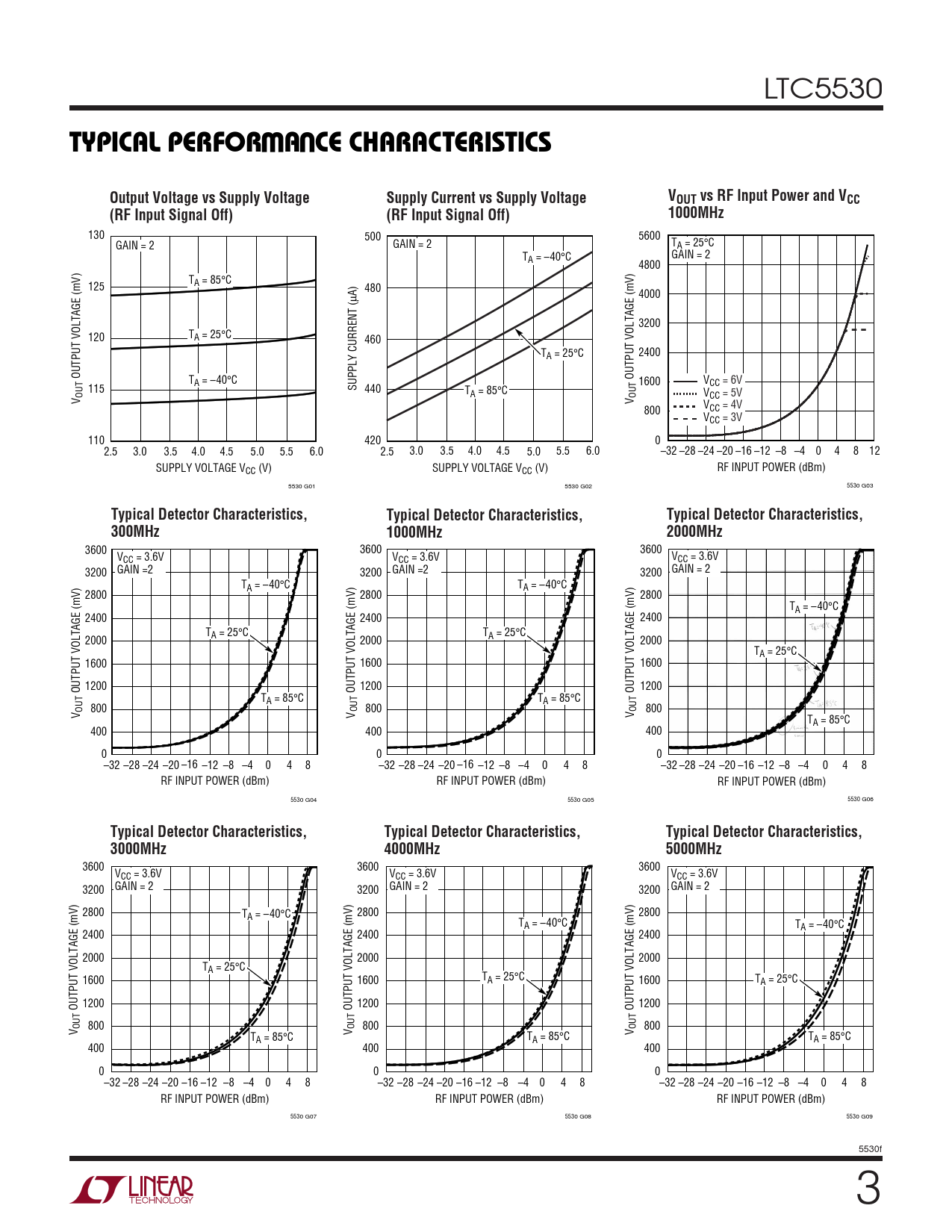

TYPICAL PERFOR A CE CHARACTERISTICS. Output Voltage vs Supply Voltage. Supply Current vs Supply Voltage
TYPICAL PERFOR A CE CHARACTERISTICS Output Voltage vs Supply Voltage Supply Current vs Supply Voltage
LTC5530
W U TYPICAL PERFOR A CE CHARACTERISTICS Output Voltage vs Supply Voltage Supply Current vs Supply Voltage VOUT vs RF Input Power and VCC (RF Input Signal Off) (RF Input Signal Off) 1000MHz
130 500 5600 GAIN = 2 GAIN = 2 TA = 25°C T GAIN = 2 A = –40°C 4800 T 125 A = 85°C 480 µA) 4000 3200 120 TA = 25°C 460 TA = 25°C 2400 OUTPUT VOLTAGE (mV) T OUTPUT VOLTAGE (mV) A = –40°C 1600 VCC = 6V 115 SUPPLY CURRENT ( 440 OUT TA = 85°C OUT V V V CC = 5V V 800 CC = 4V VCC = 3V 110 420 0 2.5 3.0 3.5 4.0 4.5 5.0 5.5 6.0 2.5 3.0 3.5 4.0 4.5 5.0 5.5 6.0 –32 –28 –24 –20 –16 –12 –8 –4 0 4 8 12 SUPPLY VOLTAGE VCC (V) SUPPLY VOLTAGE VCC (V) RF INPUT POWER (dBm) 5530 G01 5530 G02 5530 G03
Typical Detector Characteristics, Typical Detector Characteristics, Typical Detector Characteristics, 300MHz 1000MHz 2000MHz
3600 3600 3600 VCC = 3.6V VCC = 3.6V VCC = 3.6V 3200 GAIN =2 3200 GAIN =2 3200 GAIN = 2 TA = –40°C TA = –40°C 2800 2800 2800 TA = –40°C 2400 2400 2400 TA = 25°C TA = 25°C 2000 2000 2000 TA = 25°C 1600 1600 1600 1200 1200 1200 OUTPUT VOLTAGE (mV) OUTPUT VOLTAGE (mV) OUTPUT VOLTAGE (mV) TA = 85°C TA = 85°C OUT 800 OUT 800 OUT 800 V V V TA = 85°C 400 400 400 0 0 0 –32 –28 –24 –20 –16 –12 –8 –4 0 4 8 –32 –28 –24 –20 –16 –12 –8 –4 0 4 8 –32 –28 –24 –20 –16 –12 –8 –4 0 4 8 RF INPUT POWER (dBm) RF INPUT POWER (dBm) RF INPUT POWER (dBm) 5530 G04 5530 G05 5530 G06
Typical Detector Characteristics, Typical Detector Characteristics, Typical Detector Characteristics, 3000MHz 4000MHz 5000MHz
3600 3600 3600 VCC = 3.6V VCC = 3.6V VCC = 3.6V 3200 GAIN = 2 3200 GAIN = 2 3200 GAIN = 2 2800 TA = –40°C 2800 2800 TA = –40°C TA = –40°C 2400 2400 2400 2000 2000 2000 TA = 25°C 1600 1600 TA = 25°C 1600 TA = 25°C 1200 1200 1200 OUTPUT VOLTAGE (mV) OUTPUT VOLTAGE (mV) OUTPUT VOLTAGE (mV) OUT 800 OUT 800 OUT 800 V V V TA = 85°C TA = 85°C TA = 85°C 400 400 400 0 0 0 –32 –28 –24 –20 –16 –12 –8 –4 0 4 8 –32 –28 –24 –20 –16 –12 –8 –4 0 4 8 –32 –28 –24 –20 –16 –12 –8 –4 0 4 8 RF INPUT POWER (dBm) RF INPUT POWER (dBm) RF INPUT POWER (dBm) 5530 G07 5530 G08 5530 G09 5530f 3
