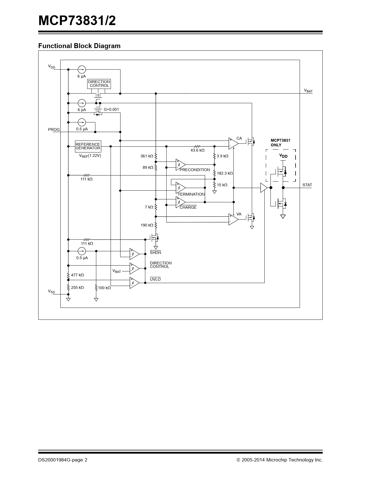

DescriptionMiniature Single-Cell, Fully Integrated Li-Ion, Li-Polymer Charge Management Controllers
Pages / Page28 / 2 — MCP73831/2. Functional Block Diagram. MCP73831. ONLY. VDD
Revision07-14-2014
File Format / SizePDF / 843 Kb
MCP73831/2 Functional Block Diagram MCP73831 ONLY VDD
VDD 6 µA DIRECTION CONTROL VBAT 6 µA G=0.001 PROG 0.5 µA + CA
MCP73831
REFERENCE -
ONLY
GENERATOR 43.6 k VREF(1.22V) 361 k 3.9 k
VDD
+ 89 k - PRECONDITION 182.3k 111 k + 15 k STAT - TERMINATION + - 7 k CHARGE + VA - 190 k 111 k + SHDN - 0.5 µA + DIRECTION CONTROL VBAT - 477 k + UVLO - 255 k 100 k VSS DS20001984G-page 2  2005-2014 Microchip Technology Inc. Document Outline MCP73831/2 Functional Block Diagram 1.0 Electrical Characteristics 2.0 Typical Performance Curves FIGURE 2-1: Battery Regulation Voltage (VBAT) vs. Supply Voltage (VDD). FIGURE 2-2: Battery Regulation Voltage (VBAT) vs. Ambient Temperature (TA). FIGURE 2-3: Output Leakage Current (IDISCHARGE) vs. Battery Regulation Voltage (VBAT). FIGURE 2-4: Charge Current (IOUT) vs. Programming Resistor (RPROG). FIGURE 2-5: Charge Current (IOUT) vs. Supply Voltage (VDD). FIGURE 2-6: Charge Current (IOUT) vs. Supply Voltage (VDD). FIGURE 2-7: Charge Current (IOUT) vs. Ambient Temperature (TA). FIGURE 2-8: Charge Current (IOUT) vs. Ambient Temperature (TA). FIGURE 2-9: Charge Current (IOUT) vs. Junction Temperature (TJ). FIGURE 2-10: Charge Current (IOUT) vs. Junction Temperature (TJ). FIGURE 2-11: Power Supply Ripple Rejection (PSRR). FIGURE 2-12: Power Supply Ripple Rejection (PSRR). FIGURE 2-13: Line Transient Response. FIGURE 2-14: Line Transient Response. FIGURE 2-15: Load Transient Response. FIGURE 2-16: Load Transient Response. FIGURE 2-17: Complete Charge Cycle (180 mAh Li-Ion Battery). FIGURE 2-18: Complete Charge Cycle (1000 mAh Li-Ion Battery). 3.0 Pin Description TABLE 3-1: Pin Function TableS 3.1 Battery Management Input Supply (VDD) 3.2 Battery Charge Control Output (VBAT) 3.3 Charge Status Output (STAT) 3.4 Battery Management 0V Reference (VSS) 3.5 Current Regulation Set (PROG) 3.6 Exposed Thermal Pad (EP) 4.0 Device Overview FIGURE 4-1: Flowchart. 4.1 Undervoltage Lockout (UVLO) 4.2 Battery Detection 4.3 Charge Qualification 4.4 Preconditioning 4.5 Fast Charge Constant-Current Mode 4.6 Constant-Voltage Mode 4.7 Charge Termination 4.8 Automatic Recharge 4.9 Thermal Regulation FIGURE 4-2: Thermal Regulation. 4.10 Thermal Shutdown 5.0 Detailed Description 5.1 Analog Circuitry 5.2 Digital Circuitry TABLE 5-1: Status Output 6.0 Applications FIGURE 6-1: Typical Application Circuit. FIGURE 6-2: Typical Charge Profile (180 mAh Battery). FIGURE 6-3: Typical Charge Profile in Thermal Regulation (1000 mAh Battery). 6.1 Application Circuit Design 6.2 PCB Layout Issues FIGURE 6-4: Typical Layout (Top). FIGURE 6-5: Typical Layout (Bottom). 7.0 Packaging Information 7.1 Package Marking Information Appendix A: Revision History Product ID System Trademarks Worldwide Sales
