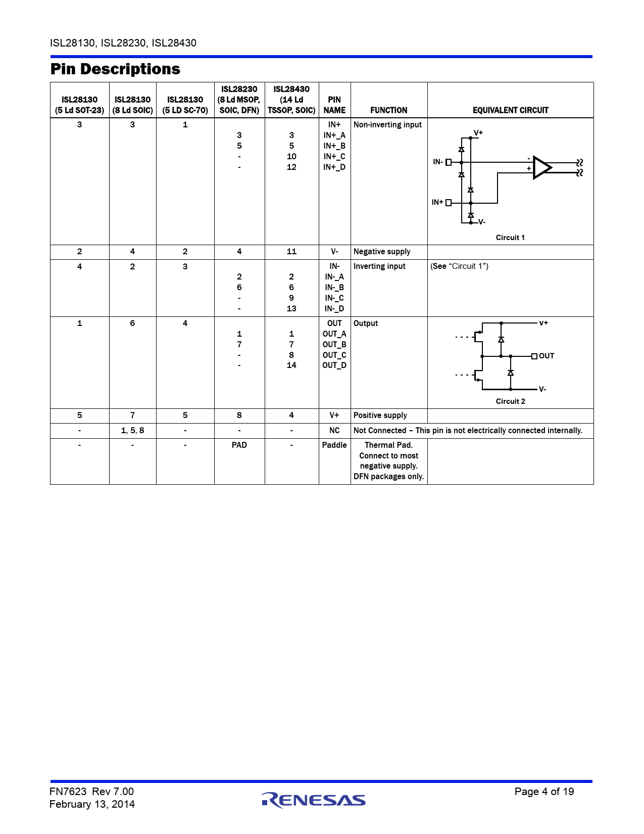

link to page 4 ISL28130, ISL28230, ISL28430 Pin Descriptions ISL28230 ISL28430 ISL28130 ISL28130 ISL28130 (8 Ld MSOP, (14 Ld PIN (5 Ld SOT-23) (8 Ld SOIC) (5 LD SC-70) SOIC, DFN) TSSOP, SOIC) NAME FUNCTION EQUIVALENT CIRCUIT 3 3 1 IN+ Non-inverting input 3 3 IN+_A
V+
5 5 IN+_B - 10 IN+_C
IN- -
- 12 IN+_D
+ IN+ V- Circuit 1
2 4 2 4 11 V- Negative supply 4 2 3 IN- Inverting input (See “Circuit 1”) 2 2 IN-_A 6 6 IN-_B - 9 IN-_C - 13 IN-_D 1 6 4 OUT Output
V+
1 1 OUT_A 7 7 OUT_B - 8 OUT_C
OUT
- 14 OUT_D
V- Circuit 2
