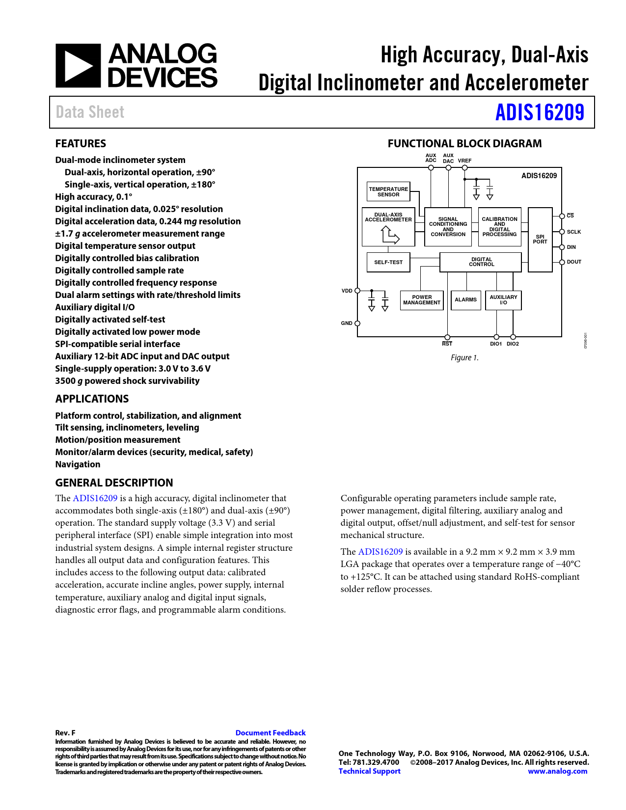

High Accuracy, Dual-Axis Digital Inclinometer and Accelerometer Data Sheet ADIS16209 FEATURES FUNCTIONAL BLOCK DIAGRAM Dual-mode inclinometer system AUX AUX ADC DAC VREF Dual-axis, horizontal operation, ±90° ADIS16209 Single-axis, vertical operation, ±180° TEMPERATURE High accuracy, 0.1° SENSOR Digital inclination data, 0.025° resolution DUAL-AXIS Digital acceleration data, 0.244 mg resolution CS ACCELEROMETER SIGNAL CALIBRATION CONDITIONING AND ±1.7 g accelerometer measurement range AND DIGITAL SCLK CONVERSION PROCESSING SPI Digital temperature sensor output PORT DIN Digitally controlled bias calibration DIGITAL SELF-TEST DOUT CONTROL Digitally controlled sample rate Digitally controlled frequency response Dual alarm settings with rate/threshold limits VDD POWER AUXILIARY ALARMS Auxiliary digital I/O MANAGEMENT I/O Digitally activated self-test GND Digitally activated low power mode

Single-supply operation: 3.0 V to 3.6 V 3500 g powered shock survivability APPLICATIONS Platform control, stabilization, and alignment Tilt sensing, inclinometers, leveling Motion/position measurement Monitor/alarm devices (security, medical, safety) Navigation GENERAL DESCRIPTION
The ADIS16209 is a high accuracy, digital inclinometer that Configurable operating parameters include sample rate, accommodates both single-axis (±180°) and dual-axis (±90°) power management, digital filtering, auxiliary analog and operation. The standard supply voltage (3.3 V) and serial digital output, offset/null adjustment, and self-test for sensor peripheral interface (SPI) enable simple integration into most mechanical structure. industrial system designs. A simple internal register structure The ADIS16209 is available in a 9.2 mm × 9.2 mm × 3.9 mm handles all output data and configuration features. This LGA package that operates over a temperature range of −40°C includes access to the fol owing output data: calibrated to +125°C. It can be attached using standard RoHS-compliant acceleration, accurate incline angles, power supply, internal solder reflow processes. temperature, auxiliary analog and digital input signals, diagnostic error flags, and programmable alarm conditions.
