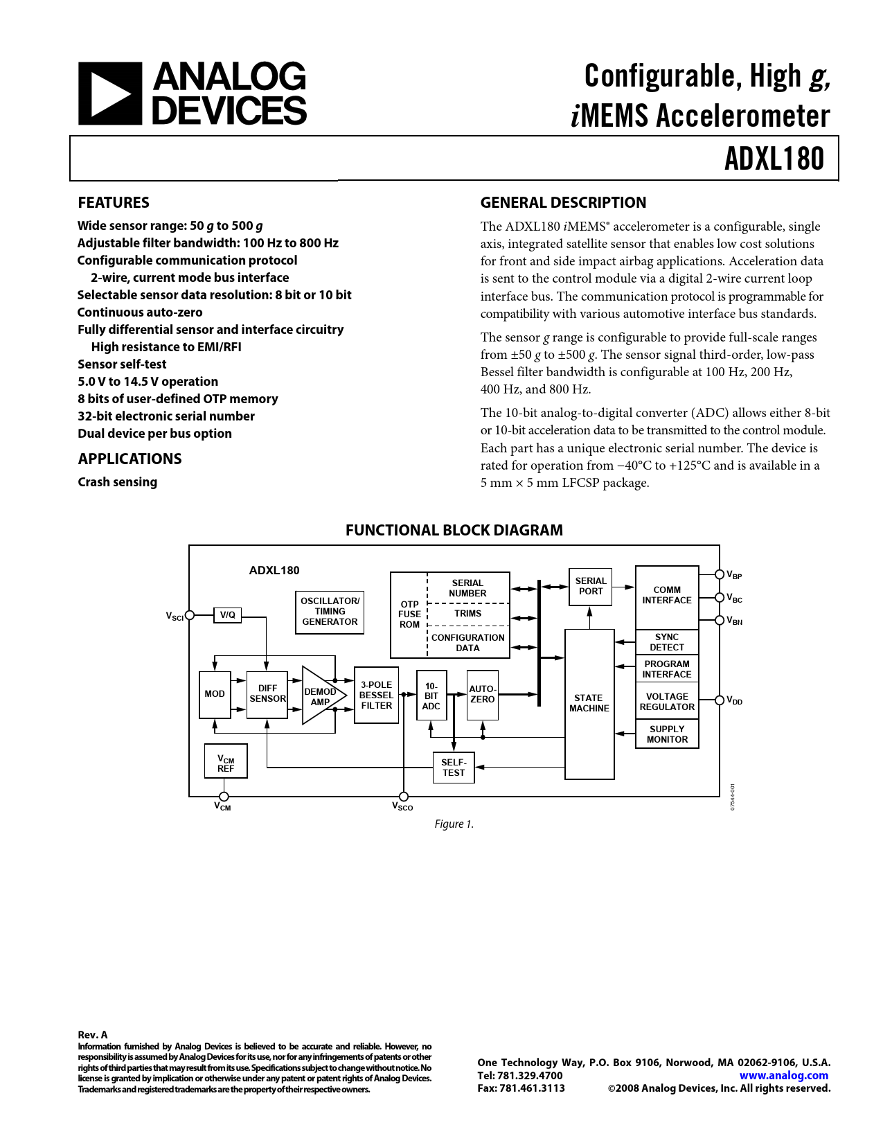

Configurable, High g,. MEMS Accelerometer. ADXL180. FEATURES. GENERAL DESCRIPTION. Wide sensor range: 50 g. to 500 g
Datasheet ADXL180 Analog Devices, Revision: B
Configurable, High g, i MEMS Accelerometer ADXL180 FEATURES GENERAL DESCRIPTION Wide sensor range: 50 g to 500 g
The ADXL180 iMEMS® accelerometer is a configurable, single
Adjustable filter bandwidth: 100 Hz to 800 Hz
axis, integrated satellite sensor that enables low cost solutions
Configurable communication protocol
for front and side impact airbag applications. Acceleration data
2-wire, current mode bus interface
is sent to the control module via a digital 2-wire current loop
Selectable sensor data resolution: 8 bit or 10 bit
interface bus. The communication protocol is programmable for
Continuous auto-zero
compatibility with various automotive interface bus standards.
Fully differential sensor and interface circuitry
The sensor g range is configurable to provide full-scale ranges
High resistance to EMI/RFI
from ±50 g to ±500 g. The sensor signal third-order, low-pass
Sensor self-test
Bessel filter bandwidth is configurable at 100 Hz, 200 Hz,
5.0 V to 14.5 V operation
400 Hz, and 800 Hz.
8 bits of user-defined OTP memory 32-bit electronic serial number
The 10-bit analog-to-digital converter (ADC) allows either 8-bit
Dual device per bus option
or 10-bit acceleration data to be transmitted to the control module. Each part has a unique electronic serial number. The device is
APPLICATIONS
rated for operation from −40°C to +125°C and is available in a
Crash sensing
5 mm × 5 mm LFCSP package.
FUNCTIONAL BLOCK DIAGRAM ADXL180 VBP SERIAL SERIAL PORT COMM NUMBER OSCILLATOR/ INTERFACE V OTP BC TIMING V V/Q FUSE TRIMS SCI V GENERATOR BN ROM CONFIGURATION SYNC DATA DETECT PROGRAM INTERFACE 3-POLE 10- DIFF AUTO- MOD DEMOD BESSEL BIT SENSOR ZERO STATE VOLTAGE V AMP DD FILTER ADC MACHINE REGULATOR SUPPLY MONITOR VCM SELF- REF TEST
01 0 4- 54
V V CM SCO
07 Figure 1.
