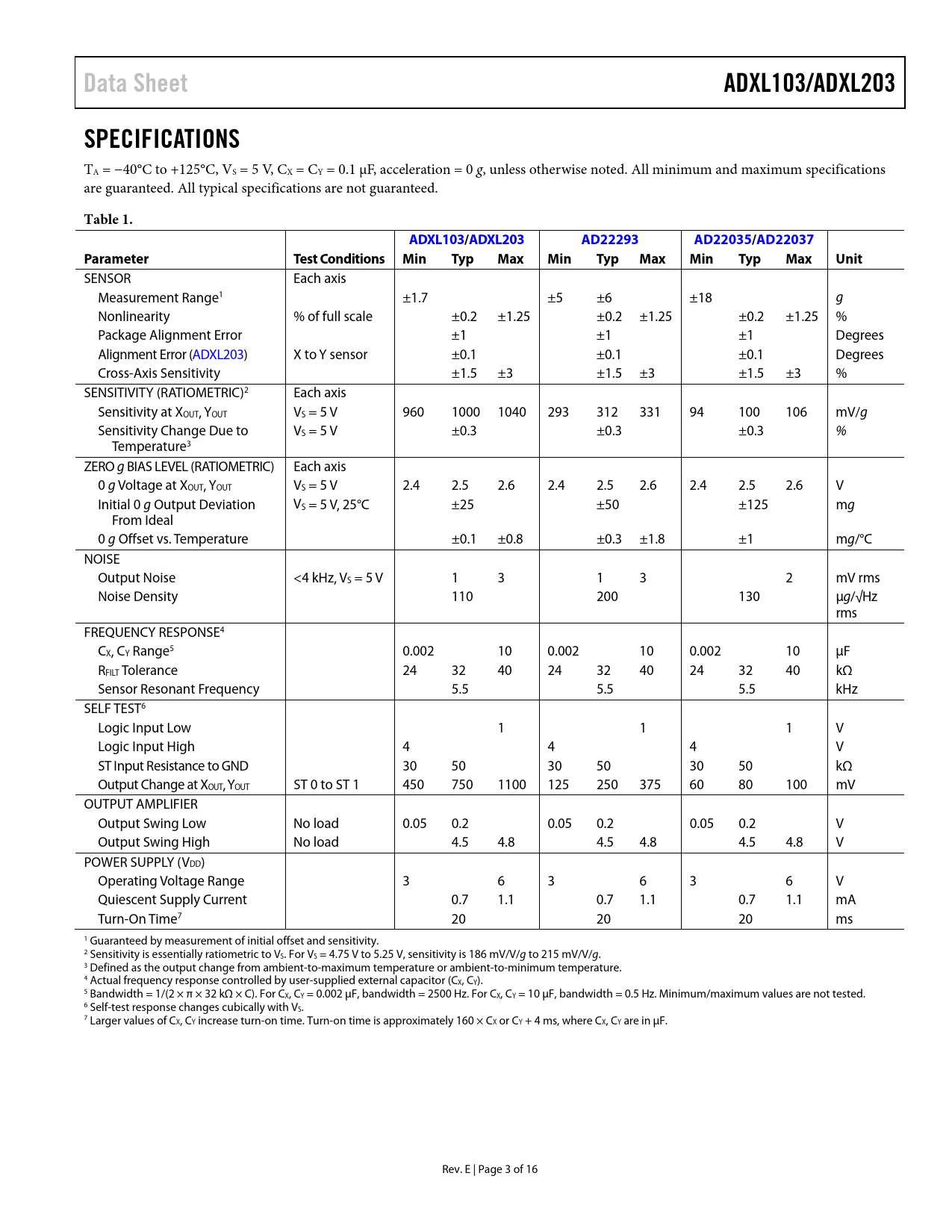

Data Sheet. ADXL103/ADXL203. SPECIFICATIONS. Table 1. ADXL103/. ADXL203. AD22293. AD22035/. AD22037. Parameter. Test. Conditions
Data Sheet ADXL103/ADXL203 SPECIFICATIONS Table 1 ADXL103/ ADXL203 AD22293 AD22035/ AD22037 Parameter Test Conditions
link to page 3 link to page 3 link to page 3 link to page 3 link to page 3 link to page 3 link to page 3
TA = −40°C to +125°C, VS = 5 V, CX = CY = 0.1 μF, acceleration = 0 g, unless otherwise noted. All minimum and maximum specifications are guaranteed. All typical specifications are not guaranteed.
Table 1. ADXL103/ ADXL203 AD22293 AD22035/ AD22037 Parameter Test Conditions Min Typ Max Min Typ Max Min Typ Max Unit
SENSOR Each axis Measurement Range1 ±1.7 ±5 ±6 ±18 g Nonlinearity % of full scale ±0.2 ±1.25 ±0.2 ±1.25 ±0.2 ±1.25 % Package Alignment Error ±1 ±1 ±1 Degrees Alignment Error (ADXL203) X to Y sensor ±0.1 ±0.1 ±0.1 Degrees Cross-Axis Sensitivity ±1.5 ±3 ±1.5 ±3 ±1.5 ±3 % SENSITIVITY (RATIOMETRIC)2 Each axis Sensitivity at XOUT, YOUT VS = 5 V 960 1000 1040 293 312 331 94 100 106 mV/g Sensitivity Change Due to VS = 5 V ±0.3 ±0.3 ±0.3 % Temperature3 ZERO g BIAS LEVEL (RATIOMETRIC) Each axis 0 g Voltage at XOUT, YOUT VS = 5 V 2.4 2.5 2.6 2.4 2.5 2.6 2.4 2.5 2.6 V Initial 0 g Output Deviation VS = 5 V, 25°C ±25 ±50 ±125 mg From Ideal 0 g Offset vs. Temperature ±0.1 ±0.8 ±0.3 ±1.8 ±1 mg/°C NOISE Output Noise <4 kHz, VS = 5 V 1 3 1 3 2 mV rms Noise Density 110 200 130 μg/√Hz rms FREQUENCY RESPONSE4 CX, CY Range5 0.002 10 0.002 10 0.002 10 μF RFILT Tolerance 24 32 40 24 32 40 24 32 40 kΩ Sensor Resonant Frequency 5.5 5.5 5.5 kHz SELF TEST6 Logic Input Low 1 1 1 V Logic Input High 4 4 4 V ST Input Resistance to GND 30 50 30 50 30 50 kΩ Output Change at XOUT, YOUT ST 0 to ST 1 450 750 1100 125 250 375 60 80 100 mV OUTPUT AMPLIFIER Output Swing Low No load 0.05 0.2 0.05 0.2 0.05 0.2 V Output Swing High No load 4.5 4.8 4.5 4.8 4.5 4.8 V POWER SUPPLY (VDD) Operating Voltage Range 3 6 3 6 3 6 V Quiescent Supply Current 0.7 1.1 0.7 1.1 0.7 1.1 mA Turn-On Time7 20 20 20 ms 1 Guaranteed by measurement of initial offset and sensitivity. 2 Sensitivity is essentially ratiometric to VS. For VS = 4.75 V to 5.25 V, sensitivity is 186 mV/V/g to 215 mV/V/g. 3 Defined as the output change from ambient-to-maximum temperature or ambient-to-minimum temperature. 4 Actual frequency response controlled by user-supplied external capacitor (CX, CY). 5 Bandwidth = 1/(2 × π × 32 kΩ × C). For CX, CY = 0.002 μF, bandwidth = 2500 Hz. For CX, CY = 10 μF, bandwidth = 0.5 Hz. Minimum/maximum values are not tested. 6 Self-test response changes cubically with VS. 7 Larger values of CX, CY increase turn-on time. Turn-on time is approximately 160 × CX or CY + 4 ms, where CX, CY are in μF. Rev. E | Page 3 of 16 Document Outline Features Applications General Description Functional Block Diagrams Revision History Specifications Absolute Maximum Ratings ESD Caution Pin Configurations and Function Descriptions Typical Performance Characteristics ADXL103 and ADXL203 AD22293 AD22035 and AD22037 All Models Theory of Operation Performance Applications Information Power Supply Decoupling Setting the Bandwidth Using CX and CY Self Test Design Trade-Offs for Selecting Filter Characteristics: The Noise/Bandwidth Trade-Off Using the ADXL103/ADXL203 with Operating Voltages Other than 5 V Using the ADXL203 as a Dual-Axis Tilt Sensor Dual-Axis Tilt Sensor: Converting Acceleration to Tilt Outline Dimensions Ordering Guide Automotive Products
