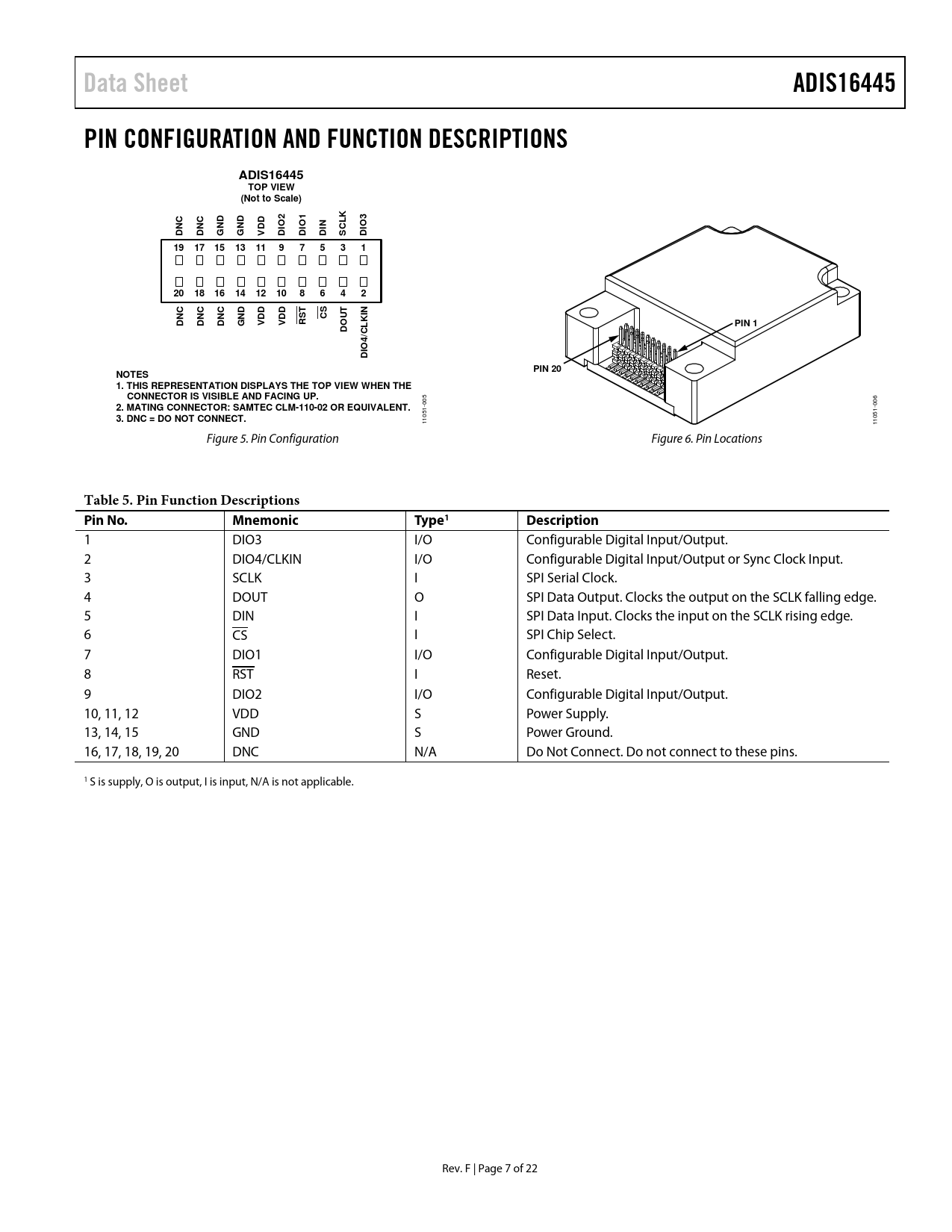

Data Sheet. ADIS16445. PIN CONFIGURATION AND FUNCTION DESCRIPTIONS. TOP VIEW. (Not to Scale). IO2. IO1. IO3. DNC. PIN 1. IO4 D. PIN 20
Data Sheet ADIS16445 PIN CONFIGURATION AND FUNCTION DESCRIPTIONS TOP VIEW (Not to Scale) IO2 IO1 IO3 DNC PIN 1 IO4 D PIN 20
Data Sheet ADIS16445 PIN CONFIGURATION AND FUNCTION DESCRIPTIONS ADIS16445 TOP VIEW (Not to Scale) K ND ND DD IO2 N IO1 CL IO3 DNC DNC G G V D D DI S D 19 17 15 13 11 9 7 5 3 1 20 18 16 14 12 10 8 6 4 2 T IN ND DD DD CS UT DNC DNC DNC G V V RS LK PIN 1 DO /C IO4 D PIN 20 NOTES 1. THIS REPRESENTATION DISPLAYS THE TOP VIEW WHEN THE CONNECTOR IS VISIBLE AND FACING UP.
005 006
2. MATING CONNECTOR: SAMTEC CLM-110-02 OR EQUIVALENT. 3. DNC = DO NOT CONNECT.
1051- 1 1051- 1 Figure 5. Pin Configuration Figure 6. Pin Locations
Table 5. Pin Function Descriptions Pin No. Mnemonic Type1 Description
1 DIO3 I/O Configurable Digital Input/Output. 2 DIO4/CLKIN I/O Configurable Digital Input/Output or Sync Clock Input. 3 SCLK I SPI Serial Clock. 4 DOUT O SPI Data Output. Clocks the output on the SCLK falling edge. 5 DIN I SPI Data Input. Clocks the input on the SCLK rising edge. 6 CS I SPI Chip Select. 7 DIO1 I/O Configurable Digital Input/Output. 8 RST I Reset. 9 DIO2 I/O Configurable Digital Input/Output. 10, 11, 12 VDD S Power Supply. 13, 14, 15 GND S Power Ground. 16, 17, 18, 19, 20 DNC N/A Do Not Connect. Do not connect to these pins. 1 S is supply, O is output, I is input, N/A is not applicable. Rev. F | Page 7 of 22 Document Outline Features Applications General Description Functional Block Diagram Table of Contents Revision History Specifications Timing Specifications Timing Diagrams Absolute Maximum Ratings ESD Caution Pin Configuration and Function Descriptions Typical Performance Characteristics User Registers User Interface Reading Sensor Data Burst Read Function SPI Read Test Sequence Device Configuration Dual Memory Structure Output Data Registers Gyroscopes Accelerometers Internal Temperature System Functions Global Commands Product Identification Self-Test Function Status/Error Flags Memory Management Checksum Test Input/Output Configuration Data Ready Indicator General-Purpose Input/Output Example Input/Output Configuration Digital Processing Configuration Gyroscopes/Accelerometers Input Clock Configuration Digital Filtering Dynamic Range Calibration Gyroscopes Gyroscope Bias Error Estimation Gyroscope Bias Correction Factors Single Command Bias Correction Accelerometers Accelerometer Bias Error Estimation Accelerometer Bias Correction Factors Point of Percussion Alignment Flash Updates Restoring Factory Calibration Alarms Static Alarm Use Dynamic Alarm Use Alarm Reporting Alarm Example Applications Information Mounting Tips Power Supply Considerations ADIS16445/PCBZ Installation PC-Based Evaluation Tools Outline Dimensions Ordering Guide
