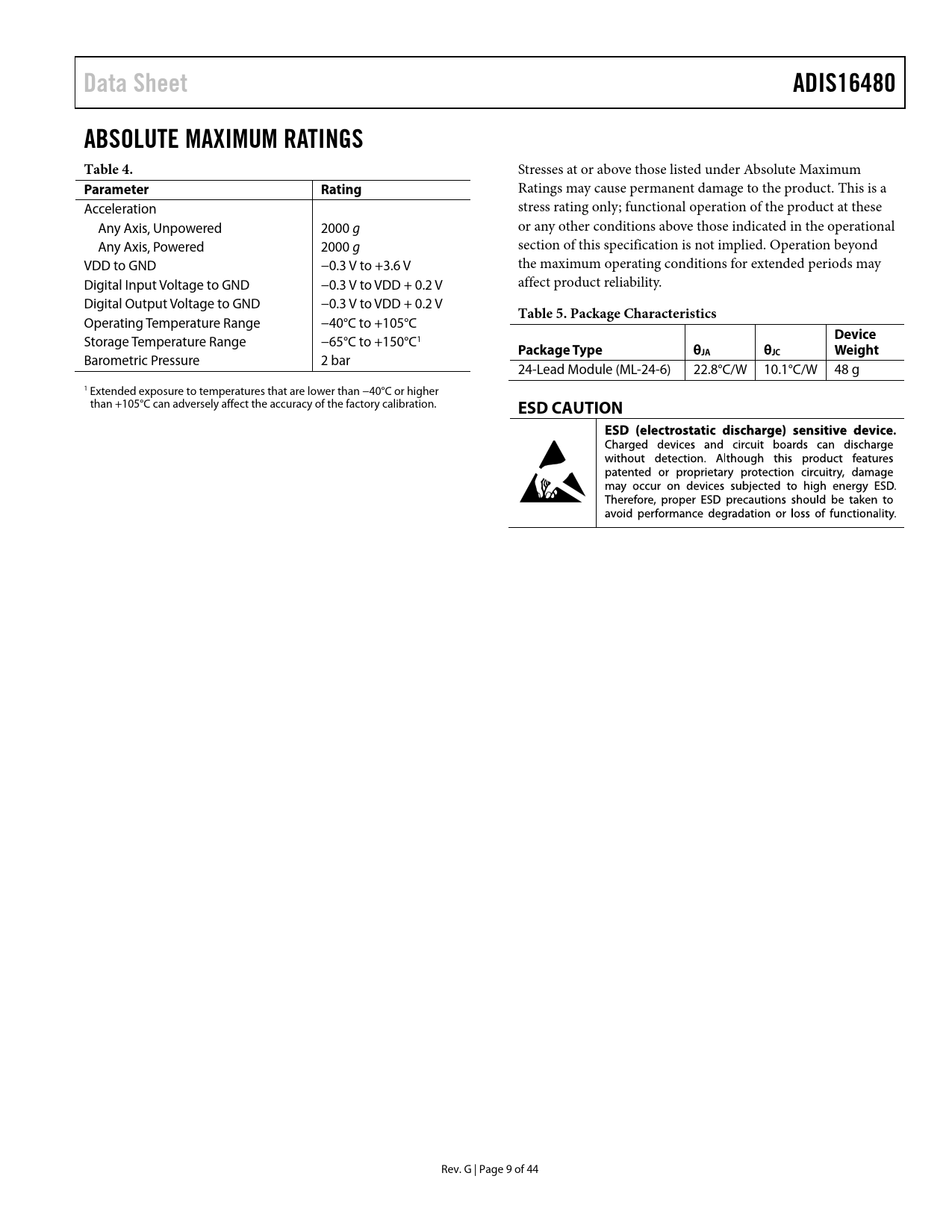

Data Sheet. ADIS16480. ABSOLUTE MAXIMUM RATINGS Table 4. Parameter. Rating. Table 5. Package Characteristics. Device. Package Type. θJA
Data Sheet ADIS16480 ABSOLUTE MAXIMUM RATINGS Table 4 Parameter Rating Table 5 Package Characteristics Device Package Type θJA
Data Sheet ADIS16480 ABSOLUTE MAXIMUM RATINGS Table 4.
Stresses at or above those listed under Absolute Maximum
Parameter Rating
Ratings may cause permanent damage to the product. This is a Acceleration stress rating only; functional operation of the product at these Any Axis, Unpowered 2000 g or any other conditions above those indicated in the operational Any Axis, Powered 2000 g section of this specification is not implied. Operation beyond VDD to GND −0.3 V to +3.6 V the maximum operating conditions for extended periods may Digital Input Voltage to GND −0.3 V to VDD + 0.2 V affect product reliability. Digital Output Voltage to GND −0.3 V to VDD + 0.2 V
Operating Temperature Range −40°C to +105°C Storage Temperature Range −65°C to +150°C
Device
1
Package Type θJA θJC Weight
Barometric Pressure 2 bar 24-Lead Module (ML-24-6) 22.8°C/W 10.1°C/W 48 g 1 Extended exposure to temperatures that are lower than −40°C or higher than +105°C can adversely affect the accuracy of the factory calibration.
