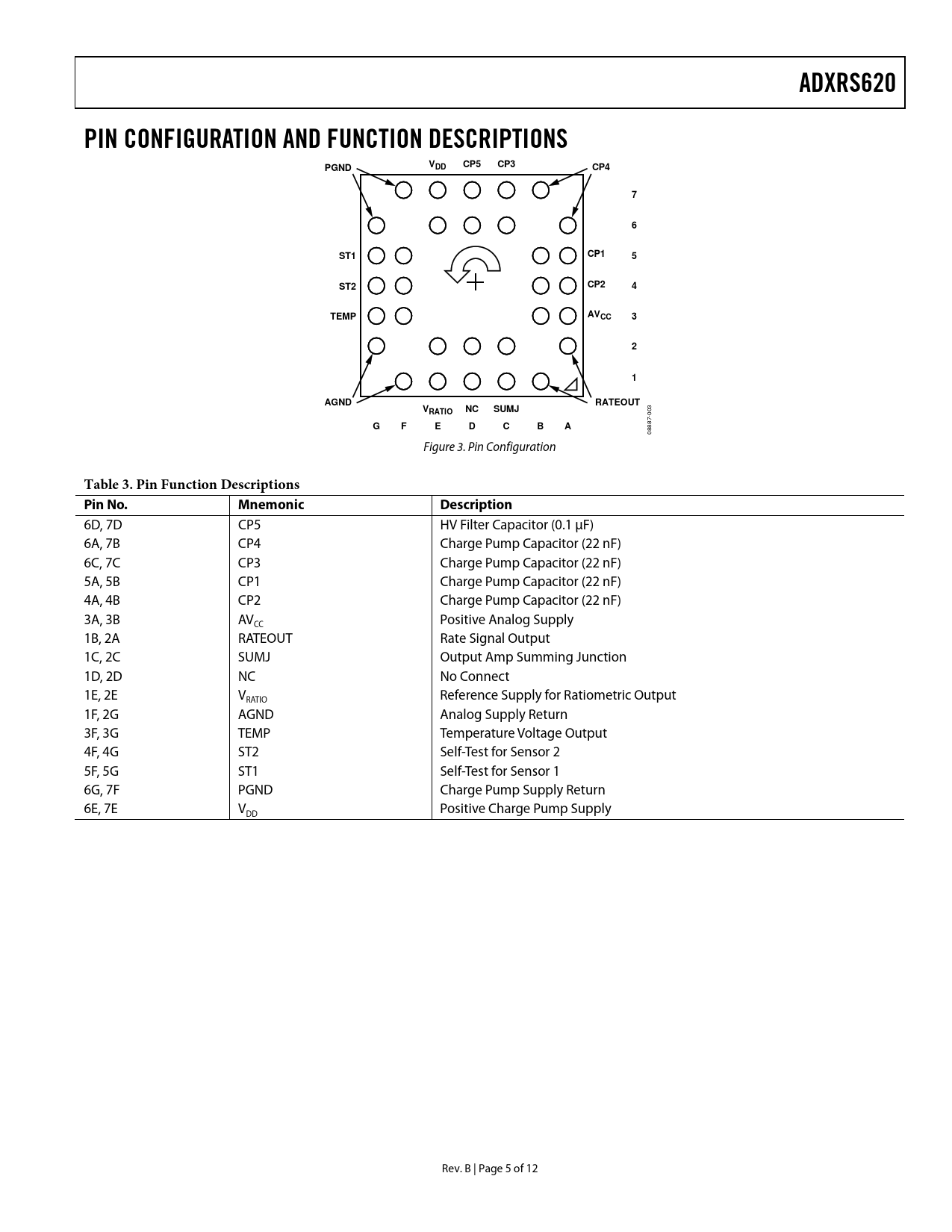

ADXRS620. PIN CONFIGURATION AND FUNCTION DESCRIPTIONS. PGND. CP5. CP3. CP4. ST1. CP1. ST2. CP2. TEMP. AVCC. AGND. RATEOUT. VRATIO. SUMJ
ADXRS620 PIN CONFIGURATION AND FUNCTION DESCRIPTIONS PGND V CP5 CP3 DD CP4 7 6 ST1 CP1 5 ST2 CP2 4 TEMP AVCC 3 2 1 AGND RATEOUT VRATIO NC SUMJ
003
G F E D C B A
08887- Figure 3. Pin Configuration
Table 3. Pin Function Descriptions Pin No. Mnemonic Description
6D, 7D CP5 HV Filter Capacitor (0.1 µF) 6A, 7B CP4 Charge Pump Capacitor (22 nF) 6C, 7C CP3 Charge Pump Capacitor (22 nF) 5A, 5B CP1 Charge Pump Capacitor (22 nF) 4A, 4B CP2 Charge Pump Capacitor (22 nF) 3A, 3B AV Positive Analog Supply CC 1B, 2A RATEOUT Rate Signal Output 1C, 2C SUMJ Output Amp Summing Junction 1D, 2D NC No Connect 1E, 2E V Reference Supply for Ratiometric Output RATIO 1F, 2G AGND Analog Supply Return 3F, 3G TEMP Temperature Voltage Output 4F, 4G ST2 Self-Test for Sensor 2 5F, 5G ST1 Self-Test for Sensor 1 6G, 7F PGND Charge Pump Supply Return 6E, 7E V Positive Charge Pump Supply DD Rev. B | Page 5 of 12 Document Outline Features Applications General Description Functional Block Diagram Revision History Specifications Absolute Maximum Ratings Rate Sensitive Axis ESD Caution Pin Configuration and Function Descriptions Typical Performance Characteristics Theory of Operation Setting Bandwidth Temperature Output and Calibration Calibrated Performance ADXRS620 and Supply Ratiometricity Null Adjustment Self-Test Function Continuous Self-Test Outline Dimensions Ordering Guide Automotive Products
