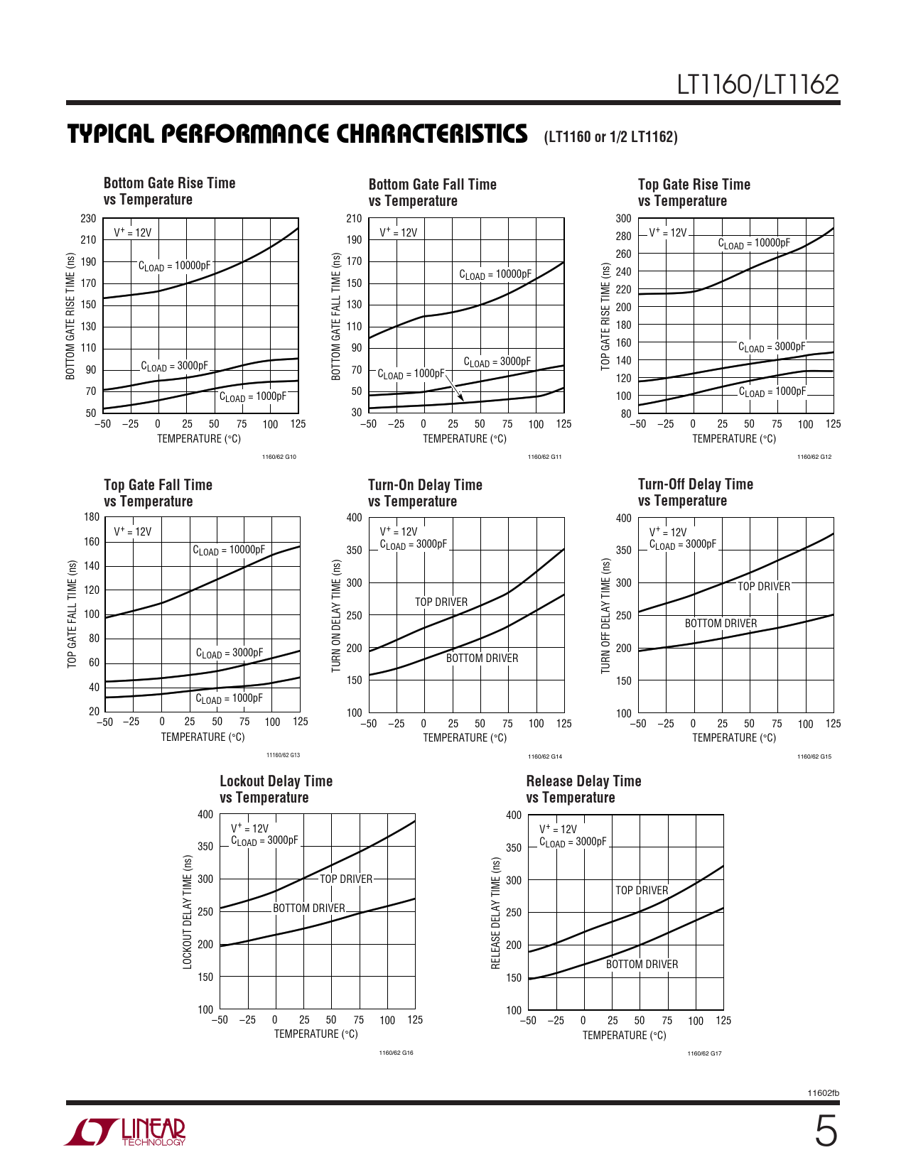

TYPICAL PERFORMANCE CHARACTERISTICS (LT1160 or 1/2 LT1162). Bottom Gate Rise Time. Bottom Gate Fall Time. Top Gate Rise Time
TYPICAL PERFORMANCE CHARACTERISTICS (LT1160 or 1/2 LT1162) Bottom Gate Rise Time Bottom Gate Fall Time Top Gate Rise Time
LT1160/LT1162
W U TYPICAL PERFORMANCE CHARACTERISTICS (LT1160 or 1/2 LT1162) Bottom Gate Rise Time Bottom Gate Fall Time Top Gate Rise Time vs Temperature vs Temperature vs Temperature
230 210 300 V+ = 12V V+ = 12V V+ = 12V 210 190 280 CLOAD = 10000pF 260 190 C 170 LOAD = 10000pF C 240 LOAD = 10000pF 170 150 220 150 130 200 130 110 180 160 110 90 CLOAD = 3000pF CLOAD = 3000pF 140 90 CLOAD = 3000pF 70 TOP GATE RISE TIME (ns) BOTTOM GATE RISE TIME (ns) BOTTOM GATE FALL TIME (ns) CLOAD = 1000pF 120 70 C 50 CLOAD = 1000pF LOAD = 1000pF 100 50 30 80 –50 –25 0 25 50 75 100 125 –50 –25 0 25 50 75 100 125 –50 –25 0 25 50 75 100 125 TEMPERATURE (°C) TEMPERATURE (°C) TEMPERATURE (°C) 1160/62 G10 1160/62 G11 1160/62 G12
Top Gate Fall Time Turn-On Delay Time Turn-Off Delay Time vs Temperature vs Temperature vs Temperature
180 400 400 V+ = 12V V+ = 12V V+ = 12V 160 C C C LOAD = 3000pF LOAD = 3000pF LOAD = 10000pF 350 350 140 300 300 120 TOP DRIVER TOP DRIVER 100 250 250 BOTTOM DRIVER 80 C 200 200 LOAD = 3000pF BOTTOM DRIVER TOP GATE FALL TIME (ns) 60 TURN ON DELAY TIME (ns) TURN OFF DELAY TIME (ns) 150 150 40 CLOAD = 1000pF 20 100 100 –50 –25 0 25 50 75 100 125 –50 –25 0 25 50 75 100 125 –50 –25 0 25 50 75 100 125 TEMPERATURE (°C) TEMPERATURE (°C) TEMPERATURE (°C) 11160/62 G13 1160/62 G14 1160/62 G15
Lockout Delay Time Release Delay Time vs Temperature vs Temperature
400 400 V+ = 12V V+ = 12V C C 350 LOAD = 3000pF 350 LOAD = 3000pF 300 TOP DRIVER 300 TOP DRIVER 250 BOTTOM DRIVER 250 200 200 LOCKOUT DELAY TIME (ns) RELEASE DELAY TIME (ns) BOTTOM DRIVER 150 150 100 100 –50 –25 0 25 50 75 100 125 –50 –25 0 25 50 75 100 125 TEMPERATURE (°C) TEMPERATURE (°C) 1160/62 G16 1160/62 G17 11602fb 5
